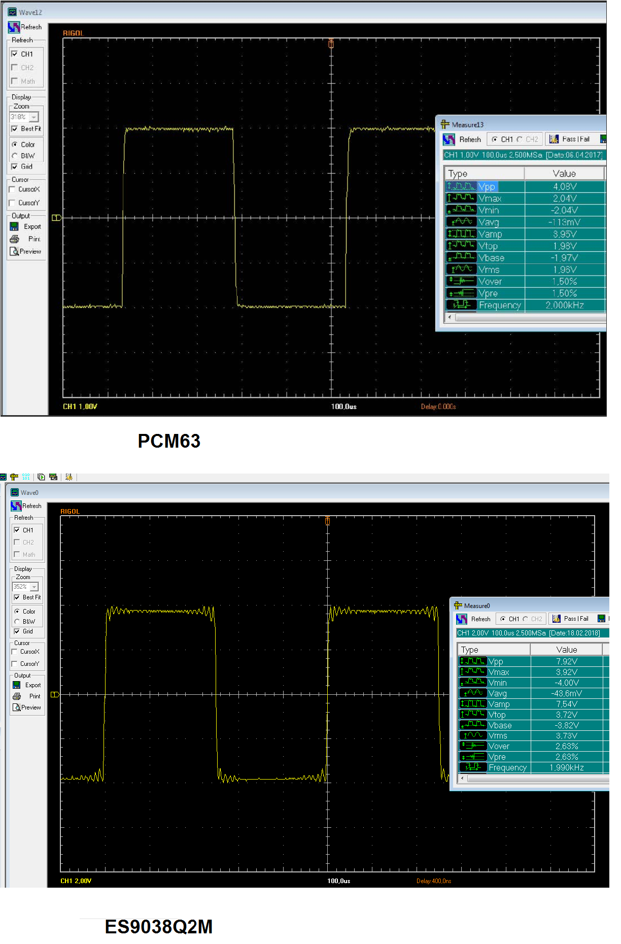

I got my 9038q2m board few days ago (VR1.06). From stock version it sounds very good, at least much better, than hifime Android ES9018 DAC. But even powered from superior quality linear PSU (+/- 15V) it still sounds like plastic, far from smoth analog lifelike music. That is why I still prefer old multibit DACs instead of modern delta-sigma.
But in frames of subject let me notice the real sound improvement phases on this board.
I don't want to say much about digital things, will indicate just for reference (should be): clean lines of IIS, clean XOs, iso, bitperfect.
However the real magic, even in modern time still happens in the analog part of DAC.
First of all, as I said above - PSU. The main PSU with clean, linear phase\impedance (without tons of ultra HFs and LPFs) is realy must to be in any DAC implementation. It is absolutely needed because the most significant part of music is located in the small signals. Small signals is a glue for anything in the world of sounds. From practice, "Virtual battery" schematic is a good choice (at least) to go down to 16 bit and deeper accuracy. When the first PSU is clean, all other regs and LDO's will do their job much better. Second step in list, but really in "the same league" with PSU quality is the i/v converion stage. I have tried a lot of different variations of i/v on OPamps (and discret) in past, but after current transformers (very low primary DC resistance of ~5-10 Ohm with enough inductane for LF), I have realy forgot about any OPs and other electronic devices in i/v stage. This DAC now is very close to my PCM63s. It is very simple to put transformers into layout of this board - just to remove a few elements and to solder instead of them pins for primary and secondary coils.

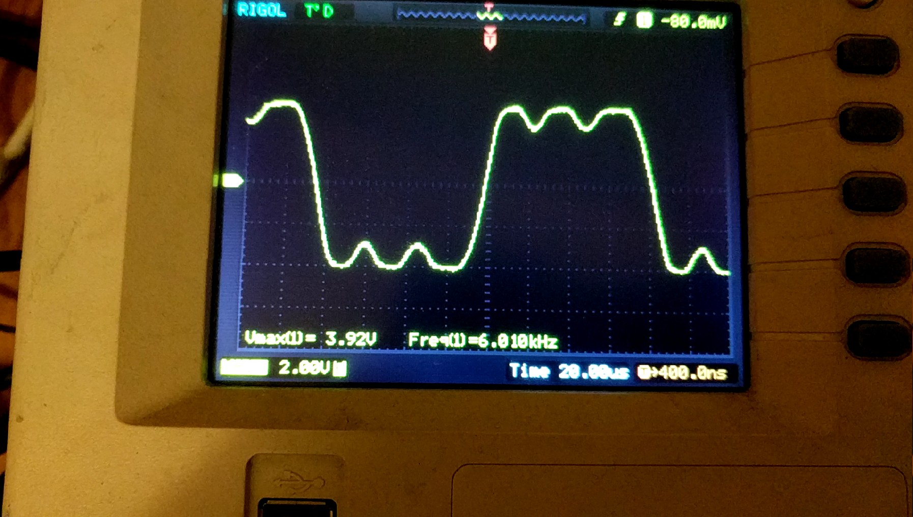

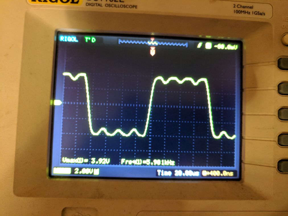

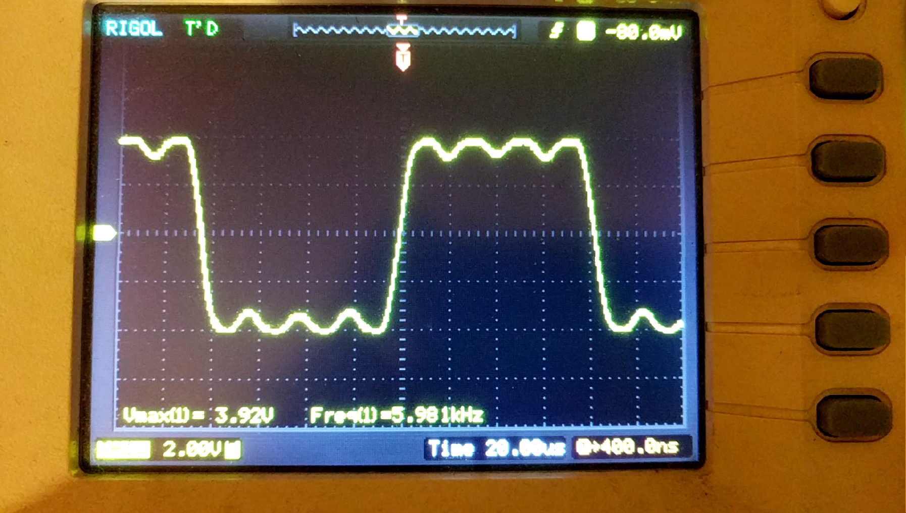

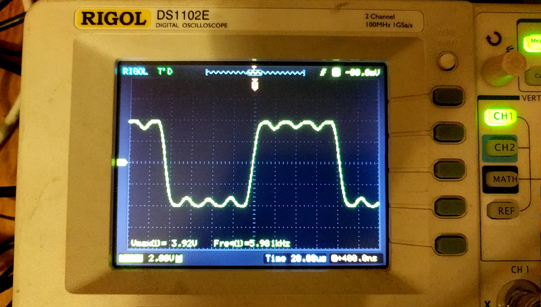

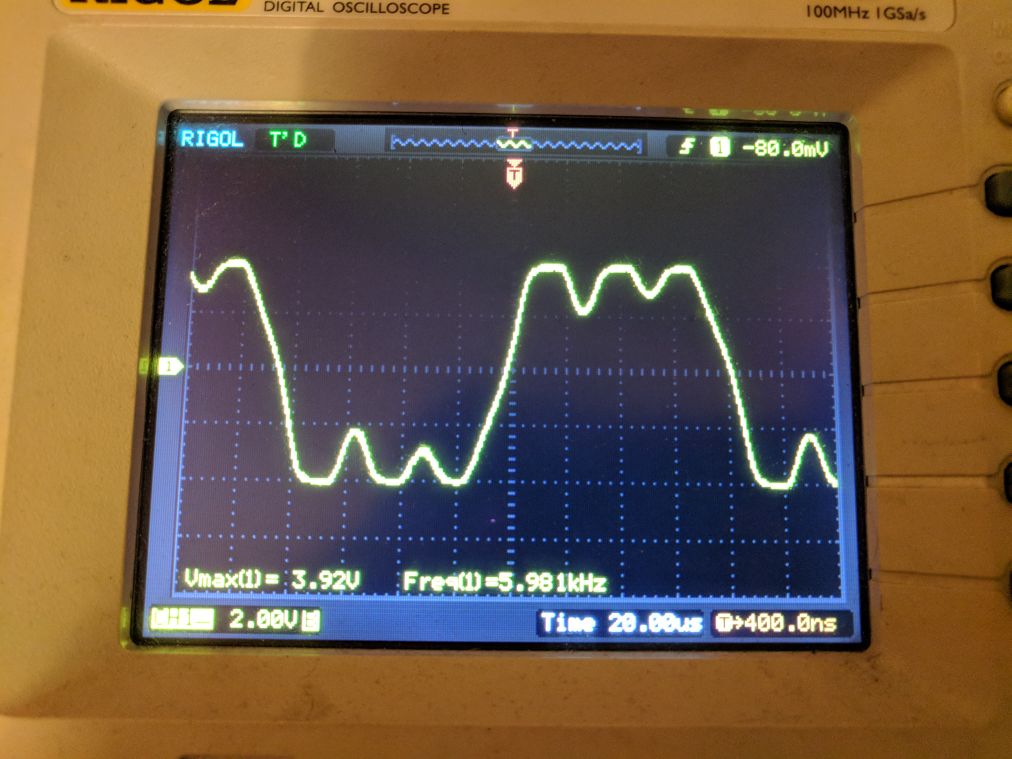

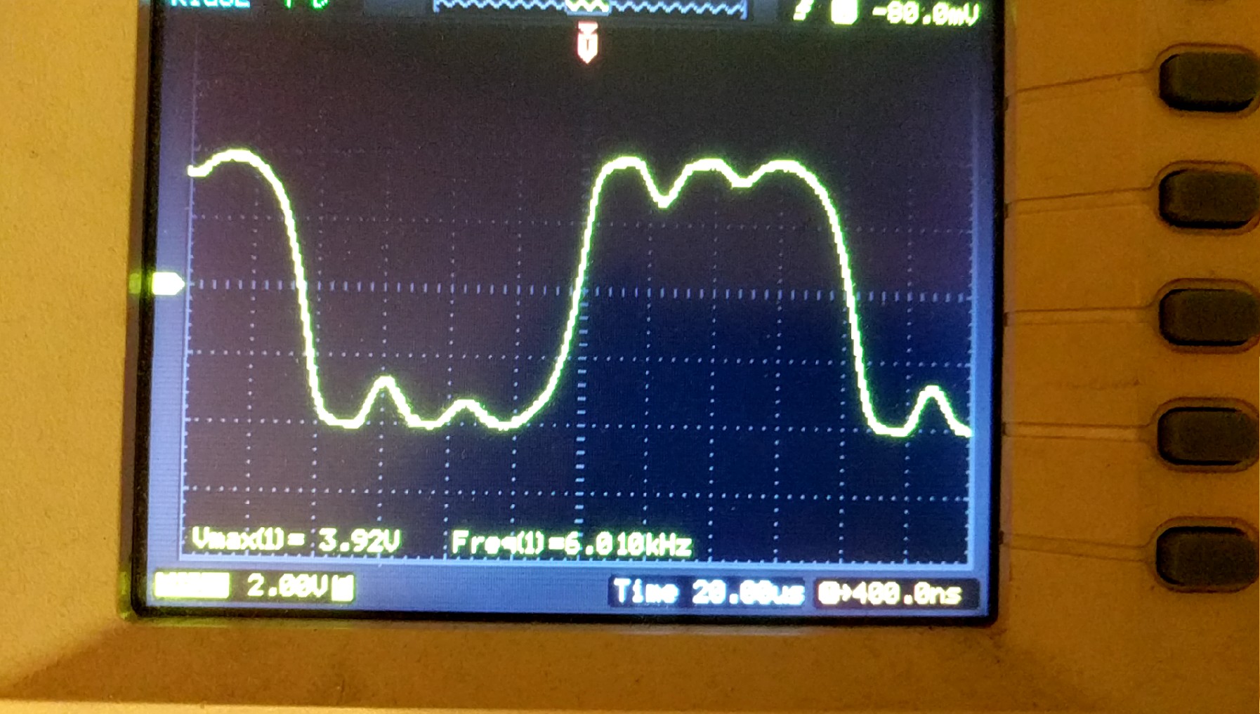

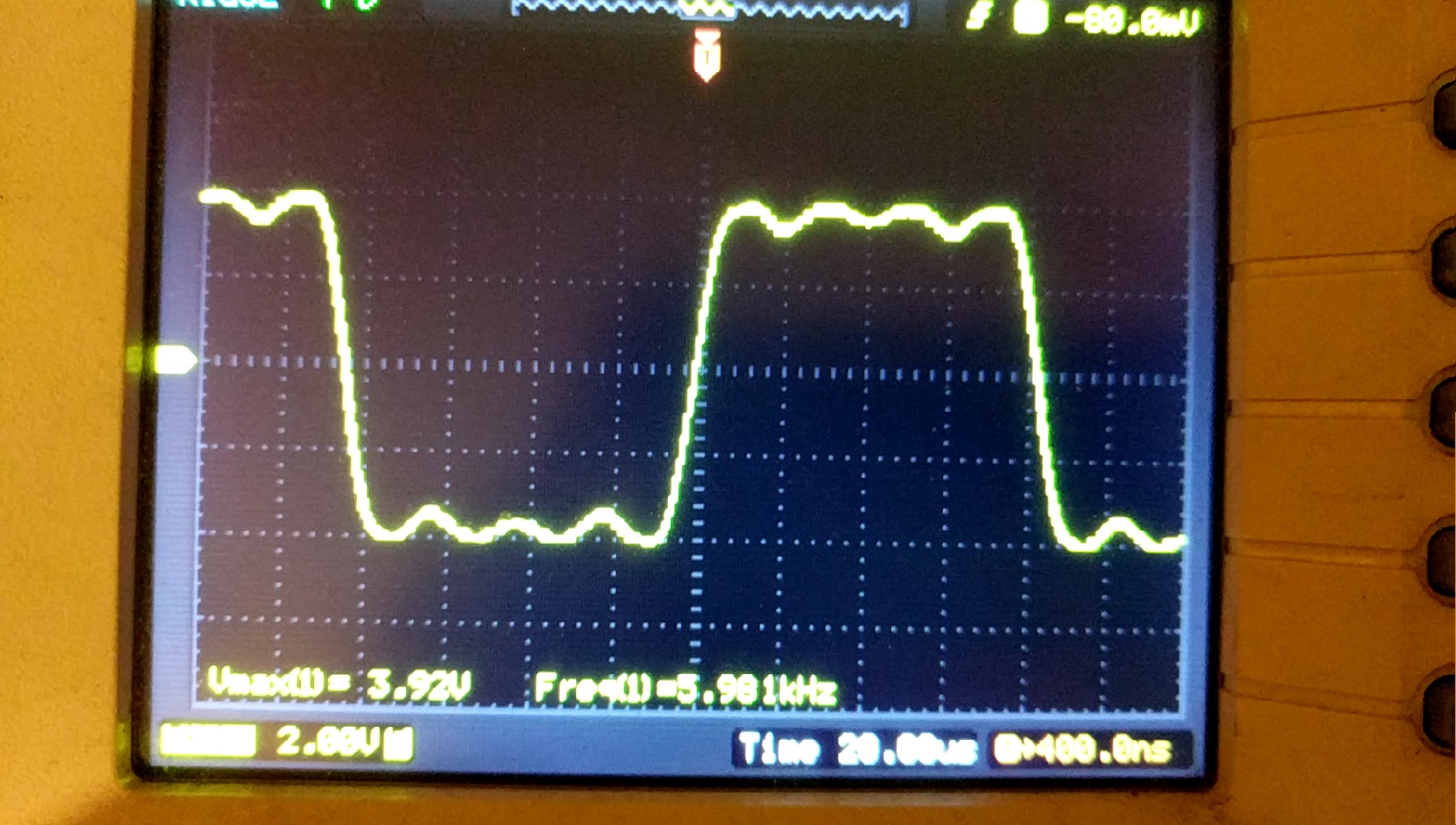

May be will be helpful for someone to make choice between LPFs:

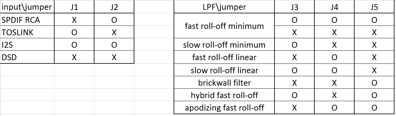

Maybe useful to mention that the fast rolloff linear phase filters exhibit pre-ringing. Best sound quality would be with slow-rolloff minimum phase, if and only if the sample rate is high enough relative to the bandwidth of the audio content. In other words, HF audio gets aliased, especially in the transition band and it is easily audible. However, if you took, say, a CD and upsampled it to 24/96, it should sound good with that filter because the highest audio frequency on the CD isn't more than 20kHz which is far away from Nyquist.
If anyone wants to try it, ripping a song to Reaper DAW and using "Extreme High Quality" SRC during Rendering does a good job of making a high quality 24/96 wav file.
NOTE: Also, regarding the jumper setting table in a previous post (thank you) it wasn't stated but: O = jumper on X = no jumper
Sorry, but it is vice versa and similiar to original graph from ebay seller's page.
X = Connection
O = Open
