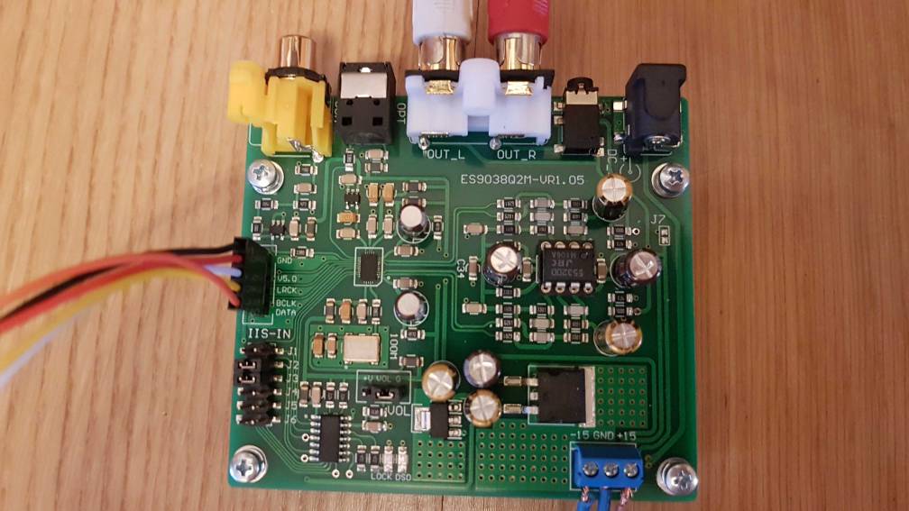

ES9038Q2M Board
Just a thought....these boards reportedly vary as to whether x=connection or o=connection....
Is it possible that J1 (not used for anything according to vendors) controls which is connection...?
ie J1 on then x=connection J1 off then o=connection
Just thinking aloud...will unbox my V 1.04 this weekend and test that...

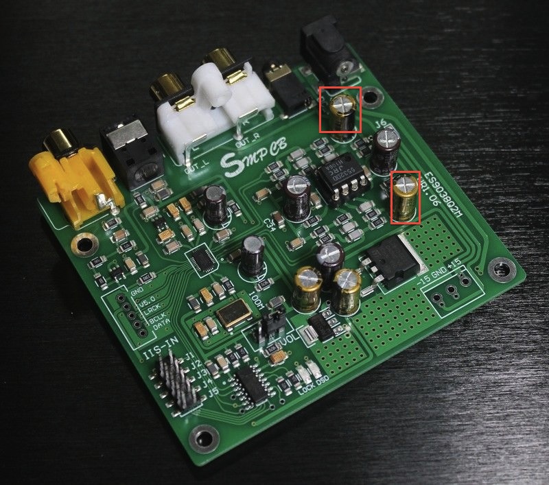

I tried THS4012 CD and it gets very hot, could oscillations cause this, I haven't put 100pf cap on, should I?
The 100pf cap only removed some perceptible glare (possibly caused by ringing). Didn't affect the temperature
Did you remove or short the output DC blocking caps? These fast opamps don't like capacitve loads (cables) so better to short the output caps and make the series resistance the first thing the opamp sees prior to the cable capacitance.
Anyhow - My supply voltage is +-15V and the opamp sits at nearly 70C with an ambient temp of 22C
I don't know if the powerpad has thermal paste, if it is well seated, what the thermal coefficient of the PCB is etc. But I am not worried. The chip can tolerate a 150C junction temperature
As an aside - I read that THS401x draws nearly 8ma per opamp so that is 16ma for the chip. With a 30V supply differential - is it nearly 1/2 W
dissipation. Assuming you are not driving a heavy load - 0.5W on a low K PCB will sit at about 90C according to the graph on page 19 for a ambient temp of 20C.
So things seem reasonable

Do I understand correctly that the +-15V supply is used for analog output stage (5532) only and the DAC itself is powered via 5/8V pre-regulator and AMS1117-3.3 regulator? If so, the output stage could be modified for smaller voltage in order to decrease the heating. Must the THS4012CD be run on +-15V or would +-9V be enough?
