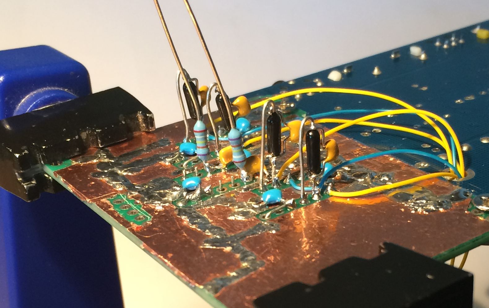

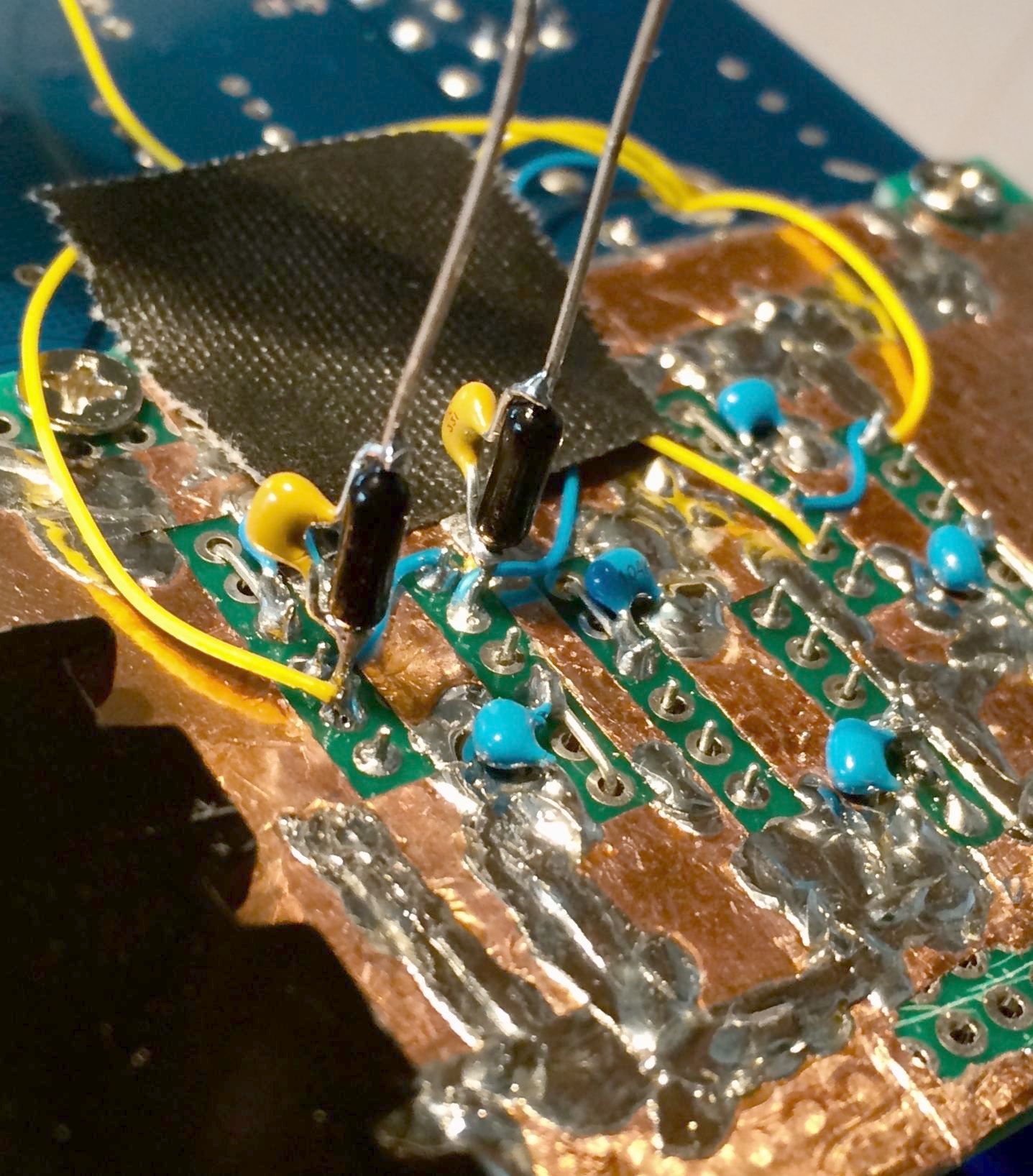

A little more progress on the through hole component output stage board. I am finding that it is a bit tight in there because I prefer to keep leads fairly short, at least where possible.
That being said, for others interested in building one of the output stages it might be worth considering moving the sockets a hole or two farther apart to ease construction access. Latest pic below.

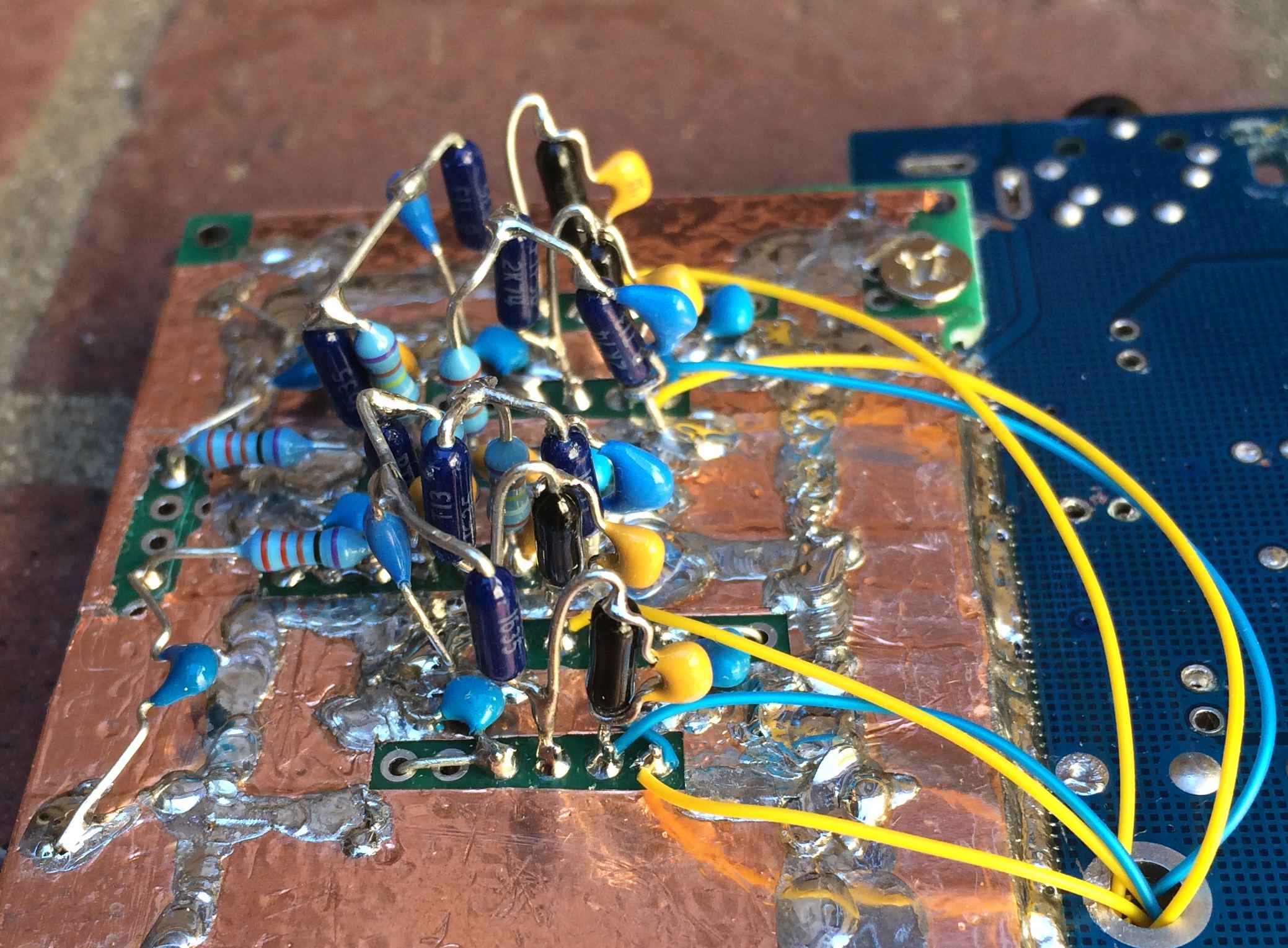

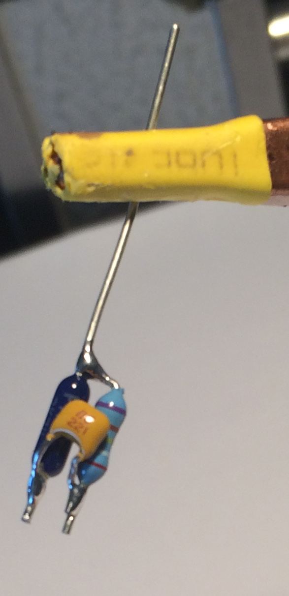

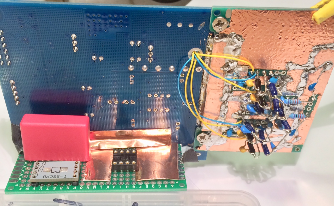

A couple of pictures below.
First is a picture of sub-assembly for attachment to output and inverting input of differential summing stage, one needed for each channel.
Second picture is of completed components and sockets wiring. (6.8nf output filter caps are tacked on lightly until I see how I like them.) I/O wiring on the bottom of the board, and power wiring on the top, both remain to be finished up.
Will probably add some 1,000 uf power filter caps somewhere, maybe on the dac board or maybe on the output stage board. I also usually like to put some reverse protection diodes where power comes into a board like this if it is not equipped with a polarized power connector.

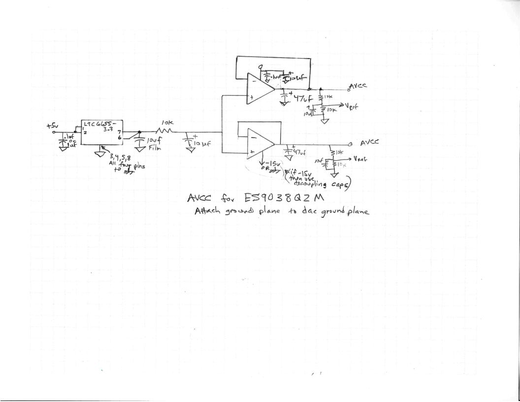

Looks like it is getting about time to start laying out an AVCC power supply somehow or other. Want to have ground plane for it too. I guess I have some ideas about how I might do it, but they aren't quite solidified yet. Anyone else been thinking about how to do AVCC? Serge, have you by chance made any progress on figuring out what to do for LTC6655 output filter cap? I only have some physically big ones here. May just have to go with that.

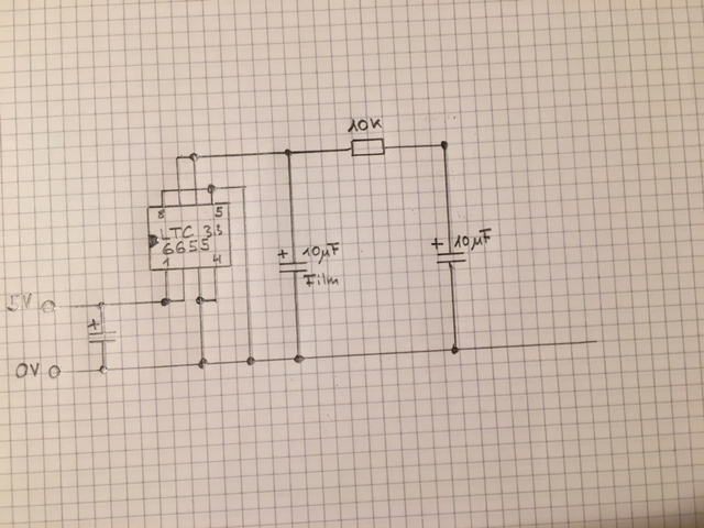

Given the number of downloads of the recent rather poor quality AVCC schematic it appears there was more demand for one than I had realized. I would therefore like to offer a slightly improved version in case it would be helpful for working on a through hole component AVCC board.
EDIT: Error got through on drawing during a revision. Opamp(s) are intended to run on +-15v with decoupling caps on both rails, or alternately, +15v and ground could be used, with decoupling just for +15v. Don't know if it makes any difference which power scheme is used in terms of SQ, but I wouldn't expect any difference.

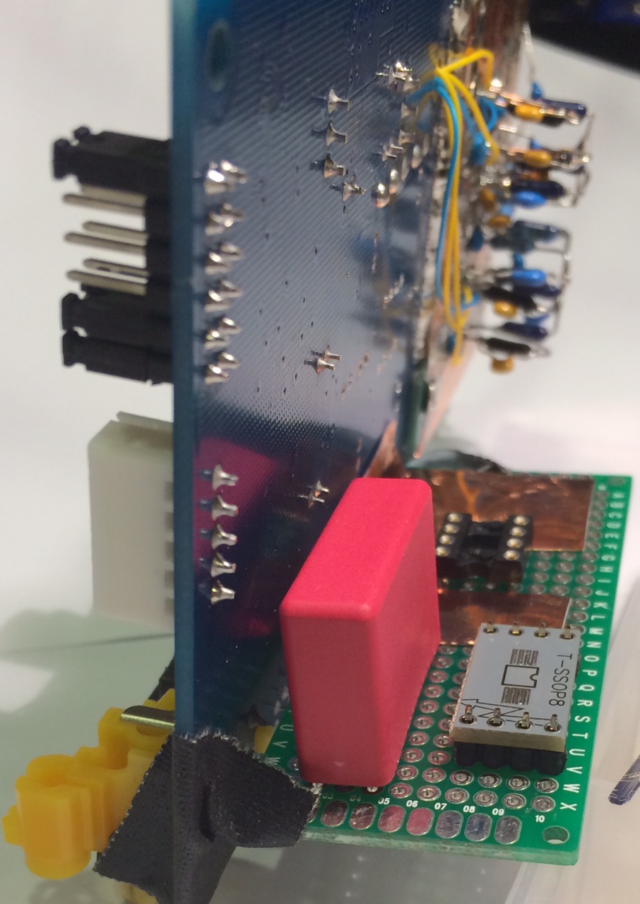

In order to mount a board there, I might need to move the audio output RCA jacks down to the output stage board, not sure. Might be a better place for them anyway.
Probably could fit the Vref dividers on the little AVCC board too. I was thinking of only having the ground plane make contact around the middle area of the dac board where the old output stage was. I laid a piece of copper foil roughly in that area to illustrate.
Closer to the far end of the dac board down where the digital stuff is would be an area where I would probably not connect the ground planes together. That would approximately be under where the far end of the big film cap is, for example.
With your AVCC ref voltage, you can use more aggressive LF filtering, say
100uF after the 10k R (instead of 10uF) and bypass 10k with a small
schottky pull up diode. Just a trick I've used on quite a few things where
I want very low LF noise.

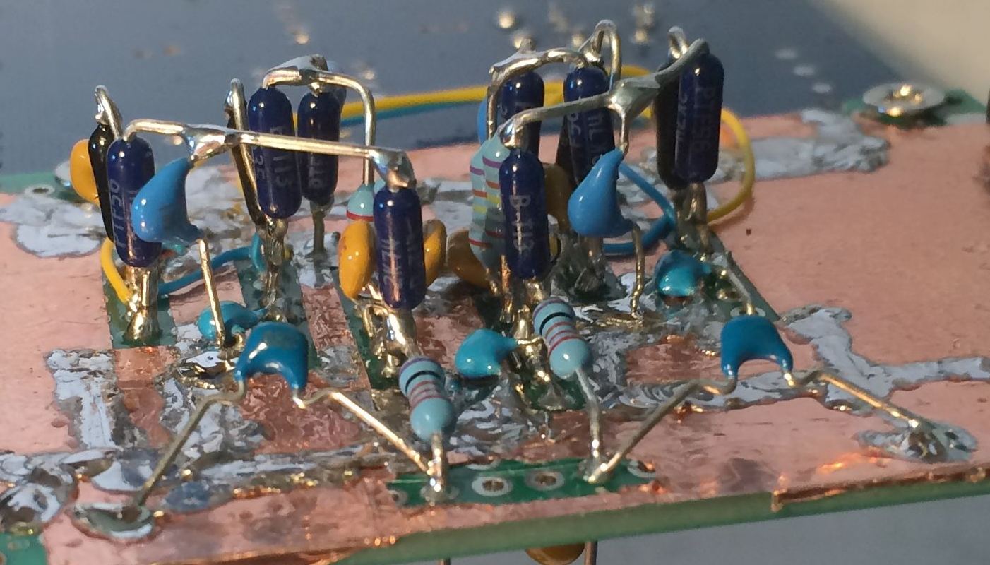

Mark, can you take a couple of pix without the flash and with some side-lighting ?
..... your macro is good but the depth of field not so much.
..probably limitations of P&S camera...?
and the flash flattens everything at the board level so it is very hard to tell what goes where...
thanks,
Bob.

In the meantime, I don't have any holders or remote exposure buttons yet. May I ask if the existing pics and layout drawing are usable or not as they are? I thought they were insofar as looking at a jumble of wires and components can be easy or hard to visualize in 3-dimensions when only 2-dimensional clues are given.
In other words, if I just look at the output stage board in-person it is not that easy to see what is connected to what except by turning it in my hands so my System 1 brain processes can pick out what is in motion relative to what, and pick up more 3D clues from that. Or, sometimes looking at it with a little flashlight helps. Not sure any photography is going to make mental visualization a whole lot easier, if that is the problem you are wanting to see improved.
But, like I say, I think it works with the layout drawing in one hand and with the pictures blown up to full size by clicking on the white X in the lower left corner, it is possible to work through it. No?

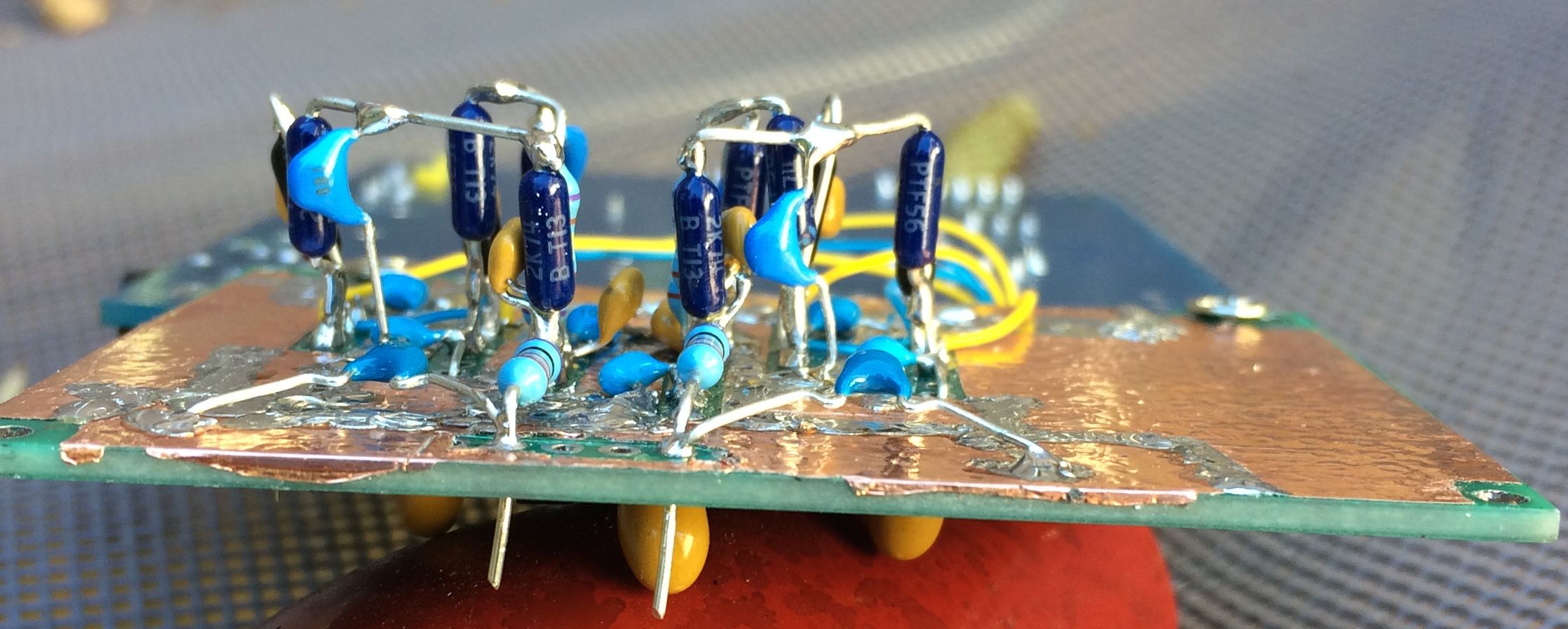

Tried taking a several more pics in outdoor diffused light. A couple might be useful, although not so sure about one of them. Angle may make a big difference, but there are not many good angles possible. You can see what you think.
EDIT: It may help to be aware that there are 4 distinct nodes tied together up in the air. Some of them stretch over longer distances from the more outside I/V opamps, and they have components attached at various places. The nodes for the more centered I/V opamps tend to come together at one solder blob each. I could try marking the 4 aerial nodes in different colors if that might help to distinguish them. If you want me to give it a try, tell me which picture would be best to do that with.
