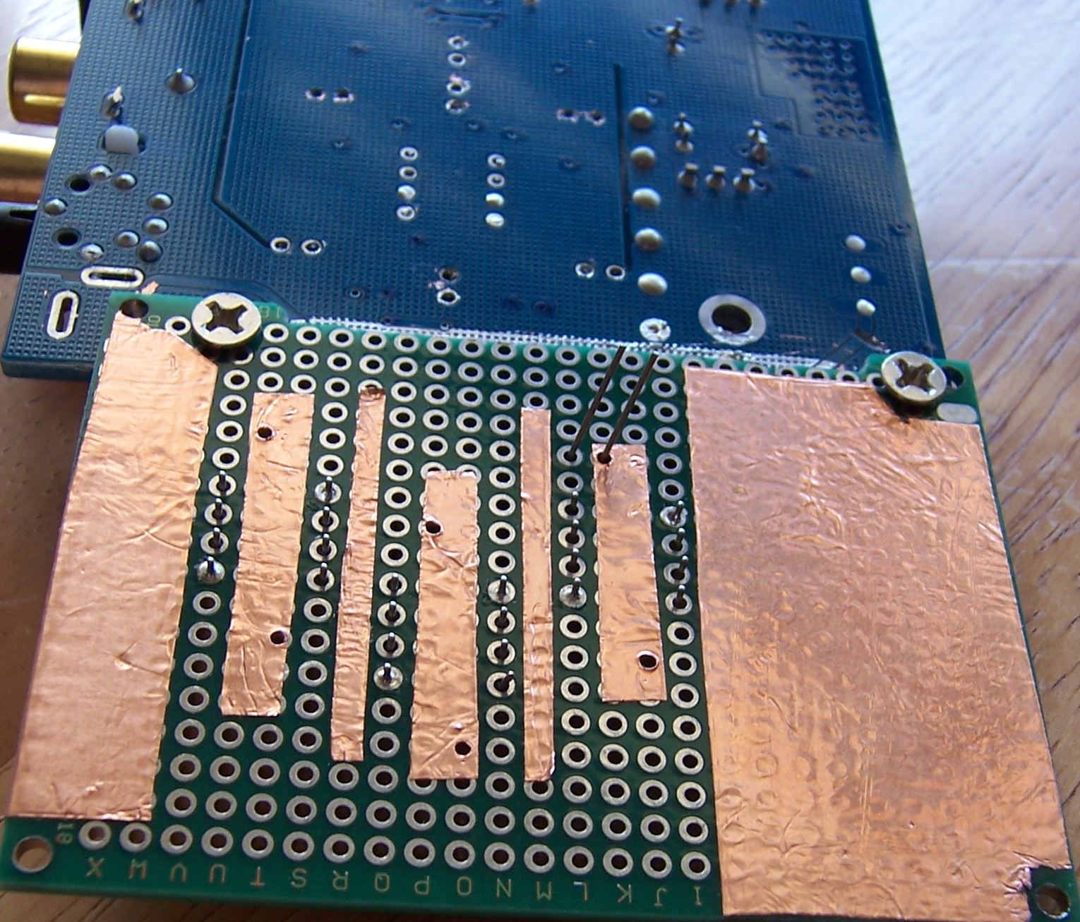

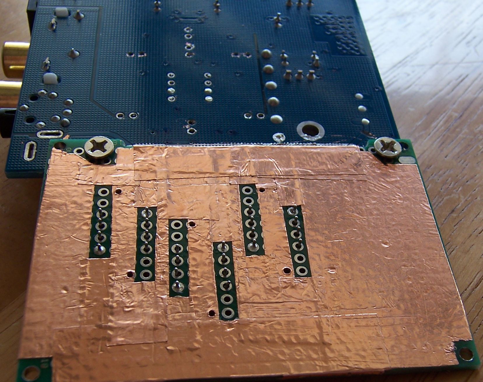

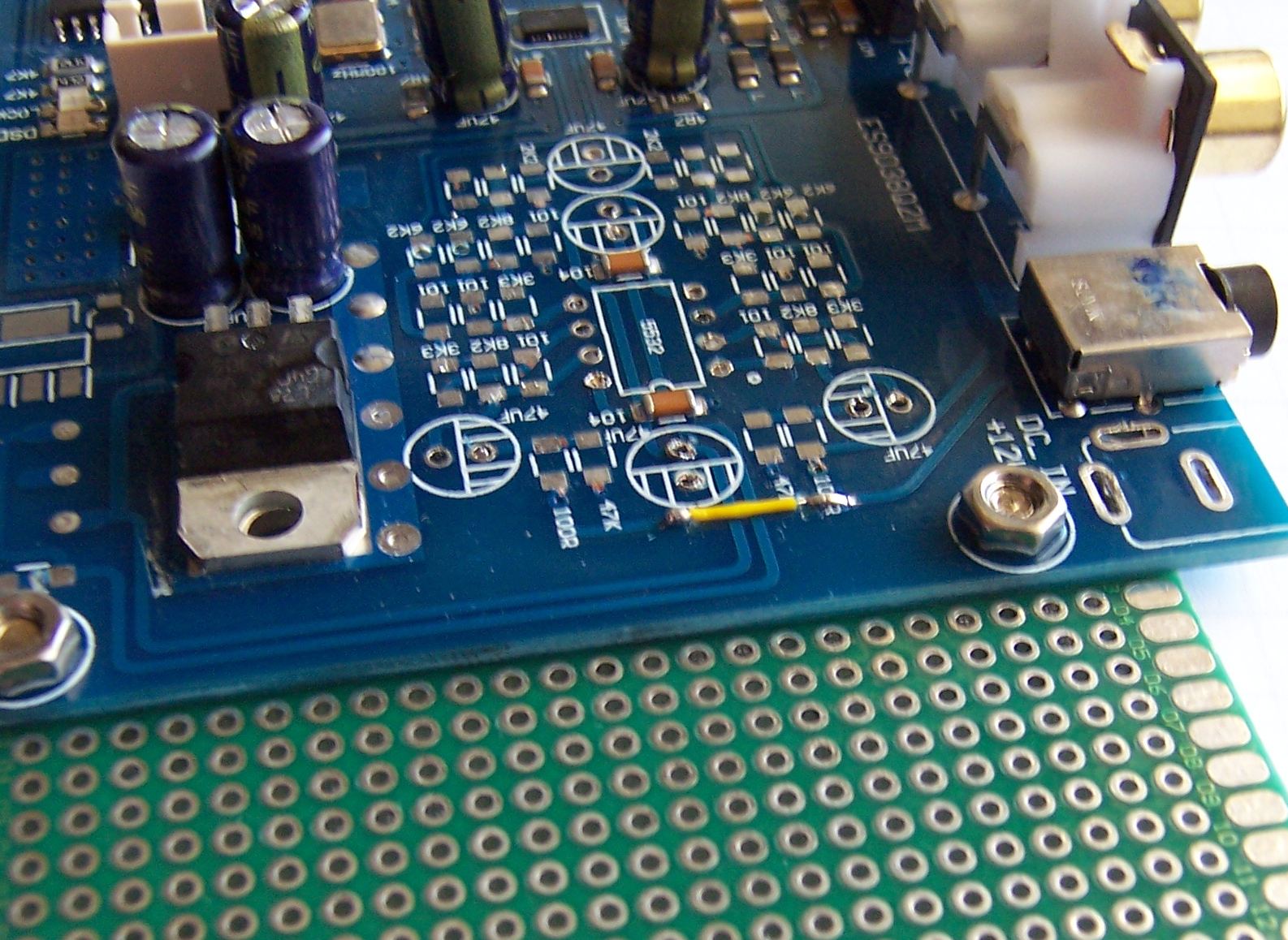

Back to through hole component output stage work. Attached below are pictures showing jumper across trace I cut out on the bottom of the board, and an area of the dac board that has been tinned with solder so that output stage board ground plane can be soldered to dac board ground plane.

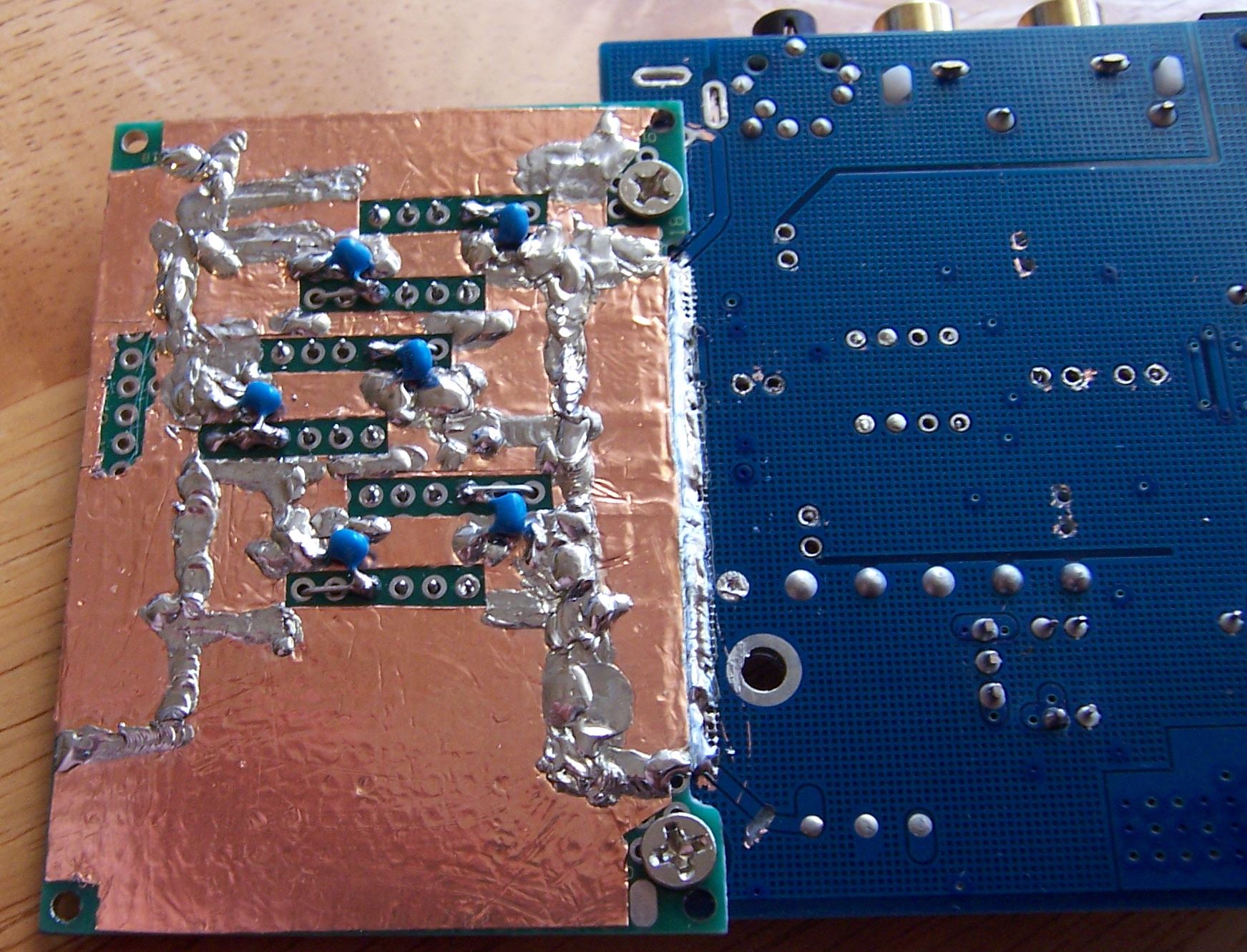

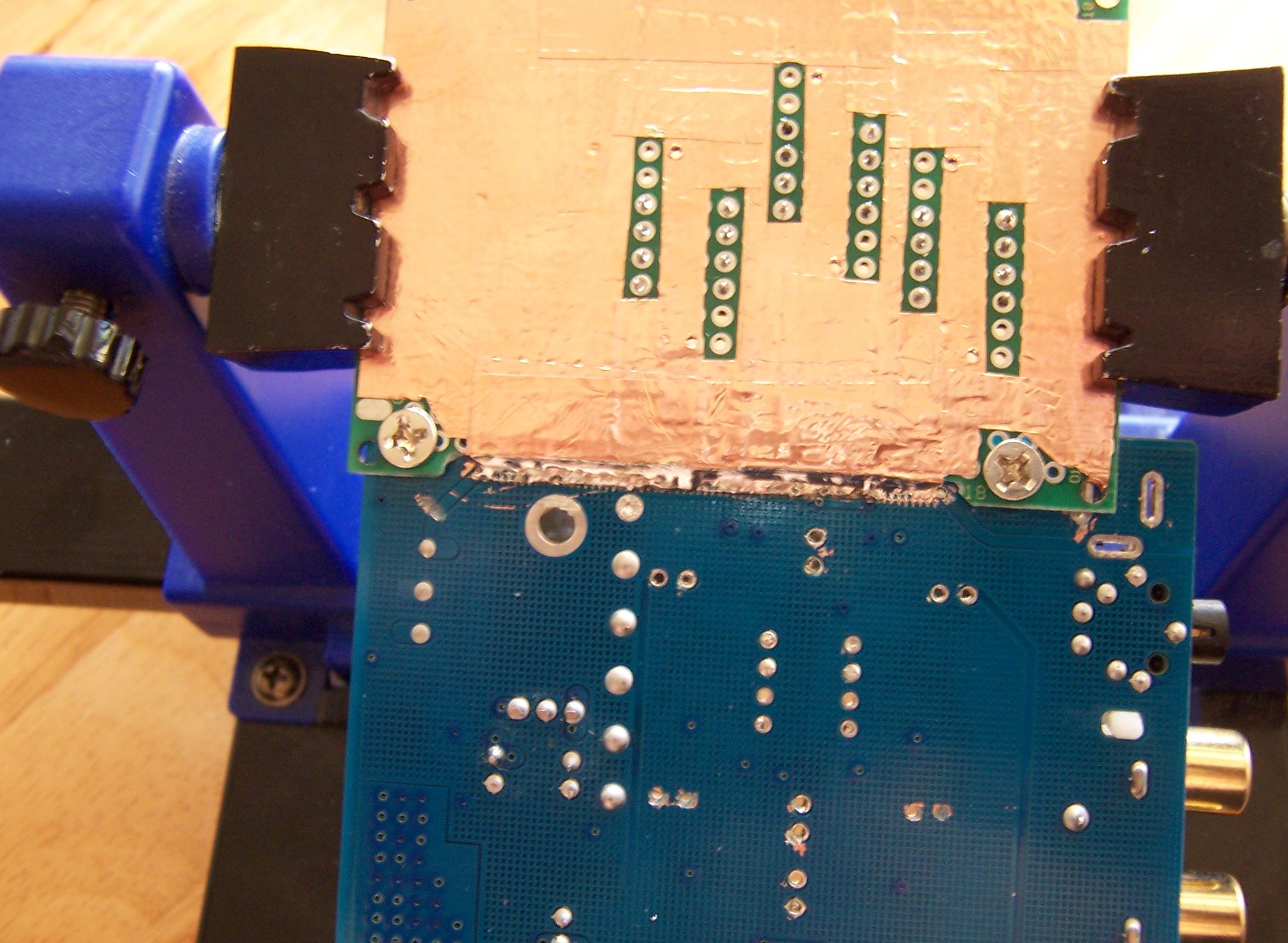

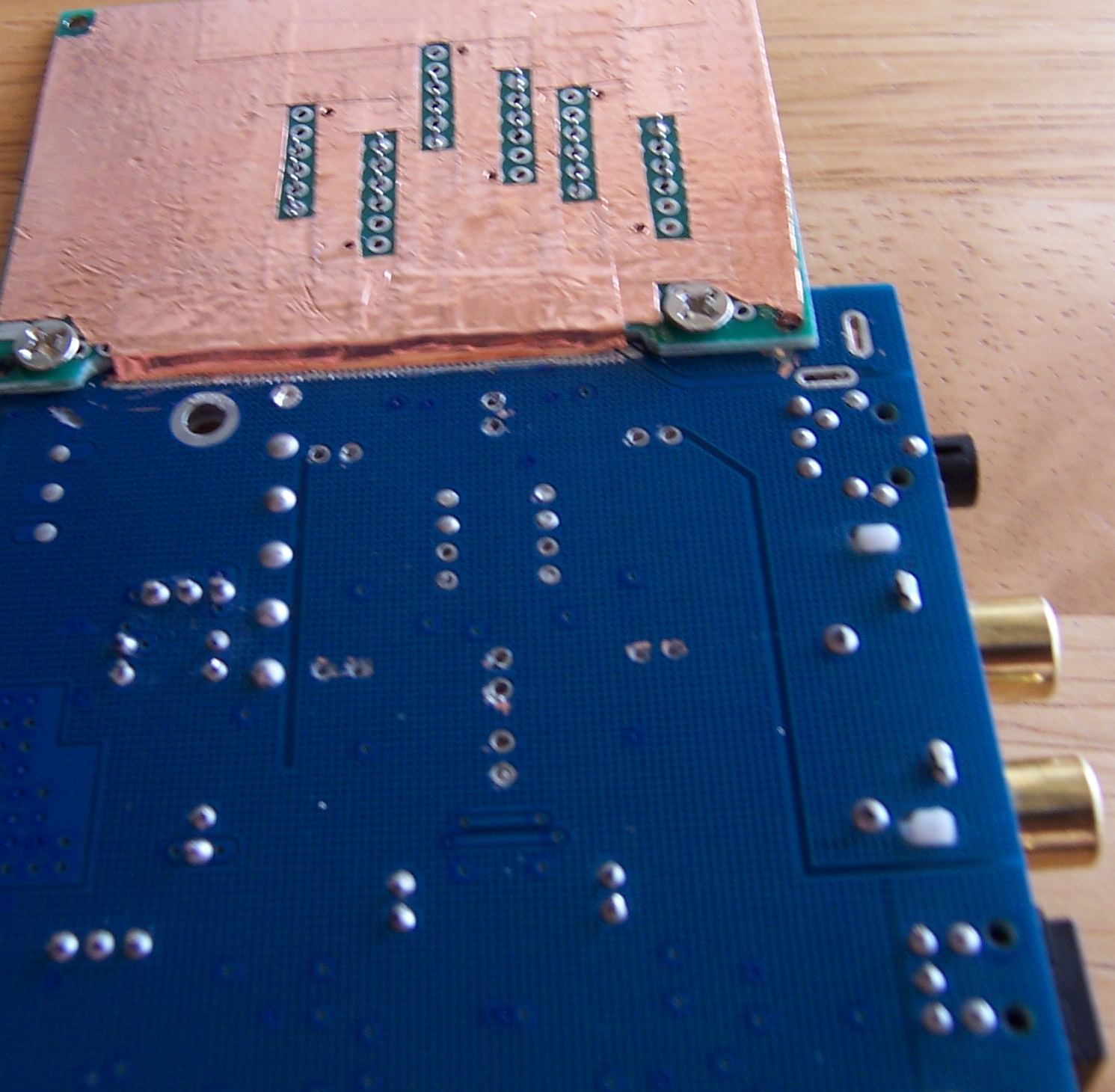

More output stage preparation pics attached below.
There are a few holes punched in the copper for the tantalum decoupling cap ground lead to come down and get soldered.
Obviously, I will have a lot of seam soldering to do a bit later.
Solder joint to dac board ground plane looks rather rough in the pic where there are shadows that look like missed spots. If examined from a good angle the solder joint looks fine.
Next step will probably be to install decoupling caps and perhaps wiring back to the dac outputs. That would be because that wiring would lay close to the ground plane and could be soldered on at the base of the socket pins. Resistors and signal caps are what will be sticking up and getting a bit crowded in places.

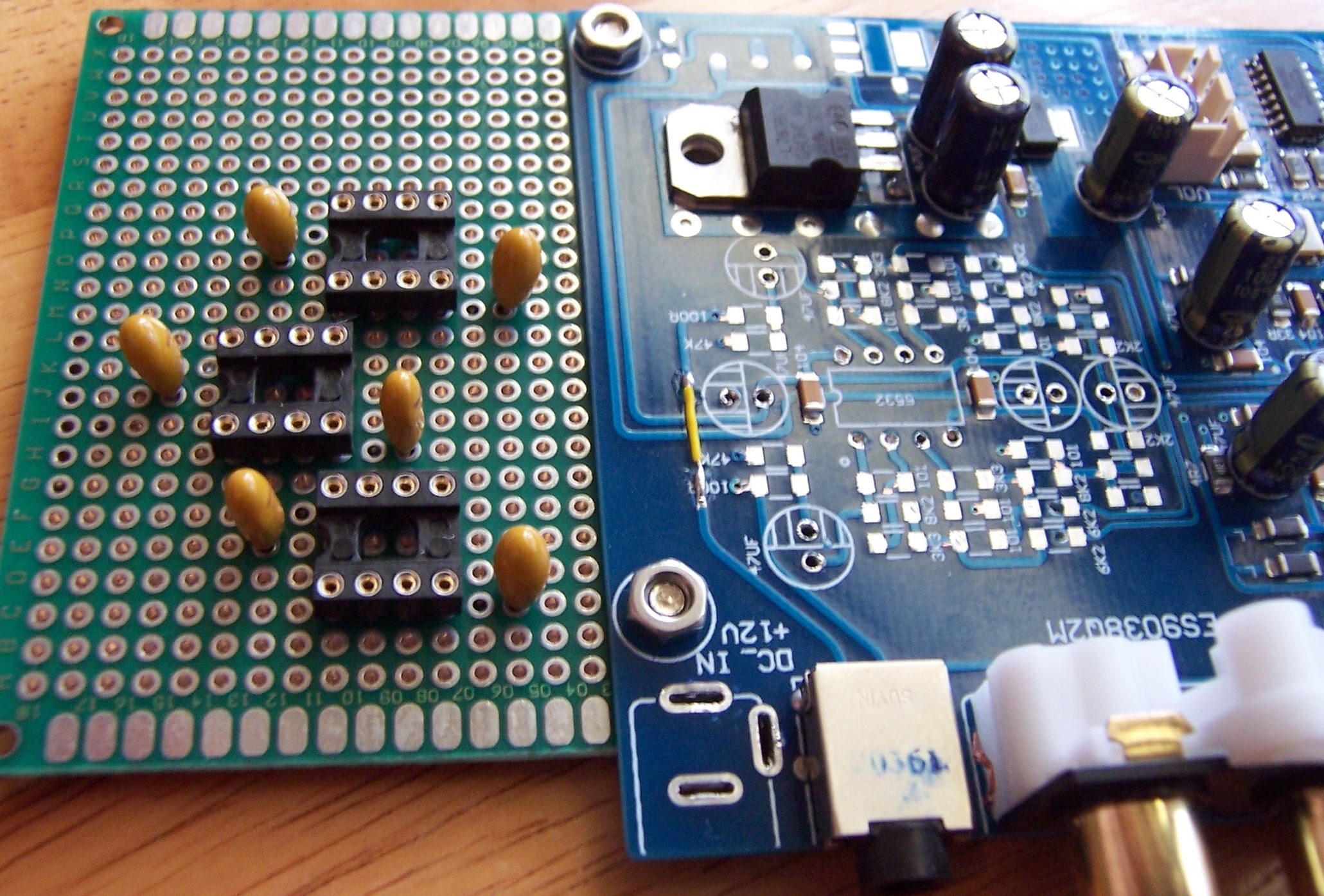

@DRONE7
That is the socket layout, except I removed some copper from a few more holes after I took the picture so I would have some places to solder the output resistor and cap together for each channel where I mechanically stabilize them a little more than hanging out in the air (since there will be wire attached to that node going off to the audio output connectors). You don't have to do it that way, of course. There are always other ways...
EDIT: By the way, I did not miscalculate position exactly, I mis-drew position, and once I noticed it I was far enough along with the drawing that I decided I was too lazy to fix it (since I figured a note about it should suffice to warn builders).

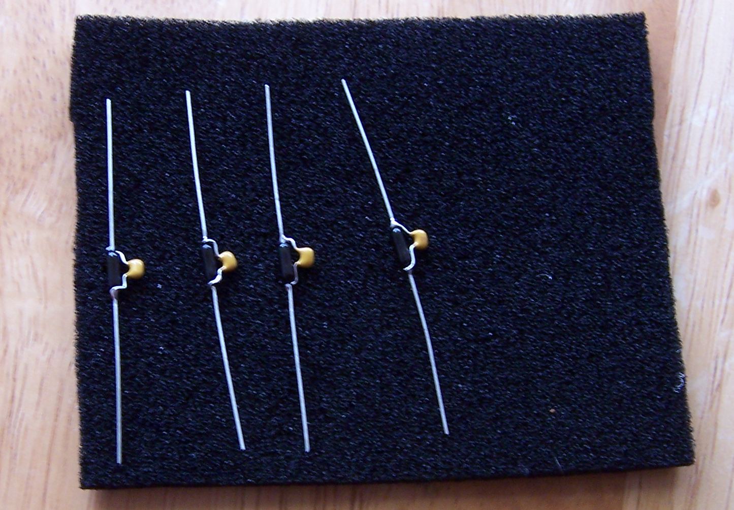

Starting to get ready for soldering multiple things together at once. Hopefully, without too much excess lead length if I can help it. Picture attached below of some 220 ohm resistors in parallel with 330pf for I/V stage feedback.
Think I can probably solder these assemblies to socket pins, with an input wire from the dac outputs soldered to one of the socket pins, and maybe then tack on a resistor to go to the filter that starts the differential output stage. Showing this and talking about it for beginners who may not have any idea about strategy for assembling things in some order. To go on a bit more then, I think I will cut off one of the leads this RC network pretty short and solder it to the inverting input pin of one of the I/V opamps. The RC network will either be standing straight up, or maybe folded over to one side, haven't decided yet. There will also be a wire from the dac output soldered on at the same time to inverting pin. I will probably tape the wire in place, then use a helping hand type of soldering holder to keep the RC in position for soldering.
Then I would plan to fold over the longer, as yet unsoldered RC lead to reach the opamp output pin and solder that in place. Later I will tack on another resistor to the long RC lead for connection to the differential stage input filter.
