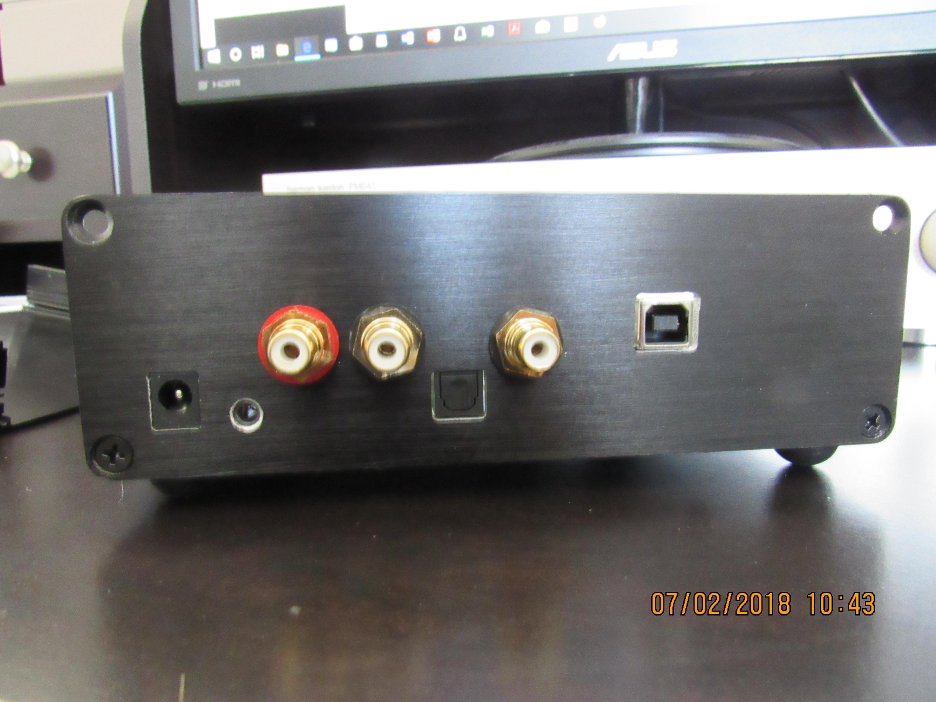

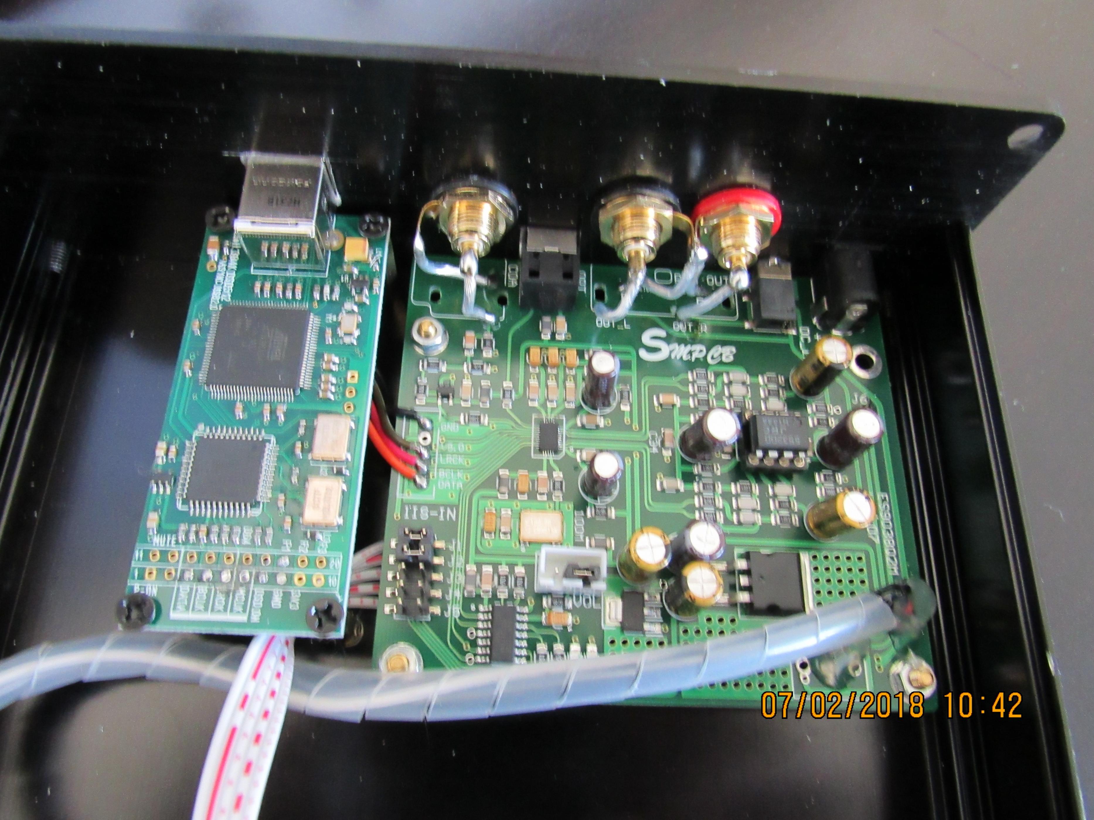

I am selling this 2.5 months old DAC at $38 off to fund my next DIY project. Please, check the SWAP MEET for my post. I got it originally from MINISHOW.This is not a review and there is not much mod. Just the first impression of an inexpensive DAC using the ES9038Q2M.

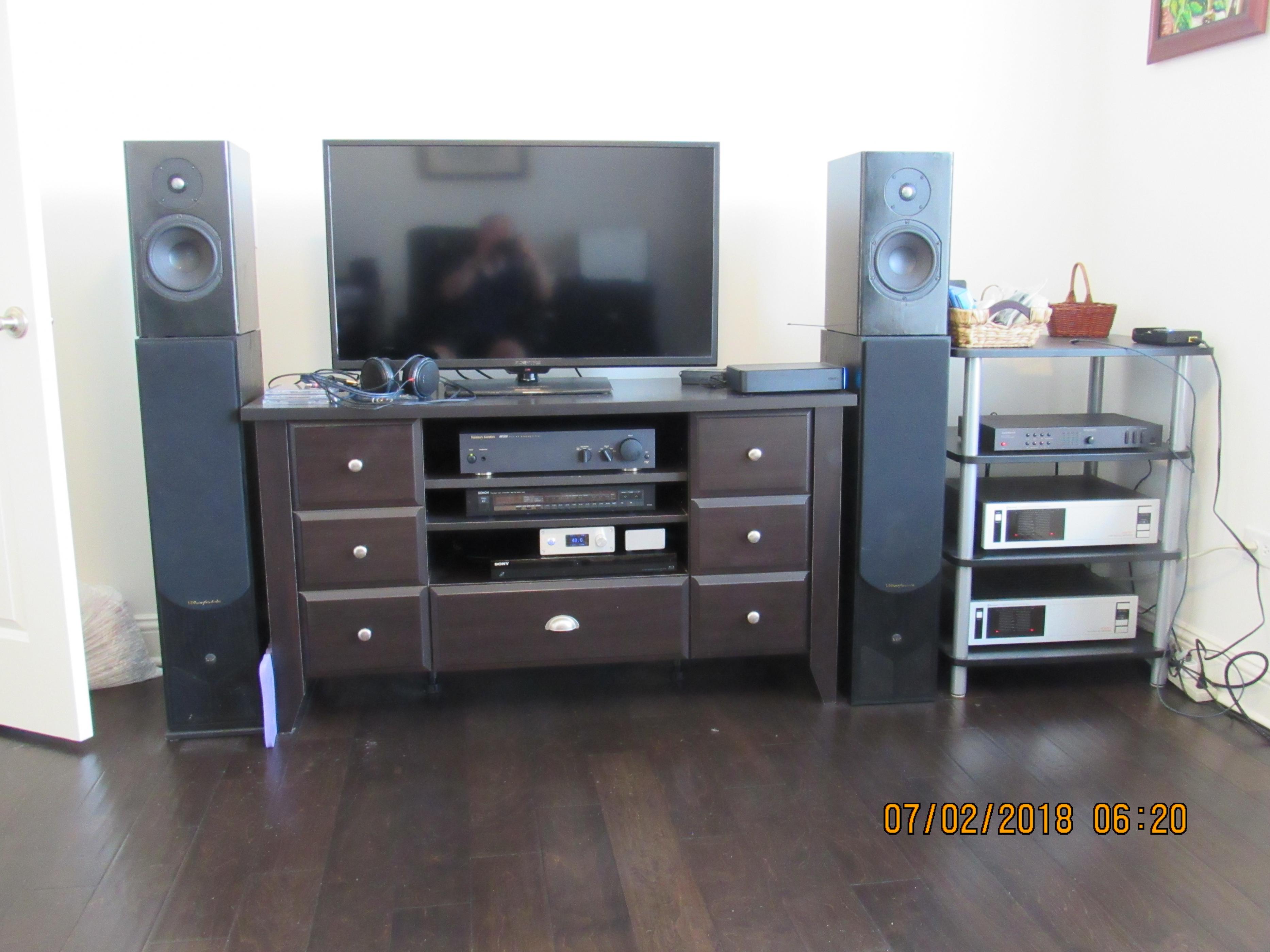

The DAC links the TV cable box and a Sony BDP-7200 Blu-Ray player to a Harman Kardon AP2500 preamplifier. The Blu-Ray player also serves as my CD player.
View attachment 689897 View attachment 689898 View attachment 689899

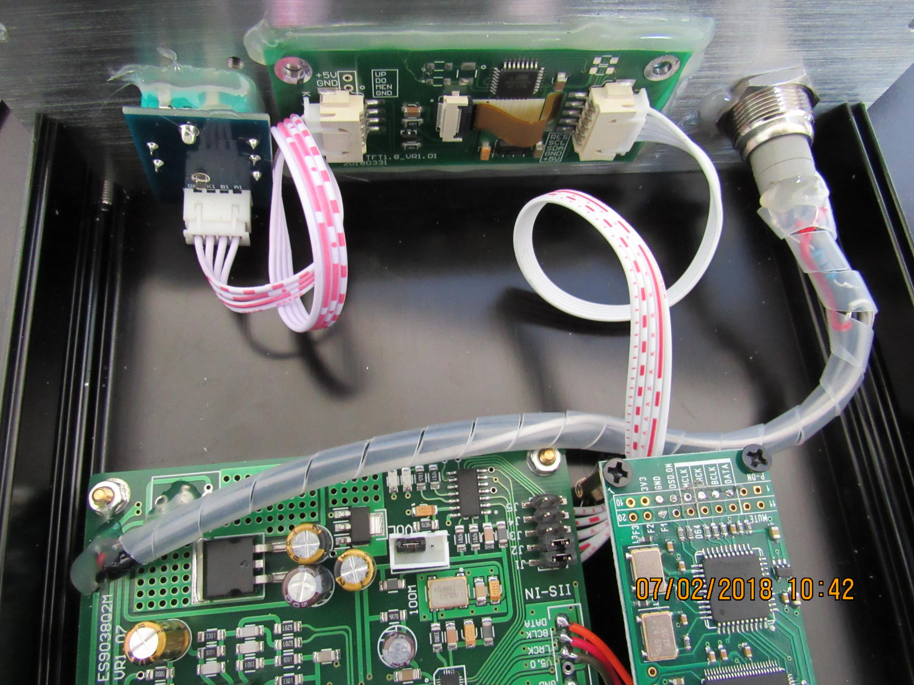

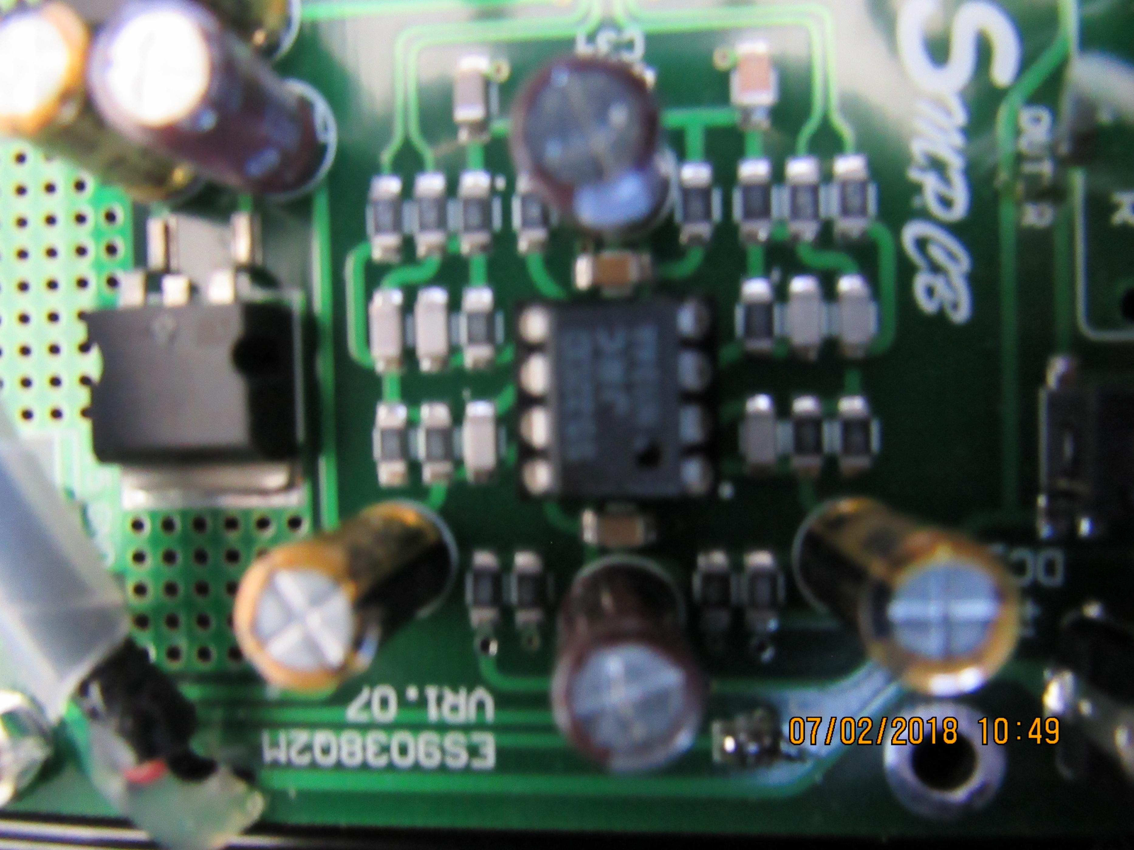

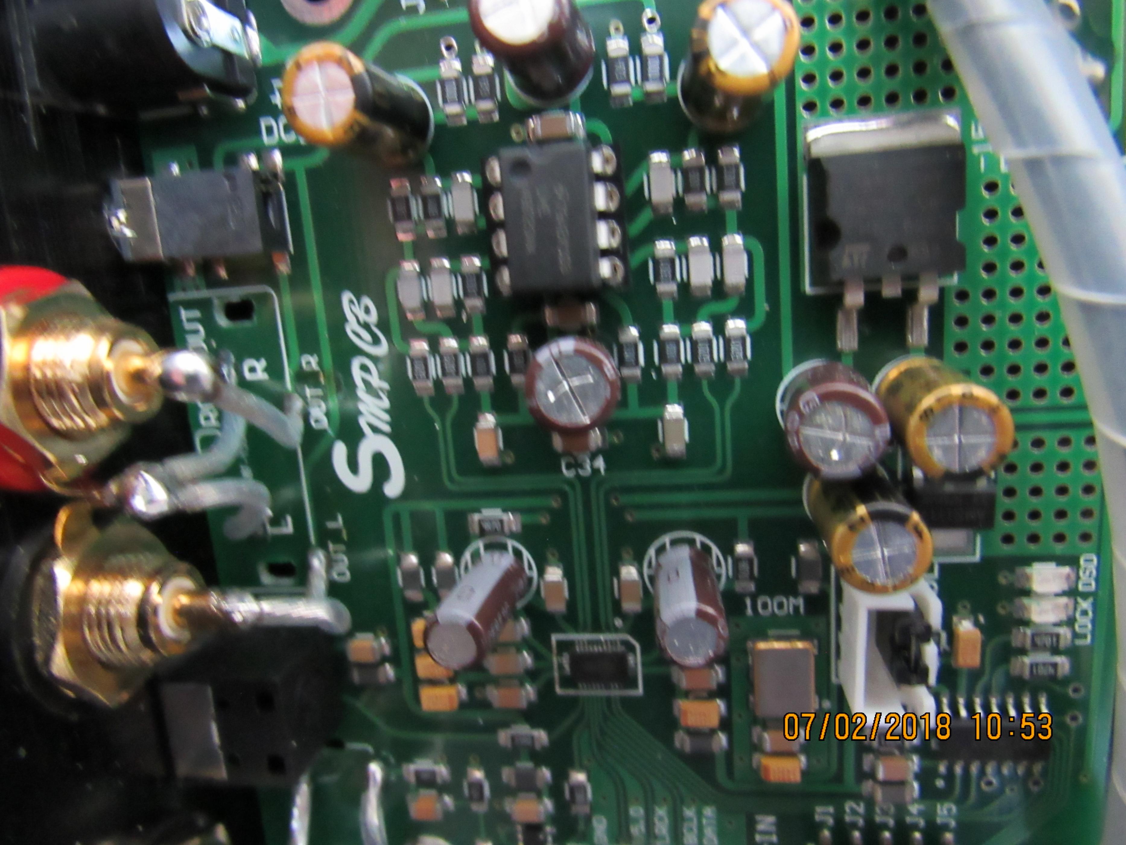

The DAC is built around the VR1.07 of the ES9038Q2M board we discuss on this thread. At the beginning, I used a switching PS from the Topping VX-1. It sounds very good from the get go. The sound is open and transparent. It has a stable sound stage with good depth. The construction of the DAC box is well executed. A lot of hot glue to hold down the TFT display panel and wires. I like the upgraded RCA socket, better than the one on the original board.
View attachment 689906 View attachment 689907

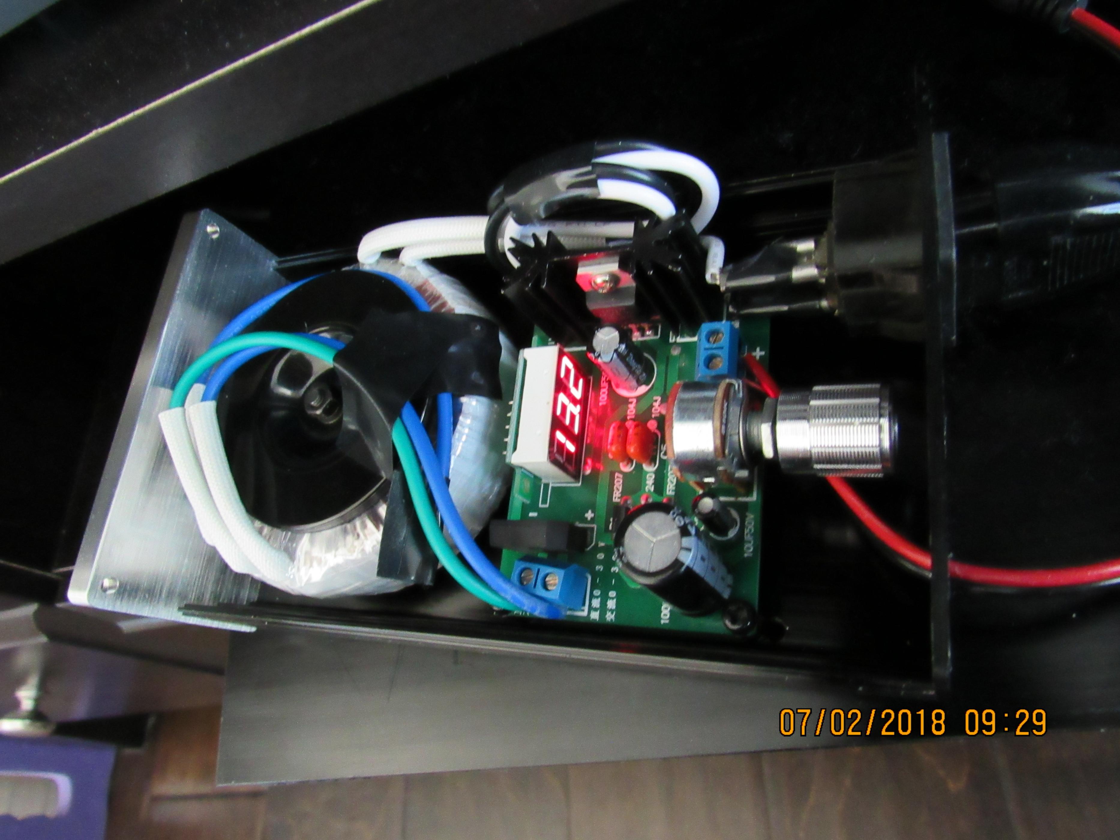

I built a linear power supply for it. It can output 9 to 15 volts up to 1 ampere. It has a good size toroidal transformer and the board has a DC voltage panel for easy setting.
I was planning to install a dual voltage PS. But there is not enough room inside to house the transformer and PS board. I went the easy route.
I did not even try to add I/V. I just replace the output stage opamp with a LME89720. The board came with NE5532DD which should be very good. I changed the opamp only because I have a whole bunch of the 720 in my spare box.

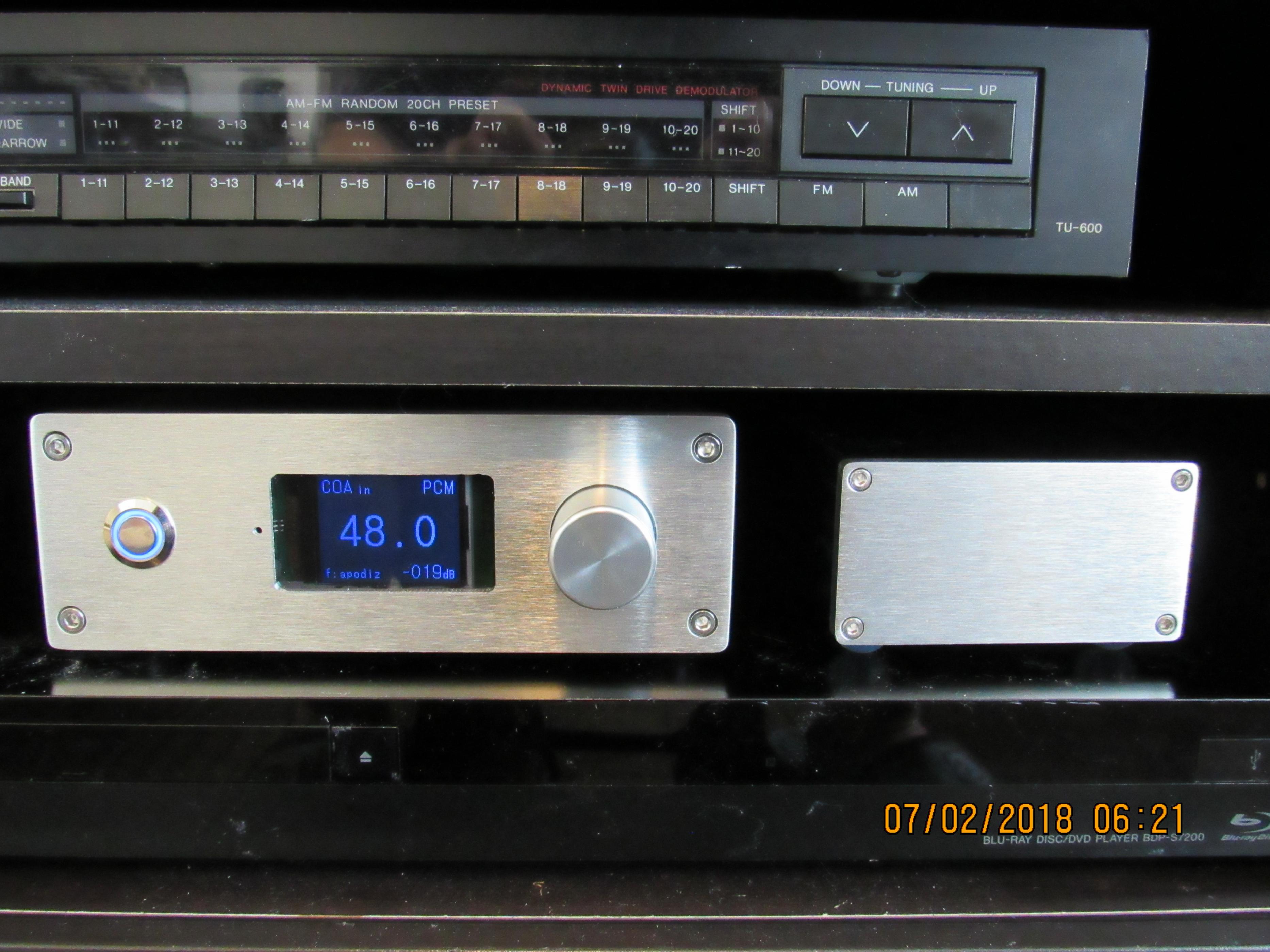

View attachment 689903 View attachment 689904
I purchase an Apple Remote which allows me to perform all the front panel functions.
My previous DAC were a Rotel RSP-1570 (for main audio) and a Tianyun Zero DAC (computer sound). Both were 10 years old vintage. It is not surprising that the MShow DAC sounds pretty decent to me. The TFT display and remote function are nice bonus. I will not hesitate to recommend this as good investment for the money, at half the price of name brand DAC. In fact, later this month, I will try to sell mine to finance my ES9028PRO project.

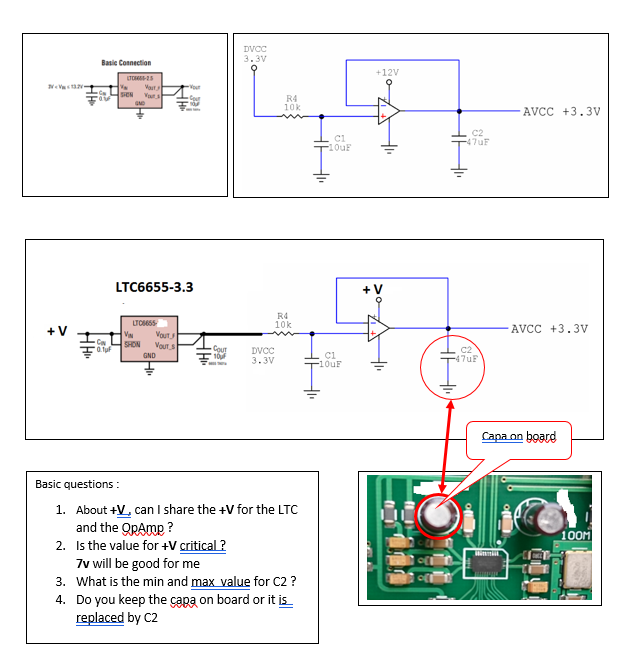

Well, a quick and easy full AVCC schematic could be like the one attached below. However, some of the lines are very thin so it may display most clearly using Adobe Reader.

Hello Mark
I have a few questions can you take a look at the picture
Serge

1. V+ should probably be different. I am running all opamps on +-15 volts. +15 and ground might be okay for an AVCC opamp, but I am not sure about going lower given some issues I have seen with sound quality that I do not yet fully understand. I wonder if the opamp can charge up the output cap fast enough if it does not have enough Vcc available. After all, it can only lower its own output stage impedance between Vcc and the load.
The other issue is that +15v is too much for LTC6655. Please use a voltage that is okay with the LTC6655 data sheet, probably in the range from +5v to +12v.
2. See answer to question #1.
3. Min and max value of C2 according to ESS is 10uf to 47uf. Please read their notes from that I posted or from their downloads page: http://www.esstech.com/files/4514/4095/4306/Application_Note_Component_Selection_and_PCB_Layout.pdf
4. I use the cap on the board to act as C2 because it is very close to the dac pins.
Also, you didn't ask, but
5. There can be only one LTC6655 to be shared by both AVCC channel opamps, but there must be two AVCC opamps, one is needed for each channel. You can however share one R4 and C1 filter for both opamps. Otherwise the stereo sound imaging will not be good. Your schematic makes it look like only having one AVCC opamp is okay, it is *not* okay or stereo quality will suffer.
If you look at the picture of my first dac board, you may notice there is only one filter consisting of R4 and C1. But there is an LME49720 dual opamp, so there is one opamp for each channel, and one AVCC/2 Vref divider for each channel.

Thanks Mark
maybe other people have to try with voltages <+ 12v and good results
Serge

How will they know if they use <+12 for the opamps if they have good results or not? They can only know if they compare by trying +15v too.
And why +15v is the best solution
I told you, didn't I? I found that reducing impedance back to the power supply for my AVCC opamps improved bass. What does that mean? Bass discharges C2, and the opamp need to quickly charge it back up as soon as the voltage starts to drop. But, the opamp output stage is in some ways like a variable resistor. When more current is needed to charge C2 the opamps lowers the output stage resistance allowing more current to flow from +15v to C2. If a little bit of resistance in the wiring can reduce sound quality during that process, so can too little +v. Both small resistance and sufficient +v are needed to charge C2. I am using as little resistance as I can with two very short wires back to 1,000uf filter caps. So, I better keep +15v right where it is and not lower it. If anything I might want to raise it to +17v or +18v.
Okay, I just gave you an unproven theory based on what I observed. I am not equipped to measure anything so I can't be sure. I could do experiments to find out but no time for that. I am retired and this is not my job. What I know works, I told you. That is about the best advice I can give, if you do it that way, it works. If you do it another way it very well might not work so well. Don't know.

Ok this is a good answer .
here the op amp works as a comparator, so it should be fine with Vcc from the input. at least I am running all series regulators in this fashion.
btw, now the AVCC circuit appears pretty much like a series reg: Vref-RCfilter-comparator.
I would ask why you need such an advanced Vref? Perhaps a TL431 would be good enough if followed by RCfilter? Of course, more current is required, so a pass transistor can be added and voltage divider in the feedback. It is important is to keep reverse currents away from the reg, so, another RC at the end. All this will result in low impedance, which more importantly will be virtually constant over a wide frequency range.
I mean something like this, just a bit more filtering: Series regulator using op-amp | Electronics Tutorial
