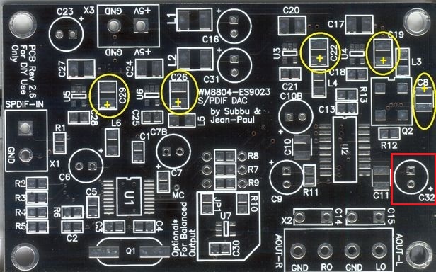

I've to mention that there's a typo concerning C32 : we have to reverse this cap polarity.
In my previous post #140, C32 is soldered the wrong way, it must be reversed.
Attached pic shows C32 correct position on the PCB. (red)
Have a look at the Tantalum caps as they are polarized too. (yellow)
Phil

MISTAKE : From 1st pic Post#140 -> Don't populate U7 - R10 - C30 as it's SE version.
It's my mistake, BTW all SE buyer's have got those parts, useless in building SE version.
Please "Stick to the Build Guide" 😉

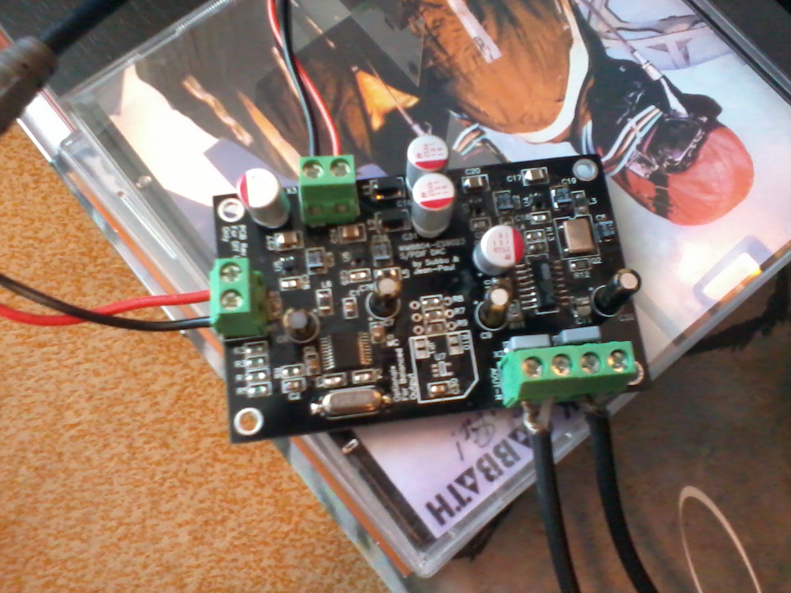

SMD parts populated.
Nothing special, be carefull with C8, must be soldered after Q2.
I've begun with ES9023, WM8804, MIC5205, 74LVC1, followed with 0805 resistors and caps, 1210 caps, inductors, crystal & oscillator, tantalum caps, film caps and electrolytics.
No solder bridge on WM8804 😉
C10 is very close to C10b, you need to bend a little C16 & C31.
That's all, firing on Monday in SE configuration.
Phil
Phil told you before not to solder the caps as a small but effective package is coming your way... Those caps are big: are these the BOM types ?
The following caps C10b - C16 - C23 - C31 are a little bit bigger than BOM's type.
Here's the link : RR71C101MDN1 Nichicon | Mouser
Size : Diameter 8mm x High 11mm but -> very low ESR 7mOhms only
Phil

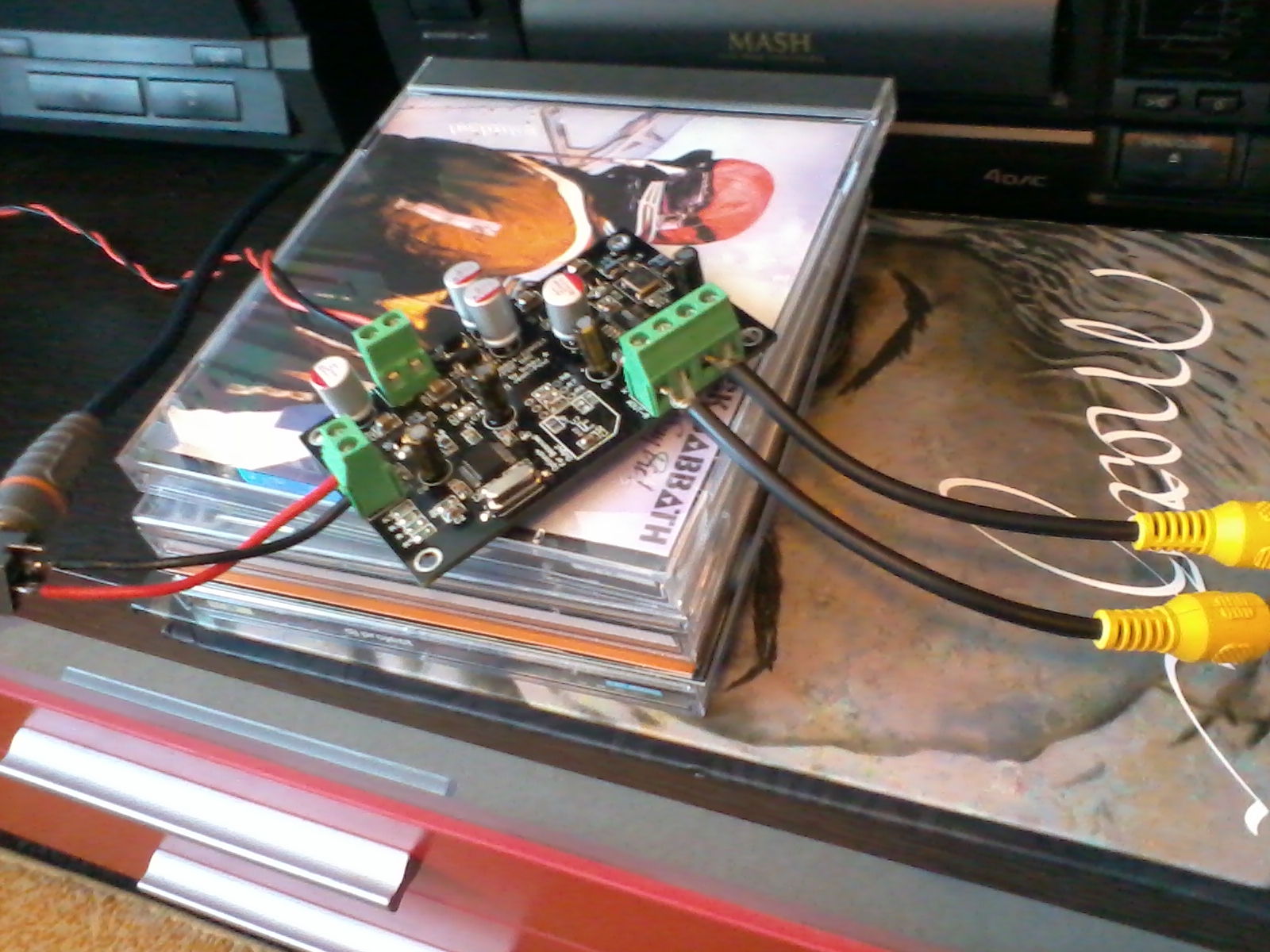

Mine is working and listening to DAC .
Now simple smsp 5V - 3 A , till i finish Salas shunt power source and then waiting for the real power source with lm723.

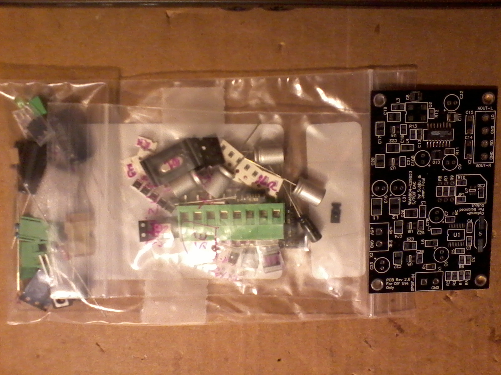

Parts have arrived. Cant wait to assemble it.Hopefully i'll have it working by sunday.Merci Korben

Skouliki, take the time to build it carefully (ESD safe too) and enjoy it and let us know if you like it of course.

I always touch a piece of metal before handling any ESD sesnsitive IC (hope that will suffice). I have a 5v "Black-Gated" Salas v1.0 ready to feed the dac. I am impatient to say the least....

It is a very good DAC and from the start the lower registers reveals very good bass with middle and treble very pleasant and bright .
Next days i will compare with the other 4 DAC I have , after some break in at least for 1 day .
