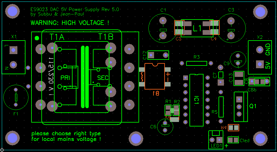

Hello All,
I have been long silent as I had some family emergency to take care and tight work schedule. Waiting for the PSU prototype boards to be delivered to me. Once the design is validated I will get in touch with the group for the final count of PSU boards to be ordered.
I have attached the PSU PCB silkscreen image.
Thanks to all for your patience.
Subbu

Hey I recognize that PCB ! There is a small "peculiarity" on the PCB. Anyone seeing it ?

Yes. And there is also C13 which is not on the schematic either but both parts can be added for those that have "noise paranoia" 😉
Both are not strictly necessary as they are only for testing purposes. I left the footprints in the rev. 5.0 PCB design as they don't hurt. Cled is parallel to the power LED (yes I am a joker) and it can be a 0805 6.3 or 10 V cap in a large value like this one:
http://nl.farnell.com/avx/08056c106kat2a/capacitor-10-uf-6-3v-0805-x7r/dp/1657936
C13 can be a 1210 size 1 uF 25 V cap, it is connected directly from the emitter of the BD140 to GND. Please await validation of the final PCB version by Subbu.

Both Cled and C13 are extra parts, BTW unmentioned in the PSU BOM.
As you say "not strictly necessary as they are only for testing purposes" 😉

Jean Paul gave some crucial informations about following parts type :
1° - C19, C22, C26, C29 and C8 for SE
2° - C19, C22, C26 and C8 for BAL
Those caps must be tantalum (highly prefered), not ceramic as initially mentionned in the BOM...
To make it short : tantalum will avoid MIC5205 oscillations and improve regs stability and BTW DAC perfs.
Bad side for you : more delay... (ordering/delivery delay/sorting)
Bad side for me : more parts sorting, labelling, etc...
Good new : there are some money left to cover the full order.
You'll have some extra parts 1 x 1uF + 4(SE) or/and 3(BAL) x 4.7uF caps per ordered set.
HINT : Old unused C8 (1uF/25v - 1210) could perfectly fit new C13 position 😉 (to be confirmed by Subbu !)
