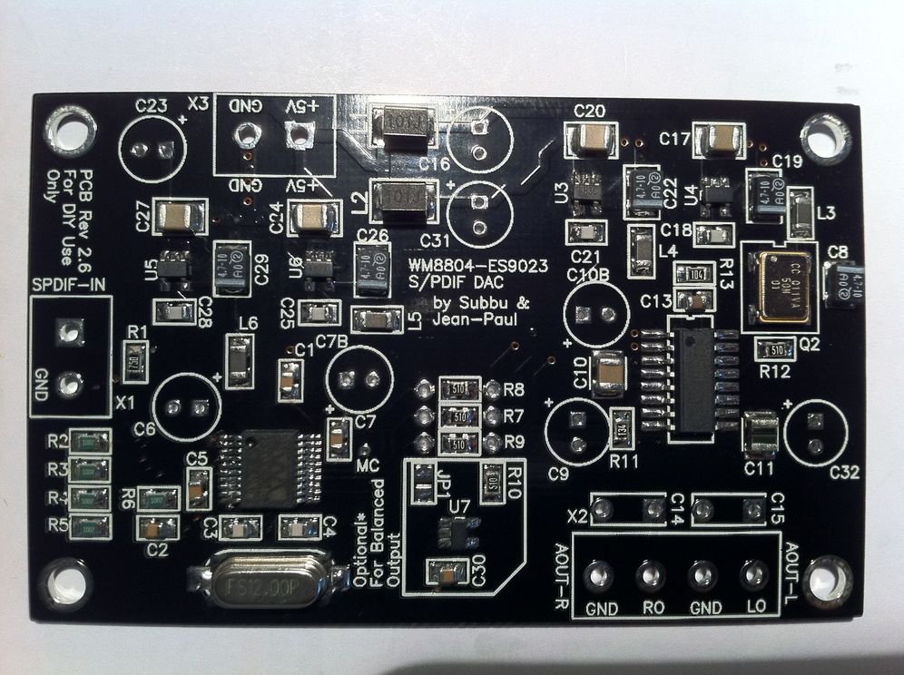

Finally I've received my ES9023 PCBs this afternoon, little boards : 80 x 50 mm only.

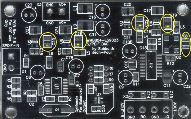

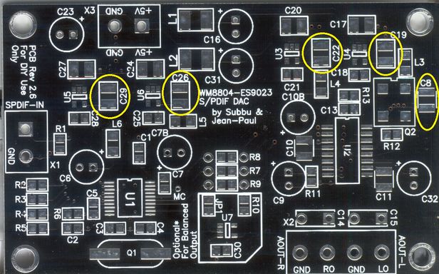

Dear Emeritus would you please point me the correct way to solder the polarized Tantalums caps ?
(C19, C22, C26, C29 and C8 for SE and C19, C22, C26 and C8 for BAL)
I've scanned the PCB and highlight concerned Tantalum caps footprint.
Thanks for your "enlighted" advices 😉

That's correct. If you are in doubt, one small trick (that's what I did) - measure the pads to the ground, there should be continuity between ground and -ve pad.
C8 is after the inductor (L3), so it can be the same parts as in the BOM which is non-polarized. Regardless, the above trick will tell you the correct orientation quickly.

Wrong, C8 was changed to a 4.7 µF 10 or 16 V tantalum cap as the regs don't like too low ESR caps at their outputs. Phil, you are right about the polarity. They are correct in the picture in post #122 but C8 is orientated the opposite way so + to the upper side. Normally I would have orientated all the same way but we started with non polarized caps in which case it would not have mattered.

And the polarity for C8 is ?
Great Jean-Paul, thanks.
BTW the attached pic should be correct.
GB members will receive C19-22-26-29-8 (SE) or C19-22-26-8 (BAL) Vishay/Sprague 4.7µF/10v Tantalum caps, according to ordered versions.

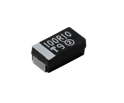

Second pic shows Tantalum SMD cap, white line indicates "+" polarity side.

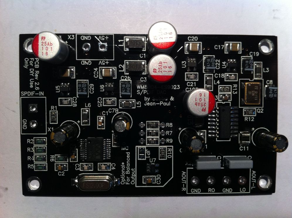

SMD parts populated.
Nothing special, be carefull with C8, must be soldered after Q2.
I've begun with ES9023, WM8804, MIC5205, 74LVC1, followed with 0805 resistors and caps, 1210 caps, inductors, crystal & oscillator, tantalum caps, film caps and electrolytics.
No solder bridge on WM8804 😉
C10 is very close to C10b, you need to bend a little C16 & C31.
That's all, firing on Monday in SE configuration.
Phil
