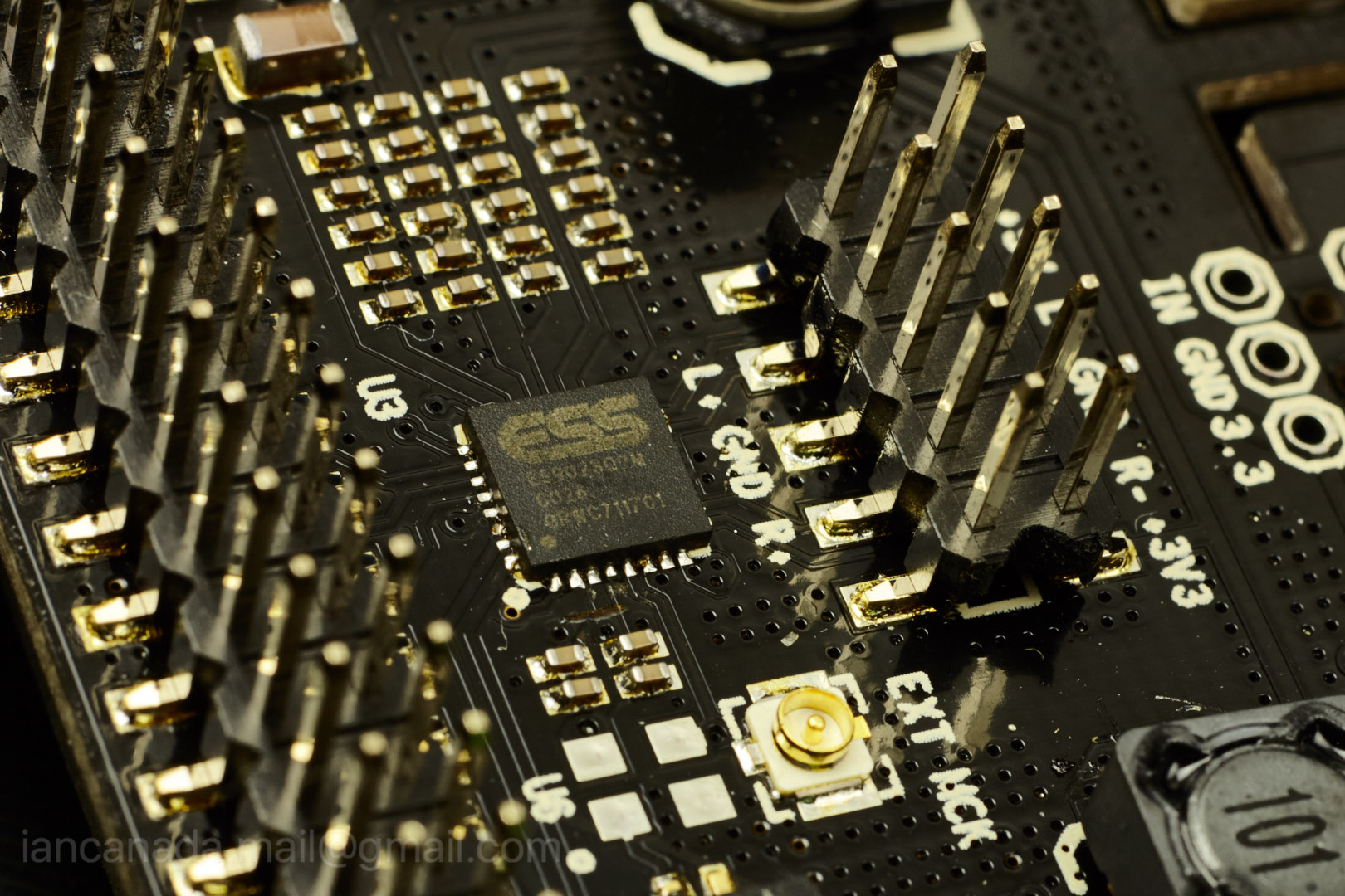

I would suggest you trying my new designed ES9028Q2M DAC HAT. It a very flexible pure 9028Q2M core board with RAW balanced output. Power supplies, clock, I/V stage, controller, configuration, Sync/Async everything can be upgrade. There will be a lot of ways for effort to improve sound quality.
Actually I designed both ES9028Q2M and ES9038Q2M DAC HAT at same time. But ES9038Q2M is only capable output current as half as ES9028Q2M does. So, ES9028Q2M would be better option for a transformer I/V at this point.

Ian, A dumb question because i simply dont know.
What are the perforations on the board for?
They are for reducing the impedance of ground by connecting grounding plates together between PCB layers. We call them vias.
There are also some considerations of high frequency signal integrity, as well as EMC.
