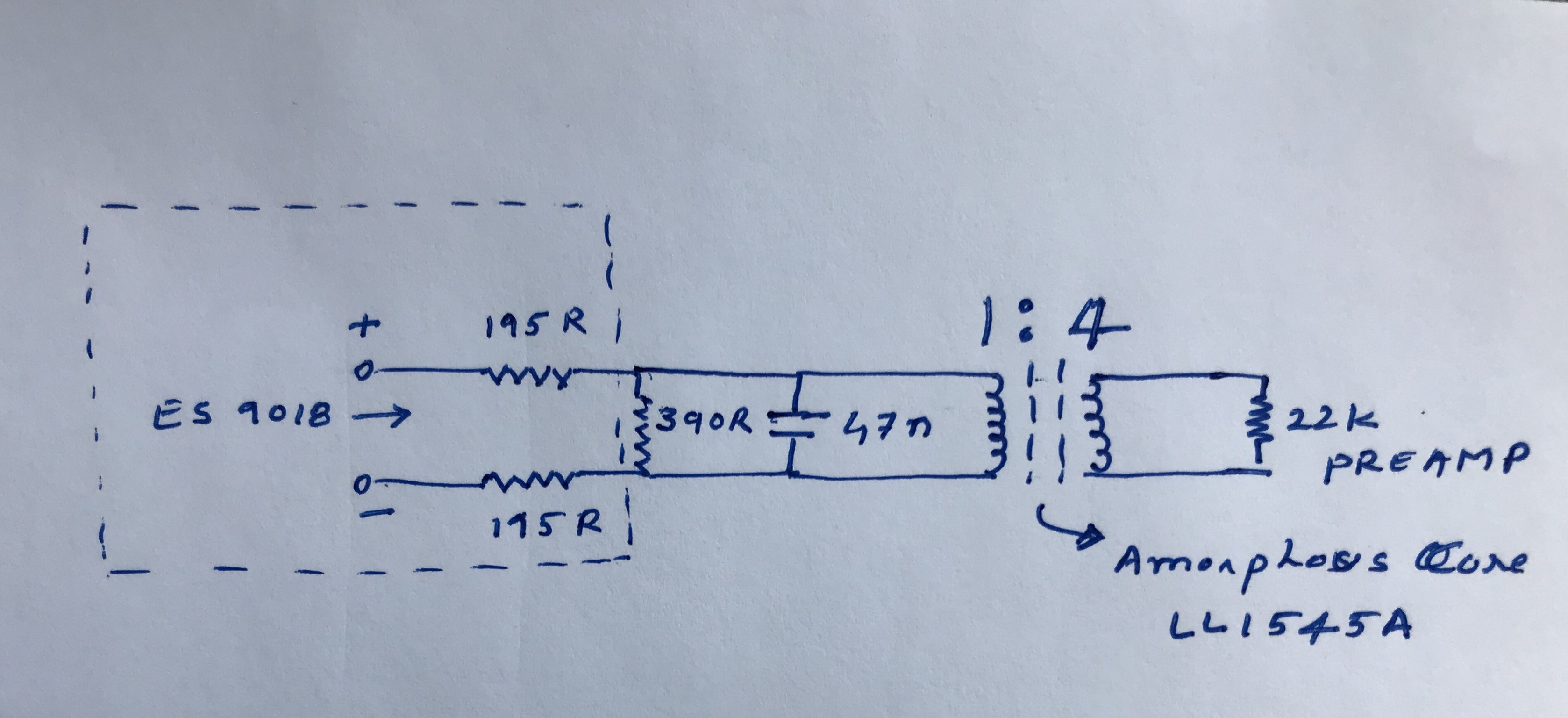

Thanks madds1,
That's great. Do you have some details with schematic?
Ian

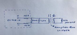

At work so I just drew it up to give you an idea.
The drawing and the my post above say LL1545A. Thats a mu-metal transformer. The one I like better than that one is 1544A which is amorphous. That is what I am using. Apologies for the confusion
As an aside - mu-metal core sounds thicker and has more body than the amorphous cores. Slightly less details
Thanks madds1, you approach looks nice. What's that 47n cap for? Dose it improve sound quality? what kind of cap did you use?
Both your LL1544A and my LL1674 are amorphous, right?
For ES9018 DAC stereo configuration, the internal resistance is 195 ohm. while ES9028Q2M is 403 ohm, ES9038Q2M and ES9018K2M are around 800ohm. So, the 390 ohm resistor need to be increased I think?
BTW, what kind of resistor did you use? Does it affect sound quality much in your test?

The 47nf cap creates a corner 3db point of 23K without the preamp secondary impedance reflected to the primaries and 20K with it reflected. But that is not the reason why I have the cap. I discovered the effect of a cap across the legs on sigma delta DACs nearly 3 years ago by accident. I reported in the these posts
http://www.diyaudio.com/forums/digi...native-post-dac-filtering-11.html#post4445352
http://www.diyaudio.com/forums/digi...native-post-dac-filtering-11.html#post4445577
That thread was started by a member who also noticed the same effect. He unfortunately got flamed for reporting it without adequate explanation. The effect is that is creates is a layering of instruments that makes listening to music - emotional.
The oldest reference I can find to this effect is here
http://www.raylectronics.nl/pdfs/Mauros_CD6367_tweak.pdf
Regarding the transformers - yes LL1544A is amorphous too. Nearly $85 in the US vs LL1674 which is $130
The resistor value to be chosen depends on your taste. Put simply - the deeper you put the DAC into current mode (by lowering the resistor) - the THD improves. At 0 ohms - the THD is the best.
But in all honestly - I can't hear THD in my system below -105db.
But I what I can hear is that the slam/attack/dynamics are lost deeper in the current mode.
The optimal value for the resistor is 4/5 times the output impedance of the DAC for my system. So 640 ohms for ES9028Q2M.
I have a modified IRAUDAMP7S driving a highly modded Magnepan 1.7. Preamp is a poorly biased JFET that creates a 2nd order harmonic at nearly -80db. I have been told 2nd harmonics change the tone but I perceive it more as body to the music. LPs naturally had this and Tapes had tons of 3rd harmonics
Sorry for the long reply. Hope this helps

Hi madds1,
That's very helpful. Thank you so much.
It seem's I should buy a pair of LL1544A to give it a try. I mainly use balanced output, is there any problem?
I still have some PCB available for the transformer I/V. I'd be very happy to share with you if you want to try something on it. DAC will be available later. Please let me know.

I think Madds1 circuit is voltage mode? While with low value resistor to ground will run dac in current mode.
Yes, I use a capacitor directly after the DAC as well.
I don't believe that it is doing anything magic, but rather it acts as a functional low-pass filter to remove the very high-bandwidth transition artefacts generated at sample boundaries.
These transition are likely to extend into the 10s of MHz region, or even higher, and may well cause problems with op-amps in the I/V or any subsequent gain stages.
The need for such a filter was explained at least 20 years ago by the famous Dr Hawksford:
Dr MOJ Hawksford -Transimpedance Amplifiers
See section 5, page 21
On account of the bandwidth, the capacitor used in this position should be a surface mount type. The leads and general construction of through-hole caps will have enough inductance to impair the filtering at such high frequencies.
22-100nF are easily available in C0G 1206 ceramic caps, and these would seem to be first choice, although the polyphenylene sulphide [PPS] dielectric of the Panasonic ECHU (surface mount) series are also worth trying. Both of these should be soldered with extreme care, if using an iron - the damage caused by overheating is not easily visible.

Yes, I did see that thread and have thought about it from time to time.
But one thing can be cleared up immediately: if you connect the capacitors to ground, I would expect a degradation of the sound.
Why? because connecting them to ground will cause the noise-currents to circulate into ground and contaminate some of the most sensitive nodes in the whole playback chain.
The bandwidth of the noise can reach into the VHF region, and it will not follow the paths that you intended!
The best to deal with this noise is to connect the cap across the DAC-out phase and anti-phase, which gives the best chance of a short and direct path for the currents.
Beyond that, anything that increases enjoyment should naturally be put to use 😉
Make sense 🙂
Ian
