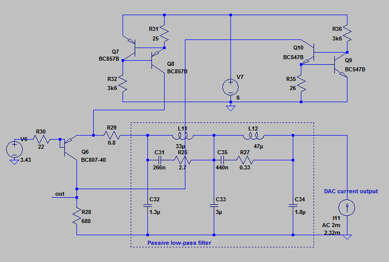

Hi Abraxalito,
I don't want to make a oven. So, I'm more interested in your approach. Do you have more information about your IV "with much lower quiescent currents and much lower supplies" ?
There are thousands of different kinds of MOSFETs, but most of them are targeted switching mode, even the one you mentioned SSM3K339R.
My question is that, according to what specification you chose MOSFETs for this kind of audio applications? High gm? Linearity of Vgs-Id curve? Or, something else?
Ian
Hi Ian
I've attached a schematic showing the output stage I'm using in my latest DAC design. This illustrates the idea - the I/V transistor (BC807-40) needs to run at a substantial bias to present a low enough impedance to the passive filter (around 2ohm or so in this case). It could just as easily be a MOSFET as a bipolar, I'm using a BC807 for cheapness. However no MOSFET has as high a gm as a bipolar, the K339R comes about the closest I've seen, about half as much transconductance. It therefore needs higher bias currents from the CCSs.
The reason this circuit doesn't dissipate as much power as the NTD1 does is that the whole of the bias current isn't run through the I/V resistor. If it were, the supply voltages would have to be much higher. Instead the current is 'bled off' via a current source across the resistor.
As for the choice of MOSFET - its about gm primarily, coupled with not having too high capacitances. MOSFET capacitances are quite non-linear so will contribute harmonic distortion which rises with frequency.
Hi Ian
Thanks Abraxalito for the schematic, it's a very smart design. Looks fantastic.
Does it use single supply? Do you have simulation result? Thant will be much help for me to understand the principle.
Thanks again.
Ian
Thank you!
Yes it does use a single supply though that entails using output capacitors as the output has a half-rail offset. Or with a negative rail generator (say ICL7660 or similar) the offset can be taken down to a much lower level.
Simulations I've done for the frequency response and I've built a few and measured frequency response and THD for a sinewave input. THD performance isn't stellar as you'd expect for such a simple circuit. It reaches around 0.2% THD (2nd and 3rd harmonics predominantly) at high frequencies (5kHz say). There are ways to improve on this - a cascode arrangement will help.
