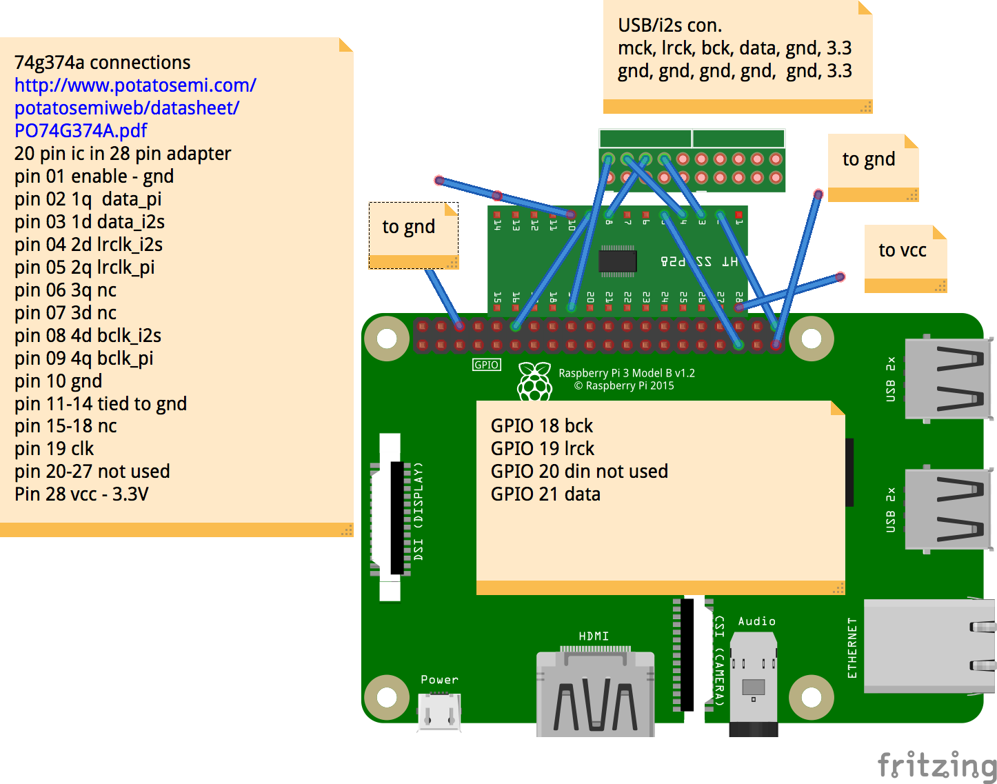

Does anyone know if Ian’s Rpi dac board can be used independently from the Rpi as a usb Dac. Thinking of using the IsolatorPi fed by a Amanero or similar into the U.FL out connectors as these seem to be connected to the isolated 40 pin Rpi header?
If that makes any sense can the FifoPi and ESS controller also be used or do these need the Rpi?

I connected a diyinhk board to a fifopo then dac. diyinhk board replaces a pi in my current setup.
XMOS 768kHz DXD DSD512(DSD1024) high-quality USB to I2S/DSD PCB - DIYINHK
The drawing also shows a 374 ff which reclocks the signals with masterclock just before I feed them to the fifopi. Should work without the 374, but that is what I did. Just keep the i2s wires short.
The u.fl are fifopi outputs, so you cant use them for this.
I wired into the 40 pin pi connector on the front of the fifopi. I put a 40 pin male header into a small piece of vectorboard. Wired this to the 374/diyinhk board then plug into fifo pi.
Will post a pic later.
