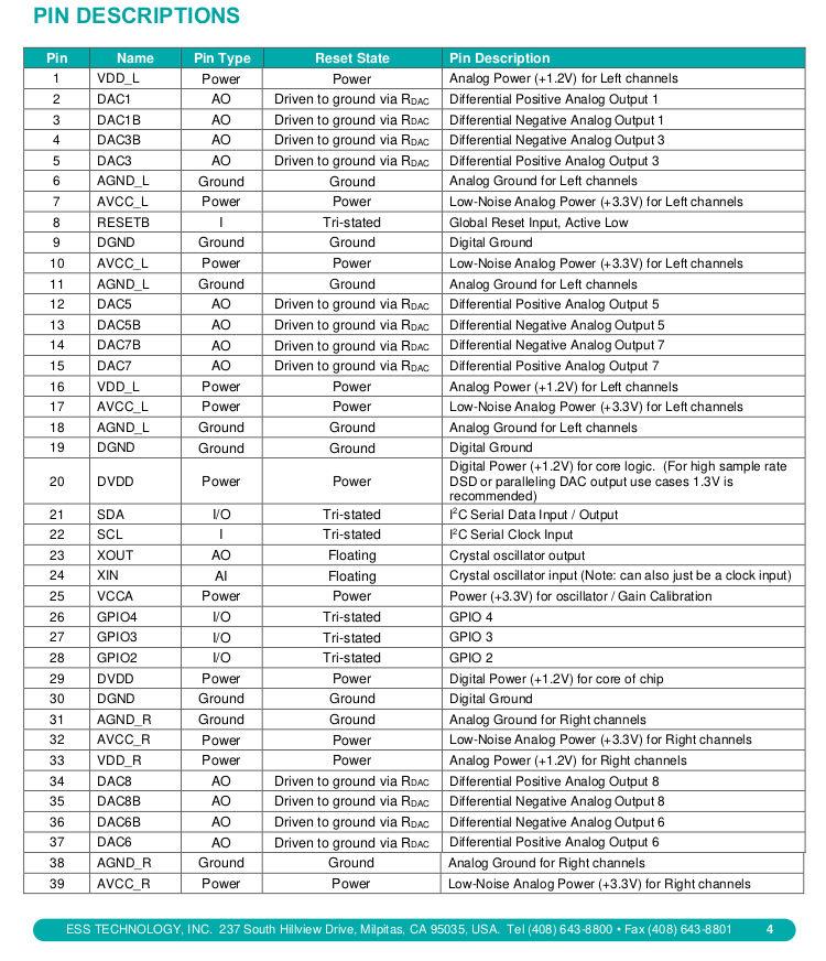

Its AVCC that one would use an opamp buffer supply for.
The other two rails, VCCA and DVCC require very little current although ESS does not specify it under all operating conditions. Best if the two are kept separate if possible. Low noise LDO regulators work just fine for them. Perhaps of some importance is to use R-core transformers for all power supplies since they are best in terms of minimizing coupling of AC power lone noise into critical power supply grounds. One of the reasons people use batteries is to avoid problems like ground coupled noise from the power lines, so wise to keep it to a minimum if using power transformers.
What are the current demands of the 3 rails of the dual mono dac?
I would like to try Salas Reflektor D. I have an op amp based pse for AVDD so what should I set the CCS to for the other 2 rails?
All of them are below 100mA, so I don't think there is any problem with Reflektor D. Set you CCS to 150-300mA would be pretty safe.

If we put two DACs in parallel, the output current will be summed together.
Let’s take ES9038Pro for example:
The DNR of ES9038Pro is 137dB when it’s configured in stereo mode. But when ES9038Q2M is configured into dual mono mode by paralleling both left and right channels together in each DAC chip, the DNR will be boost to 140dB. 140db equals exactly to 137dB + 3dB.
Now we know why sound quality can be significantly improved by paralleling DACs.

Just one question. From the spec sheet the 9038Q2M in dual-mono (2CH in parallel) mode has
Output impedance: 387 ohm
DNR differential current mode: 132dB(theoretical)
THD+N differential current mode: -120 dB
The 9038Pro in stereo mode (4 channels in parallel) however has
Output impedance: 50.5 ohm
DNR differential current mode: 137dB
THD+N differential current mode: -122 dB
4 CH in parallel
How did you arrive at a DNR of 140db?
