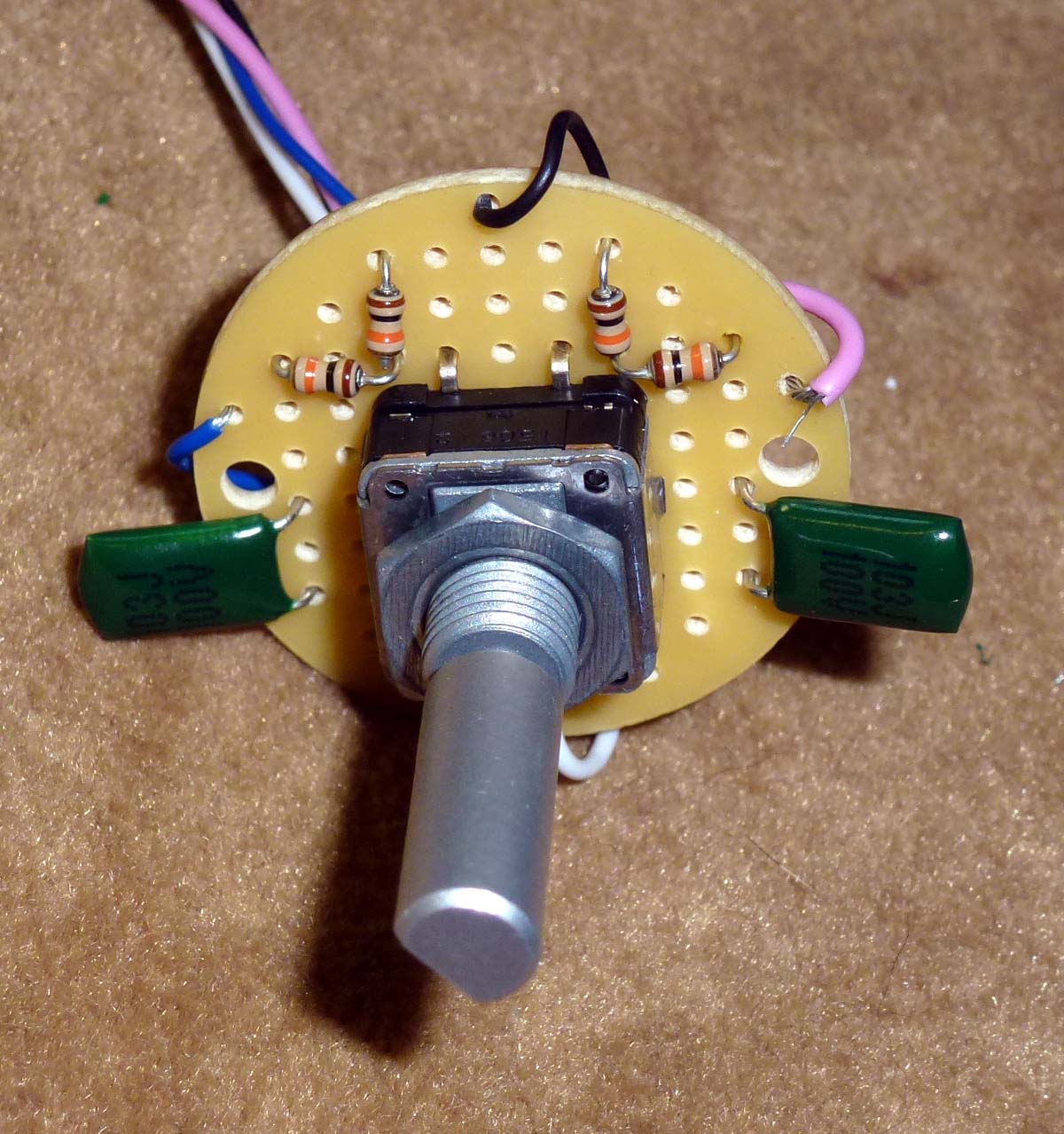

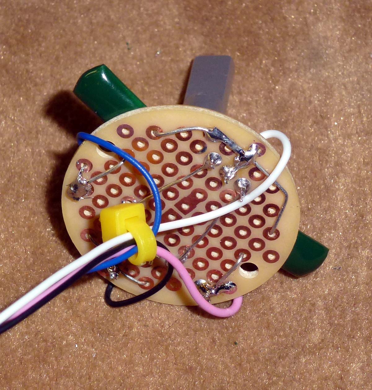

I have hardware debounce ready to go. This is per glt's helpful diagram. The next picture of the new encoder will have holes in the PCB for them mounting lugs. So when you tighten the nut while holding the circuit board, the encoder doesn't turn.😱 Fortunately I left my other software debounce encoder intact.

The new encoder arrived yesterday! First thing I did was drill two holes in the PCB for them two lugs on the switch body. Now it won't twist when I hold the board and snug the nut. I am using the Panasonic EVQ-WTEF2515B rotary encoder that glt suggested.
I disabled the pull up resistors in the Arduino by setting the appropriate two lines of code to LOW. I reset switchbounce interval from 250 to 200. Hardware debounce works better for me. Better control. I get less overshoot, ghost changes, when turning the encoder. With software debounce, after I made a change to a menu setting sometimes it changed back to previous setting even though I didn't turn the encoder another click. I’ll stay with hardware debounce.

I'm using the exact same encoder. Two new encoders just arrived some days ago. I never experience any ghost changes when turning the encoder, but that doesn't stop me from using the hardware debounce.🙂

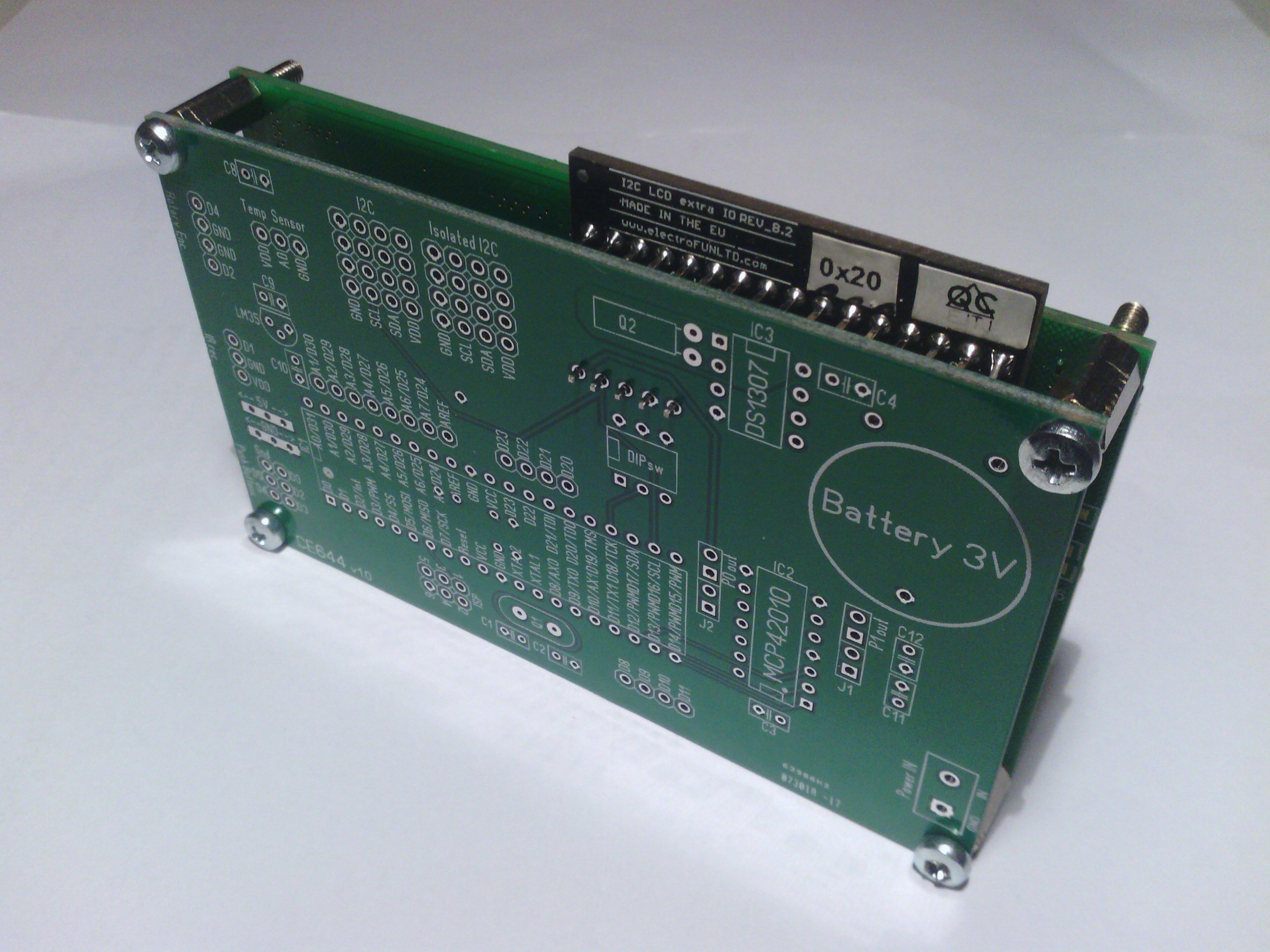

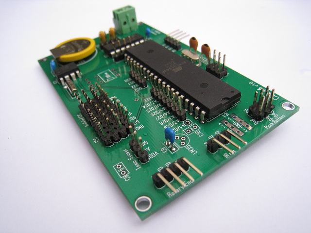

Et viola! The PCB is here......finally
It took a real long time before the mailman showed up with the Prototype PCB. I almost gave him a hug when he handed over the small box from China. :hug:
I did a quick check on all connections and all looks fine at first sight.

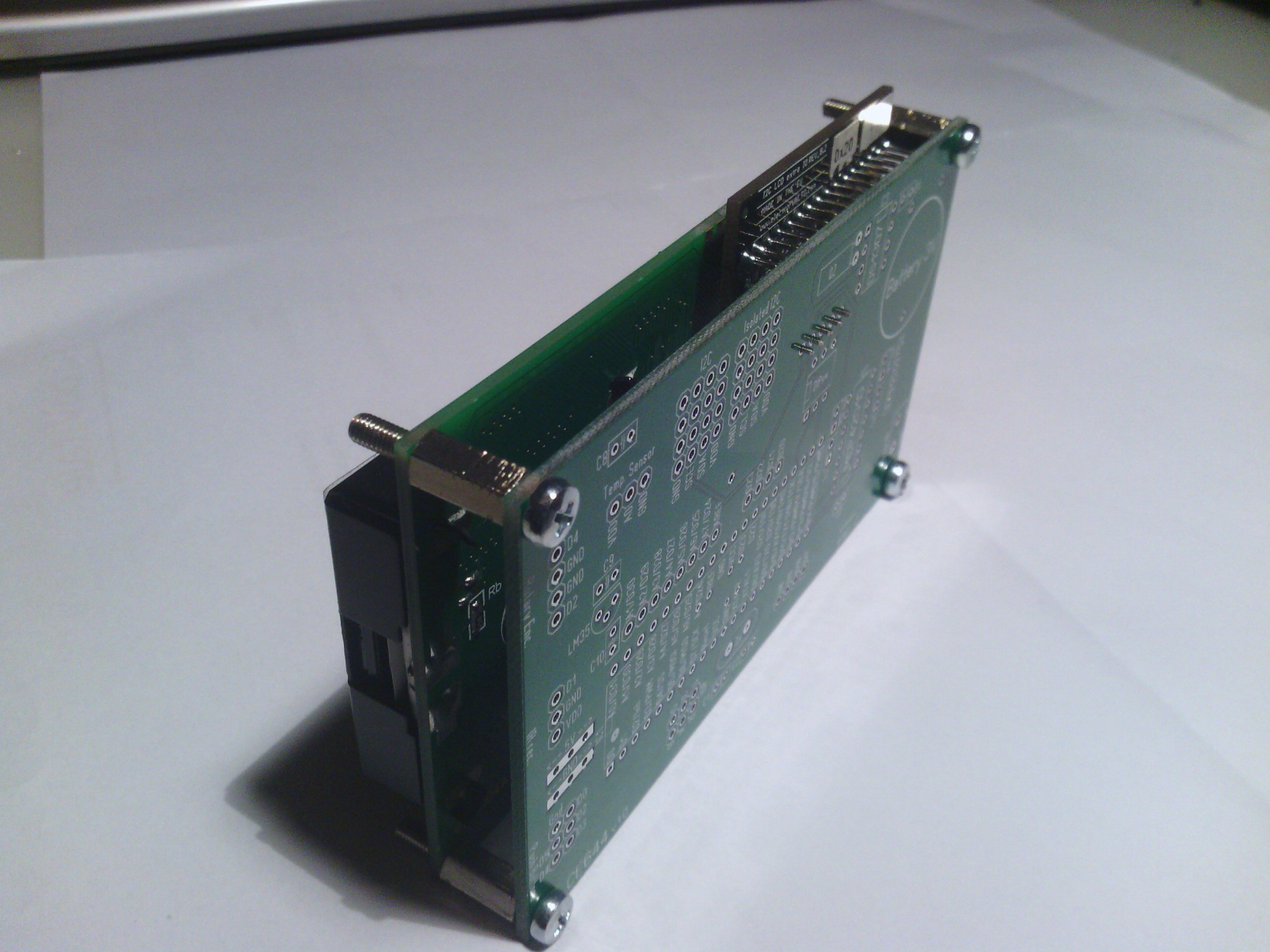

It fits exactly on my 20x4 LCD and the pins of the 'I2C LCD extra IO' do line up perfectly with the connector pads. Time to do some prototyping tomorrow.
I also have to do some more programming, but most of it is done by now.
Here are some 'showcase' pics of the PCB mounted on the LCD display.

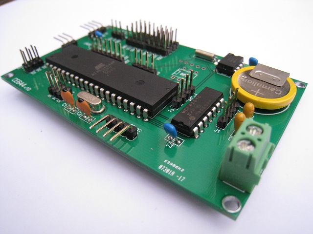

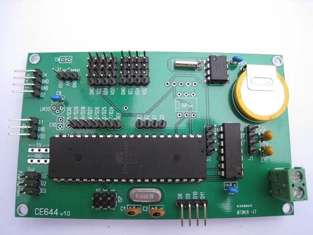

I populated one of the boards today to test if no mistakes where made in the design. All components fit nicely,exept for the 100nf caps I had at home. The pin spacing for most 100nf caps is a bit wider (5.04mm) than the distance between the holes (2.52mm) for the caps. The pins of the caps I had at home needed to be bend straight in order to fit in the holes, but 100nf caps with a pin spacing of 2.52mm can also be bought 🙄
I had ordered the wrong package LT1086, so this is not used yet. The meant that I had to power it by bypassing the power input. I used an Arduino for this. All works just like it has to. Now to add the temperature sensor and DIP switch. I decided to use to DIP switch to lock the volume control enable/disabled setting, Stereo/Dual Mono setting and output phase setting. When the switch is set to ON the corresponding setting can't be accessed in the menu. This safety precaution is especially useful when having children around or a wife that is not that confident with electronics or.... to protect it from yourself :scratch1:
I also need to finish the code, It's still not finished because I think of options and setting to add or enhance about every two days. I hope to release the first version next week.

Very nice. It looks like it will be possible to have a very tidy cable layout. Nice and tidy control solution that fits the rear of a 20x4. Very nice 😀:hohoho:
I like the idea of locking the settings that can harm the system as well. Less likely that there will be any mishaps 🙂
