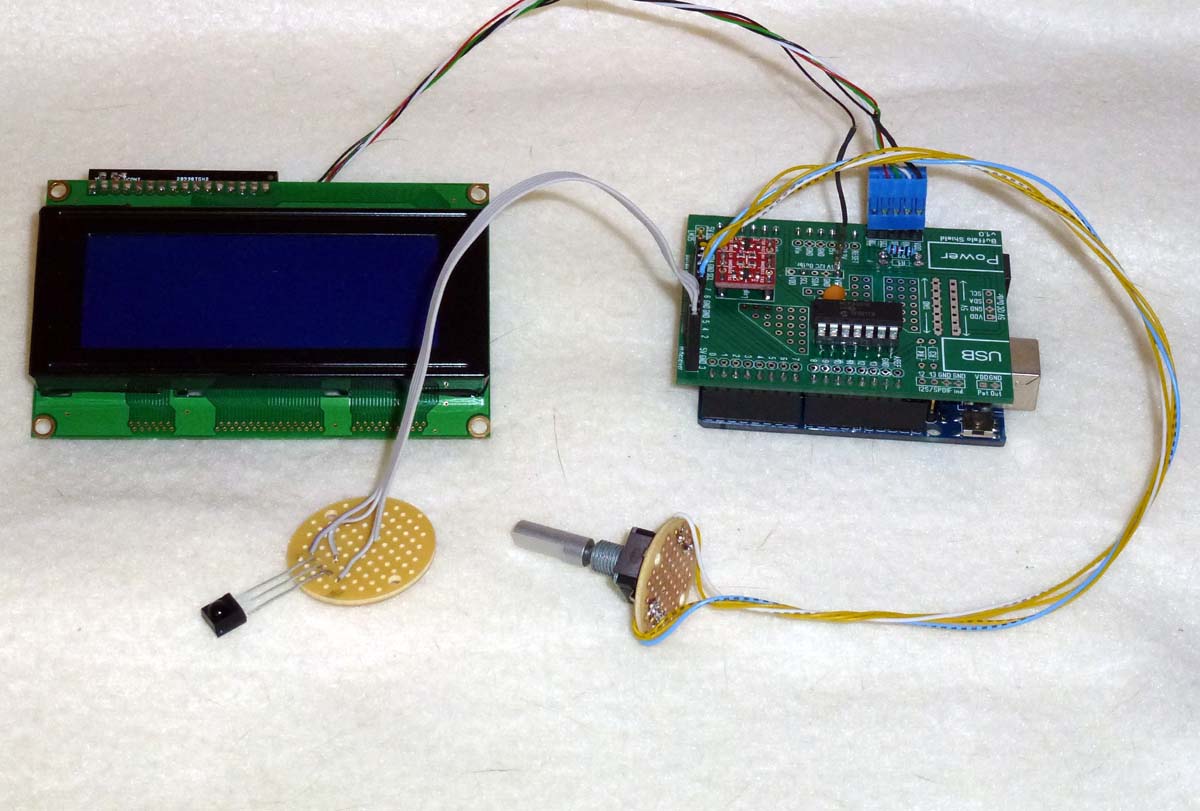

Great work Corpius! Anxious to see your finished project. If it wasn't for you sharing your code I would not have gotten my dual mono BIII project to work with Arduino. A big thanks to glt at HiFiDuino for starting it.

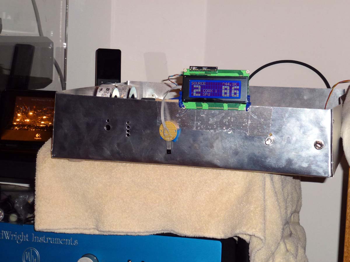

Here is my progress with your Buffalo Shield Corpius. It sure makes for a neat and clean install! I am also using the electroFun I2C LCDextra IO board you suggested.
While not pictured I recently added the temp sensor. A proper enclosure is in the works at modushop. Currently the BIII in is my friendly case...it waves at you.😀
Thanks! All credit may go to glt for the code! Nice to see the Buffalo shield!Great work Corpius! Anxious to see your finished project. If it wasn't for you sharing your code I would not have gotten my dual mono BIII project to work with Arduino. A big thanks to glt at HiFiDuino for starting it.
On the controller is also room for a temperature sensor, but there is also a separate connector to allow it to be placed elsewhere in the case.
btw Love your friendly case
Cool wobbly case SCompRacer 🙂 Looking forward to seeing your new case.

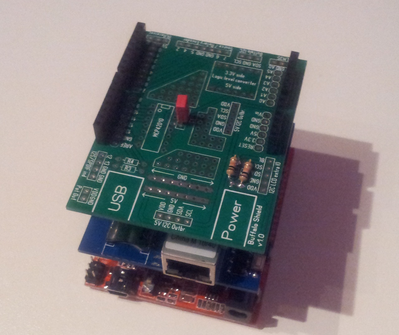

The PCB for the prototype is being manufactured this very moment. 🙂
Although i changed a few part, the designs as seen here has not changed.
Now I can focus on the add-on boards while I wait for the PCBs to arrive. First ones will be the rotary encoder and push buttons add-ons.
There will be five push buttons on the add-on board for the following functions: up, down, left, right and select.
There rotary board will have the debounce circuit resistors like glt suggested earlier on. I'm not sure about using a debounce circuit for the push buttons. It is easily done in the code, just as for the rotary encoder. I'd like to hear how some of you think about using a decounce circuit for the push button. Personally I like the idea of cancelling possible noise wherever/whenever possible.

That is great. Great idea with the buttons btw. Should be very nice. Debounce could be a good idea on as much as possible. Not sure how much effect if has with the hifiduino code, but with your altered code I dont think the software debounce is there on those spesific function buttons?
There is debouce in my code. 10 ms for the push buttons, but the buttons for volume control react better/ more natural with a delay of about 80 ms. For input selection I included even a longer delay, 500ms....but with your altered code I dont think the software debounce is there on those spesific function buttons?
Ok. I am looking forward to testing this with button control instead of the rotary encoder.
