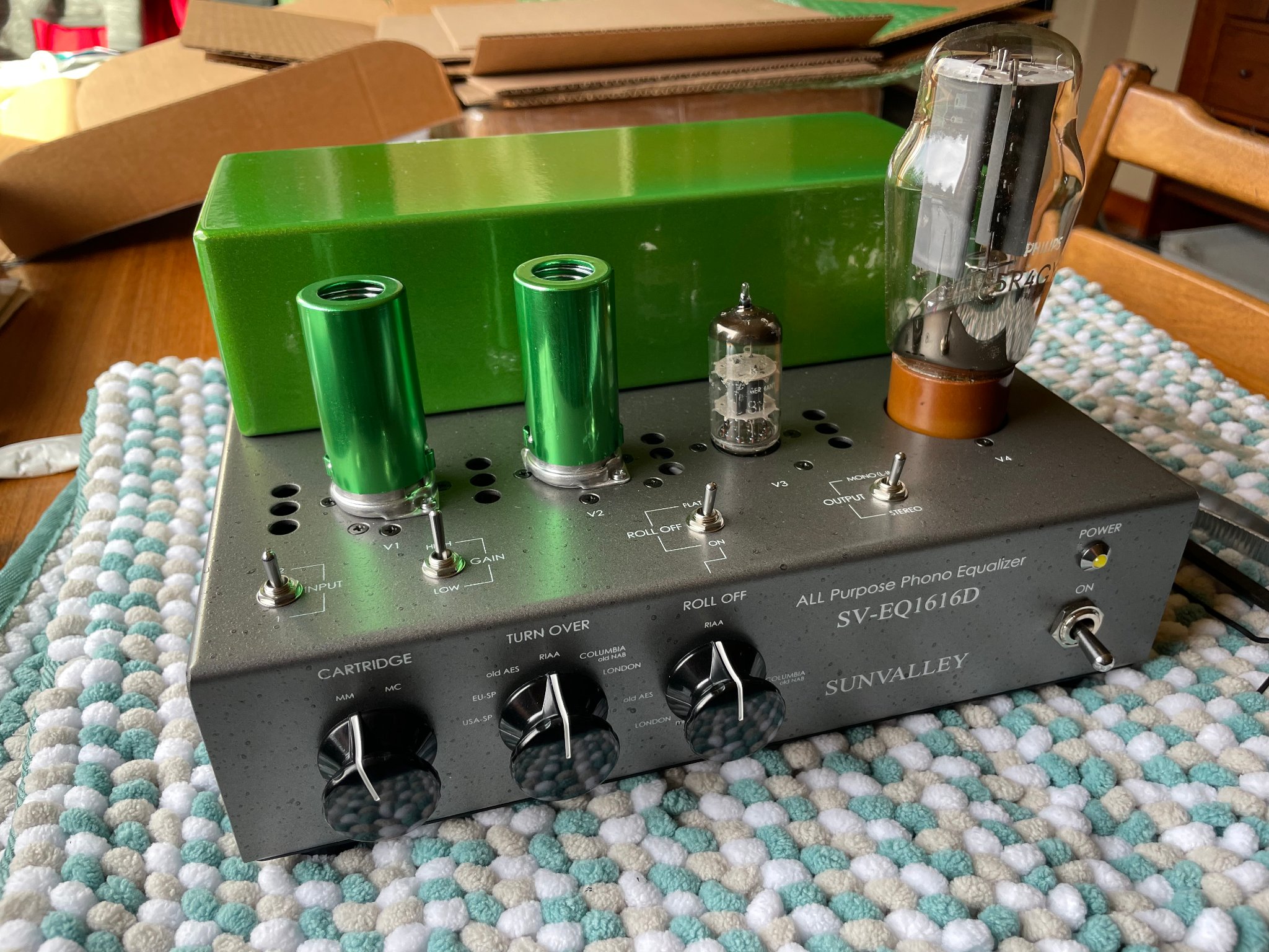

I've been loving my Sunvalley SV-EQ1616D phono amplifier and decided to do a little something to make it more mine. A quick trip to the powder-coating shop with the transformer cover and some anodized tube shield from Antique Electronic Supply have added a little zing.
Now, if I could figure out how to get the control knobs off, I have some nice green anodized knobs to add the finishing touch. I've removed the set screws but the knobs are so tight on their shafts I've pried as hard as I dare without getting them to budge.
Any ideas?

Well, that was easy. I didn't realize that each knob has not one but two set screws, about 90 degrees apart. So, with each set screw backed out, the control knobs slid off easily.
Here's the (almost) finished facelift:

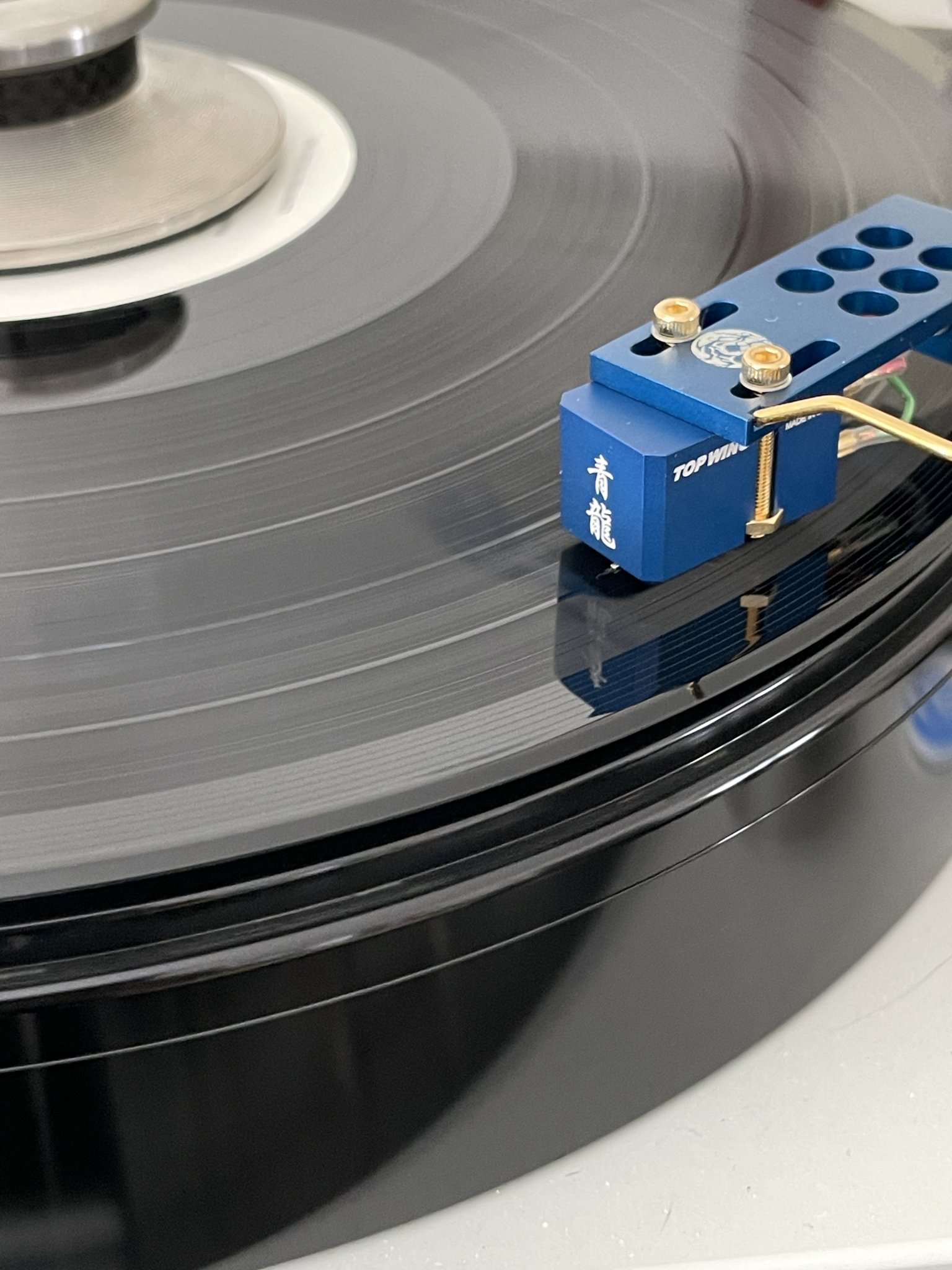

Thank you Mr. Ohashi sent me a Blue Dragon - Seiryu Cartridge few month ago
Finally I installed this new toy in my T/T few minutes ago. It is good. to work with LL1931ag and EQ1616D

Cartridge : Coreless straight-flux cartridge Seiryu (Blue Dragon)
Tone Arm : SAEC WE-4700
SUT : Lundahl LL1931Ag
Phono : EQ1616D
Amp : Sun Valley SV1645
Speaker : AER Excentre
