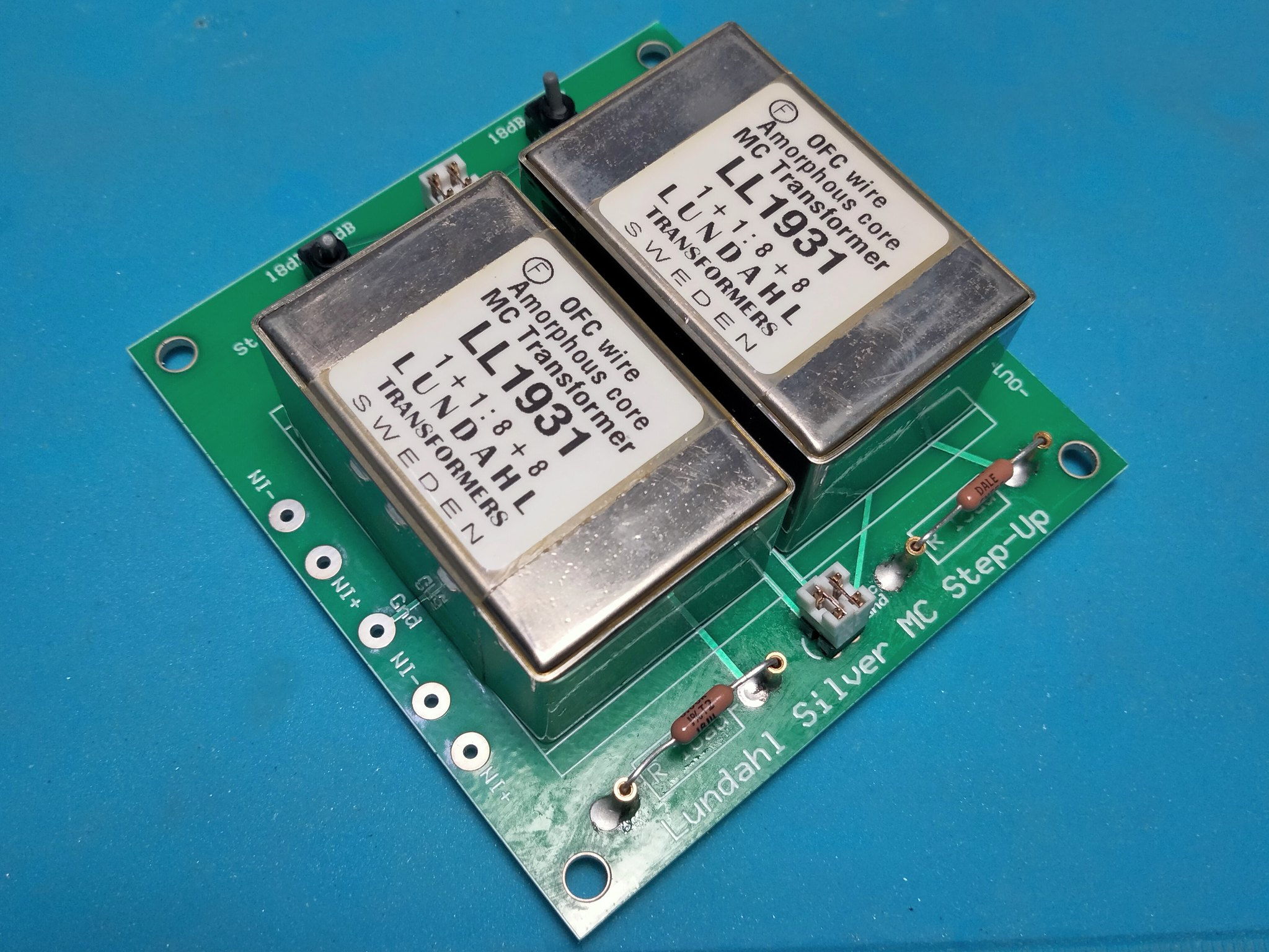

For MC, we use the loader resistor of the SUT to match the impedance of your cartidge
The bown color dale resistor is a 1% loader resistor to match your cartidge

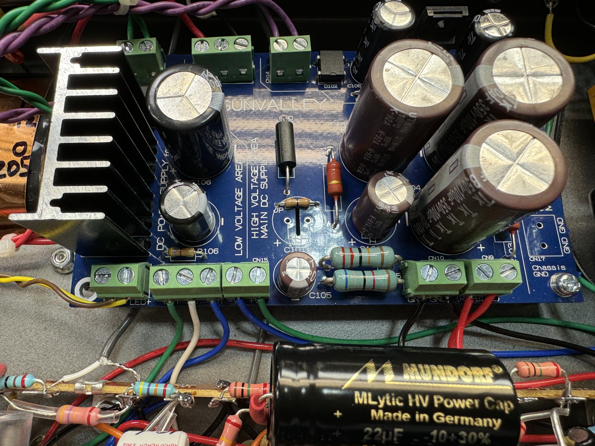

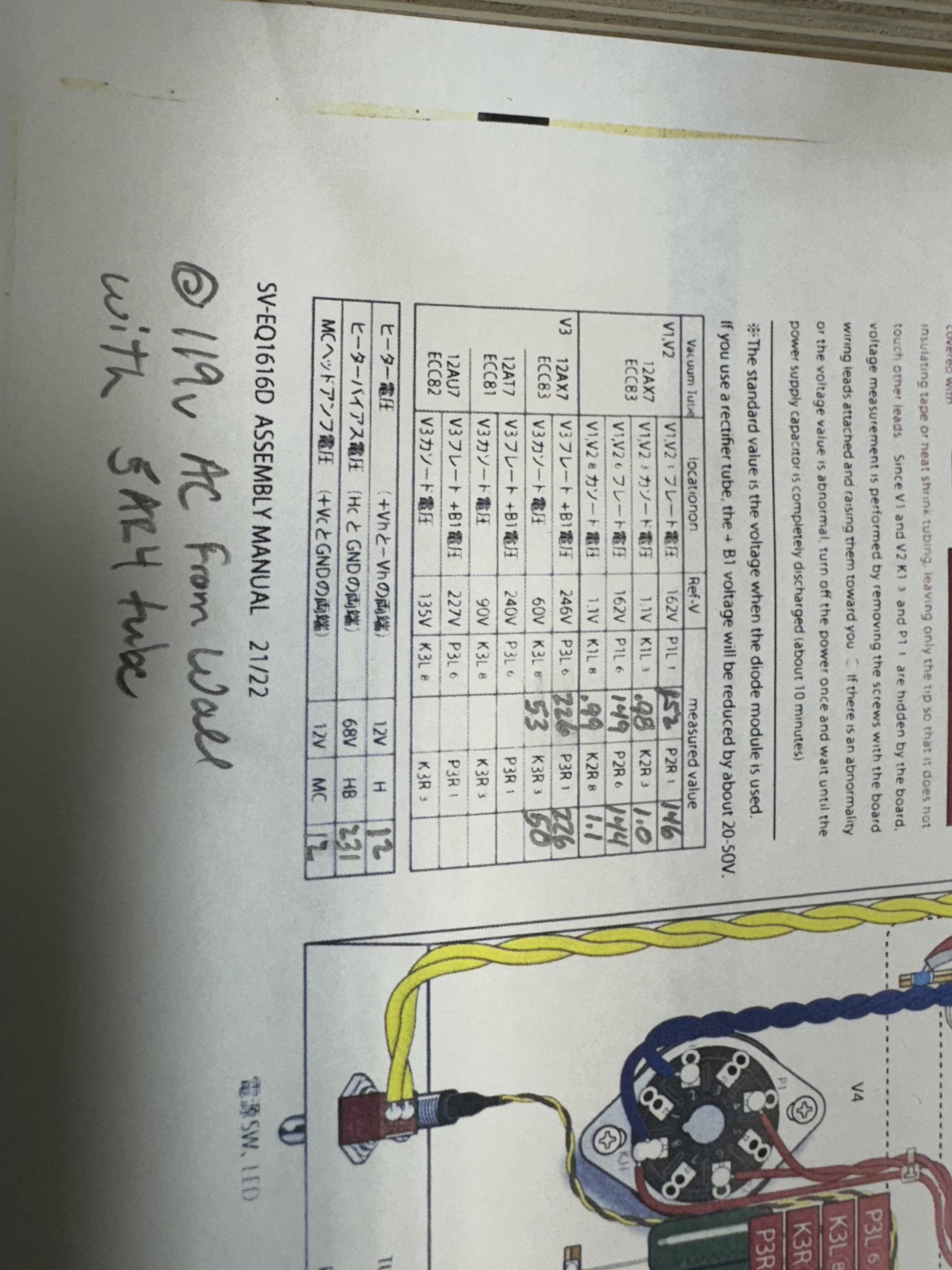

Hello - I have completed the build of my EQ1616D phono and I am getting a single voltage reading that does not match the check sheet (HB gives me 226 vdc instead of 68vdc). I have double checked all connections and solder joints, and I don’t appear to be missing any components. I have checked resistors values as well (you will notice I used different brands than supplied in the kit). I am at a bit of a loss here and any help would be appreciated.
I have checked voltages with wall Vac @119 and using a recent production 5AR4 (GZ34) tube.
The wire off of the HB test point goes to pin 9 of V3 (then pin 9 V2 and V3 serially). Unless I am wrong this is the heater center tap and used when wiring the filaments (pin 4 and 5) in parallel. So, I tested between pin 9 and pin 4 and got 6.0 vdc and between pin 9 and pin 5 and got 6.0 vdc. This seems correct, but on an elevated DC baseline of 226vdc instead of what the manual says should be 68vdc.
I also measured the equivalent of these at CN11 on the PCB and got the same values 6.0vdc between HC and +Vh (and -Vh).

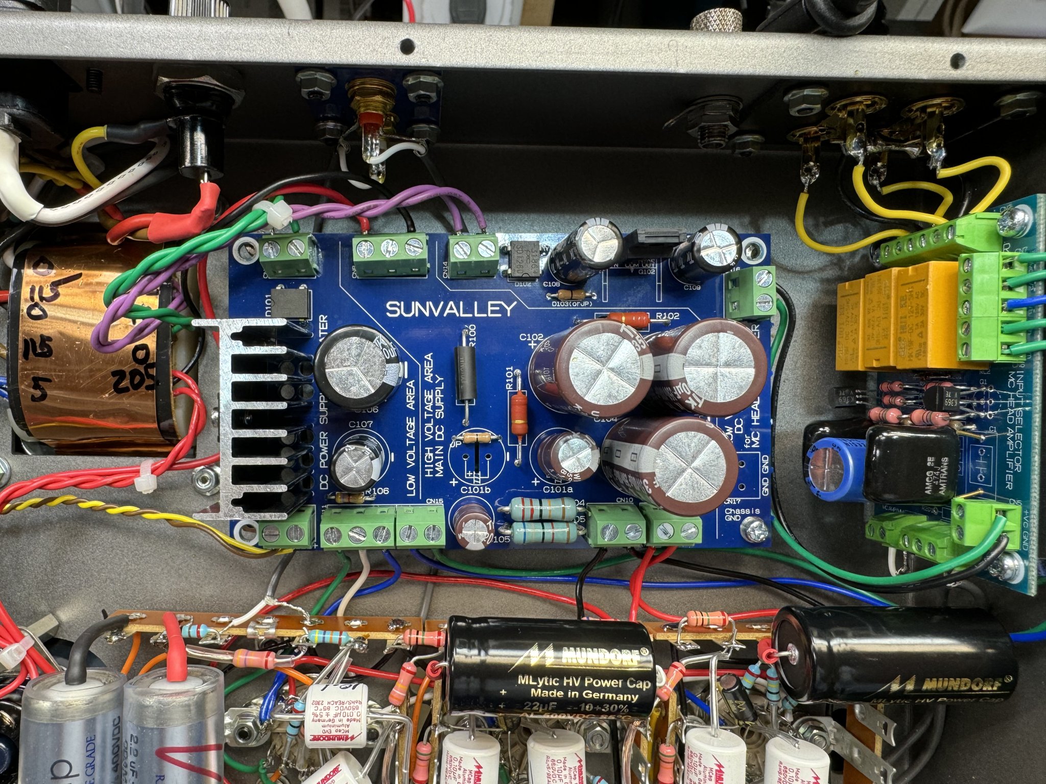

I followed page 4/22 of the assembly manual (the schematic page). And tested each section between the rectifier 5vac connections to the v3 pin 9 (and 4 and 5) and the numbers seem to be correct.
A) The 5vac secondary (blue wires to rectifier) give 5vac, 12vac secondaries (green wires and purple wires from transformer) give ~13vac at AC2/AC2 and AC3/AC3 connections, respectively.
B) B0+ measures 280vdc (btw the red and black wires) at CN8 on the PCB
C) B1+ measures 226vdc at CN9 on the PCB
So, it appears that my reading at checkpoint HB is the same voltage as B1+.
Any thoughts of what is incorrect or what else I can check?

Since the HB voltage is almost equal to the B voltage, one of the following parts that divides the B voltage is suspect.
(1) R105 (68kΩ/1W) is not conductive due to bad solder.
(2) R104 (220kΩ/1W) is shorted due to use wrong resistor ( with a low resistance (2.2kΩ or so) )or solder bridge.
