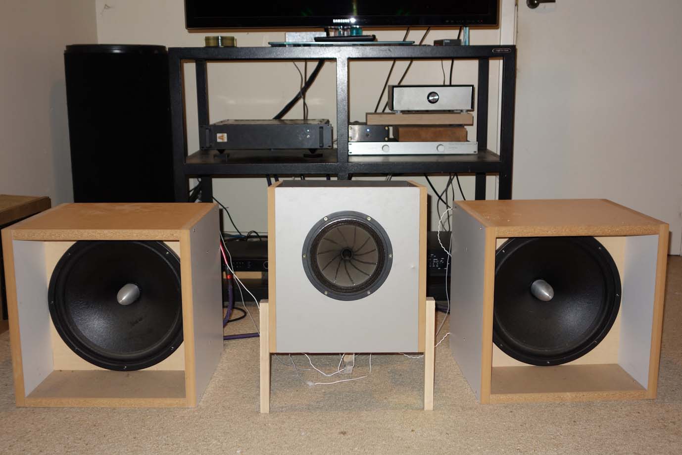

Ok, so spent a weekend mussing around with this concept. And it works! But with riders, though isn't that always the case?
The psychoacoustic circuit is necessary, no doubt.
And the sound? If you've longed for a stable soundstage no matter where you are in a room, this is the stereo system for you. For those who mock without trying it, don't. You can move from one end of a sofa to the other and the image is utterly constant.
Glad to hear you got it working well for your purpose 🙂
Your comments about the sound I feel are exactly as mine too. No sweet spot, Imaging in the whole room, and the filter is mandatory (though it may depend on the side walls distance and their reflectivity capabilities)
Even the Significant Other thinks that it is an improvement.
Now that is a heavy argument 😀

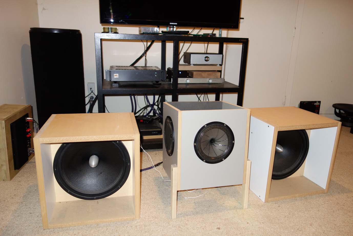

Yes, that was an early image taken during the initial build.
The subs now stand about 15 inches away from the SSS. However, I have only just gotten the imaging to lock in properly so haven't played with moving the subs right away from the speaker system entirely. Will give that a shot over the next few days.
