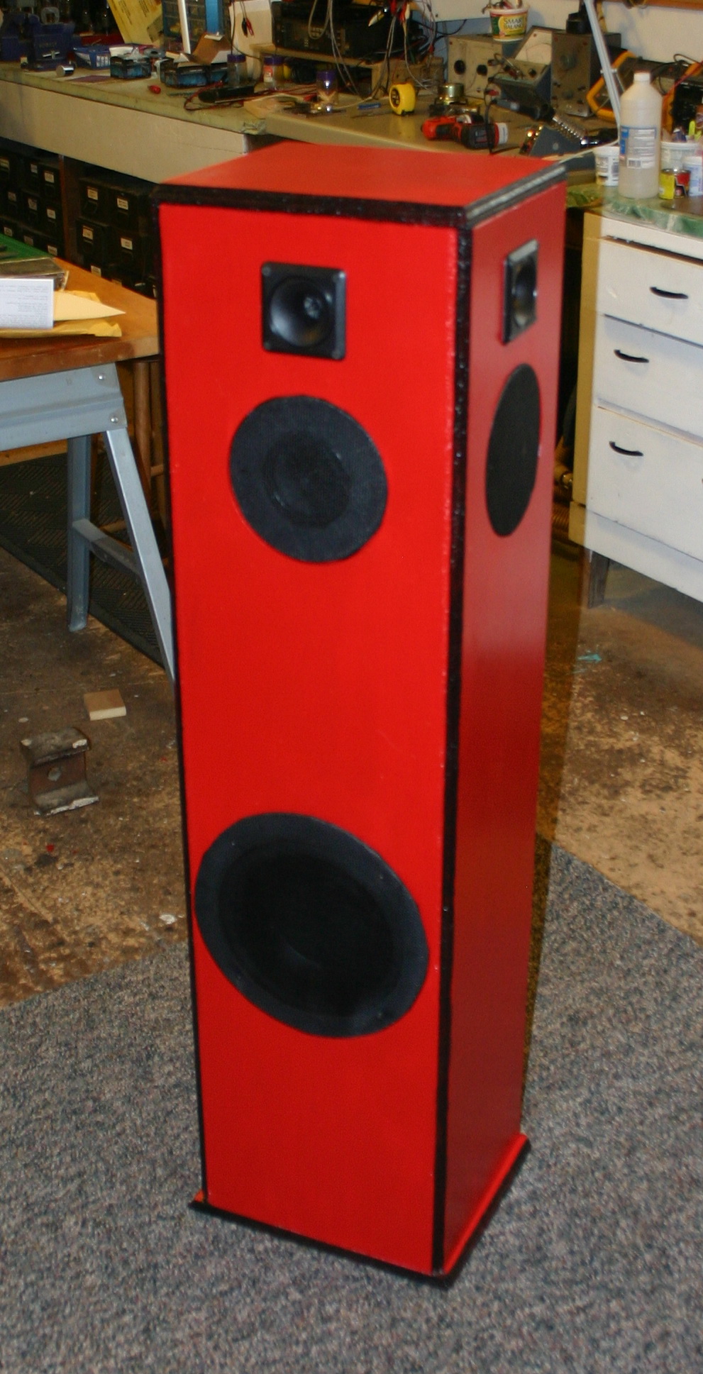

Here is my version of the single stereo system. Three four inch mids with Piezos in a separate chamber with a sealed ten inch DVC with the crossover at 400HZ. OK, the color is strange but I had the paint left over and what else to you do with MDF?
It needs a narrow room ten feet of less to give stereo, however place it in a corner and you get some good imaging and of course more bass than you need.
The Piezos are attenuated 6dB to match the mids and the center channel is down 3dB. An interesting experiment that saves you some wood and work but it was tried in fifties and sixties but never caught on.
