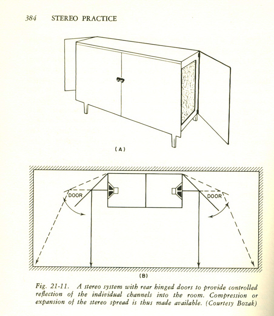

Yes Elia those are vintage references but at age 73, I am also vintage. Attached is a vintage idea that I may try for larger rooms. Hinged reflectors mounted on the cabinet rear so they can be adjusted to control the spread. This was used in a Bozak system and Electro Voice also had a version. I write for Audio Express Magazine and am thinking of writing an article on my version of your system for publication in the fall. If so, I will certainly give you full credit for the concept. Let me know if you would approve of same.
There was some disscussion here at diyaudio about Bozak including the one with hinged doors. It is inspiring to see the early experimenters had fresh ideas at their time, now being forgotten long ago.

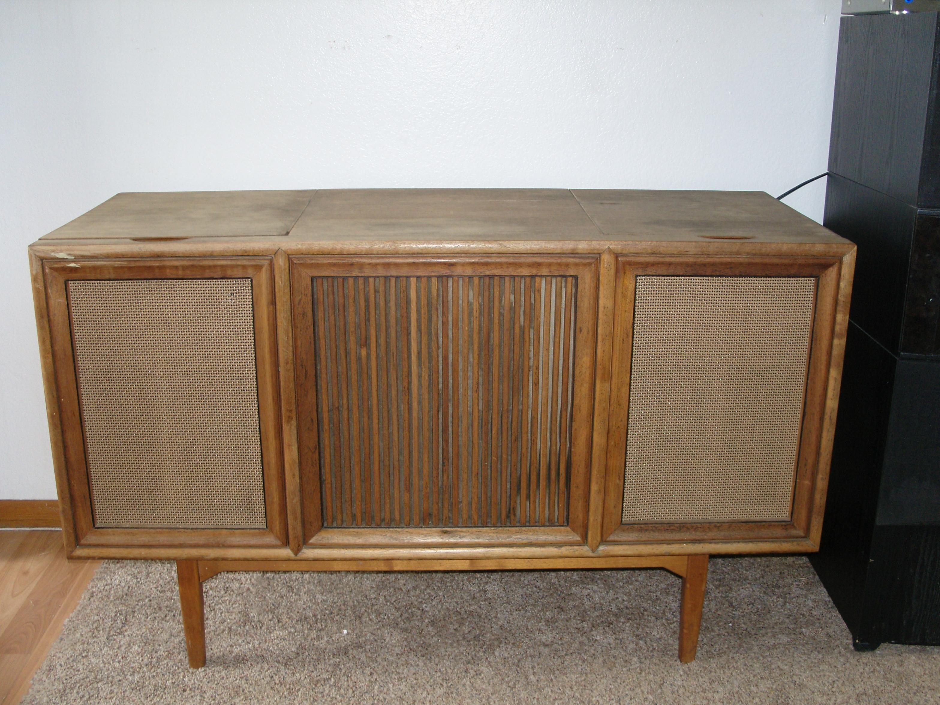

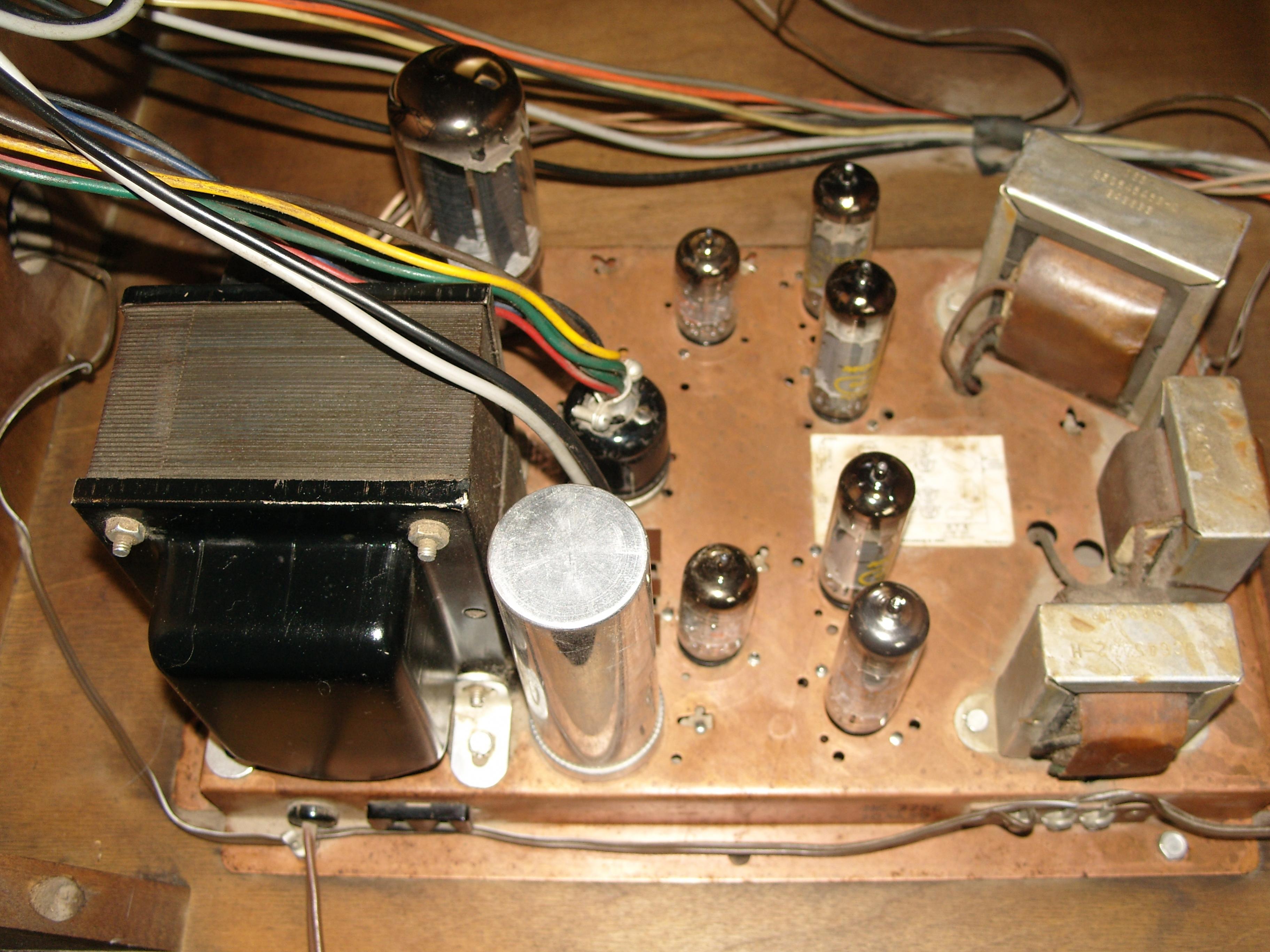

My '59 Motorola SK32W console is three channel. The center channel is derived before the amp.
Any idea of the matrix coefficients, or how the wiring is done ?
