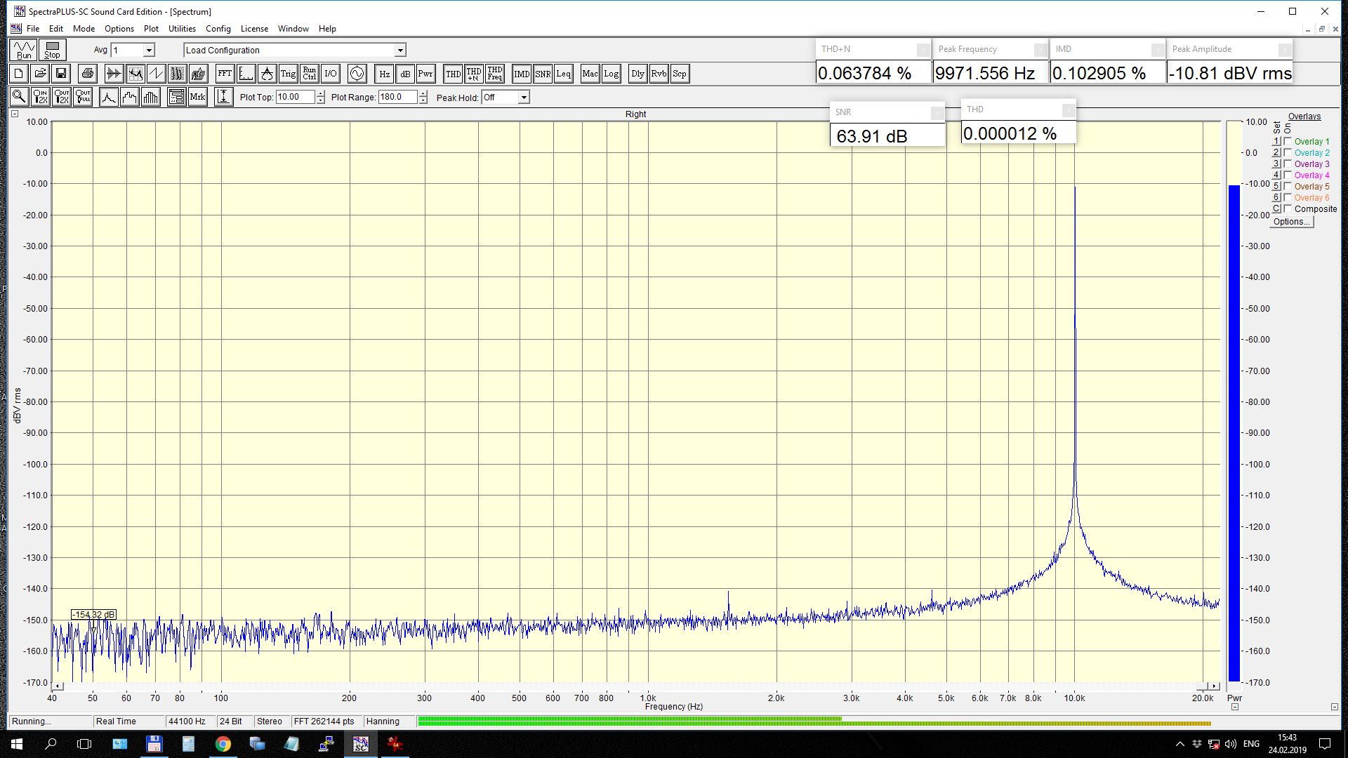

While I do think the the performance is good 😀, it does not have a THD+N of -121dB. The THD can be, with the right settings, but not the THD+N.
So I think there is something wrong with the settings in the MI Pro. Perhaps the noise is not included correctly or only for a very narrow bandwith?
Anyway, this is perhaps a bit OT for this thread.

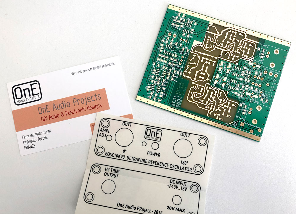

Thanks Frex! PCB arrived - looks like fantastic quality. I'll post a completed build once the parts have arrived and I've had a day to slap it together 🙂

HI folks
I am intending to build one of Frex's oscillators and wondered if anyone has a project listing/order/BOM with one of the usual suppliers like Mouser to make the ordering easier for the likes of thick-thumb typist like me. I am intending to build the 1KHz version
Mike
In addition, Frex is extremely helpful when it comes to any questions you may have. His BOM lists MELF resistors, which are increasingly becoming tough to find - he was kind enough to point out that 1206 thin film resistors will also work perfectly.
Thanks for the information guys,
just got an email from Frex and sent a payment - looking forward to having a play. First time with surface mounts - so another adventure 🙂
Gulp! I suspect you might struggle with this a little if it’s your first bash at SMD soldering - there are some very tricky bits. Might be best to get comfortable on some less valuable PCBs.
However, don’t let me deter you - I highly suggest using solder paste and hot air rather than hand-soldering those smaller components. The resistors are easy - those tiny ICs are the problem. But good luck!

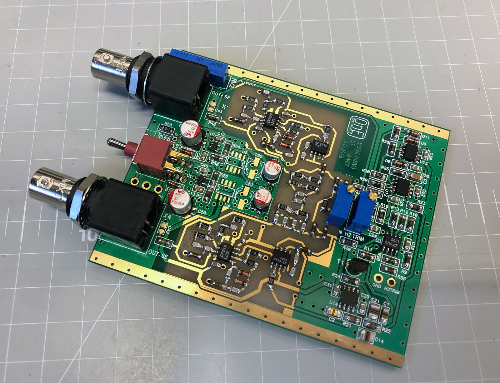

PCB (almost!) complete! Managed to get through the bulk of it on Saturday. The caps for C10, C17, C42 and C43 were missing from my Mouser order, however... so I'll have to wait until they arrive before finishing up.
Next weekend I'll put the case together. Detailed pictures, complete build and testing to follow.
