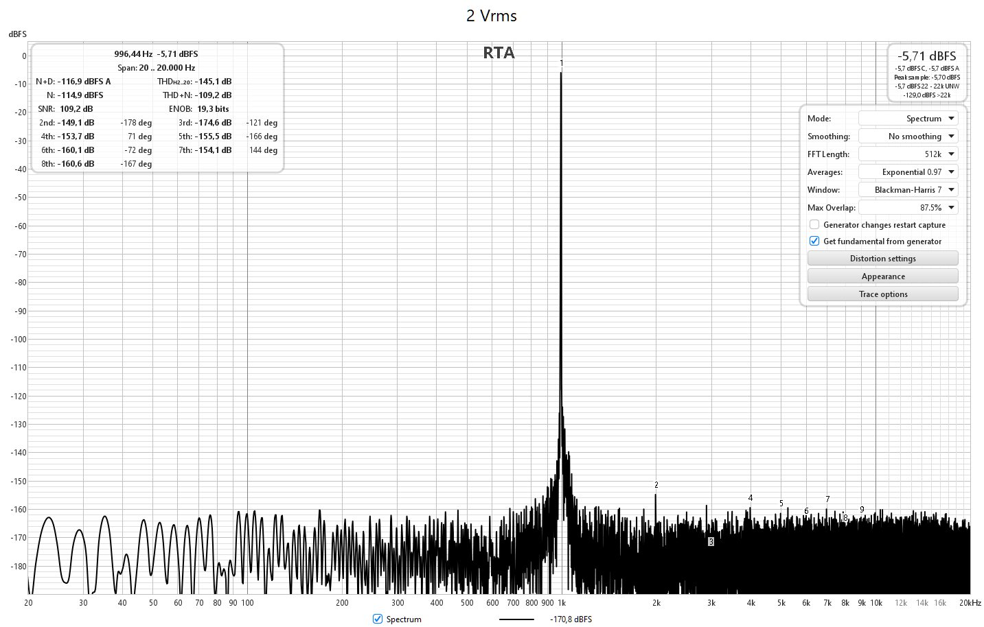

Top right widow has information with total calculated voltage over all bins. If there was no 1 kHz signal present, value would represent correct total noise in the fixed 22 Hz – 22 kHz bandwidth. Noise (signal) density over frequency is a correct averaged value for any given frequency axis point. As you pointed out, window skirts or signal phase noise obscure result close to signal frequency. At such low levels I can't tell which is more responsible.

I’ve upgraded my measurement equipment with Cosmos APU + Cosmos ADC. New measurement confirms that this signal generator has at 2 Vrms output, distortion at -145 dBc. Measured distortion is actually in the range of residual distortion from measurement equipment, as can be seen at this link:
https://www.diyaudio.com/community/...na-70-to-outperform-apx555b-for-30000.386001/
So, actual distortion could be even lower.
Measurement was taken at 2Vrms for comparison with Victor’s signal generator. At ASR forum and some bloggers (Archimago), measured for Victor’s signal generator -142 to -145 dBc distortion. My measurement of Victor’s generator, using same output level and equipment resulted with 6 dB worse result for Victor’s generator. Seems that all samples are not the same.
I’m waiting for ADC thermostat board add-on, which should improve further lowest measurable distortion levels, so we’ll see.
Another advantage of EOSC is perfectly stable frequency. Cold start is with 996.45 Hz. After hours of operation, frequency is 996.44 Hz. Victor’ generator from start to stable condition changes frequency some 2 Hz. It’s significant issue only with use of precise notch filter (Cosmos APU).
