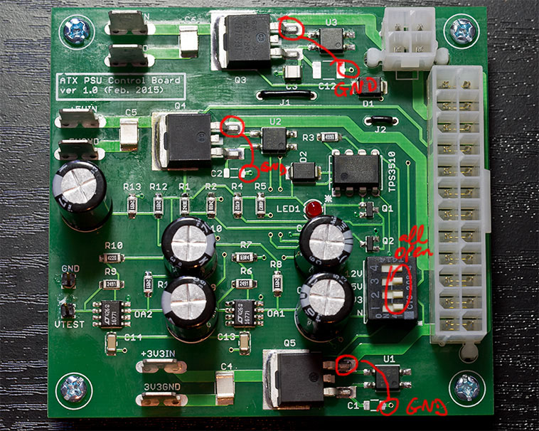

I'm regretting not purchasing the -S version of my scope with built in waveform generator. It would have been much cheaper than now buying the cheapest Rigol generator. Would this have all the functionality I would need for diyAudio stuff?

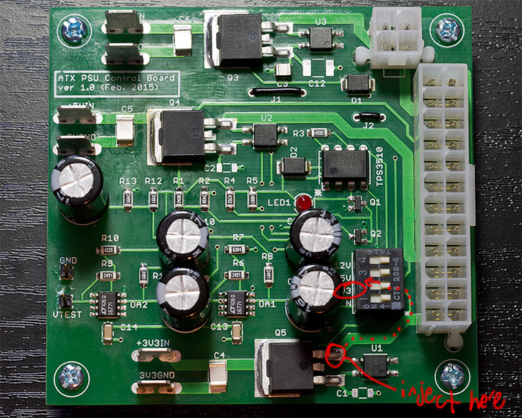

I presume the workflow would be to inject at, for example, the point shown in the attached via a BNC-alligator clip cable (or similar). It still seems something of a wayward cause trying to calibrate something which can only display on a small screen and without log frequency axis... I can save the data as a Reference and export that but it is a .ref file and my Mac thinks it is a Unix executable file so I'm not sure I can do anything with it.

Maybe it's possible to open all four DIP switches and inject there, so you're fighting against a weak opponent.

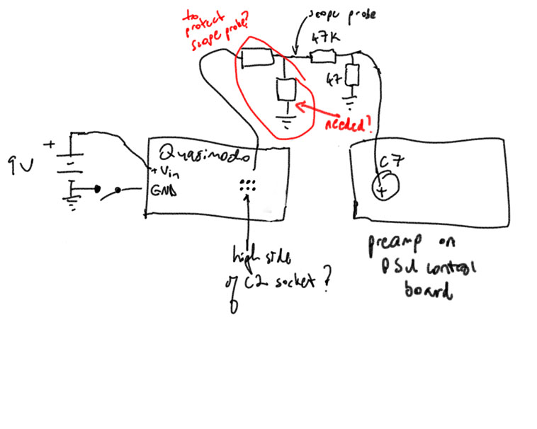

Thanks Andrew, Mark. I need to think about the signal generator. One advantage of the Rigol is I have someone I can pester easily for info/firmware updates etc. Is the one I linked to good enough?

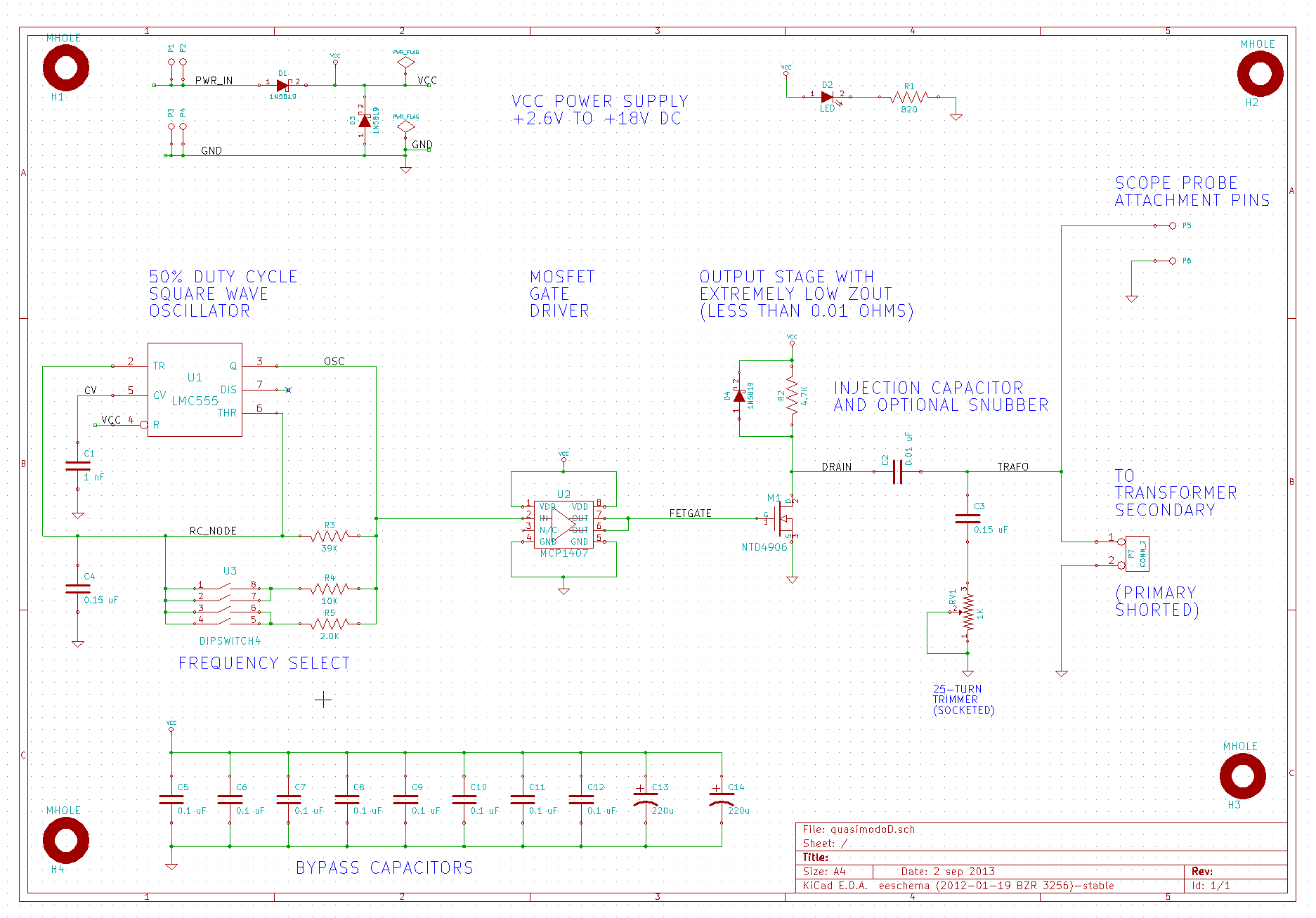

Re the Quasimodo, I should give this a go since I have one sitting here already. My through hole resistor parts bin isn't as well stocked as you guys have. I do have a 0.1% 47K resistor and a 47R resistor which measures 47.0 with my DMM. So a higher input impedance - too high?
Mark, I don't follow your sketch fully. The output voltage divider is fine. But I'm not clear where the connections to/from the Quasimodo would be made. I don't need the Quasimodo snubber so I think I take the output from the high side socket of C2. Quasimodo schematic attached. I'm confused by the 4.7kR/6mR divider. See attached sketch. I presume I need to protect the scope probe with a series resistor between it and the Quasimodo (your 4.7k). I have 2k, 3k and 8.2k to hand.
EDIT: oops... the 4.7kR/6mR protects scope probe without screwing up the 1/1000th attenuator

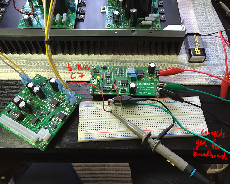

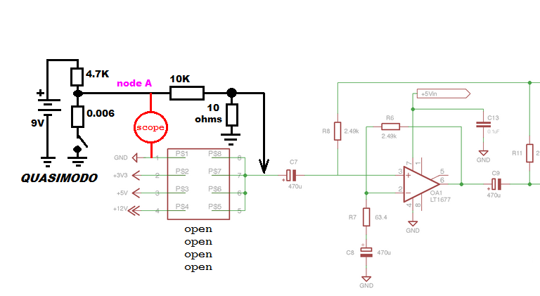

Good that you looked at the Quasimodo V4 schematic. Remove Cx, Rs, Cs from their sockets. Use node "drain" as the output when treating Quasimodo as a pulse generator in this scheme. Node "drain" drives two external resistors, Rtop (10K) and Rbot (10R). Or other resistor values as you please. Higher Rbot will give higher thermal noise but maybe it won't be noisy enough to obscure the calibration peak you are injecting. Try it and see!
Look at Figure 2 of the Quasimodo design note, p.3. You will see 4.7K and 0.006R and a switch. The key to understanding everything is this switch. Pause and consider. Ruminate.
It just so happens that this MOSFET's on resistance is 0.006R. Maybe that's a clue.

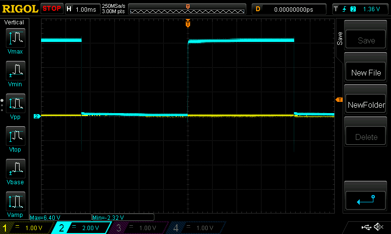

Unfortunately I don't think the Quasimodo setup is going to work. It's a mass of noise. Pic 1 is setup. Pic 2 is upstream of voltage divider. Pic 3 downstream. (Looks like I need a new 9V battery.) (Ignore channel 1 yellow; I never got so far as to connect it to the pre-amp.)
BTW note the overshoot to the downside when the Quasimodo FET turns off.

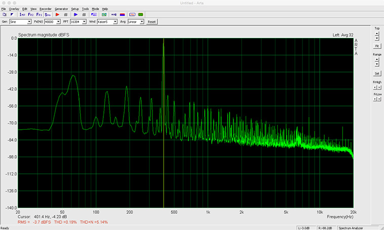

I got ARTA up and running on my Mac and I have a Roland Quad Capture external sound card. (Not as good as an ESI Juli@ but not completely useless. It measures 0.017% THD+N with -3dB points of less than 10Hz and circa 18.5kHz. I normally use it for Room Equalisation Wizard.)
But... In addition to a few questions to diyAudio member Preamp about how to calibrate ARTA properly (I still haven't gotten this properly figured out) I am having a lot of issues with noise. I did a bit of poking around.
The TPS3510 is in a state such that the pass transistors are turned off. However, I got a big surprise when I looked at the drain pins of the pass transistors with my scope. See attached pic for probe points (using probe GND spring). The second pic is what I get in my scope. (Schematic attached as well.) I presume this is EMI? (There seems to be some residual, 1Vrms, even when I turn the power supply off.) Presumably this, and its harmonics, is getting fed into the pre-amp as well when one of the dip switches is closed...
If it is coupling in via my temporary wires from the regulators, it can make it through an 'off' pass transistor?

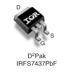

It seems you may have probed the "top" leg of the three legs. The International Rectifier datasheet says that is the Source and not the Drain. Have I misunderstood?I got a big surprise when I looked at the drain pins of the pass transistors with my scope. See attached pic for probe points (using probe GND spring)
My bad. It was very late and I got my p and n muddled up. Yes, the Source - the low side of the switch.

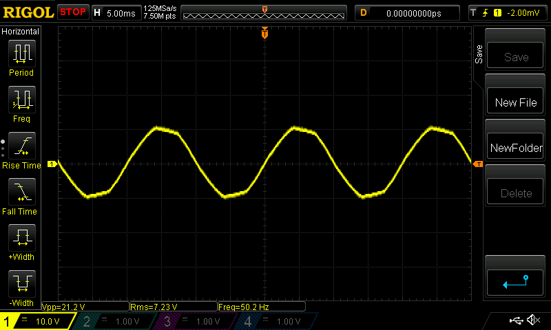

(I also don't seem to be getting a voltage ratio of circa 49dB when I measure the voltage out of my sound card versus out of the pre-amp but I will test this again at some point today.)
I set up ARTA following instructions from Preamp (Lasse). When I go to calibrate the sound card - pre-amp chain, I feed an ARTA-generated 400Hz sine wave (-3dB, 16 bit dither) into the source of 3V3 pass transistor MOSFET. (I can refine the injection point at a later date but this is just for calibrating the dBV scale and this injection point provides an easy point to clip onto.) Switch 2 of the dipswitch is closed to feed this signal into the pre-amp. (In the image in post 273 you can see the thin trace which feeds into the dipswitch.)
I take the output of the pre-amp and feed it into the sound card. While watching the Spectrum Analyser in ARTA I set the levels on the sound card so that there's no clipping. The attached image is a clip of the ARTA Spectrum Analyser window (32x linear averaging). You can see from the cursor reading that the 400Hz signal is -4dB.
I can then measure the voltage peak-to-peak at the output of the sound card (which should equal the voltage at the input of the measurement pre-amp) with my scope. I can also measure Vpp at the output of the measurement pre-amp. At the output of the sound card I measured 240mVpp. At the output of the pre-amp I measured 2.72Vpp. This is not at all the voltage gain I was expecting from the measurement pre-amp (with schematic shown in post 272).

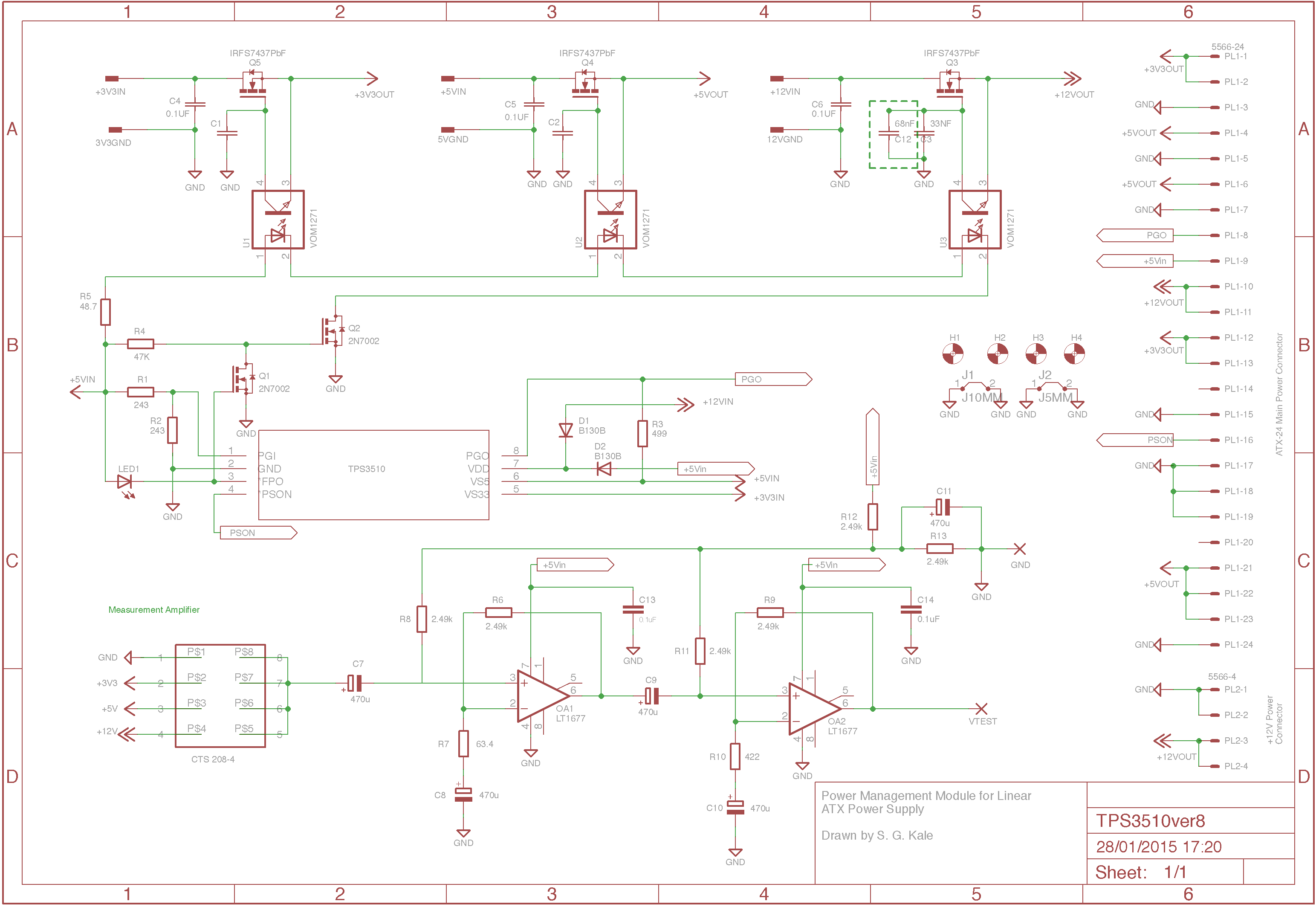

I probed the output of the first LT1677 op amp (OA1). It measured 480mVpp for a voltage gain of just 2x (versus a modelled 32dB or 38.9x voltage ratio). Clearly there's a problem here. The gain for the second stage feels a bit light as well at 5.7x (vs 6.9x modelled). Maybe we can let that slide.
I checked all the resistor values on the board. They seem fine. If the negative terminal of C8 wasn't properly grounded (I left these pads too small for my liking) there'd be unity gain at the first stage. So it must be the op amp and it's an absolute pain to get to...
Is there an error in my thinking?
Maybe it would boost your confidence in this new and unfamiliar measurement apparatus configuration, if you used it to measure three or four circuits that are Known Good and whose output-vs-input behavior is Known. Whatever's easiest for you and the parts in your junkbox and the available space on your least populated solderless breadboard. (You do own several solderless breadboards do you not?)
_
- an eleven-to-one voltage divider (Rtop=10K, Rbot=1K)
- a gain-of-negative-one amplifier (Opamp and two 10K resistors)
- a gain-of-positive-two amplifier (same opamp and same two 10K resistors)
- an RC lowpass filter that drastically attenuates your input frequency and whose expected output amplitude can be calculated using EE math or simulated using LTSPICE
