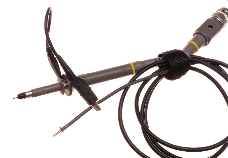

I tried the multimeter first but the probes on my meter are to big to probe properly on these small chip transistors so it is a bit of a struggle for me thats why i tested with the lcr tester and thats how i found out its a pnp and not a npn
You can sharpen the probes. If you don't want to sharpen the ones you have buy a cheap set to sharpen or use clip leads to connect to small solid wires that you can sharpen and use as probes.
The attached image shows one being used for ground but the idea is the same.
