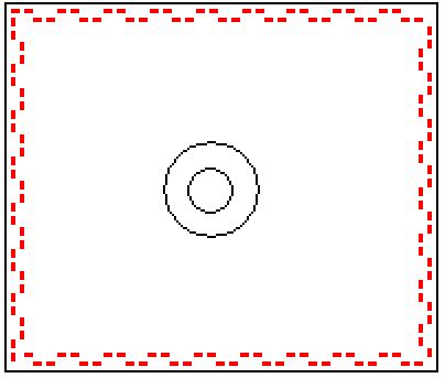

G'day john k (and others),
Just to clarify what I'm refering to as 'EnABL' when talking about baffles and ports:
- block material is either PVC duct tape or aluminium foil backed with double sided tape
- paint is not used as a block material
- block size is calculated, not ad hoc - which I have outlined here.
- EnABL pattern size is directly related to the block size
- The EnABL pattern is applied as a straight pattern either along baffles edges or around the inside circumference of a port.
I have attached a pic which roughly represents what EnABL would look like on your test baffle - note that the block sizes and baffle are NOT to scale.
I'm happy to adopt an alternative description if that will make things clearer for everyone.
Suggestions?
Alex
Are you guys reading the same words I am? The only way it could be more clear would be for john to post a picture.
A mental picture is what I want. John's post suggested a solid ring of pinstripe tape. But I figured that couldn't be b/c it's so far from what the enable pattern is. So forgive me for assuming I must have misunderstood what he did. If what he did is, in fact, a solid ring of pinstripe tape, then I did read his post right, but from a SCIENTIFIC, OBJECTIVE and TECHNICAL point of view, what he did is irrelevant and belongs on the other thread... 😕
Carl

CarlP,
John does have the proper tape width for that diameter of outer pattern ring. I have attached a simple dimensioned drawing to show this.
I am assuming he is just condensing the pattern into a solid for simplicity. On the other hand I have no idea from this what effect the offsets might actually have. It is good to have a baseline though, so when we get to looking at Alex's tape patterns we do have one data point.
I will again say that my expectation for a ring here, around a driver or even two drivers would be a very slight change in mix height, and that would be pretty debatable. In conjunction with an outer pattern there may be some more usefulness, but I haven't done this combination in a number of years, so at some point I must have decided it was not worth the time to apply.
