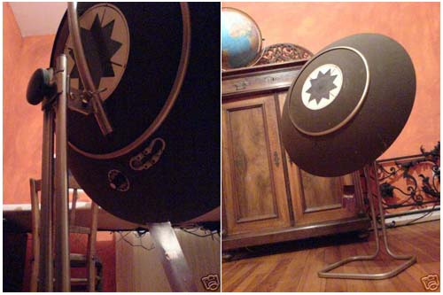

I do recall some sort of ring to pre-warp the baffle diffraction effects was patented, and probably it was a Manger patent. I'm sure rings like these do have effect. But again, like any pattern, there is no cure all formula.
It is an error. Patent says it is for correction of an impulse response but in final product it's just a mounting ring :)

Well, just looking at the pic from a glance, it seems the impuse irregularity is caused by the baffle.
Patent and above (mine) redraw shows driver irregularities, baffle step in time domain from omni source and bipolar rectangular. Disc and bipolar baffle was optimized for a smooth step curve - a square wave friendly speaker :)
