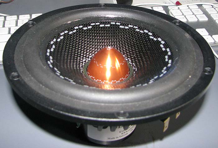

Re: No one is grasping the import of john's posts
dlr said:
It is interesting that for those in this thread who are doing any current mods to drivers in their own, personal systems, all mods are being done on full-range drivers.
Some people use these up to 2k, personaly i start feeling uncomfortable when things start creeping up over 500 Hz.

Re: Re: No one is grasping the import of john's posts
dave
I would be very interested in before/after measurements raw, then the same with a crossover in place. Got any to show? I'm especially interested in the response with a crossover, since that's how it will be used. If the Fc is 500Hz, changes are likely to be rather far down in level, I'd like to see just how much is changed and how far down it is before/after.
So how about your analysis of John's posted data? So far no one has made an attempt. You've got a modded driver to show, but you leave John's post without response. There's a lot of expressed interest in objective data, yet no one discusses it once it's made and posted. How about you?
