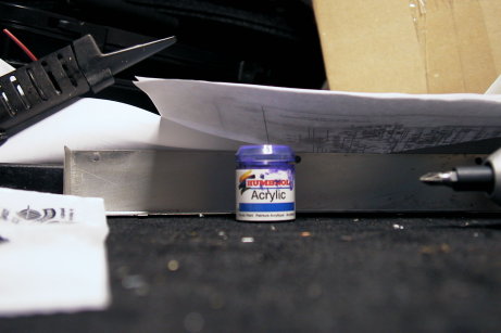

I have been shopping.
Fist the new paint.
It's acrylic, flat and coloured brightly. This cant be wrong 😉

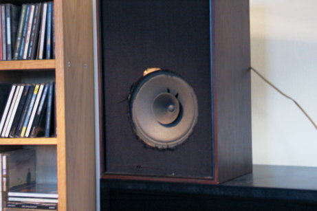

I did get a pair of new victims as well. This time they have a whizzer that will be a challenge for my new painting skills 😀
They are on the amp now and sound much better than they should, especialy in the high end frequency. They do however lack a lot in the deep registers.
So Bud I hope you will photoshop this image with your virtual EnABL so I'm sure that I get it right.
Thanks in advance 🙂

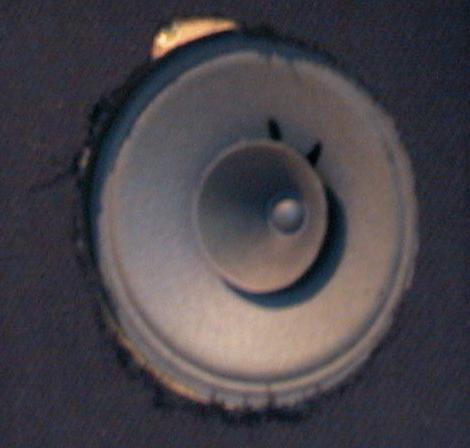

This is a driver pic I have in my photos folder without any caption.
Surely the 'phase plug' here has been designed to re-direct transverse wave pressures/velocities arising at the cone centre wrt circumference, instead of them colliding/interfering with voice coil induced cone motion.
Cheers .......... Graham.

Looks like someone put "Kisses" there.😀 It sure looks like the middle of a ring radiator tweeter as well.
