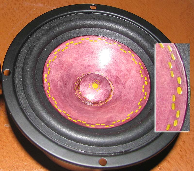

BudP said:
Take a close look at the Fostex 127 E photos, to see just how badly my hand shakes when applying these rather small shapes.
Attached is another example. If yoy count the spots you will see that this 4" driver has the same number of spots and exactly the same arrangement as the picture of the 8" B200 posted earlier (ignoring the extra detail required by the phase plug installation)
Note: the pre-coat on these has nothing to do with EnABL (his wife wanted them marroon
dave

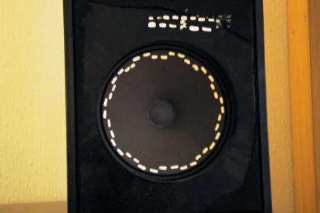

What's the hold up? I thought you guys would jump on the opportunity to demonstrate the improvement this process makes by distinguishing distortion to a lower level.
I'm very disappointed...
BTW, how did I do mine wrong? The blocks aren't yellow, I know.

John, Maybe you don't know this, but I'm pretty sure the color of the blocks isn't important, but maybe I missed your point.
