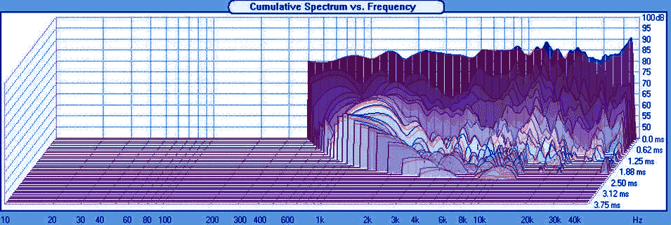

Here is an overlay of the after (red) ontop of the before (blue)...
dave

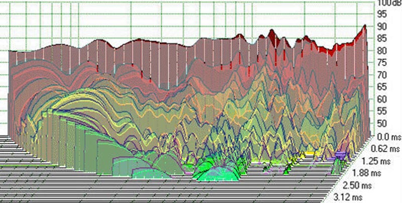

and here is a blown up comp that shows the after has a subtly faster decay in the after (again on top).
I haven't heard Soong's drivers, but if these CSD/FR differences were the drivers i have been listening too, there is no way that i could see these subtle differences causing the differences that i am hearing.
If anyone wants the layered photoshop comps so that they can play with the transparency of the after/top layer to better see the differences please mail me.
dave
Edit. Dark hunps are before, lighter humps after.

Note that the time scale in the first two CSD plots is very different. The second and latter plots step over much if the short time resolution. In any case there are clearly visible changes between the last two plots.

Be very wary of making any inferences from any quasi-anechoic measurements. These are typical, with a low cutoff of 400Hz. There are two issues here. The window was selected, appropriately I believe, to avoid any reflections, a requirement. First, this means that the limits of resolution across the spectrum for display will have a sample point separation of 400Hz. Everything in between is totally missing data, except for the FFT "bin" variations inherent in the processing. It's the effect on the bins by the window (type, start and stop markers) used that will cause some variation.
Second, if the same window were used and a square window rather than what I suspect was a half Blackman-Harris window, the low end frequency response from 400Hz up to maybe 1200Hz might easily show 1-2db variations in FR. These low end variations can easily show up either as false resonance ridges or a leveling of real resonant ridges. Anything below 1K in these two plots are highly questionable as to precision, a normal situation for the short window required to eliminate reflections. It would take something such as a true infinite baffle in an anechoic chamber, a measurement made outdoors with the driver "flush" mounted in the ground and mic above or a ground-plane measurement to truly capture the low end, but it can be done.
That low end is unlikely to be much of the reason for any change in perception IME unless the mass added made a fair amount of change in Fs and/or sensitivity. The ratio between low and high frequency sensitivity can change with added mass that will alter the spectral balance of the driver.
