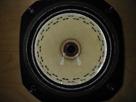

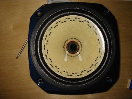

Giving the enable thing a go. First attempt, my printer is acting up so no pattern to follow. I used my finger as a guide (used to pinstripe) to draw the concentric circles and a protractor to get the spacing. There is a light layer of dammar on the cone giving it that gloss. The driver is a FE-166esr.

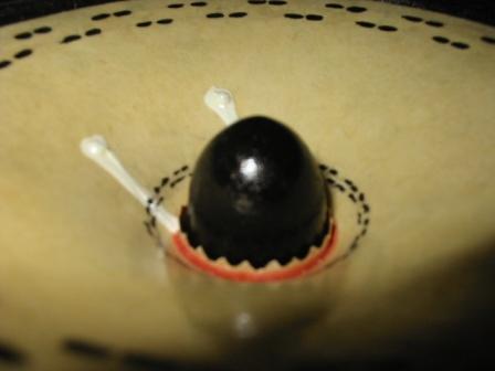

here's a shot of 'teeth' I cut (mostly on a hunch). I wanted to cut a quadratic pattern for dispersion or remove the lip entirely. I was too lazy for the quadratic pattern and didn't want to mess with the VC wires to remove the lip entirely... I know if I started I'd get carried away and try to shape the lip for smooth flow and have to relocate the entry of the wires... on most other drivers sure, but I have a sentimental attachment to these.
Oh! point. At first go sans whizzer I heard sort of sibilant edge that bugged me. I felt a little ticked off and the tooth pattern was the first and successful attempt. The sibilance went away and more clarity came forward. Happy camper.
Edit: I need to lessen the gap between vc and phase plugs, the picture enhances the effect.

Bartek G.
You will want to be careful to watch for marauding timber wolves from the western mountains, after flaunting that bit of work! After the spots leave Dave's eyes and he can actually see you, of course....
Nice work for a veteran striper. Don't hesitate to spot up the rest of your home... a fellow on Oahu was eying his window glass the last time I communicated with him.
If you apply a light coat of Micro Scale Gloss, over the entire thing including those teeth, it will tend to draw an even finer focus on the really tiny sounds.
See Dave's earlier posting pic's to discover how to make the phase plug play right along.
The teeth are a very good idea, by the way.
Bud
Dave, maybe I should just buy a pair from you if you have some on hand, lathe time at work isn't easy to come by these days, they keep me too busy for g-jobs.
BudP, thank you for the kind words. I'm not that good with the brushes anymore, I got a little case of shakes after a concussion, never went away.
I just may start patterning the place, I like the look.
Will the coat of dammar already present on the cone mess up the Micro Scale Gloss application and/or effect?
If the Dammar is under the pattern, no problem, put a single 50% cut with water gloss coat over the whole thing. If it is over the pattern I might just let things settle for a time and listen. If you then think something more is needed then, the Gloss would be a useful tool.
It will take you a while to reeducate your ears to be able to make any decisions about the Gloss, or the rest of your system for that matter.
