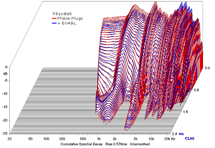

Here's the CSD comparison for the fostex with phase plug and the EnABLed version with one coat of gloss. This time the time scale is the same.
Now it's time to see if I can get rid of those two nasty peaks in the 1-5KHz range.

Really looks like the micro gloss is stiffening the cone structure which reduces resonance time at 3kHz and increases transduction efficiency above 8kHz.

Dave,
Do you also have the stock driver?
dave

It would appear that the measured sound level of the Enabled driver is ~1.5-2 dB lower than the nontreated (notice the hole @~750Hz, where the measurement drops through the -25dB floor). So, if you were to raise this up, some of the peaks that appear to fall below that of the untreated driver would probably be the same.
That said, it definitely changed the response level in the higher frequencies.

I somehow get the feeling that the weaker modes are taken out, leaving the stronger modes more distinct. meaning the Fostex cones have pretty stiff paper, unlike some of the cheaper paper drivers. This means the pattern needs to be stiffer material, and the pattern cannot be so dense.

Dave: could it be the "apparent" discrepancy suggested above is an artifact of the method used to overlay the graphics?

Actually I think we are beginning to get to the meat of the issue, with Gerrit's CSD plots and the overlay differences shown.
Since the various distortion tests I have run show little or no change from original to EnABL'd driver, the patterns are not changing the amount of signal energy that is causing resonances to be emitted, at other discreet frequencies. Meaning that the same amount of energy devolves to a second and other harmonic as was true before the driver was EnABL treated.
What I think is beginning to be shown is that energy that rings at the original frequency, but at a lower amplitude and a very slight to a somewhat longer period in time, is being eliminated, by forcing it to emit with the original excitation wave.
If you look at the physical distances involved, most of this same frequency ringing would only show up in a CSD plot of the 1st ms and might actually need to have the first 100 us as a time frame, to show what EnABL is actually doing.

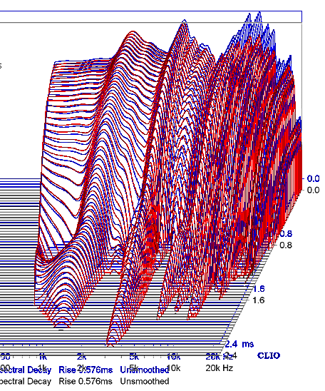

The 1st chart lines the plots up using the grids. One would expect the EnABLed driver to be a tiny bit less efficient due to the small amount of extra mass from the gloss coat. I don't know if it can account for the we are seeing. (on an FE126/127 i usually see about 1/2 a dB and that is with both puzzlecoat & gloss.
If ialign the chart using the 1st bump in the response, you can see that the clearly visible lumps are decaying faster on the EnABLed driver. This is the kind of thing we would hope to see based on the theory althou i strongly suspect that we are only seeing the tip of the iceberg and the real relevant stuff is still at the bottom of the wave where we can't see it in the measures.
Of course this is only one measure so we need to take it with a grain of salt. It does show some area for exploration. A greater amplitude capture, and a time scale in cycles would really help.
dave
Clio uses the highest peak as a 0dB reference for the CSD plot, this makes comparison a little awkward. With the untreated driver the peaks in the mid range are predominant, while with the treated driver the peaks above 10KHz are dominant.

Seems kinda futile (at least from a CSD perspective) trying to improve this:
http://gboers.xs4all.nl/daisy/home/458/version/default/part/ImageData/data/CSD-comparisonB.png
when one can get a driver (albeit a tweeter) for ~$19 that looks alot better (w/o EnABL no less) ...
http://ldsg.snippets.org/graphics/peerless/Peerless_811815_Waterfall.gif
That's why I don't much care for the "full range" approach.. at least not using cone drivers...

Wouldn't life be so much simplier if the measurements could actually tell us what something sounds like?
We know that EnABL makes a big improvement. We are just trying to tease a difference out of the measures. It is so far proving to be a significant improvement that seems to be impervious to any measures taken so far.
