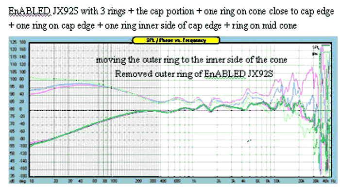

This is the best I can do for now. Light colored graph is changing of cone edge. Dark colored graph is changing cap and mid cone. Hope you can figure out which is which in the graphs.

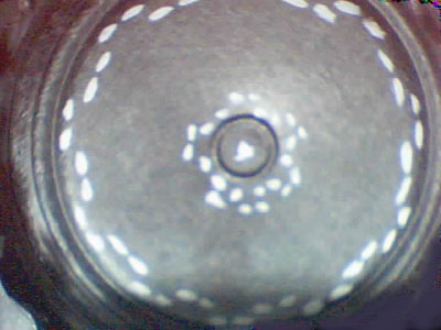

I decided to use acrylic poster paint, since I'm having trouble finding the materials. I didn't find suitable conformal coating, so I only apply the pattern.
Today I tried putting EnabL pattern on some thin carton food packaging , comparing the sound when I flick my finger on them, there's difference in the sound , normal pattern 1 -1 sequence and 2-2 (BudP pattern ) sequence seems to be less resonant than no pattern, with 2-2 pattern better. I notice as the pattern dries there's difference in the sound .But I'm still unsure about applying it to speaker.
so I decided to experiment on my cheap paper cone computer speaker ( around 3.3 cm diameter ) it's very cheap, it even combine the stereo input into mono , no opamp , just discrete transistor, probalbly single ended class A/B , AC coupled, probably less than 1 watt power.
removed (destryoed literally ) the plastic grill and cloth covering the driver, and played a CD(Jacky cheung) through my computer onboard soundcard. I listened and began putting the pattern with the music on. (the driver practically have no excursion so it's easy to do it). when i put the pattern one by one the sounds begin to change, and it's not subtle. this time the pattern I put is thin, practically add very little to the speaker moving mass. as the patterning finished, I listen to it a while as the paint dries, It sounds much cleaner, the paper warbling noise is much much reduced. Comparing to the other speaker that's not treated, the untreated one have the typical cheap paper cone sound, warbling noise, dimension is lost, and sound is much more fatiguing.
EDIT : I done this listening on the speaker front baffle, held by hand, taken out of the box, no box sound to muck up the listening.
The treated one sound so much different, Jacky Cheung sound is much more clear, and the ambience is more heard and relaxed and have more depth, even the drum bass sound is much more defined (in 3.3cm speaker). now this speaker started to have proper imaging, amazing.

Here are some exciting results on the JX92S:
Yes, this is the same driver, and all the high frequency breakup modes are gone. Enjoy! With a mod like this, you can be sure that the slight harshness originally existing in the high frequencies are gone. I can predict that cymbals will be crisp and realistic.
I must say that this was not so difficult because the JX92S is already an excellent driver.
Again, I must express that each driver needs to be individually tuned. This is because the high frequency response may vary.
Soongsc,
This set of graphs is for the cone without any dome treatment. This is quite amazing.
This is a VERY important discovery. If the rings can be taken off of the dome completely and a ring set on the cone only will control the dome, that will be a key finding.
Do you have the extended time window for any of the other ring sets?
Even more interesting to those who still cannot grasp how this pattern can possibly work, would be this whole work up for an untreated driver, for a full baseline. Something that shows just how long it takes for the untreated driver to fall to the levels of ringing shown in the full time extension CSD plot of the treated driver.
Bud
Hartono,
I am so glad that you did this. It is the most convincing activity I know of, to just apply the pattern and listen to how the sound changes as you apply it. What is lost and what shows up to take it's place. Then to realize nothing was really lost, or gained, it has just been redeployed by applying this powerful tool.
I once treated a pair of PM speakers, 80mm in diameter with domes on the voice coil end rather than flat hats. I then mounted them into Koss Pro 4 headphone cavities and took them around to dealers and a few Audiophiles I knew, who had high end headphones. Their only equals came from Stax and the Pioneer HPM film headphones. This was done in 1978. The PM speakers had extraordinarily deep bass and endless definition. Something else all of you can try in your spare time.
