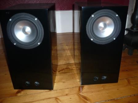

I had a friend build me some compact enclosures for the JX92S which gets a lot of tuneful bass out of them with a very balanced & refined sound throughout the spectrum. Has been passed as excellent sounding by local hifi club - up against Quad ESL57s. It's a design called a 3D Spiral Horn meant for full range Fostexs and AFAIK I'm the only one to have used JX92S in this enclosure type.
Size wise - about the size of Rogers LS3/5As which they are replacing
Thread here: http://www.diyaudio.com/forums/showthread.php?s=&threadid=119903&highlight=
Final Qs - what metal strip & glue/paint are you using or does it matter? Can you define the parameters of the pattern, please?
