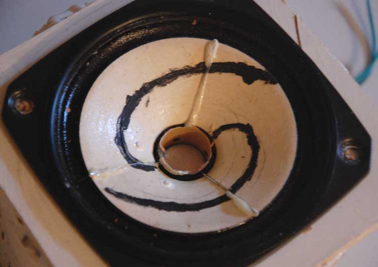

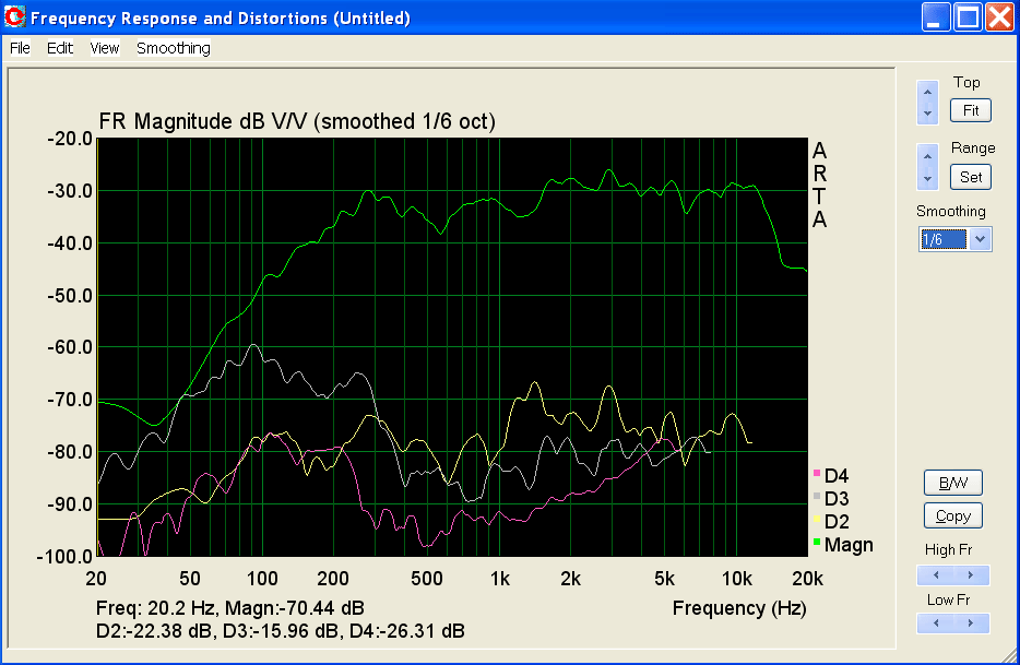

here is mine macho cone mod 😀
cone is slit, then straightened paper clip soaked in gorilla glue inserted into the cut.
results are good, but there is still may be a room for improvement,
I may try to glue paper clips around cone edges.
measurements are taken 8in away in small enclosure with 5x5in baffle.
