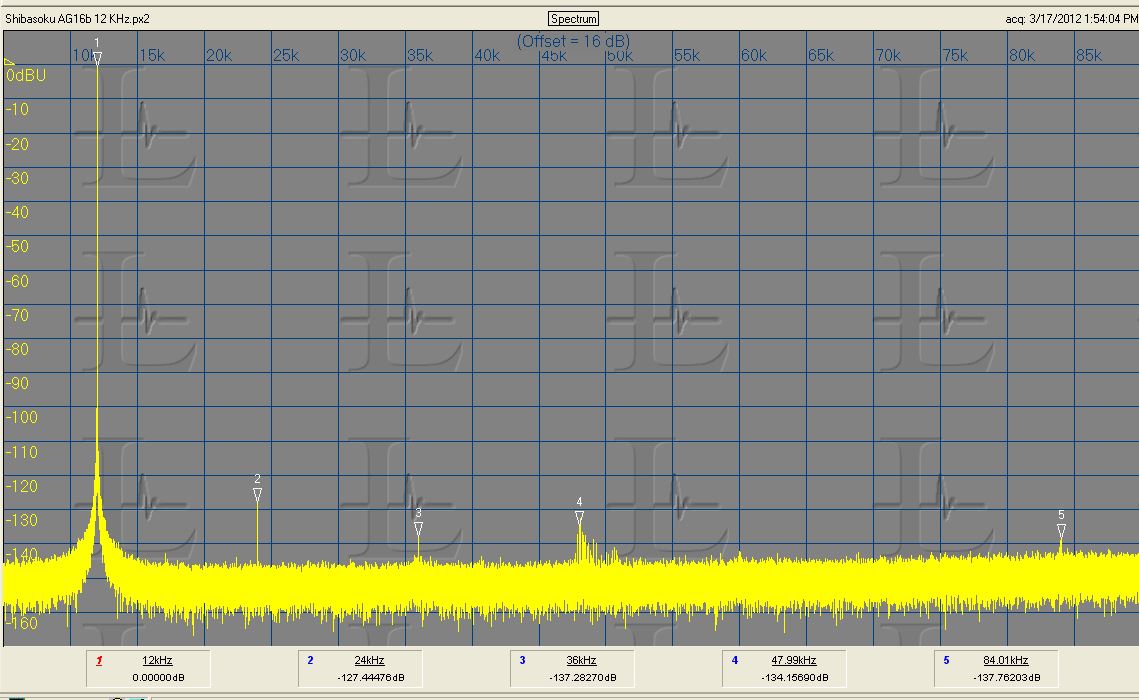

Here is a measurement of the AK5394a + Shibasoku AG16 at 12 KHz. The strongest residual is at -127 dB. I'm not sure I could duplicate this since everything needs to be working perfectly. The overall THD calculates to -125 dB or .00005%.
The AKD5394a was externally clocked with a really good 24.576 OXCO. I'm using Juli@ card into Praxis and it takes as much a 1/2 hour to make the measurement if the resolution is really high, necessary to see the close in jitter.
The AK5394a noise floor does not rise with frequency. The Juli@ card also uses the AK5385b. That chip does show a rise in noise floor.
I see a 100 KHz limit but no limits below 100 KHz for measurements.I personally think looking for -100 or even -80 dB harmonics at 100 KHz+ isn't meaningful. The 10 bit QA100 will show you everything you could possibly be interested in, and its easier, quicker to use and done. Creating these things looks like a quick and fun task. It is for the first few hours or days, but after 6 months of fiddling it gets real old. The Audio Widget has had several years of patient and determined development and tweaking by Borge, Alex and some others. Getting to that stage is a lot of work. I suggest building on it.

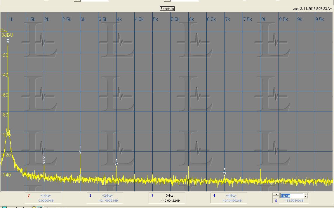

A quick update on my observations. First the EMU Tracker Pre and the )$)$ use the same ADC, AK5385a as does the ESI Juli@ and the RME HDSP9632. The analog implementations vary and the RME seems to have the best (most robust) interface to the host PC. It should given its market and application, but even that will get hammered if I start something line a VNC session moving screens remotely.
Attached is the RME loopback distortion and noise floor. This is going through the Praxis so the internal opamps in the Praxis are limiting the performance some. Its lower 2nd Harmonic that I get with the other devices on loopback. I'll connect the ShibaSoku later this week to get an idea of what can be expected.
I get much better results from the AKD5394A demo board.
Other notes (before I forget). The Tracker pre only runs at 44.1 and 48 on XP (at least with the drivers from EMU on their site). It runs up to 192 on Win 7. The 0404 does run up to 192 on XP. On Win 7 to get the input sensitivity down I need to set the gain in the windows mixer to 5 on the input. I still get occasional glitches at 192 with the EMU stuff.
I'll post a picture of the Tracker insides later this week.

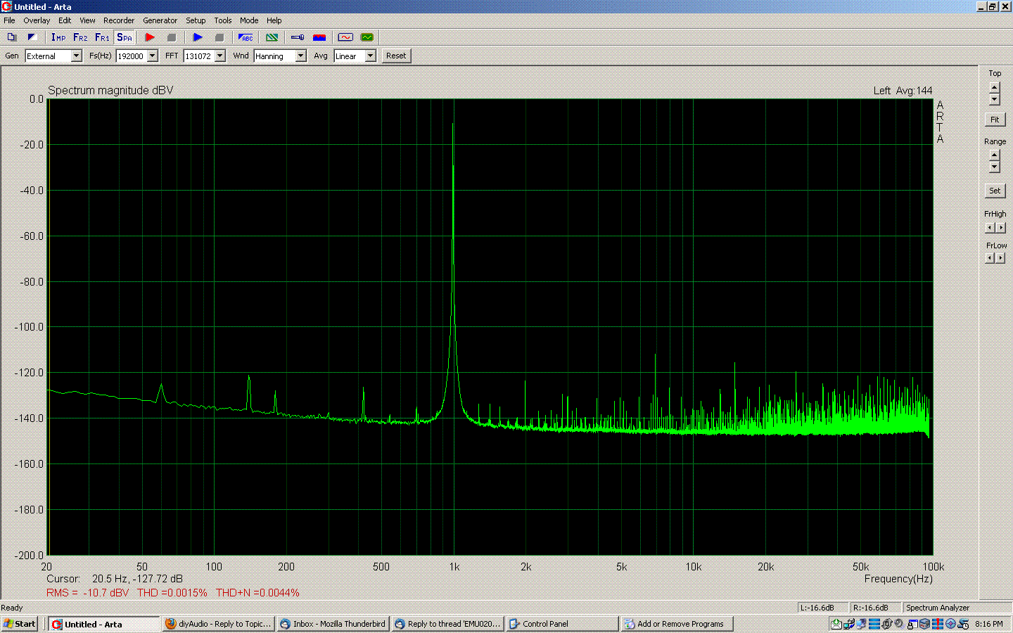

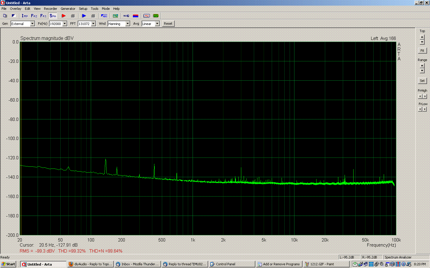

I've got the EMU1212 up and running but I've got to say I'm pretty disappointed.
I think this is a waist of a AK5394A. Just my opinion though. It took me over half an hour to get ARTA calibrated with this thing. It won't work with out the application that goes with it and that really get's in the way of third party apps.
See for yourself. This is no good for high resolution measurement and is another reason we are doing the Capture Widget project.
The first pic is self explanatory and the second is with a 75 ohm load on the input.
