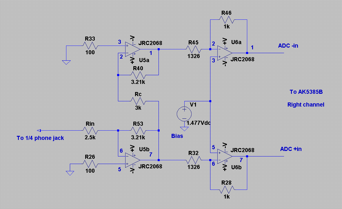

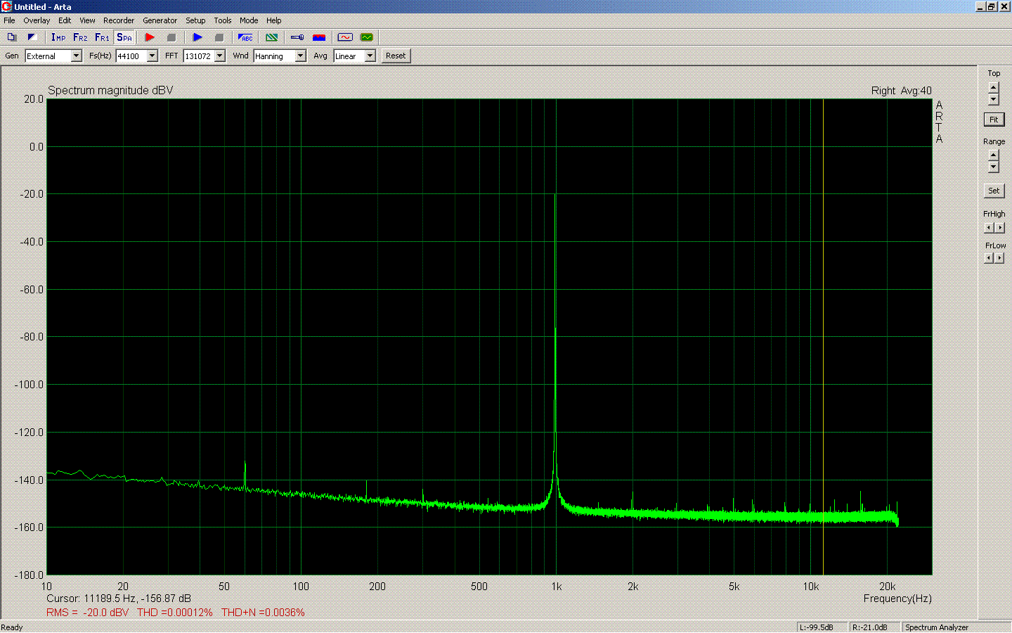

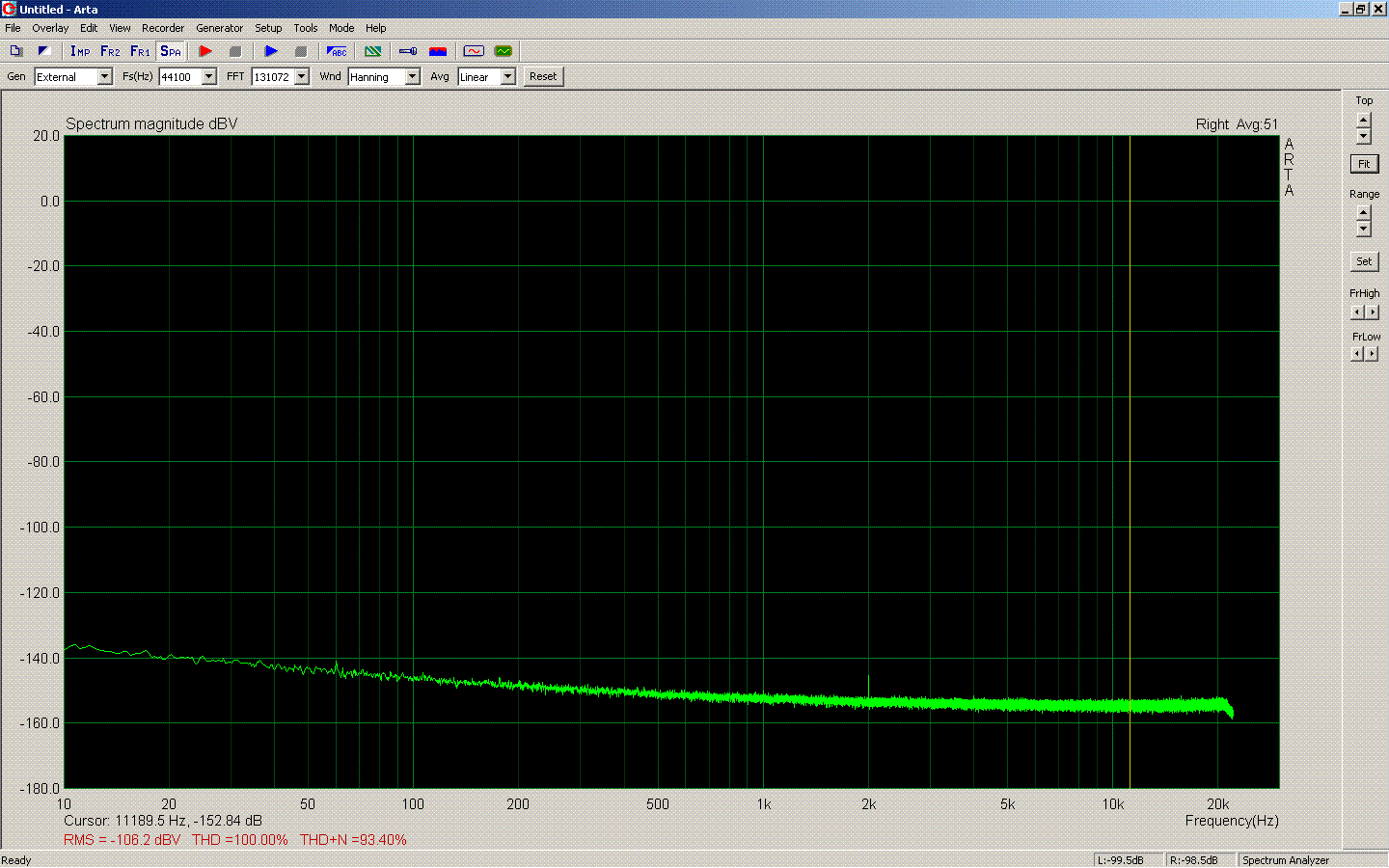

EMU 0204 right channel mod
I have arrived at R values to scale 0dB to the FS of the AK4385B.
The ADC FS is 2.9Vpp differential.
I give some details of performing the mod in another post.

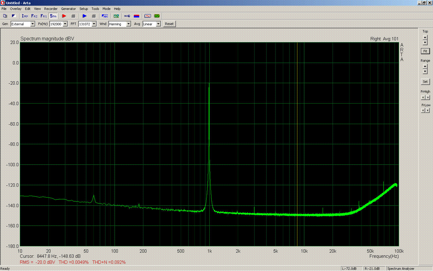

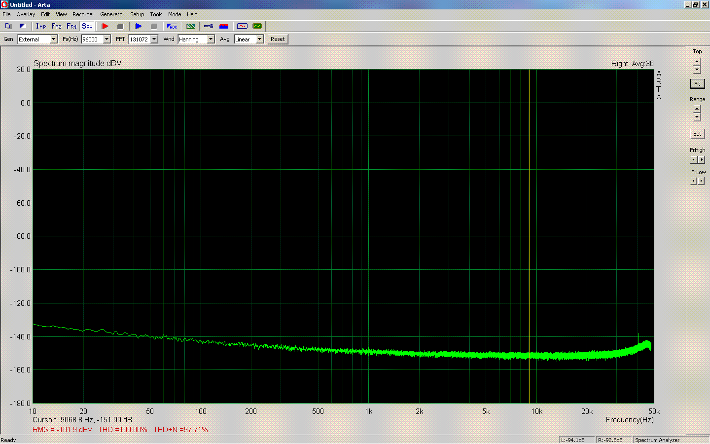

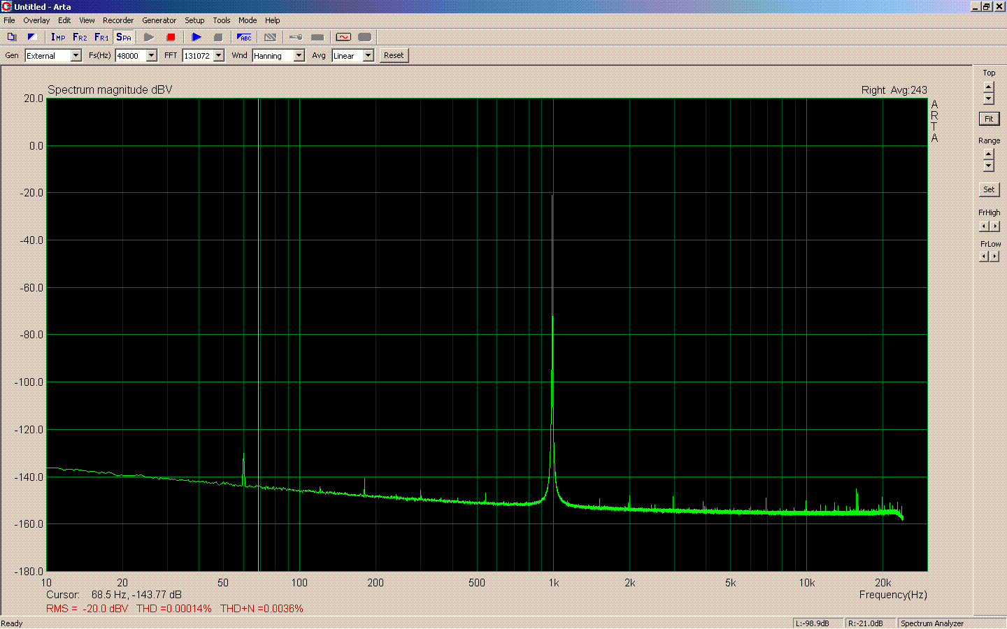

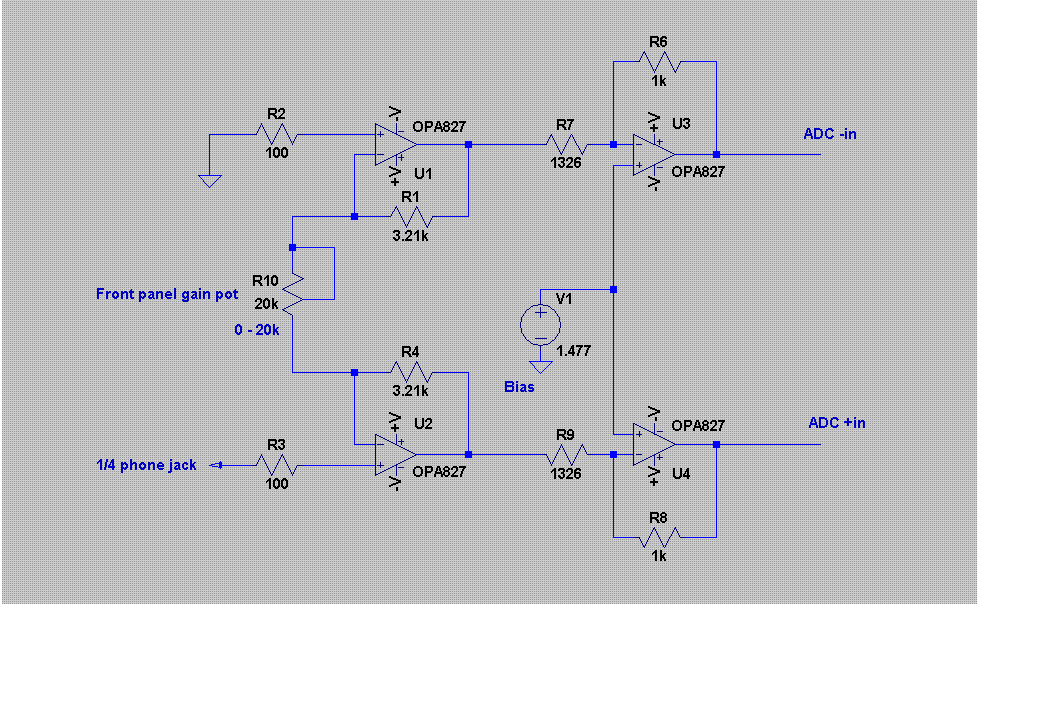

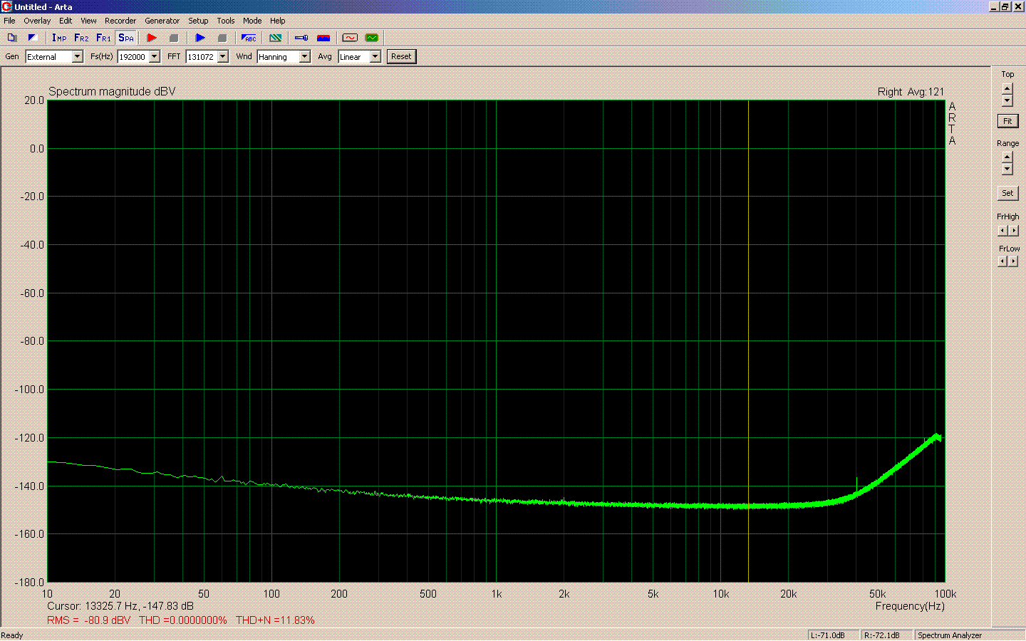

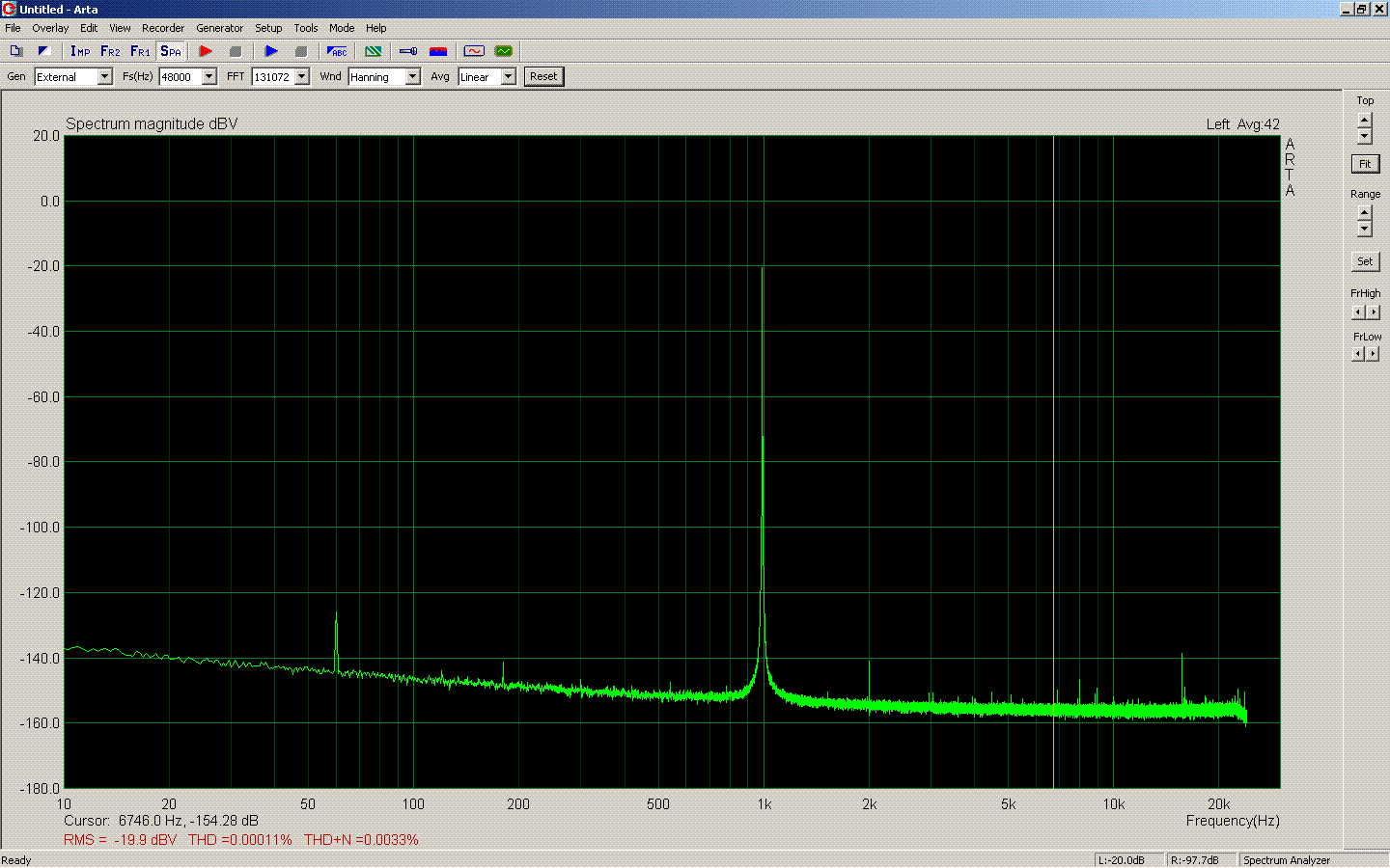

Here are some schematics and results.
The first sch is the original. The second sch is the AKM recommended and the third sch is the mod.
The rest is self explanatory.

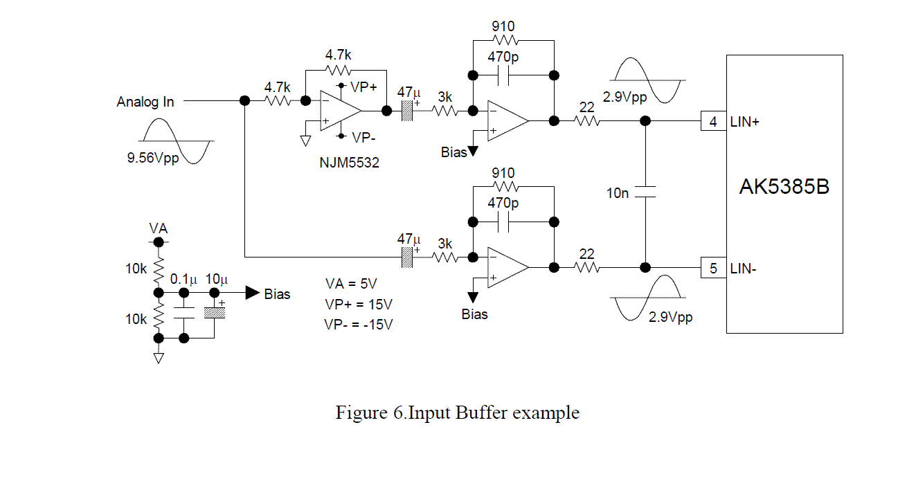

In your mod sch Rc is not equal to feedback resistor of the inverting opamp- inputs to adc will not be equal on each phase
You can use an exact value if you like but the 3k worked just fine in mine and a lot better than what EMU had there.
As an alternative you can input 1Vrms and bring the gain control up to clipping.
Reduce the input level to-10dB and calibrate ARTA with 316mV.
But the differential voltages to the input won't be balanced.
This mod is a bit cleaner though.
This is the alternative.

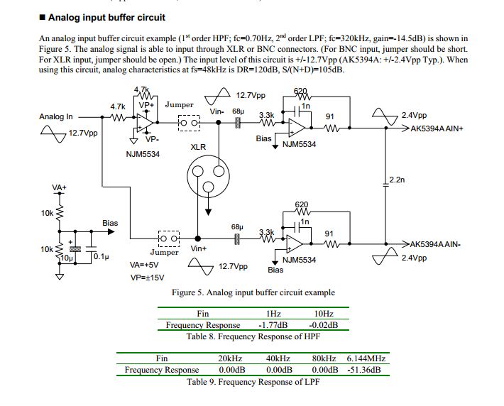

I was confused at first but I believe what you are doing is making sure the differential inputs are equal at the DAC. this would give the largest dynamic rage on it. The lowest distortion is usually less than full input, typically -10 dB or so.
The AKD5394A uses almost the same input circuit and the docs are more complete (see below). Its not necessarily the best but it will give perfect balance at the chip.

Hi Demian,
This same circuit is on Ak5385B data sheet. I didn't show it because I only addressed the right unbalanced channel.

Does this mod invert absolite phase for this channel? It looks like it would.
It does invert the signal. This shouldn't be a problem unless the two channel are summed physically. The emu would be useless for music applications at this point.
An alternative is to leave the input op amp in the non inverting mode, ground the added resistor and adjust the R value for this mode.
I prefer the inverting amp.

I bet they're the same input circuit. Whatever EMU used for a balance input.
EMU likes to direct couple each stage of there inputs. This make it difficult to minimize the number of op amps required. The driver bias voltage appears at the non inverting input.
This forces the preceding stage to operate a bit in class A. The output bias voltage is dependent on having the source resistor of the driver tied to a low Z ground reference source. Other wise we would not get the 2.5V bias required at the inputs of the ADC.
