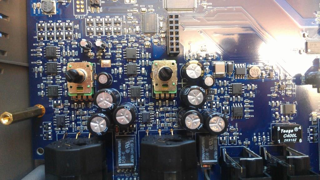

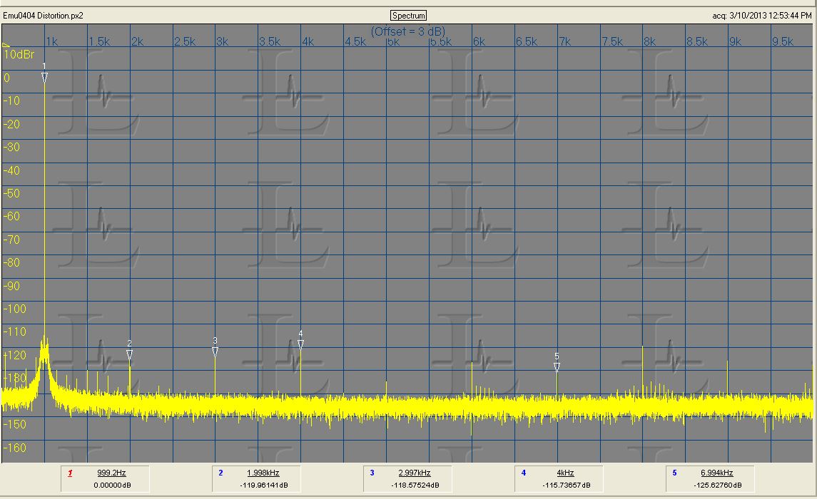

I was wrong about the EMU 0404 USB. It uses a different ADC, the AK5385. I'm attaching a photo of the pcb (I have higher res if someone needs) and the distortion spectrum.
Notes- over 1V and the input circuit distorts, pretty much regardless of the gain setting. Turning it up and reducing the input just raises the noise floor. This was 500K point and 7 averages at 96K sample rate. Its not stable enough to use at 192K. I may yet finds whatever is interfering and fix the sample rate.
Source is my ShibaSoku 590AR generator. Its residual is at least 6-10 dB better.
Its pretty good, not as good at the AK5394A demo board.
The other EMU's I have are not working as well on Windows. I may need to reinstall the drivers again.
Hi Demian,
That's the same ADC as the 0204. I'll bet EMU uses the same input circuitry.
Are both channels balanced or is one unbalanced like the 0204?
The behavior was the same on the 0204 until I balance the differential signals into the ADC inputs. Scaling to 1Vrms by increasing the gain at the ADC input gives you an extra 6dB on ARTA or the like. The software must be recal'ed for the 1Vrms (0dB) to see this.
I guess the second picture answers the question.
Maybe I take a look at the balanced left channel on the 0204 and see what EMU has done.
For now input 1Vrms, increase the gain to just below clipping. Input -10dB to -20dB or what ever gives a clean result. Calculate the Vrms for that level and use that amount to cal the software. You should see a difference.
