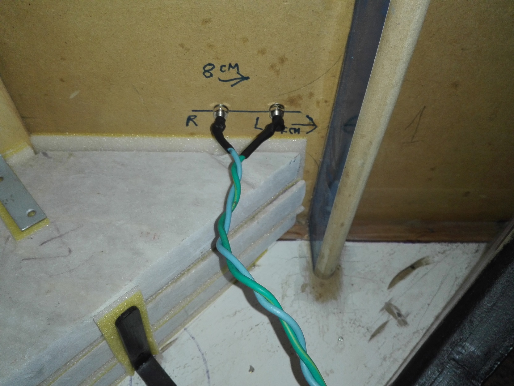

As you all have seen, car manufacturers do not care too much about the appearance of the bodywork in the hidden parts in general view. That is, interior of the engine, floor, interior of the trunk and fenders, etc.
So why should I waste time on an impeccable termination for something that won't be seen ? 😀

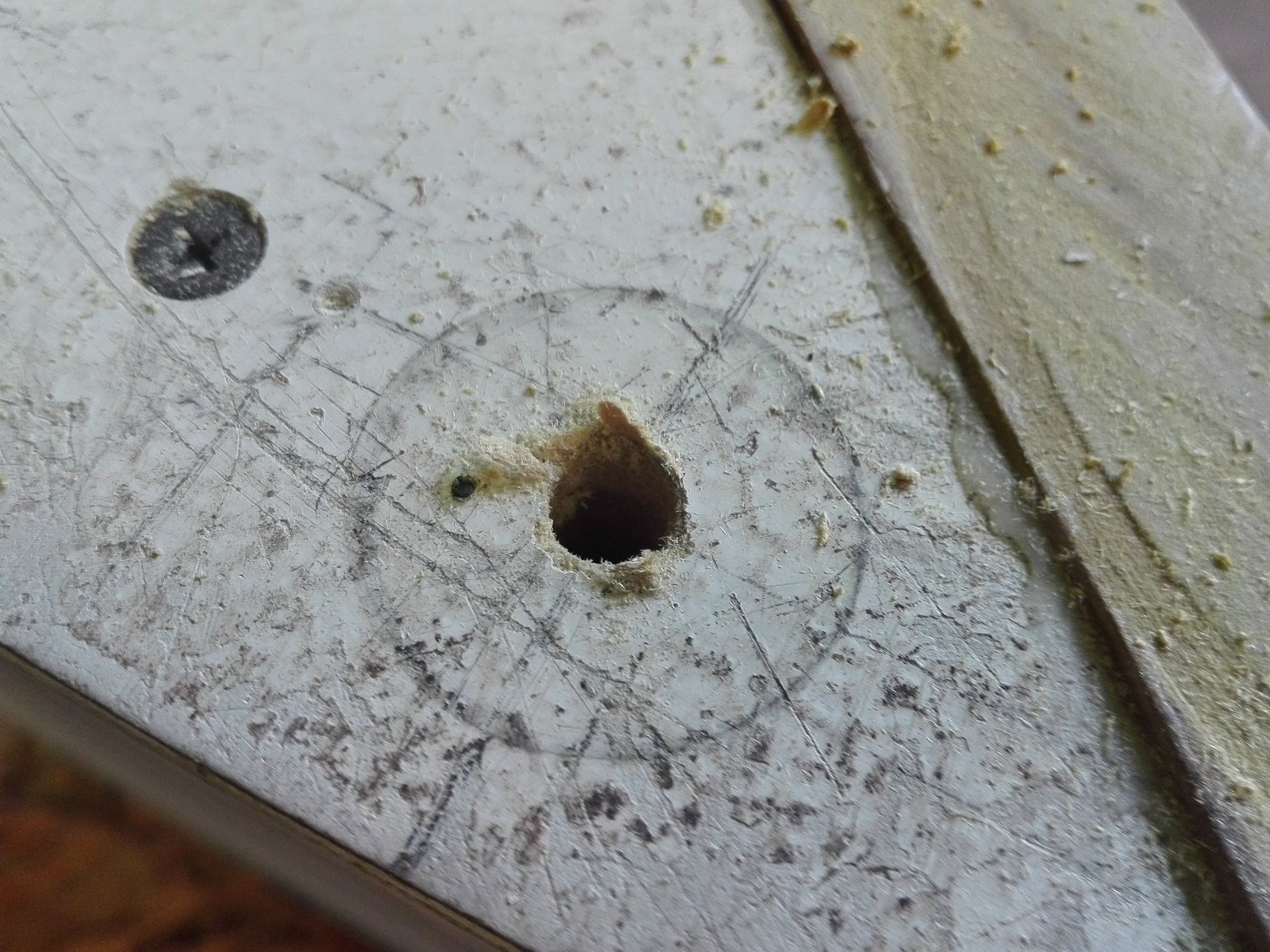

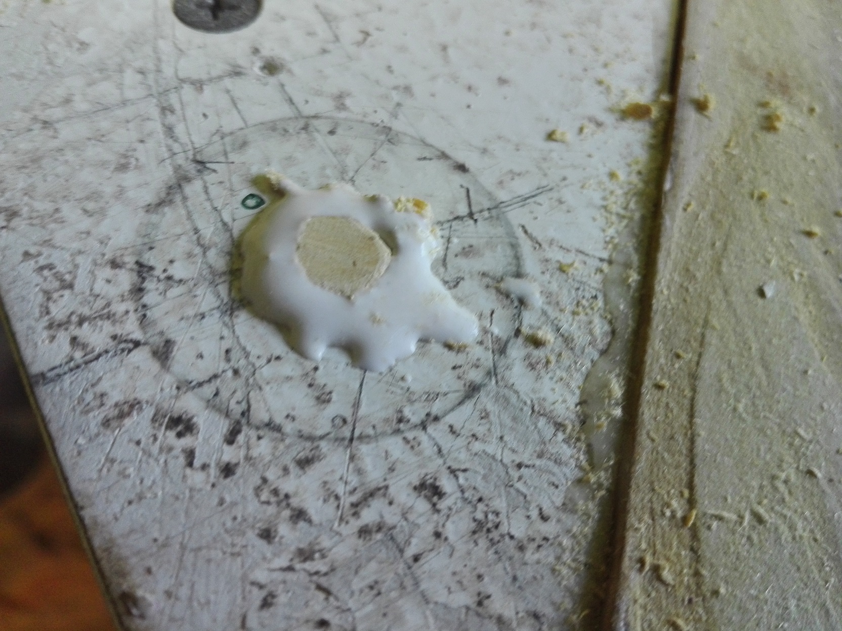

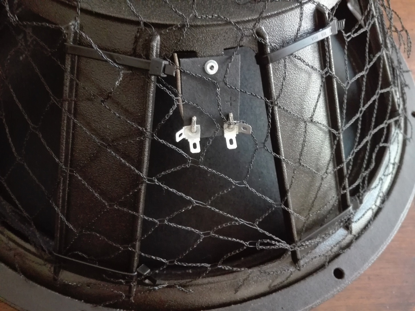

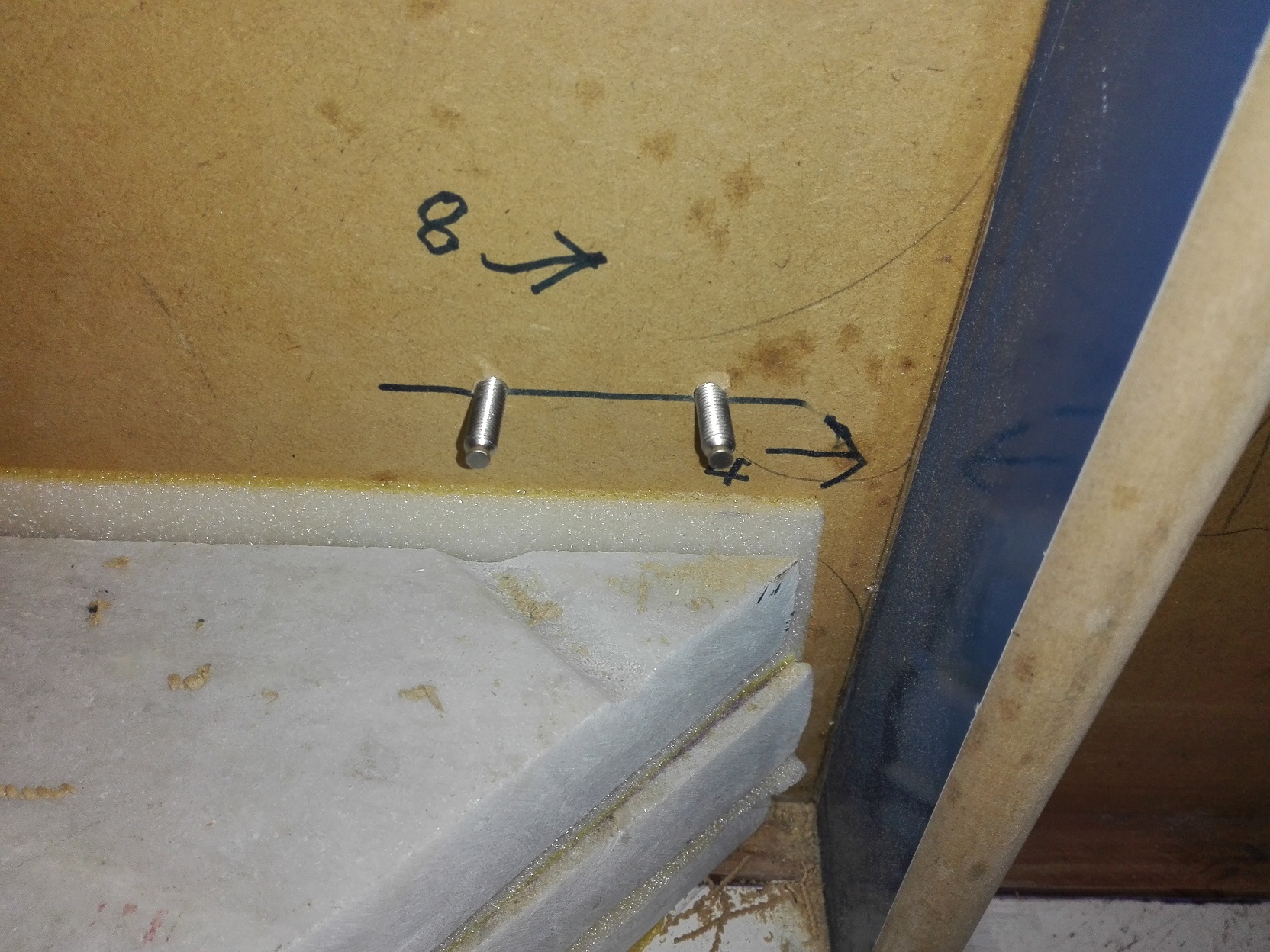

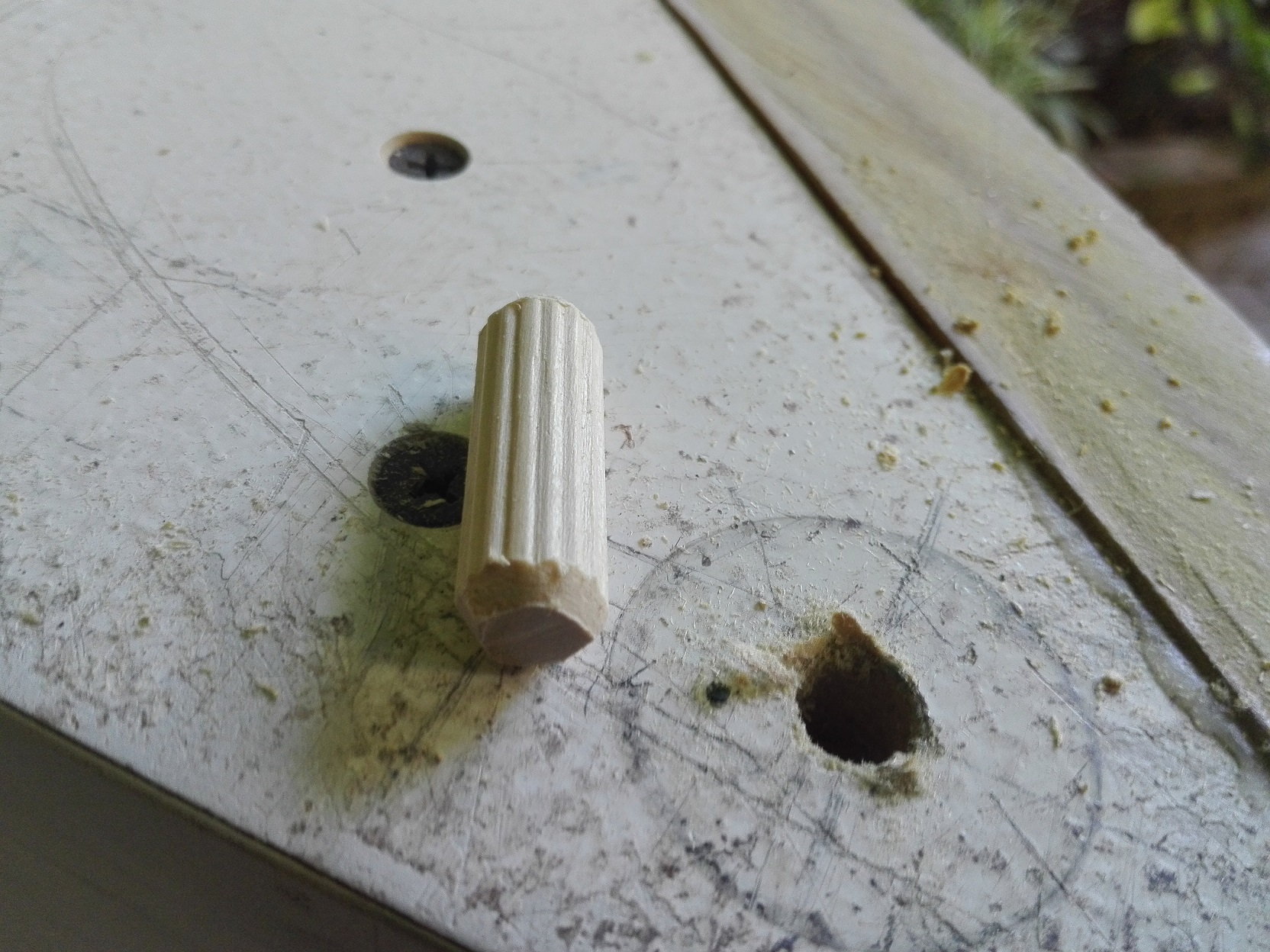

Some new screw of the legs was suporposed with a previous one. The solution is easy, you take it out, place a dowell with a tail, cut it out and that's it.

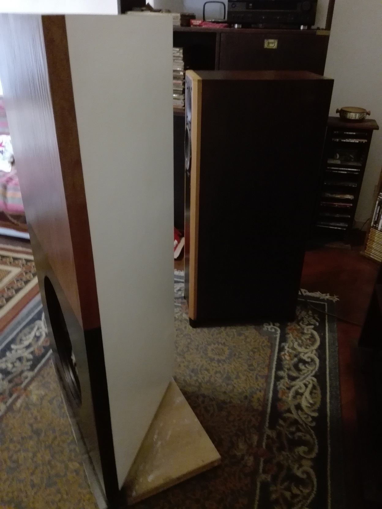

The furniture had to be turned upside down to work, so it was essential to secure the marble block. A piece of wood and a wedge makes it very simple.

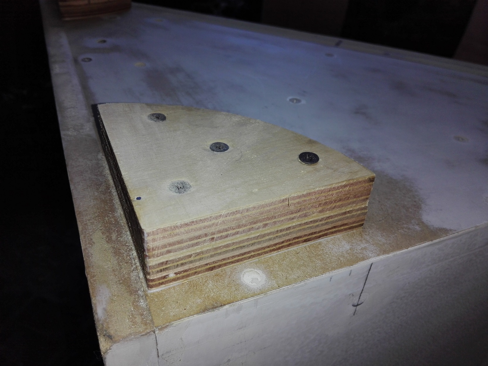

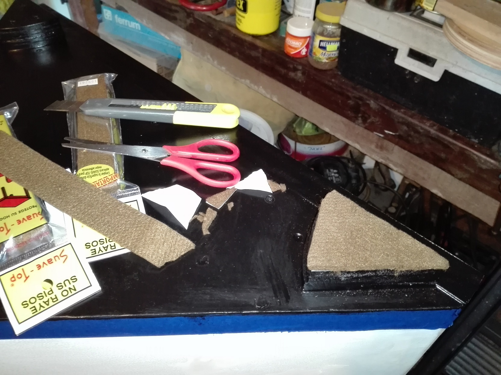

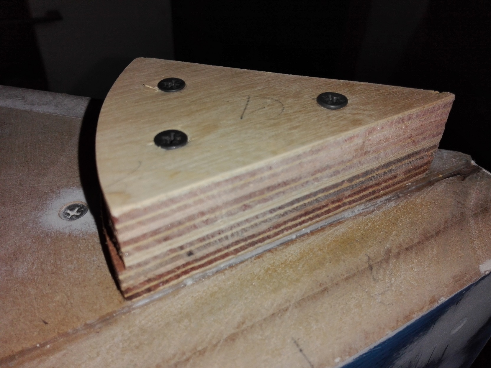

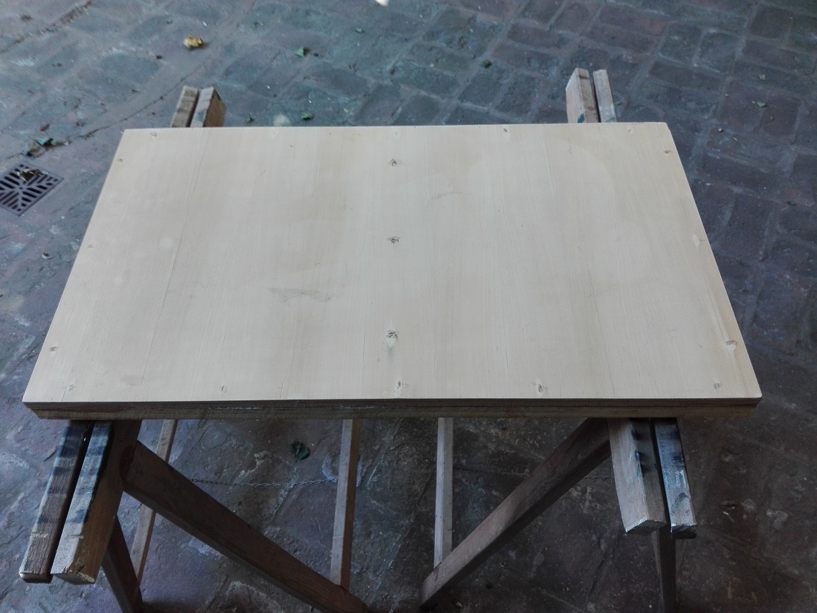

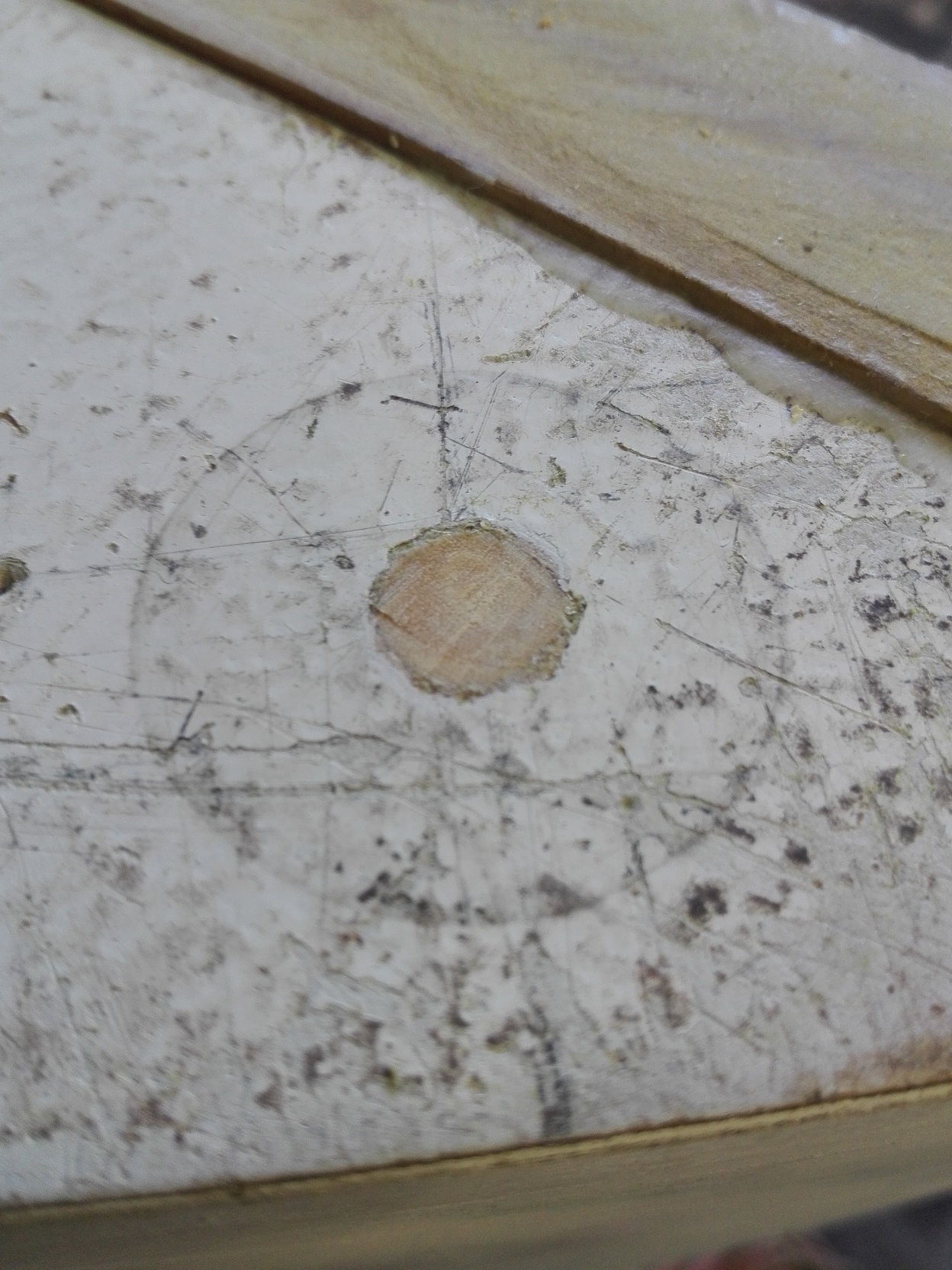

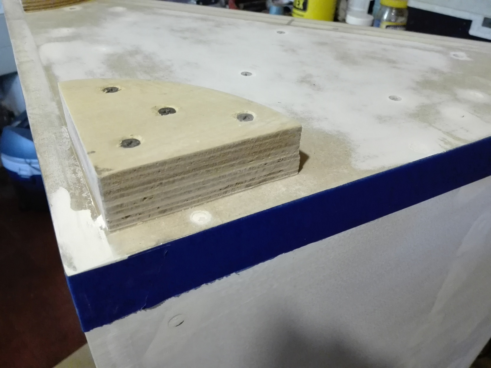

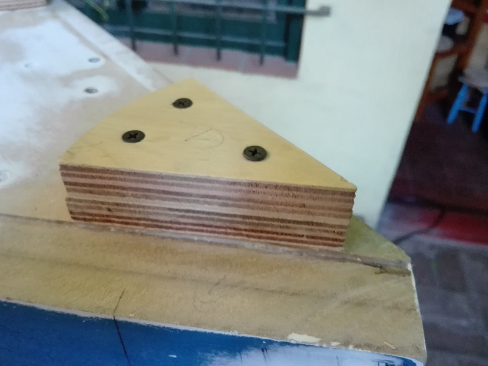

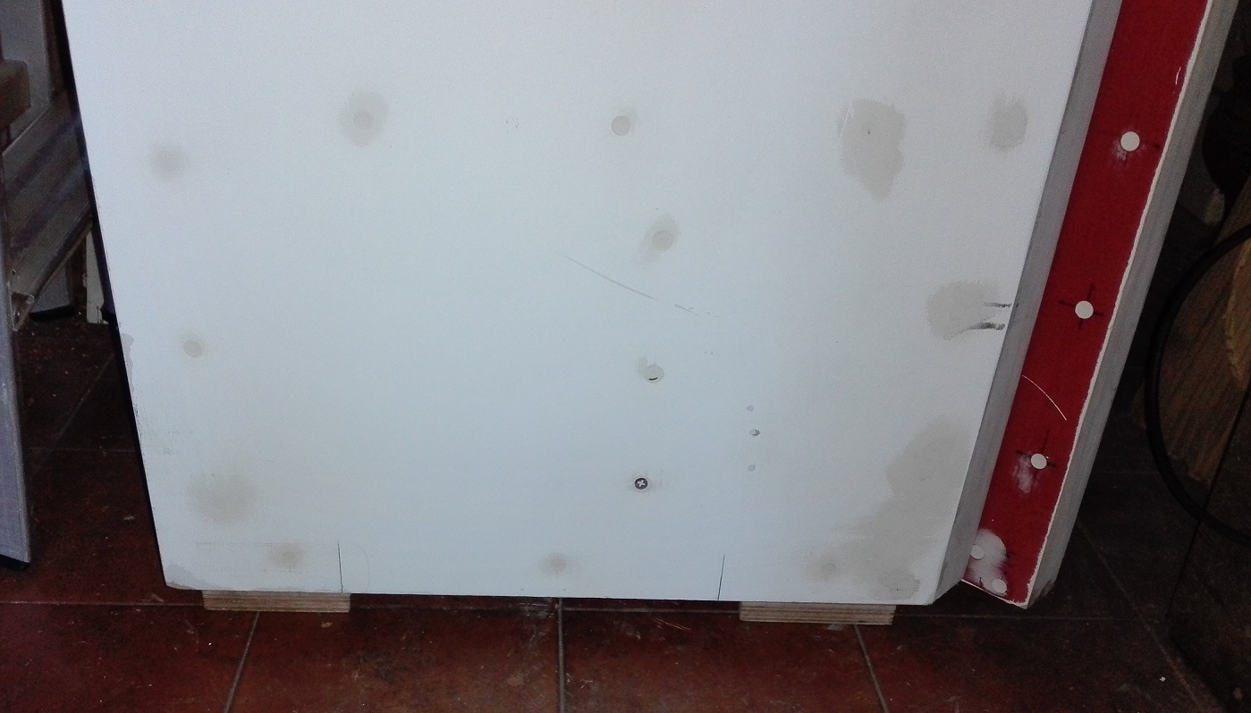

Latest photos, these feet sit very well on any surface, three are better than four ....😉

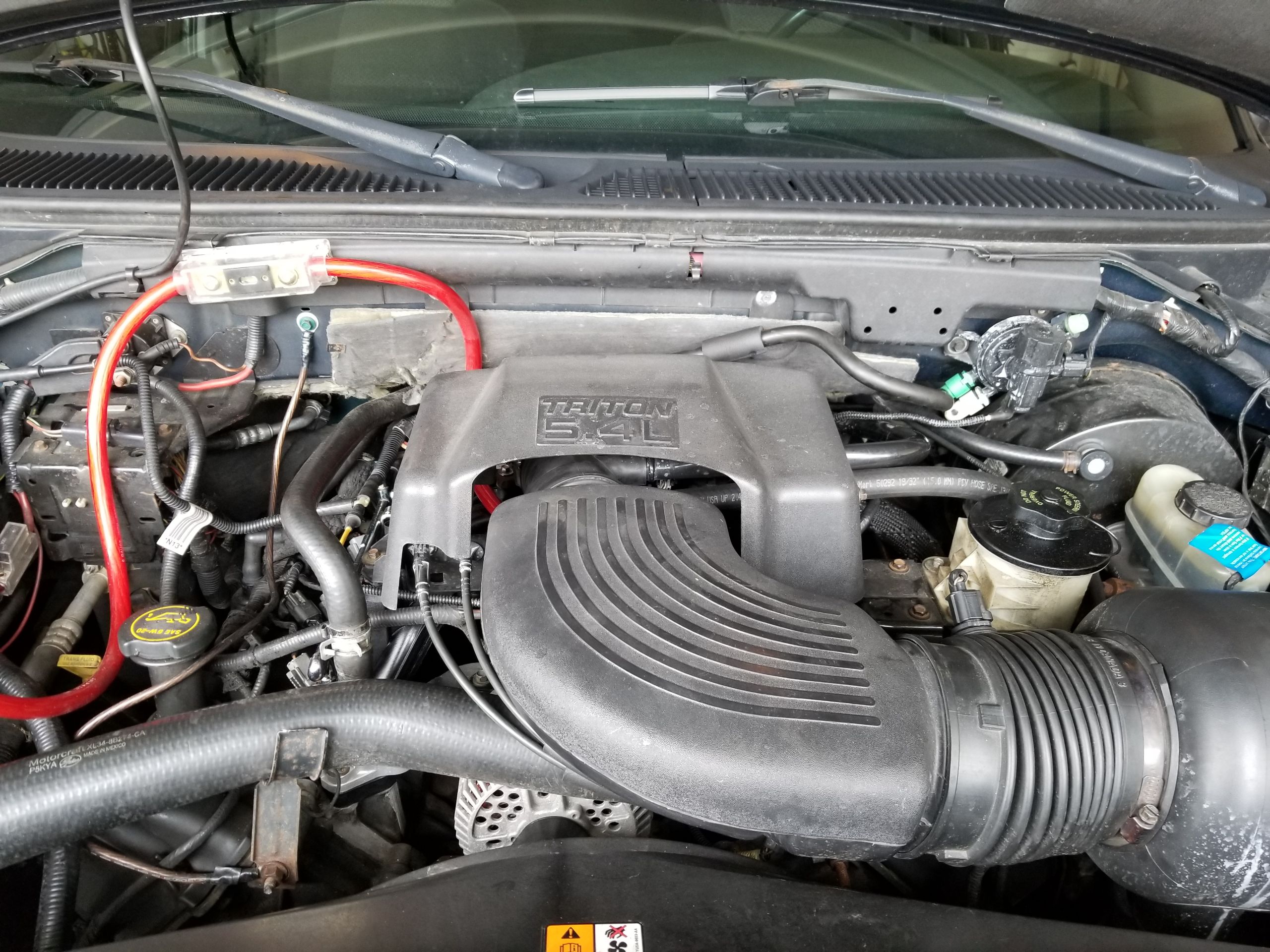

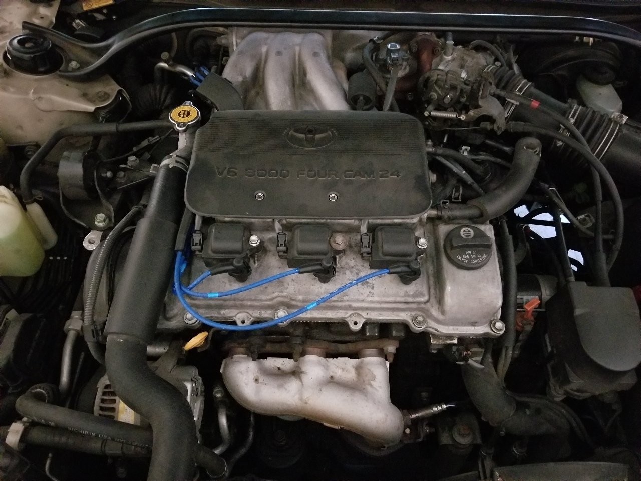

Well, some cars do come with engine covers and a subwoofer in the trunk. My old 2000 Toyota Solara SEV6 has a cover over the emission system.
After searching for the Solara's pic, I found my ex-2001 F150 Supercrew 5.4L engine cover too!

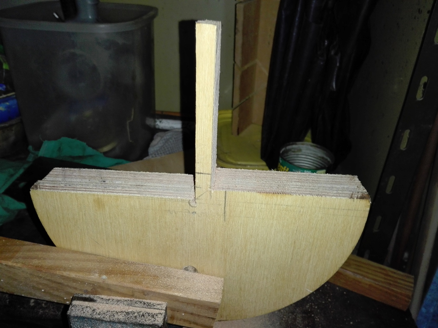

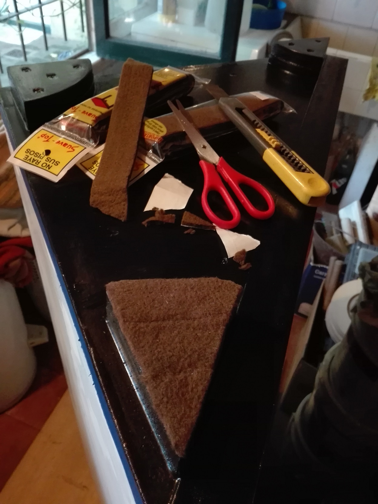

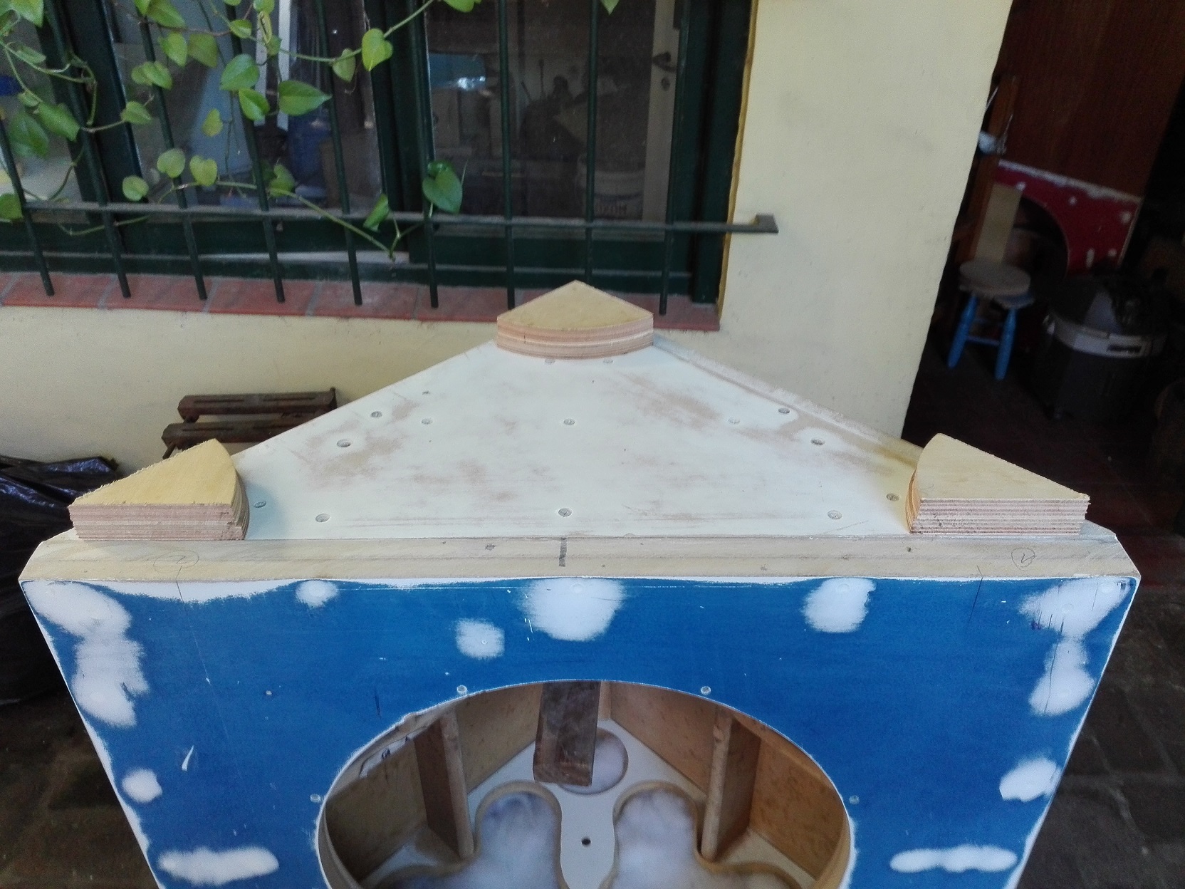

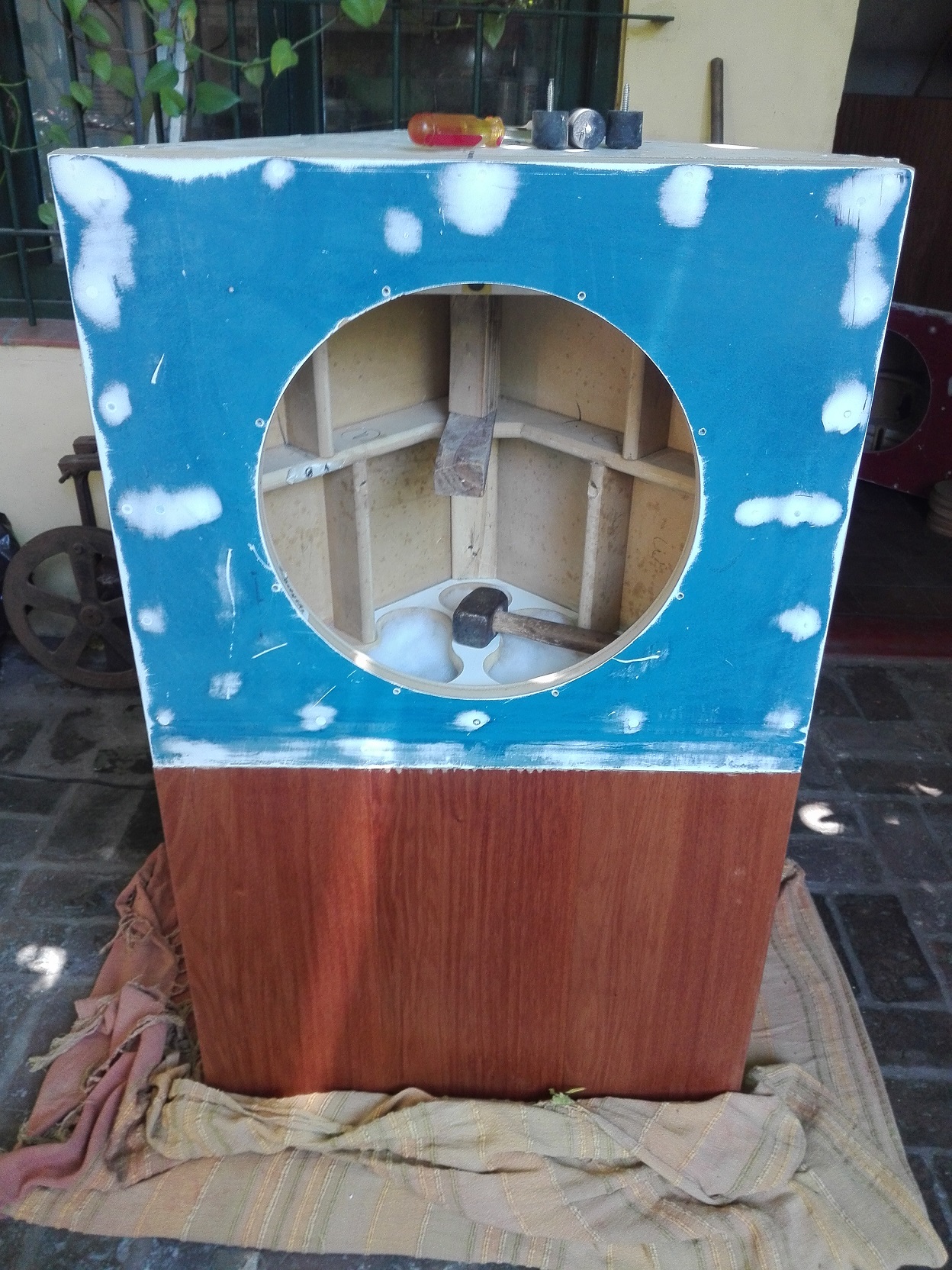

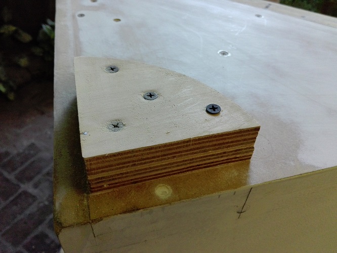

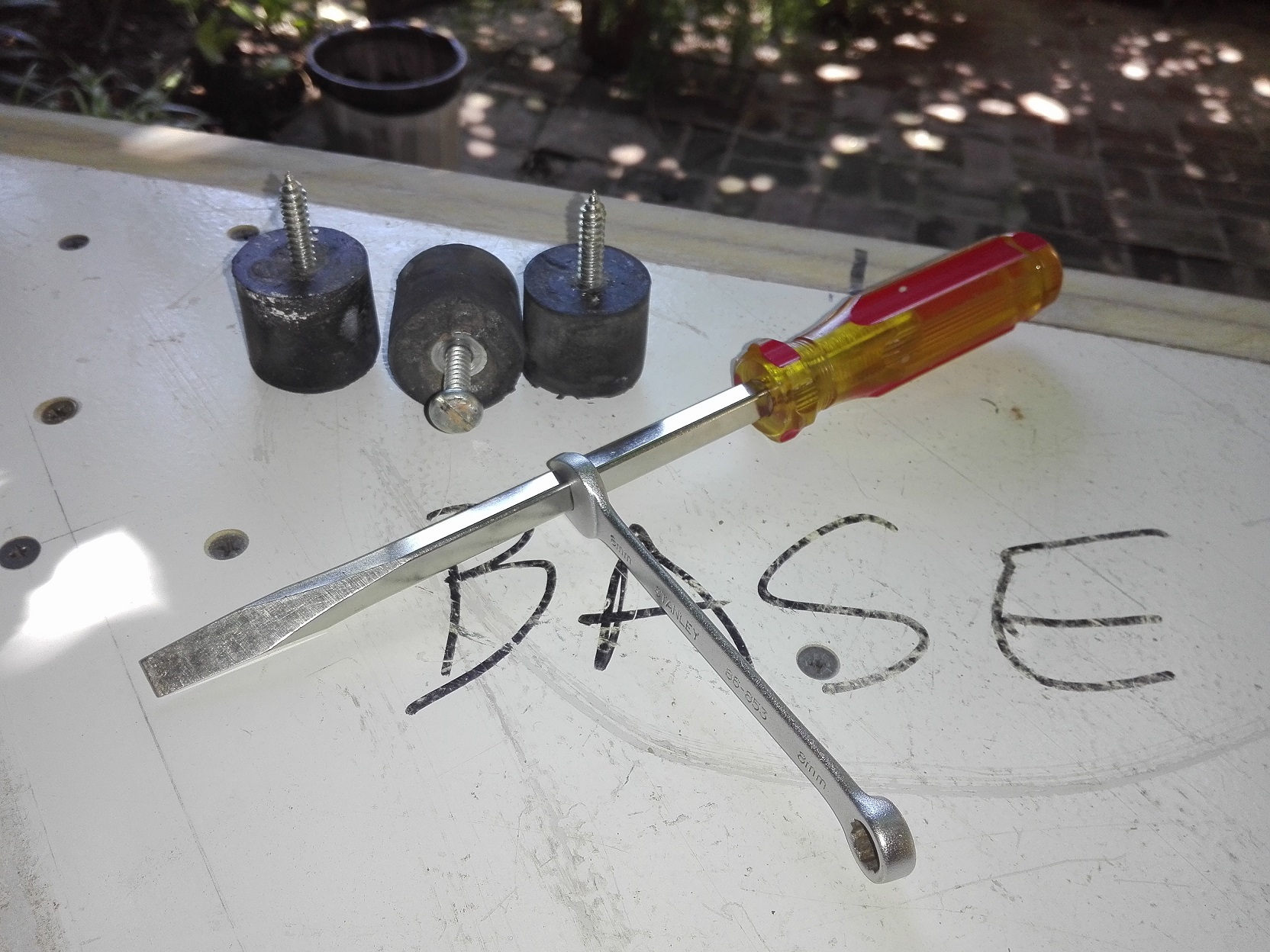

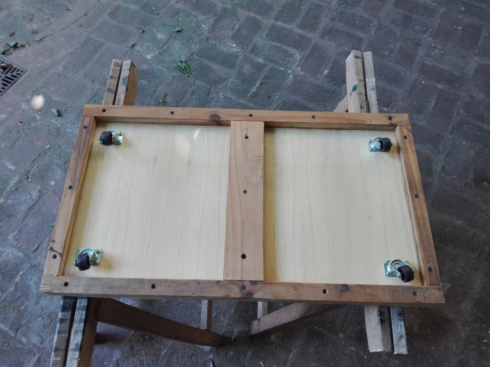

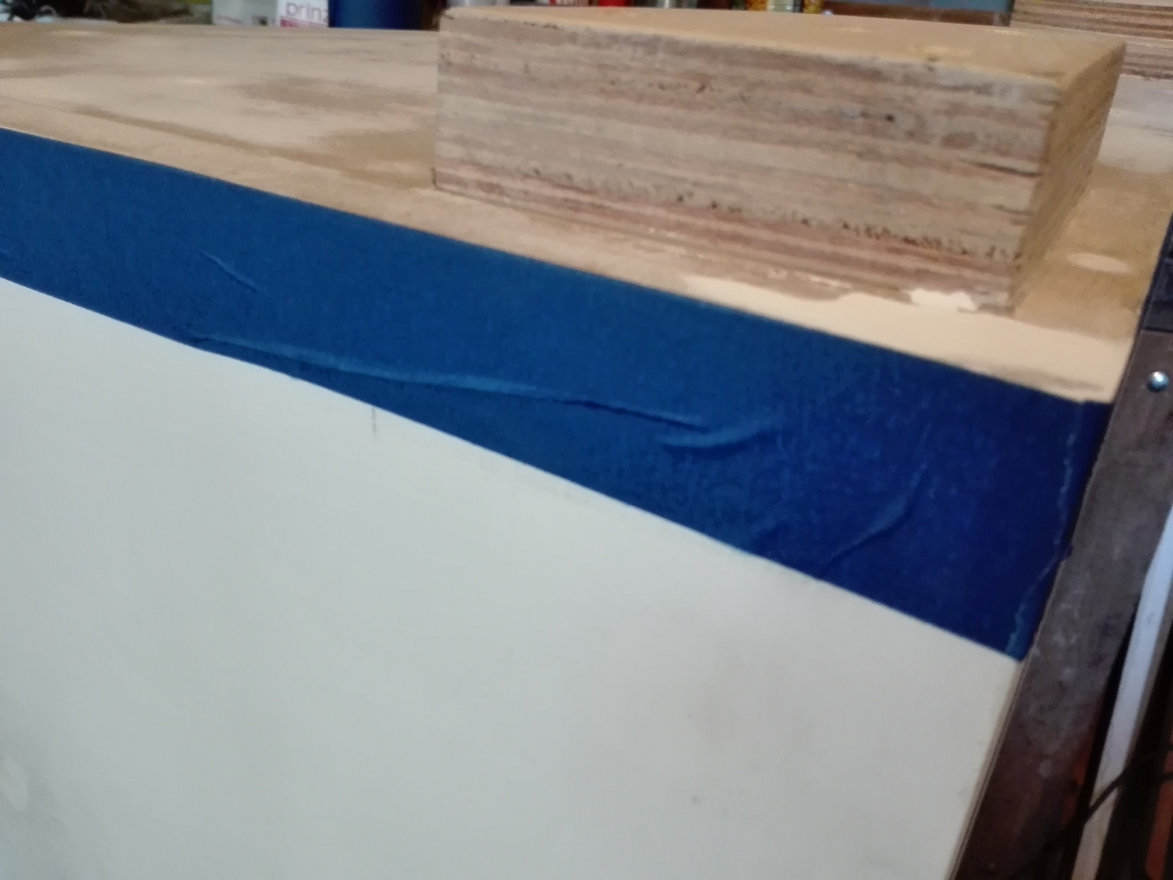

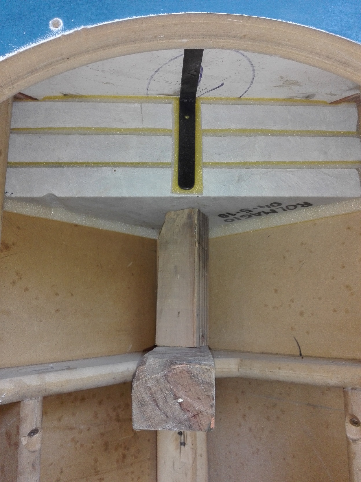

The base is finished and I have placed protectors on the legs. As I will have to paint with an outdoor spray, manipulating this furniture from now on will surely damage the plush.
So I have prepared a "bed" with wheels. 🙂
Only I will have to ask for help to lift the beast and support it on it ... 😱

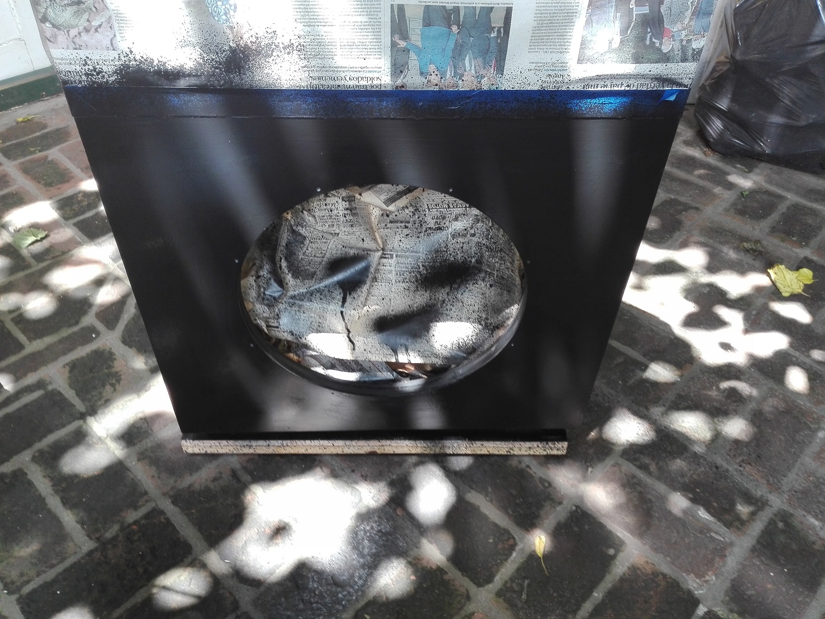

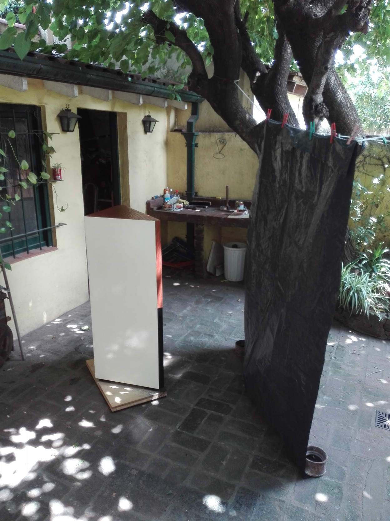

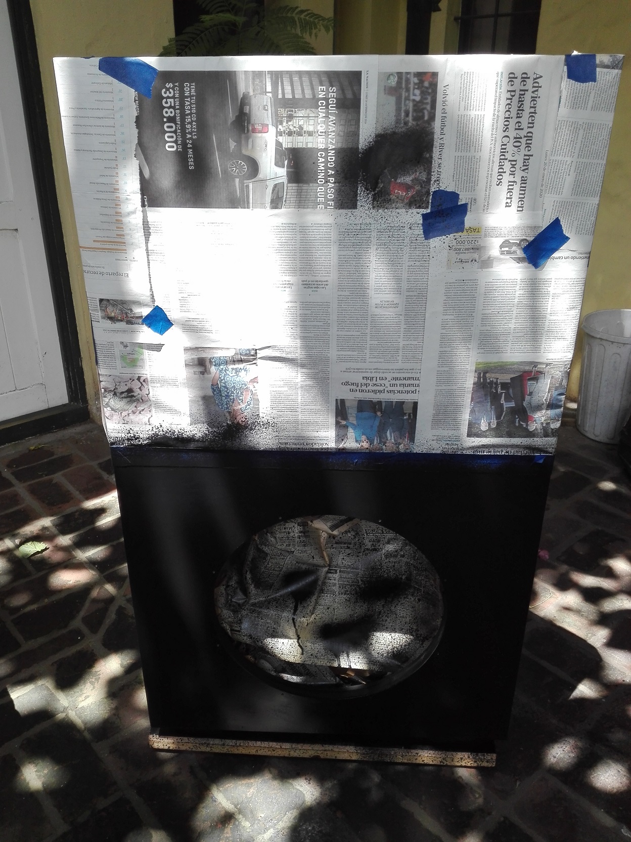

There is no rain forecast in the next few days around here,
so I got help to mount the cabinet on the platform, and tomorrow I will apply the spray paint.

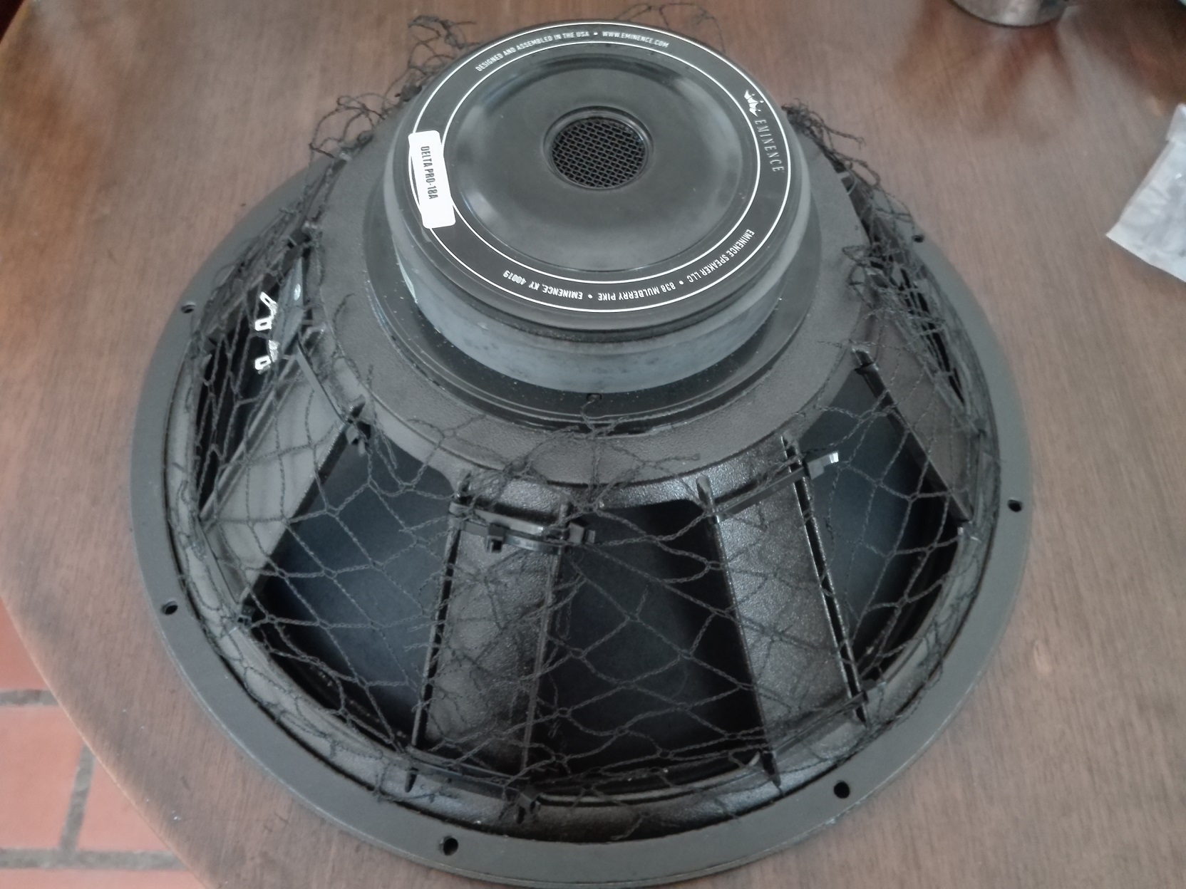

I do not put it on the weight scale of personal use of the bathroom .... but this is very heavy !
80 kg? I think that is the approximate weight, and the speaker is missing ....😀

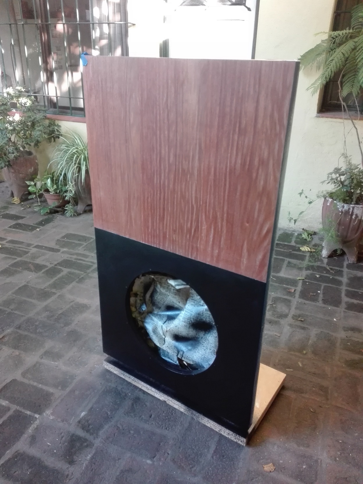

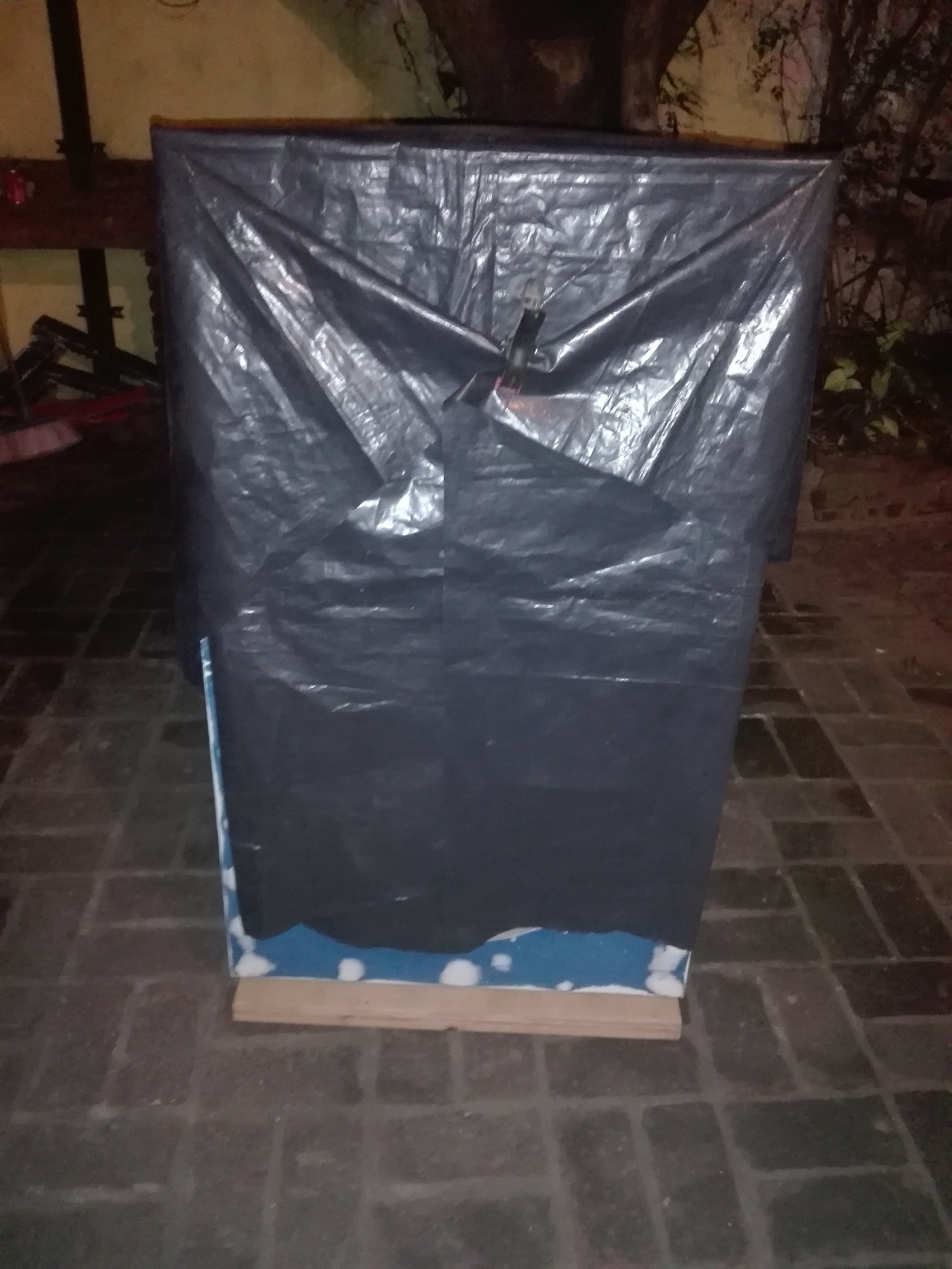

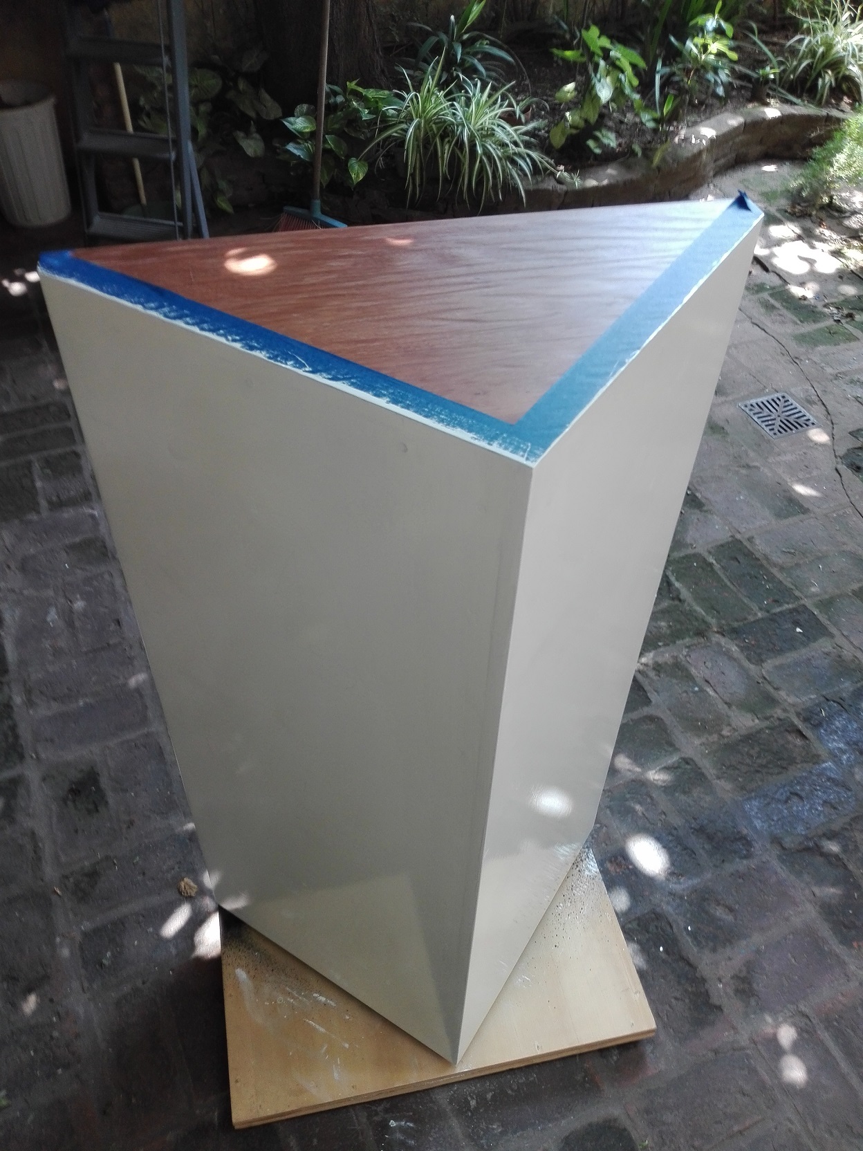

Finally there was rain, so I could apply a single coat of black.
Is it that the satellites do not work well or the climatic changes are so sudden that they do not give time to correct the forecasts ?

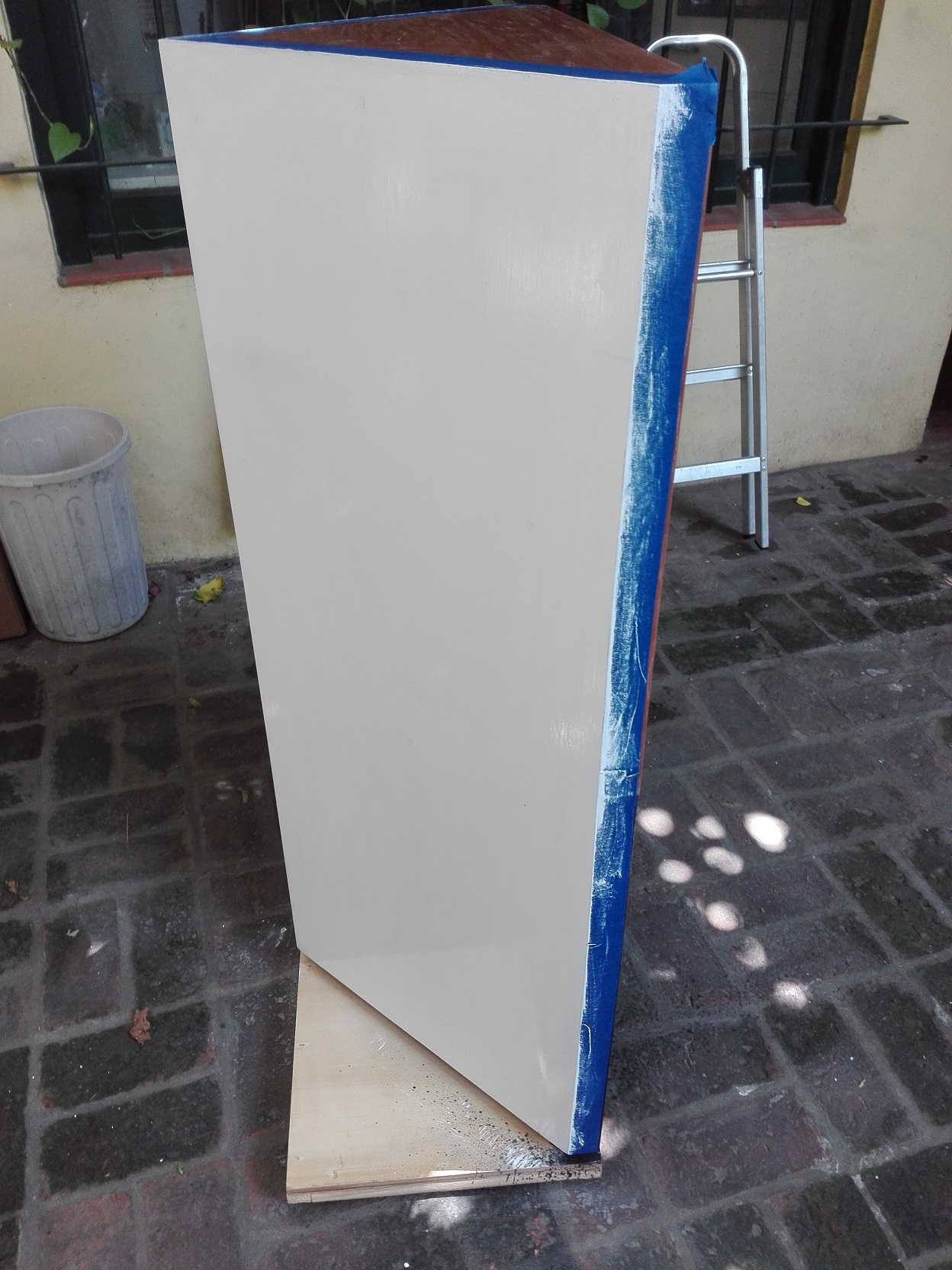

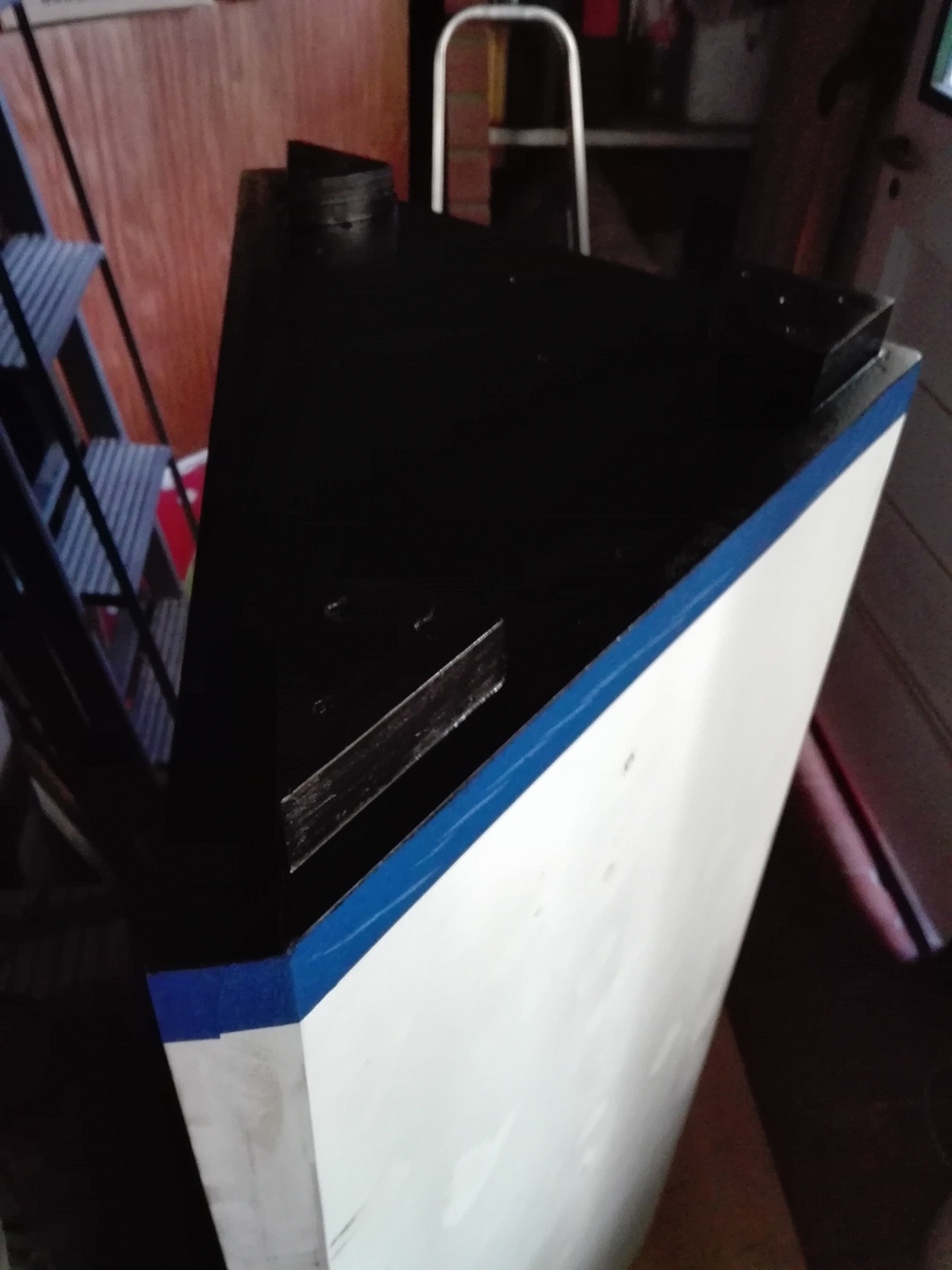

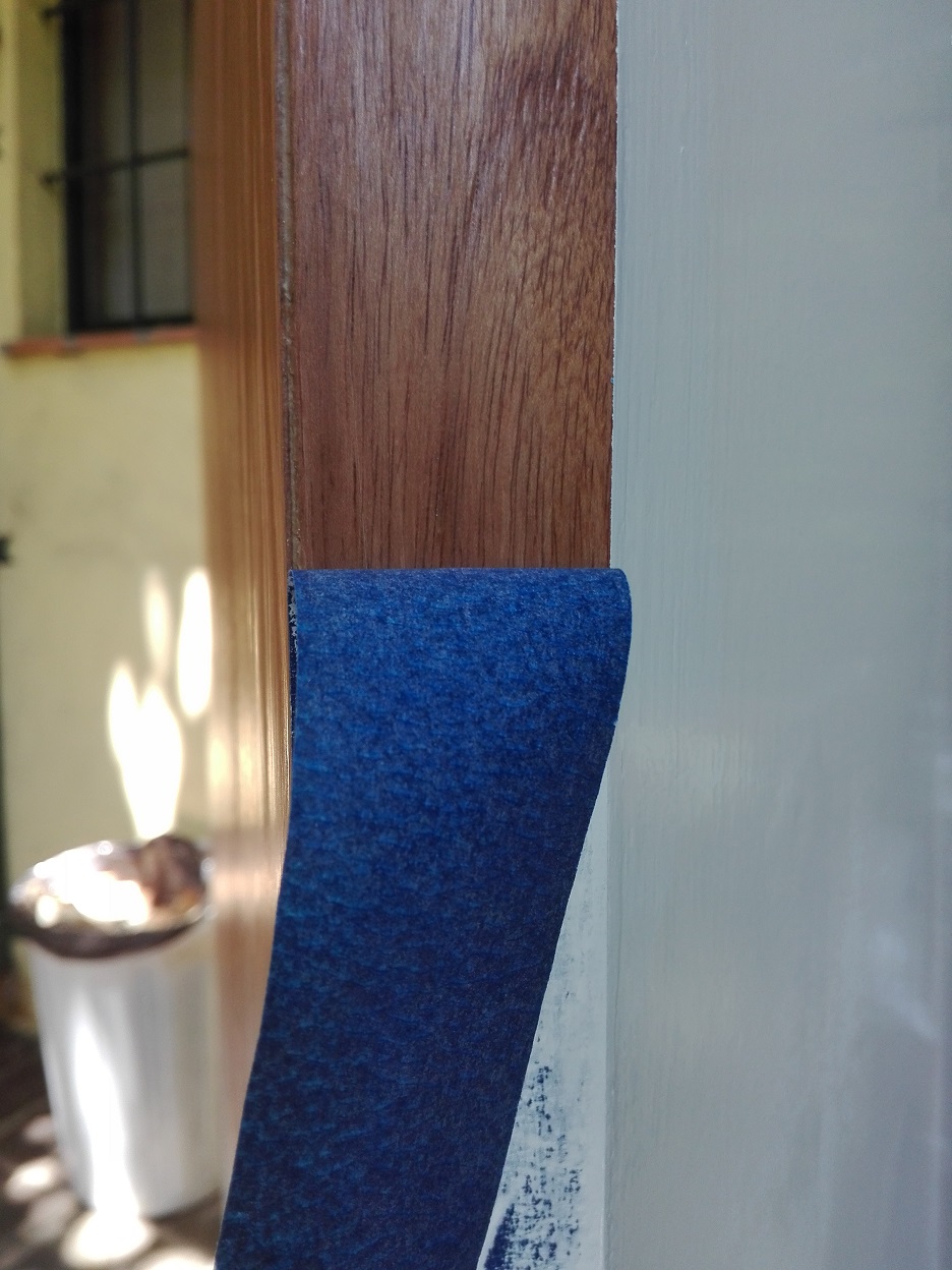

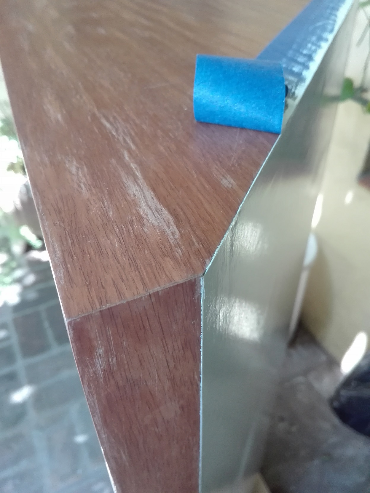

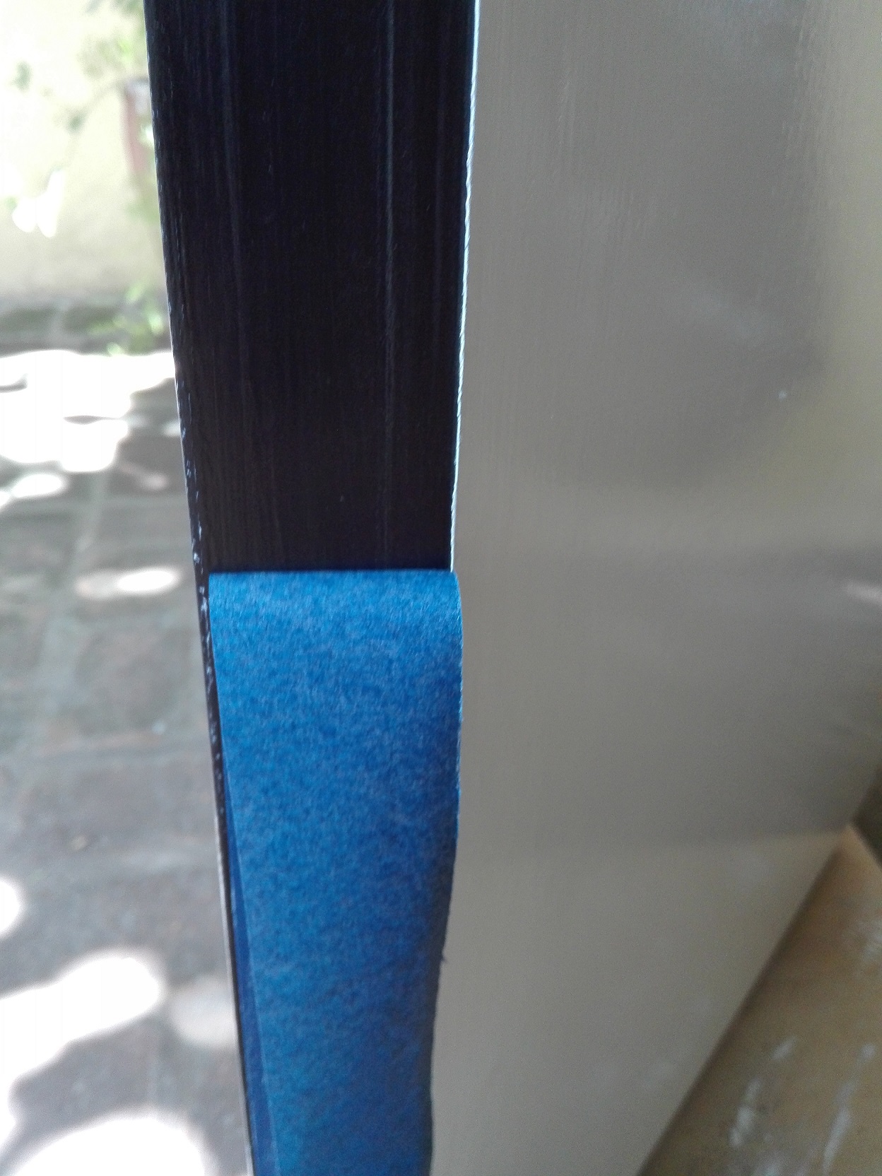

The next step is two hands on the entire front of semi-matt varnish, I do not like too much gloss ....😎
White is also semi matt, it was applied by brush.

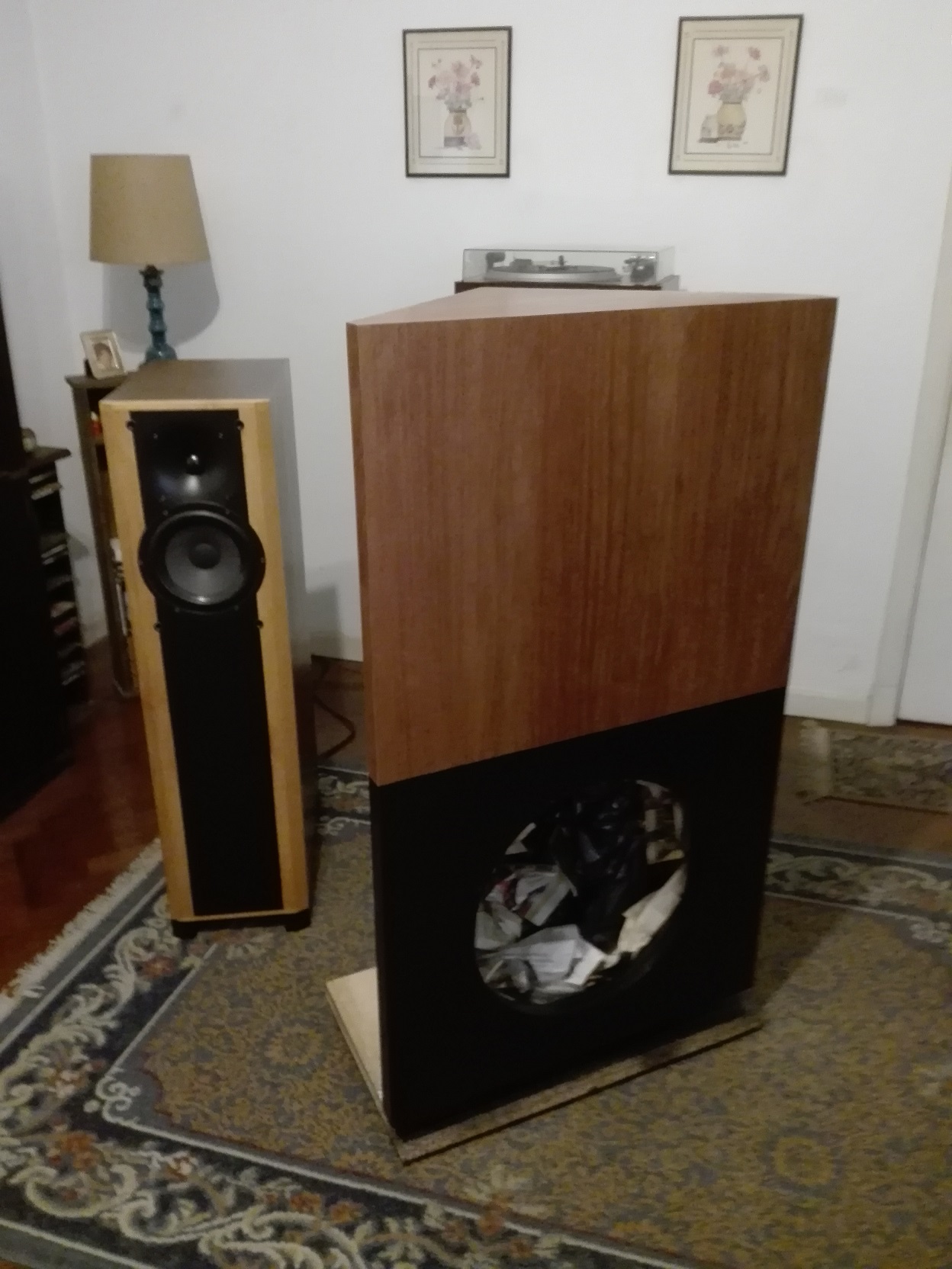

The cosmetic process of one of the cabinets is already finished.

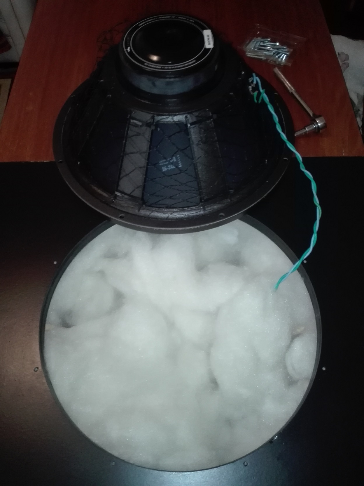

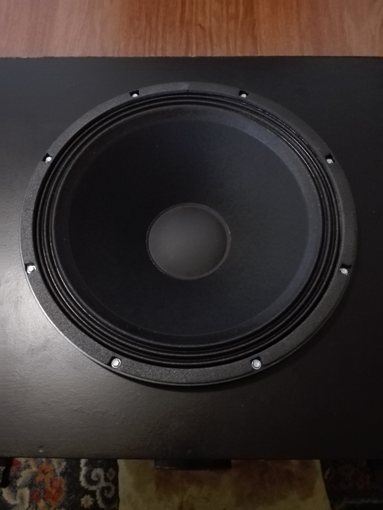

I will place the speaker and make it work in the corner that you can see in one of the photos.
Then I will continue with the remaining subwoofer and only there will I know if more power is needed, DSP, stereo subwoofers, etc. (All that would come along with the purchase of the Bheringer NX3000D)
There will be no measurements, microphones, REW, EQ of the room with MiniDsp, etc. Everything will be evaluated with my ears. They are not " golden ears ", but they have a lot of experience,
I trust them ! 🙂
The other speakers (DtqwtII) seem pygmy compared to these .....😱

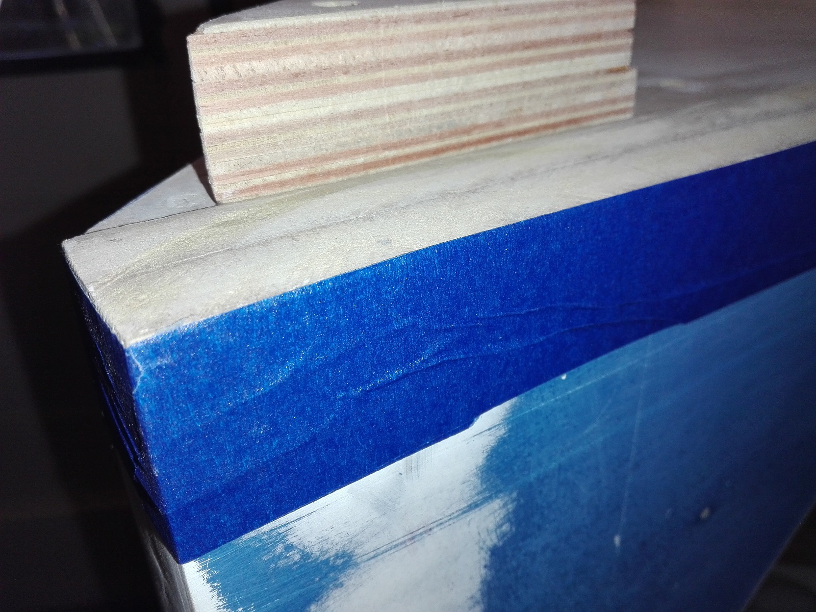

The final finish was applied with a roller, they were two layers of semi-matt varnish on all surfaces, not only on wood. Black and white acquire a very pleasant hue.

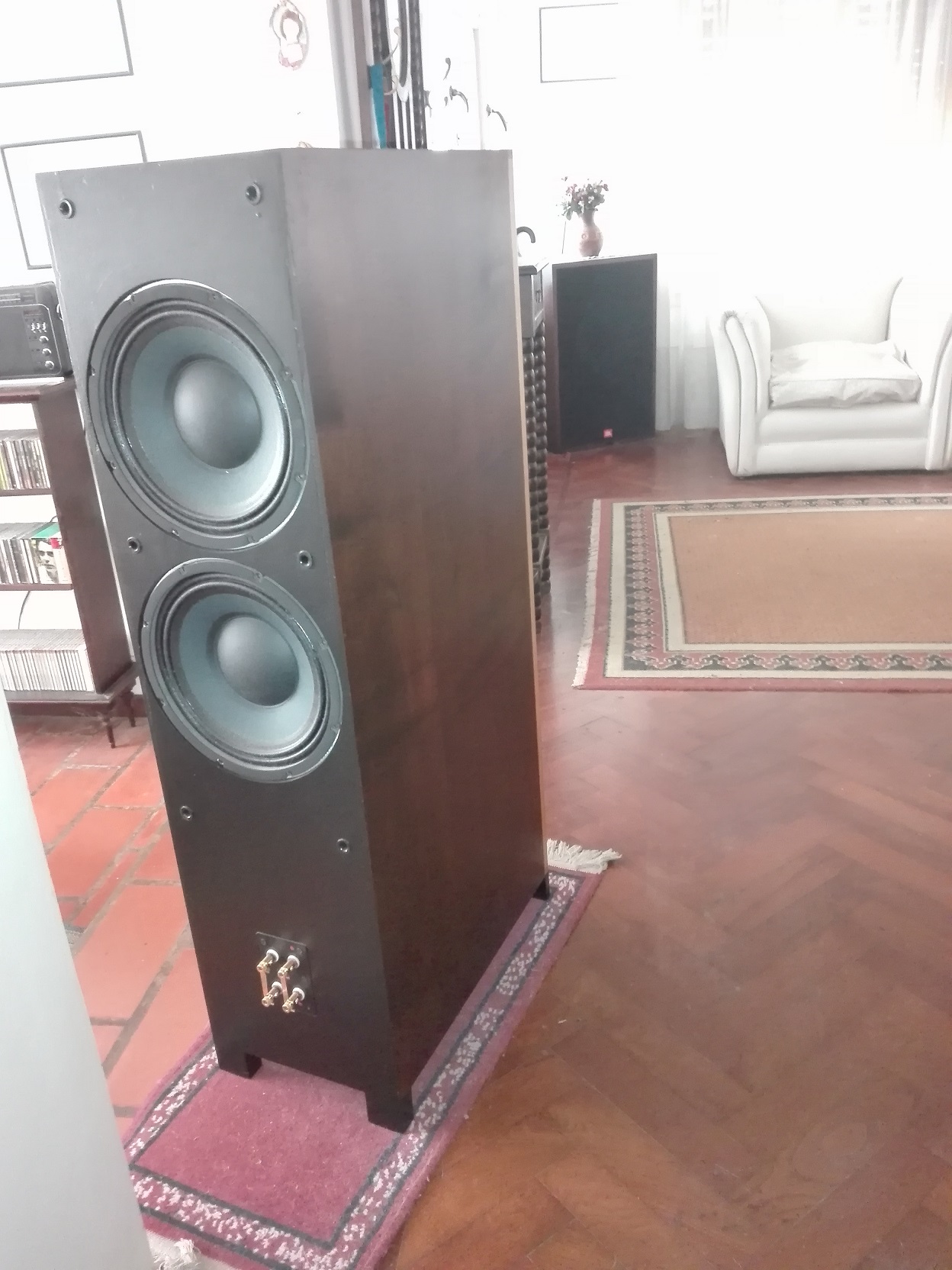

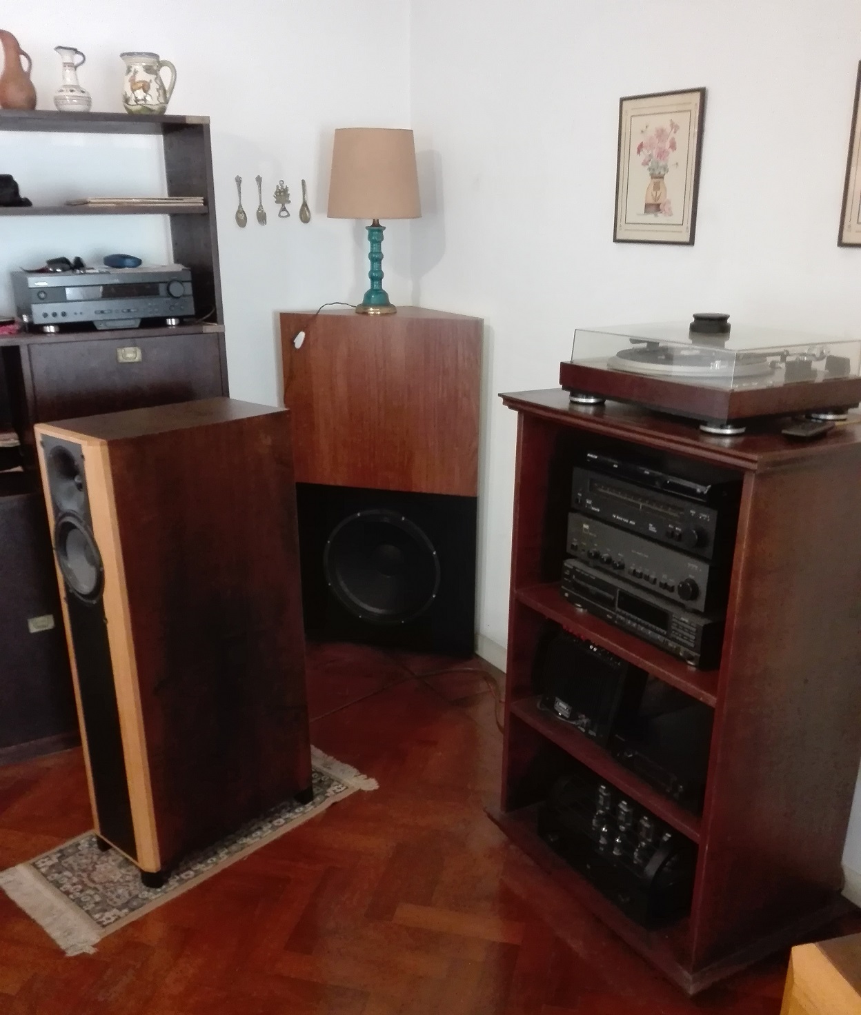

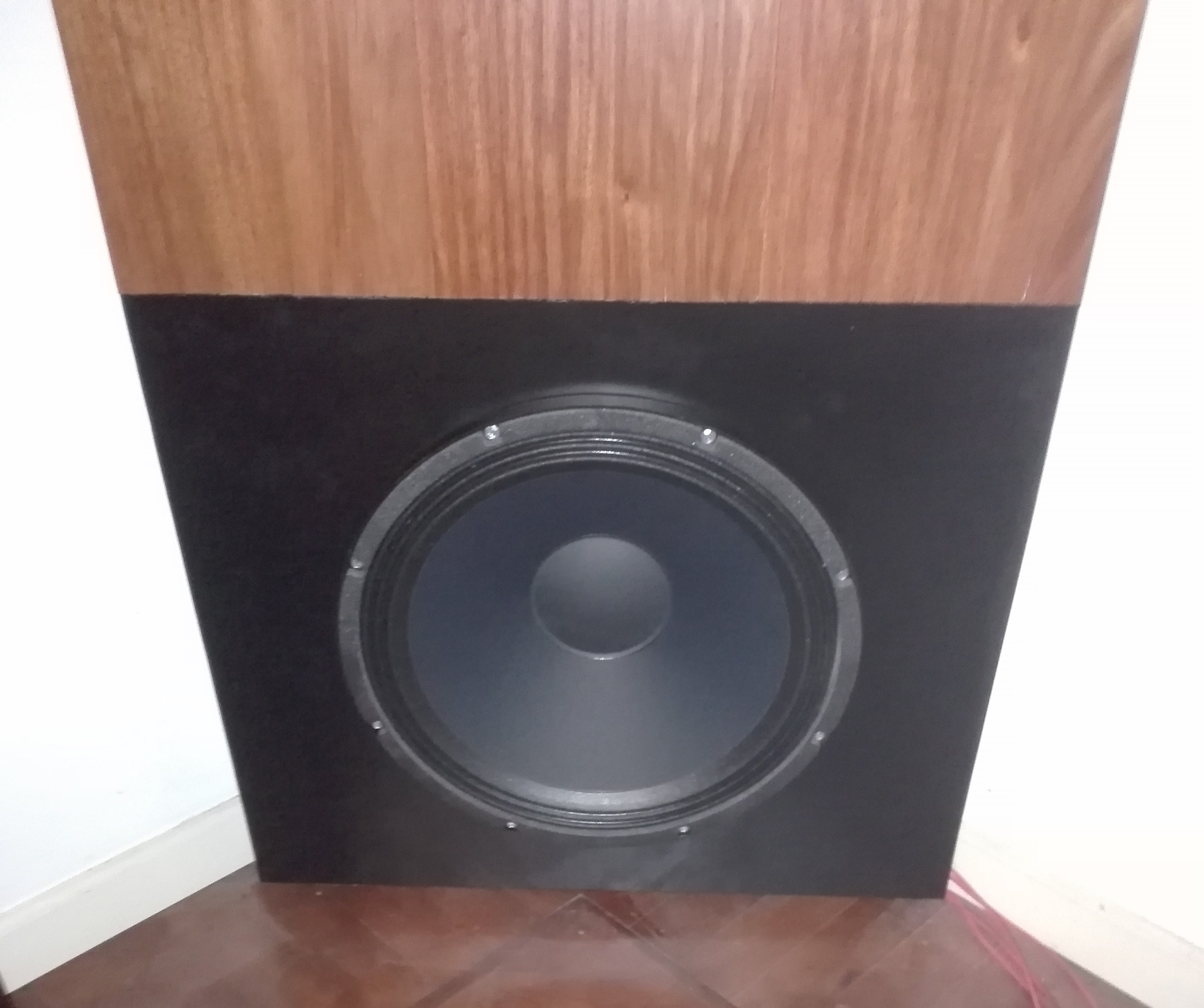

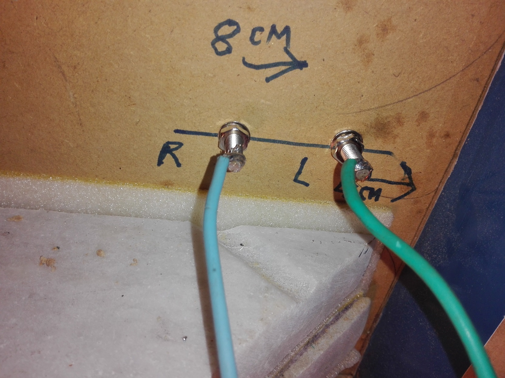

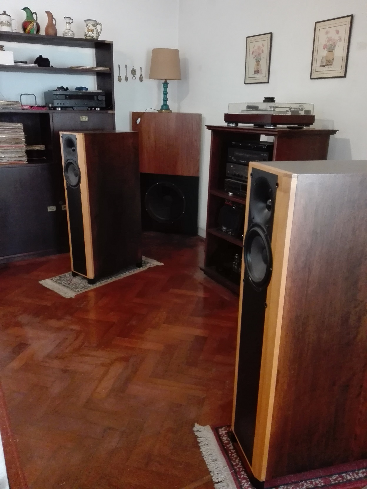

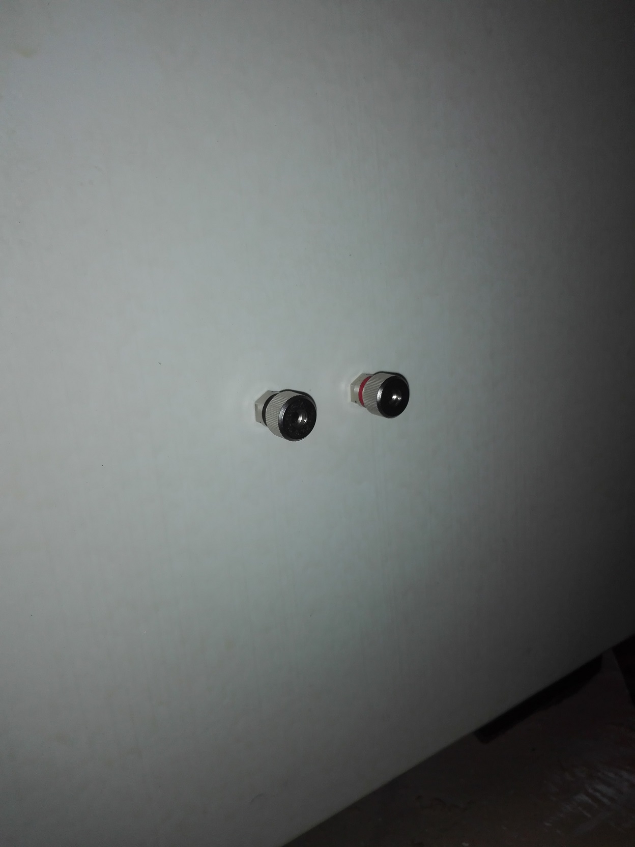

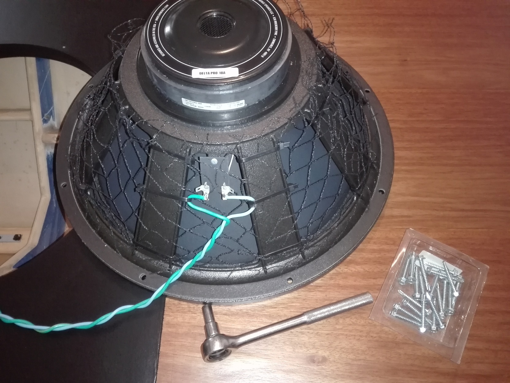

One of the two "corner" subwoofers is finished and in operation.
I fed it with 156 Watts Rms Class AB with 8 Ohms, 0.1% THD
When you connect the second cabinet in parallel, it will be 252 Watts Rms 4 ohms <1.0 THD
Without applying bass boost.
https://www.parts-express.com/pedocs/manuals/300-803--dayton-audio-spa250-manual.pdf
All expectations are widely met ! 🙂
The basses are very deep (20 hertz) but without the effect of "room load", which I had read is a characteristic of sealed cabinets. Here there is no "one box resonating inside another box". There is no "eave" effect either in DTQWTII or in this sealed cabinet.
The phase control was reversed, (180 degree offset) so that the Eminence Delta Lite 2510 II speakers of the Troels cabinets work simultaneously with the Eminence Delta Pro18A and do not override.

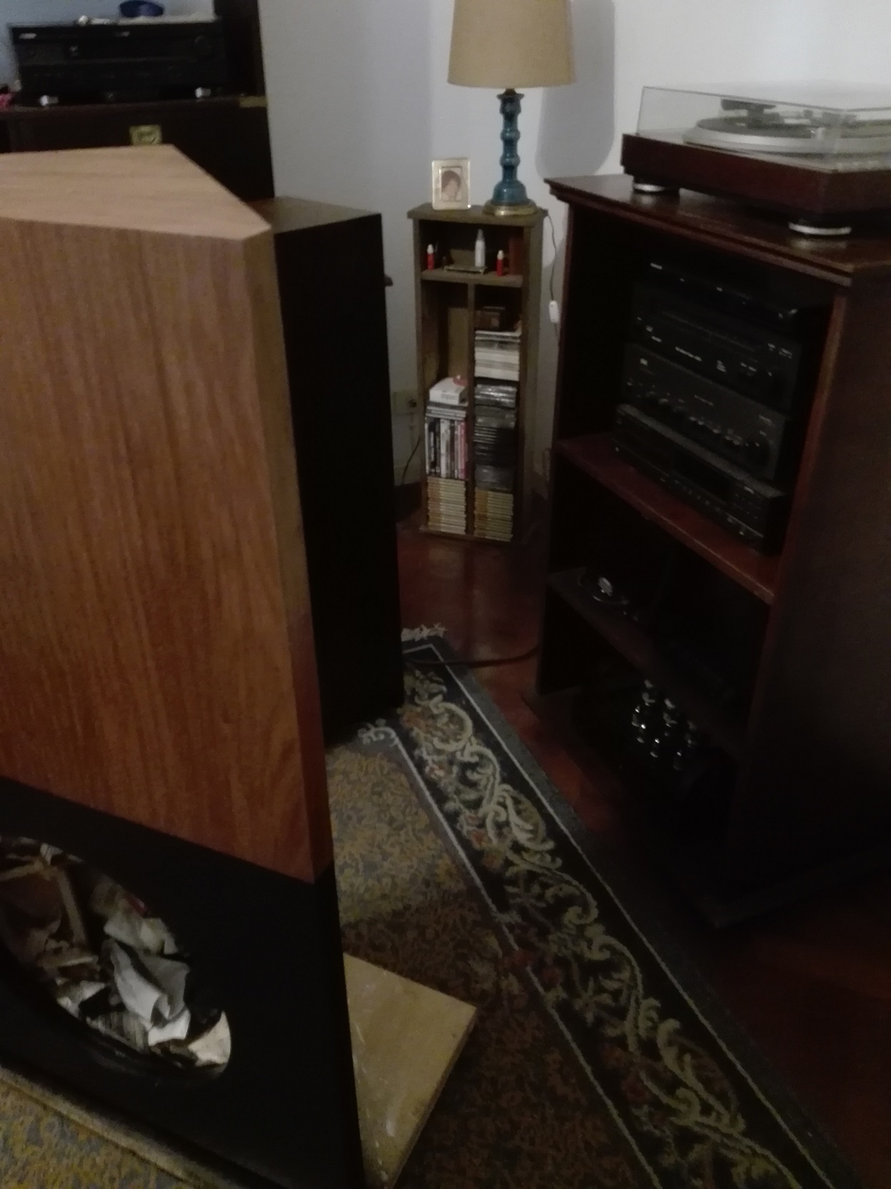

You can see in the last photo my previous configuration of subwoofer (two) of near field, now there is only one (I will finish the other one) but they have much more admissible power in the speakers, and although I lose "the back wave" of a BR of 80 liters, the gain of the corner, (4 Pi) the large SD of a speaker of 18 "and almost double the volume of the cabinet, (almost 150 liters estimated with the filling) far exceed the above.
I do not find "null" in different parts of the room, I attribute that to the irregular forms of it added to what has been said above about the "load" of the cabinets sealed with the room.
So (never say never) I will not change the Dayton board amplifier for the Bheringer with DSP, only if it is audible to go from 0.1% to <1.0% THD in the next step.

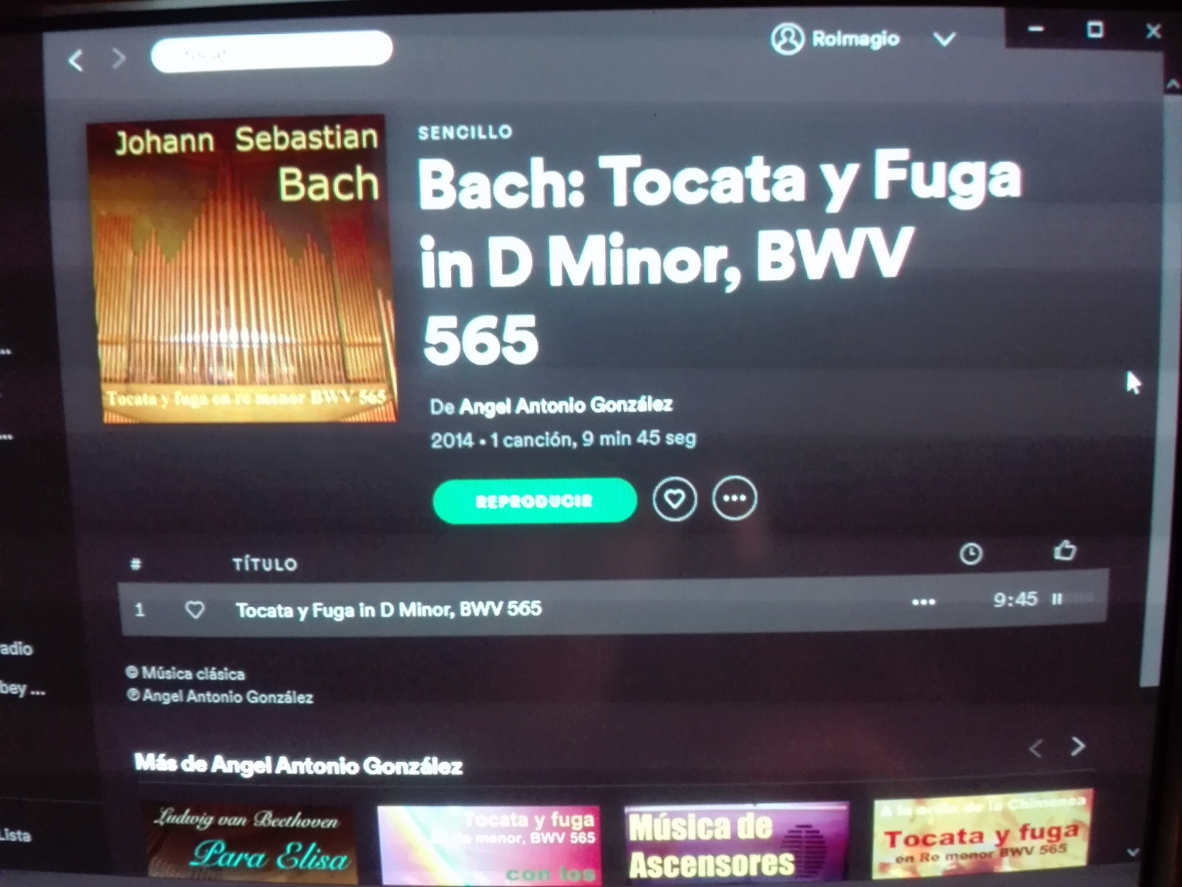

The sound of the DAC Oppo is really very good, the EssES9038ProSabre chip is excellent, so I looked first of all for organ music. I already mentioned that the subwoofer drops to 20 Hz, but in F6, so I selected the amplifier crossing at 50 Hz approx. (There are no marks of the crossover frequencies on the selector knob, the minimum is 40 Hz and the maximum 180 Hz) And the gain knob (volume) raises the smooth characteristic slope of sealed cabinets to F3 or perhaps less, I already mentioned There are no measurements here. Just good ear. Sorry for the lack of modesty here, but it's been years that I've been listening to sound systems of good caliber. And yes, there are frequencies below 20 Hz, the vibration of them on my listening chair is perfectly felt. And I have the subwoofer working in the far field now!
So I searched Spot..y, and chose this version of the famous Tocatta and Fugue de Bach. Again, very happy.
