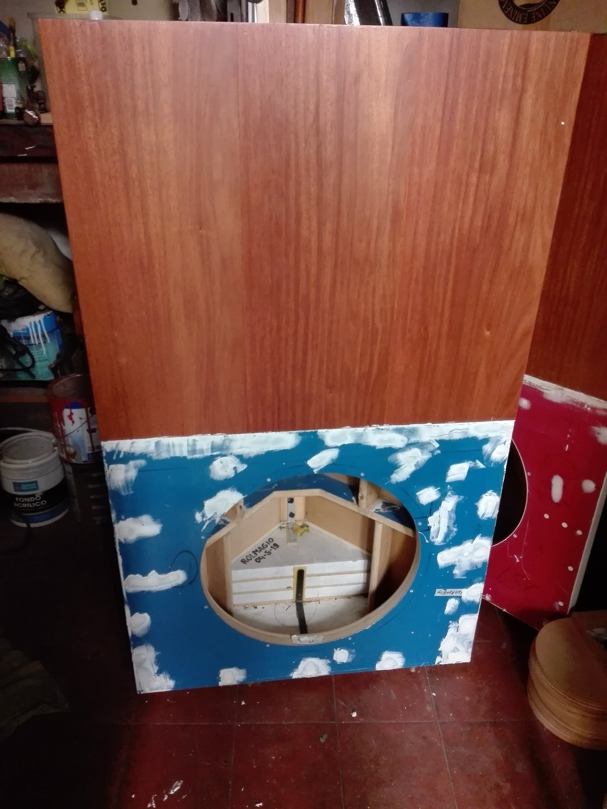

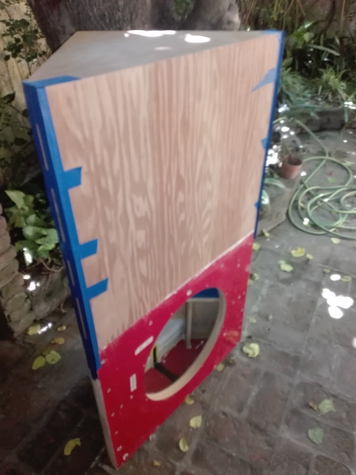

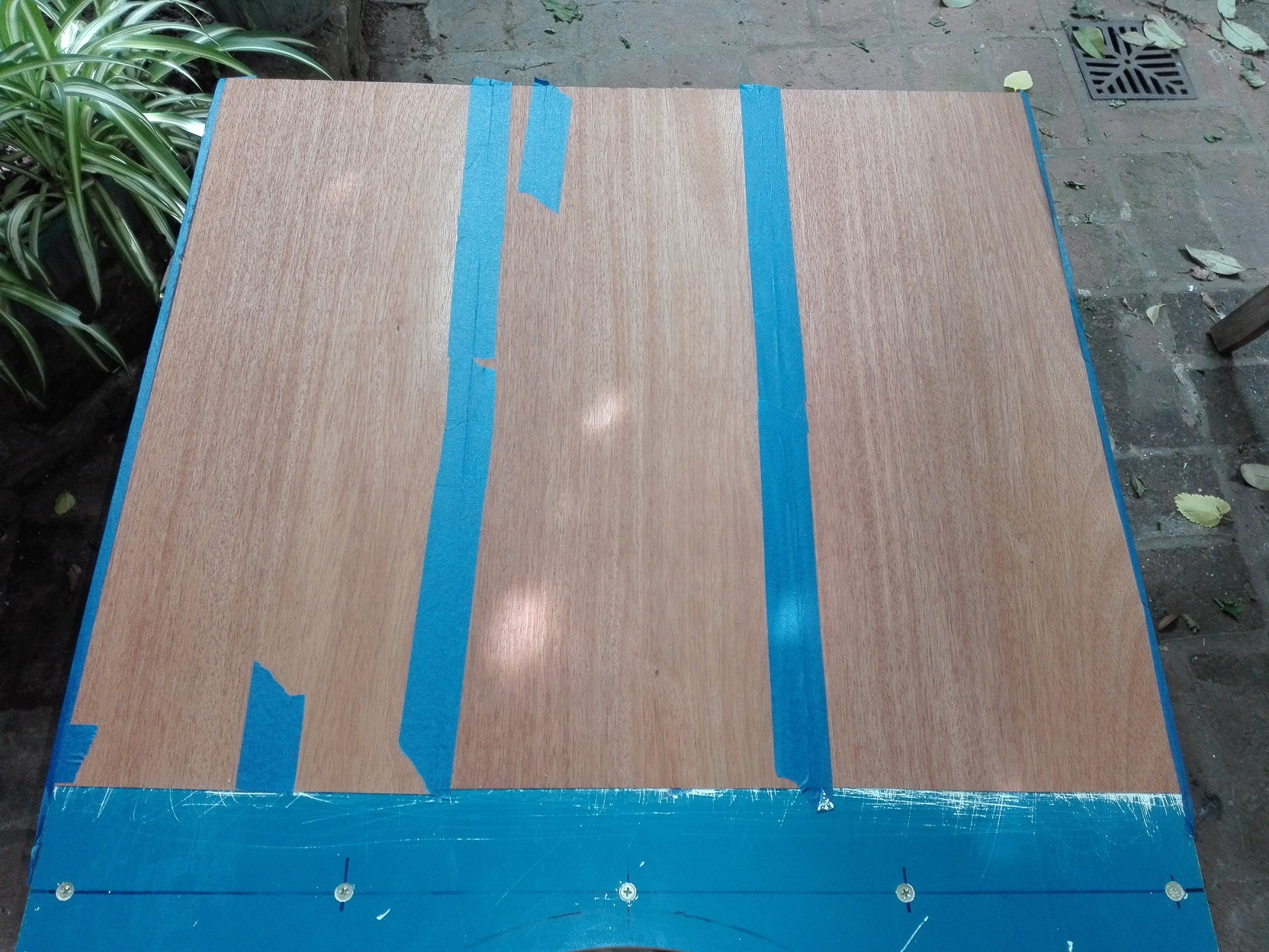

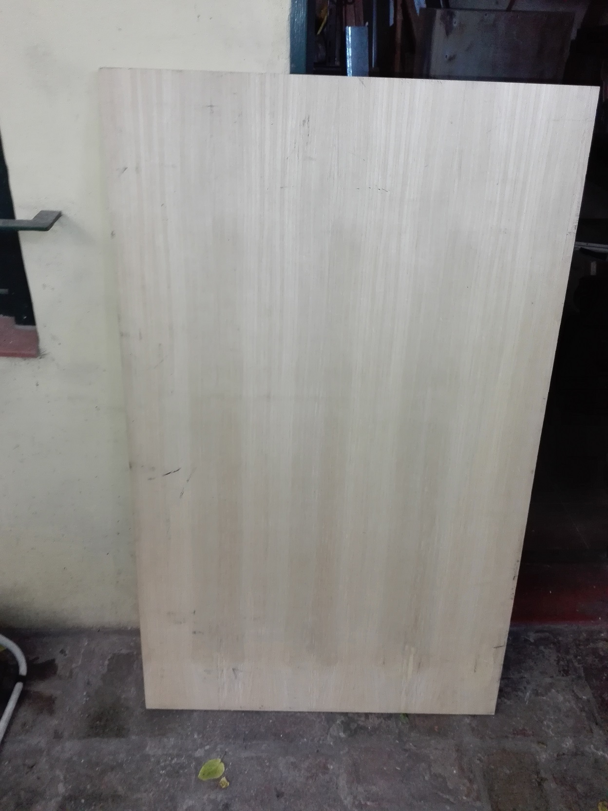

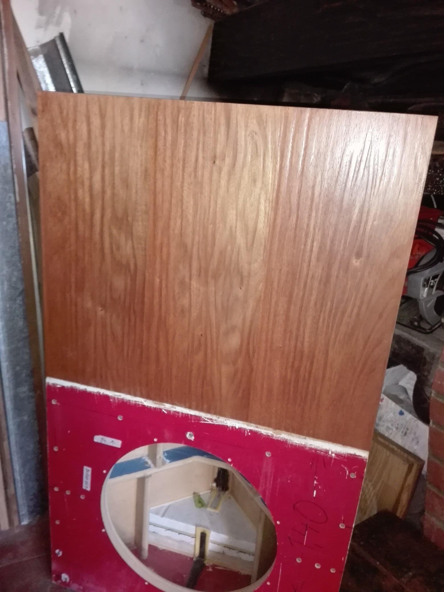

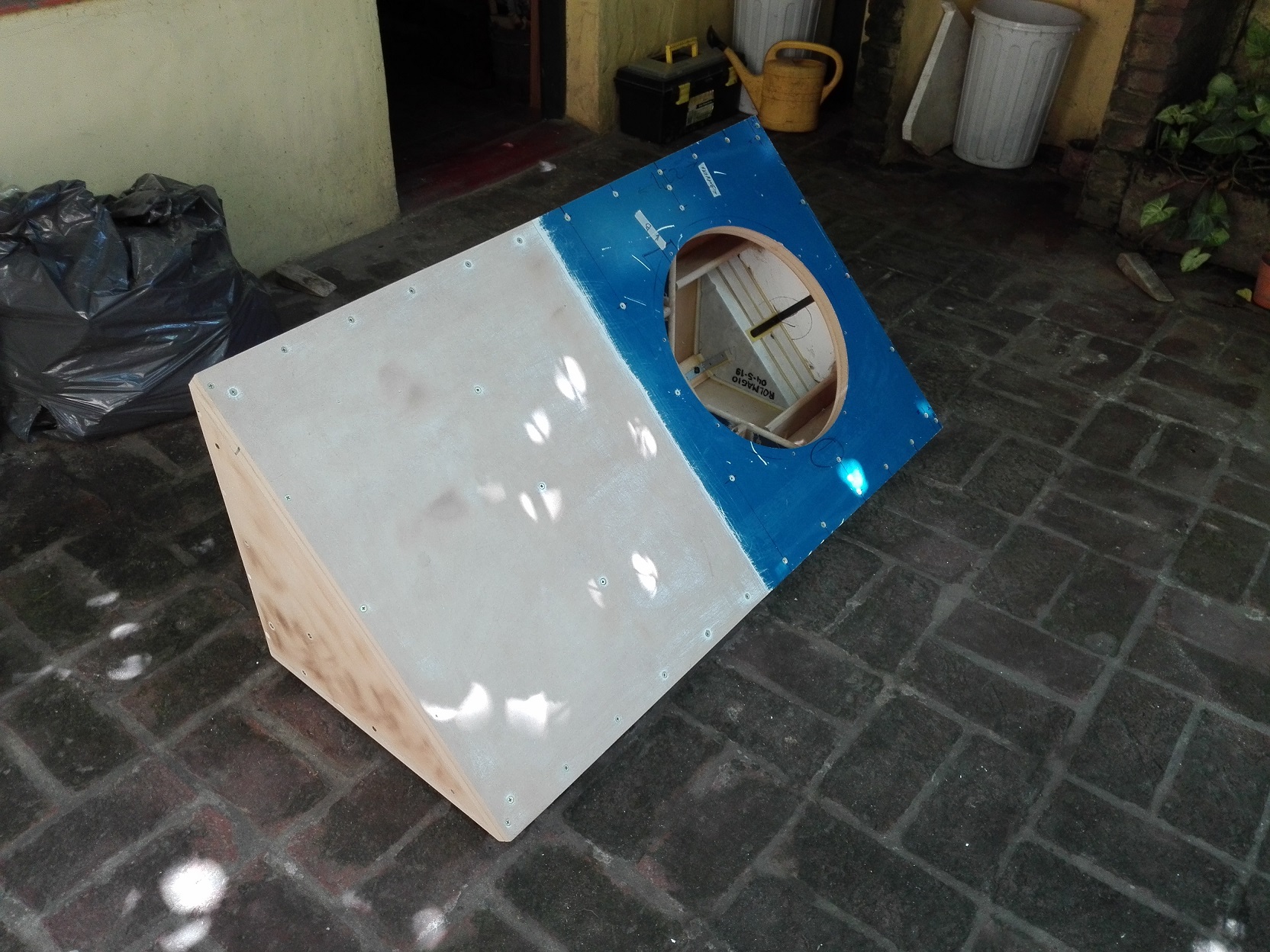

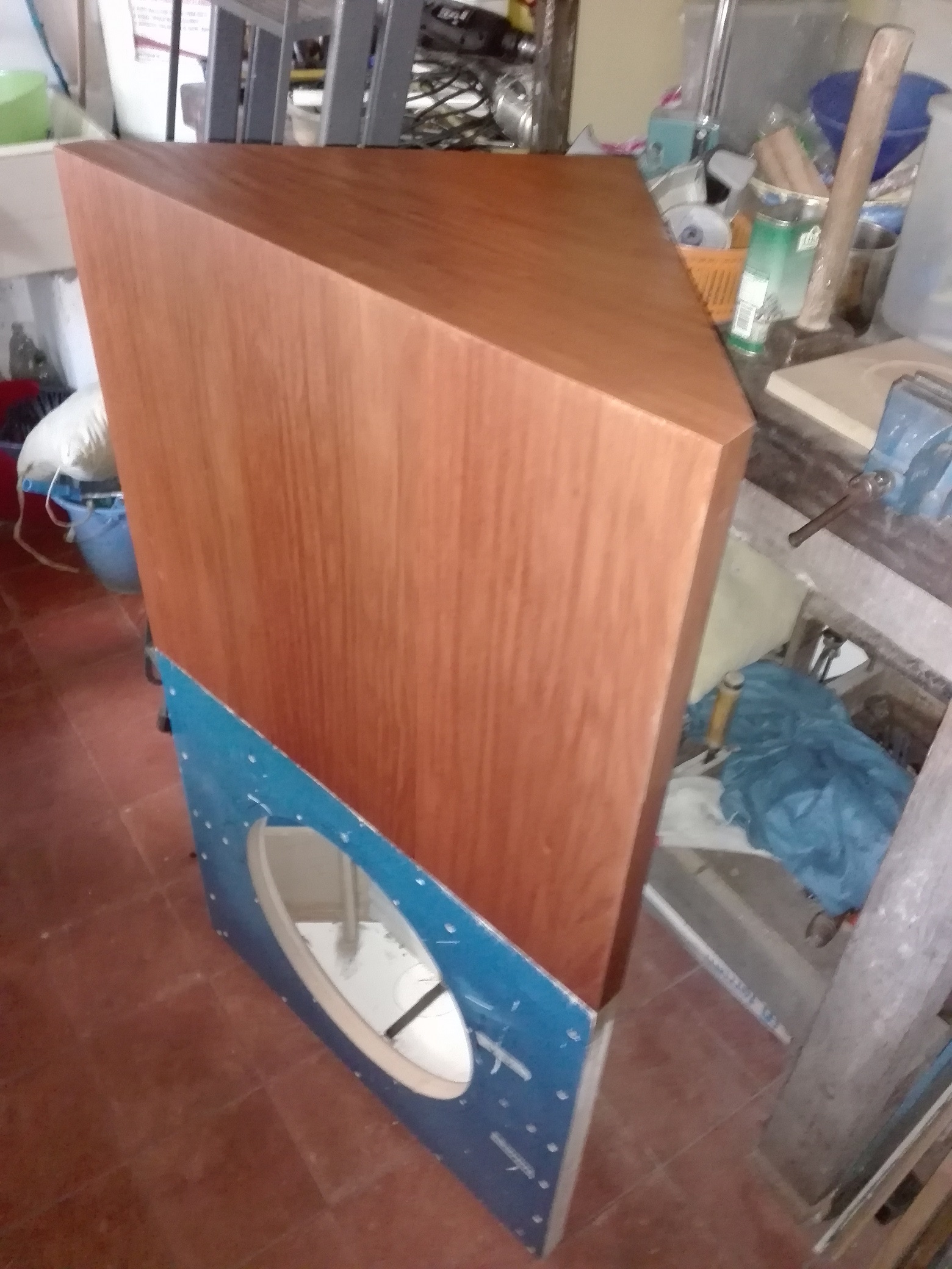

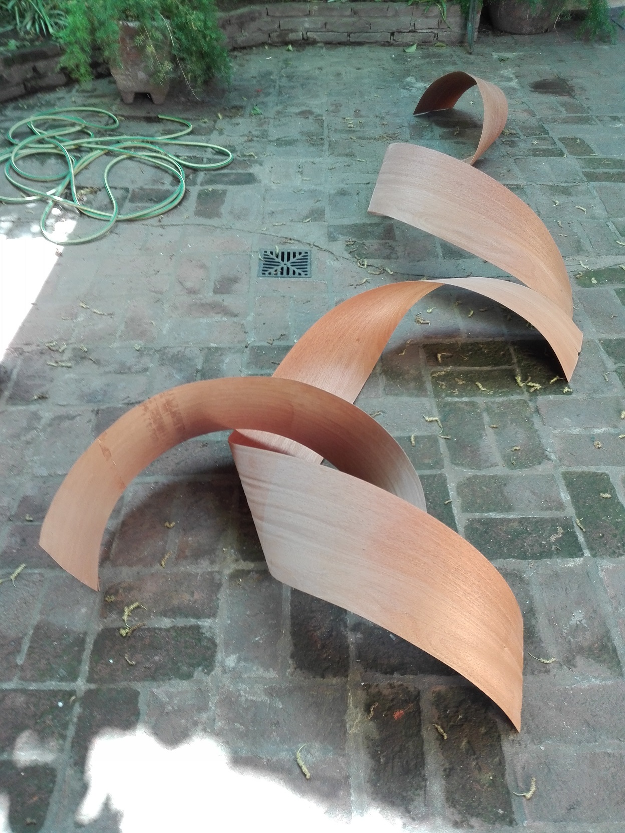

I remembered that in the loft I kept a beautiful cedar veneer wood many years ago. So I will use it for the front of the cabinets.

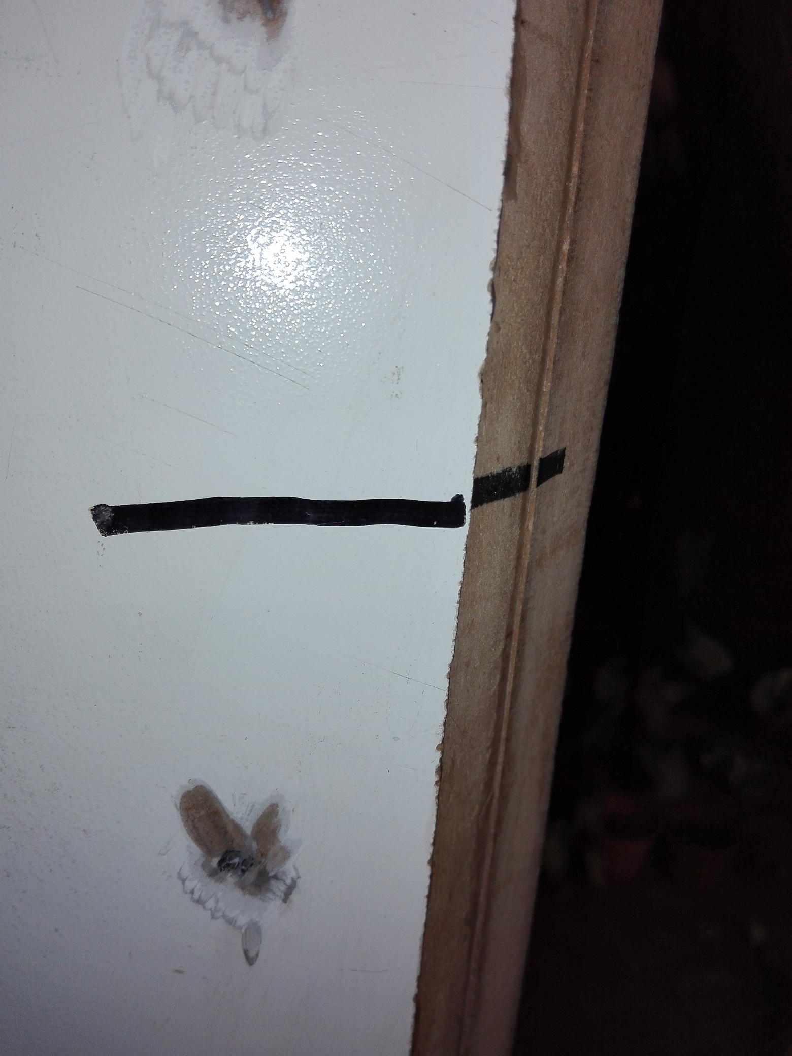

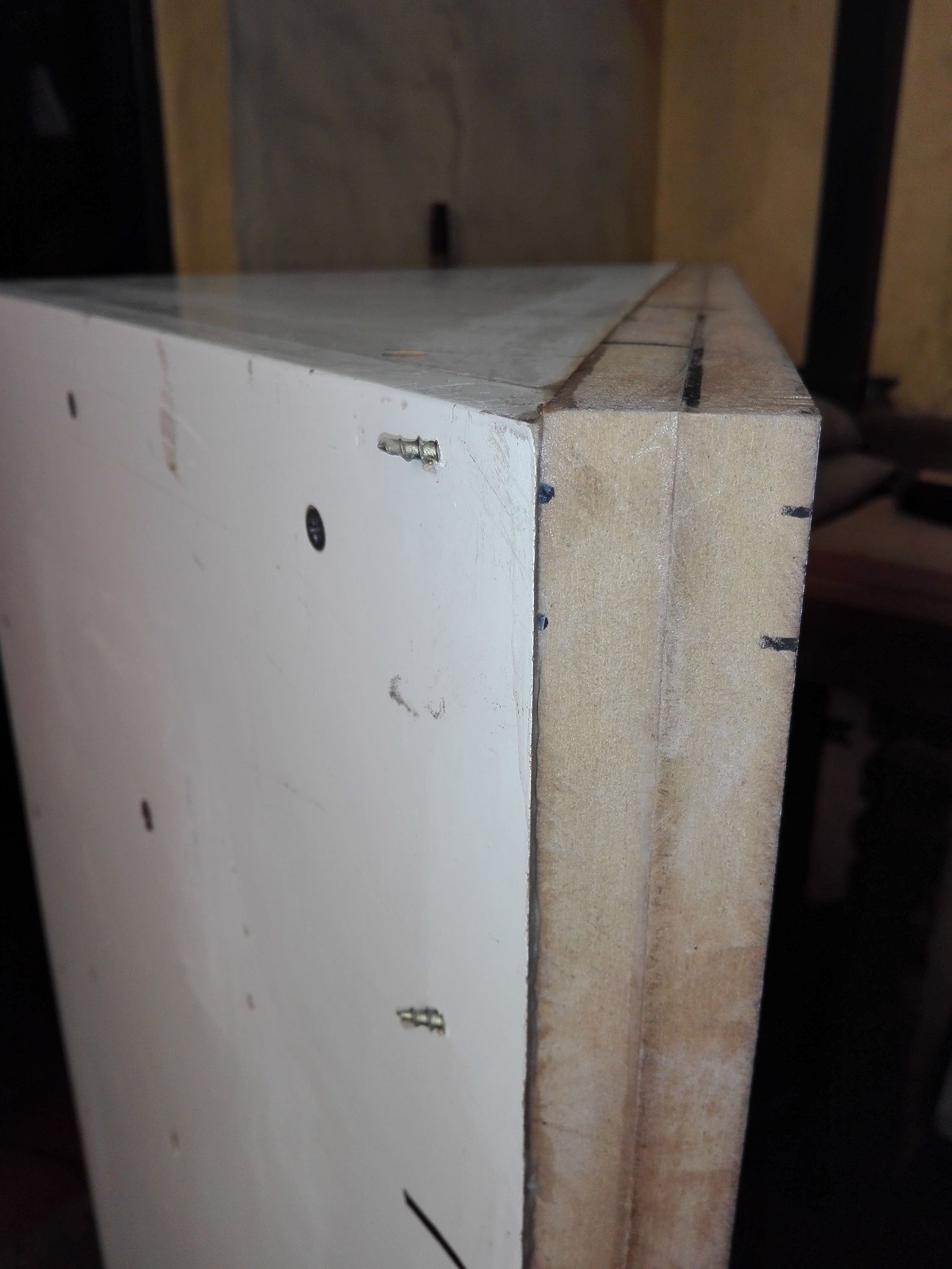

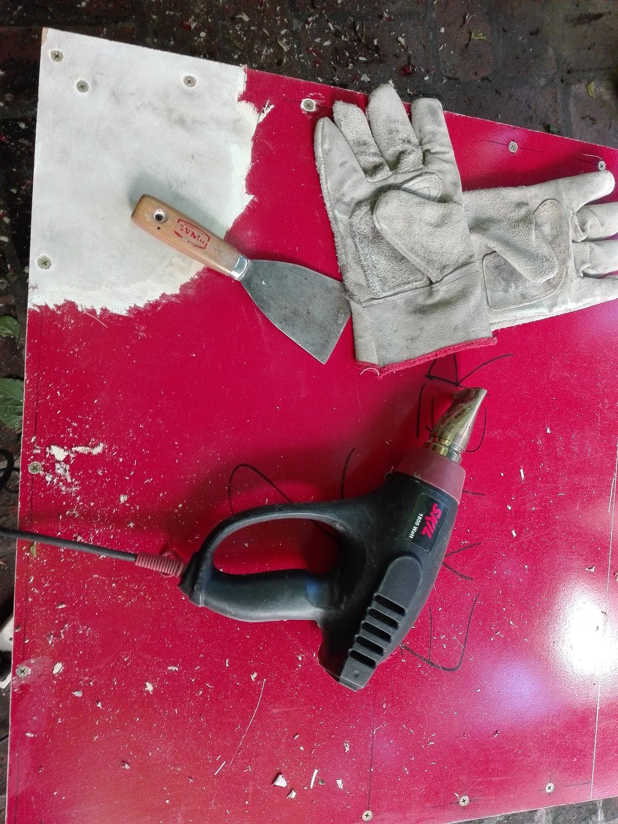

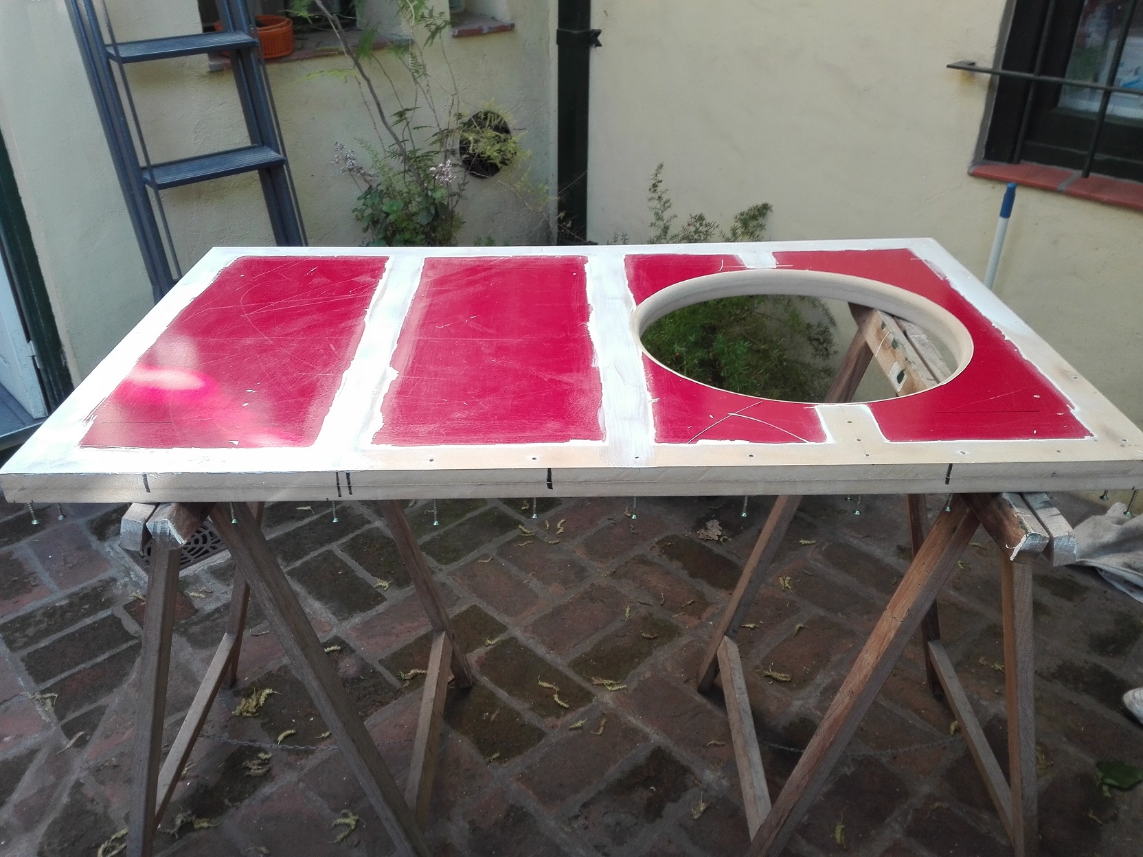

........... apply the vinyl glue on the two surfaces to be joined, and then finally screw again.
Passing the photos through the Windows Paint to reduce its "weight" takes time, first I choose the most appropriate for the development of the story, and then leave them in a position to view them in detail.
Normally I pass them by applying a 40% reduction in the amount of pixels, so they go from around 4 Mb to 500 Kb.

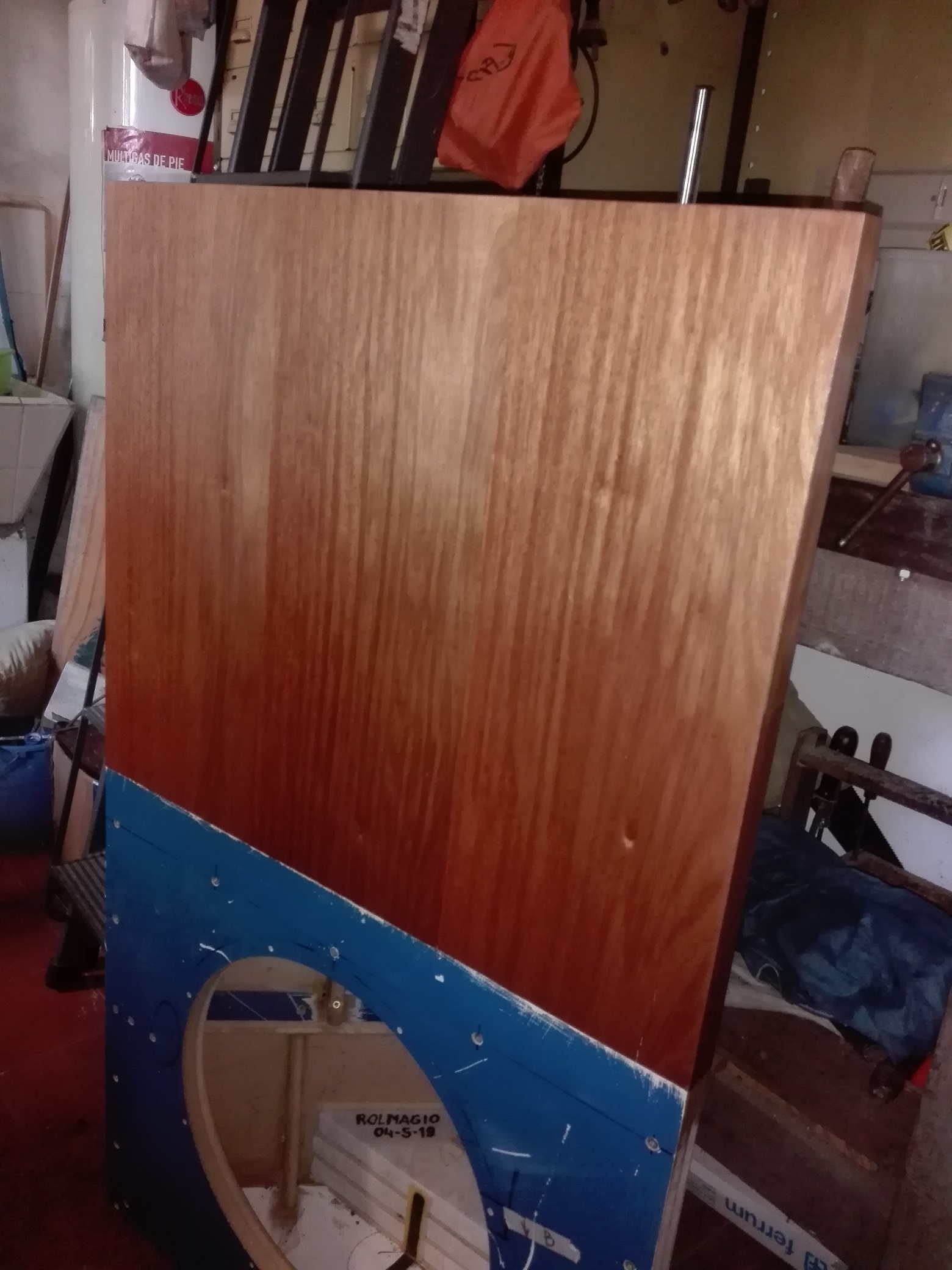

Yes, the plating is ready and I am applying the varnish, I will upload photos as soon as I have some time. 😉

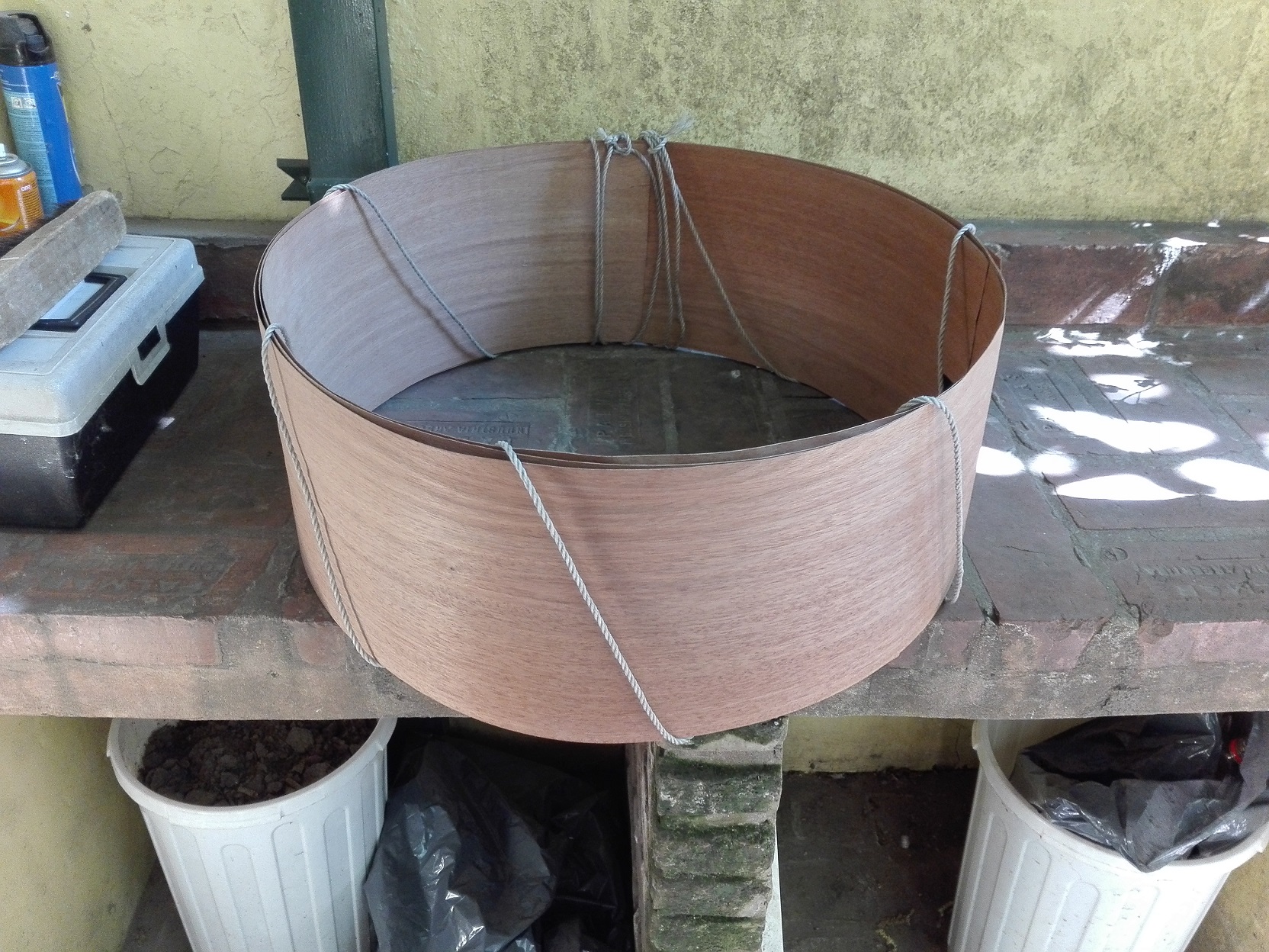

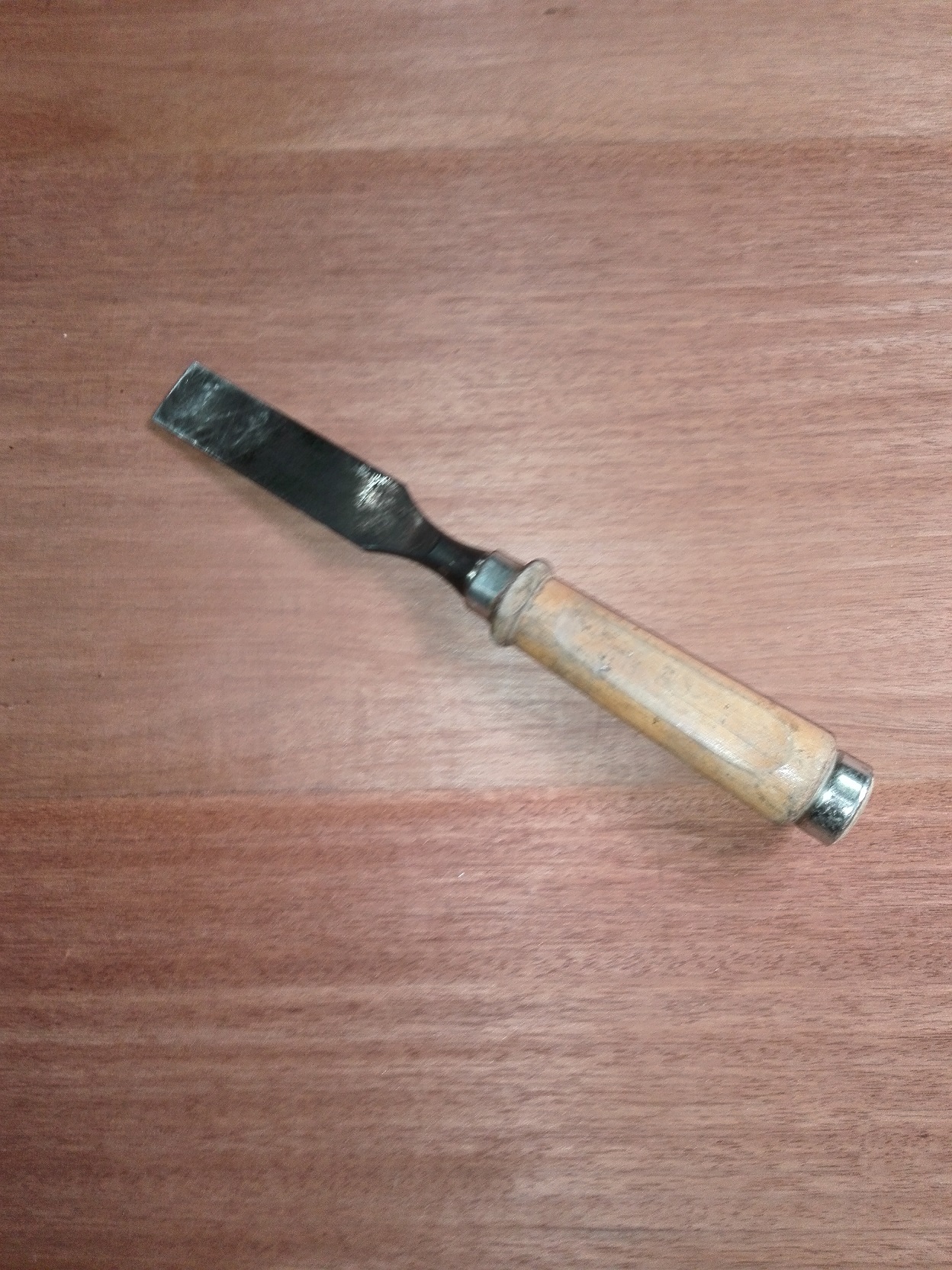

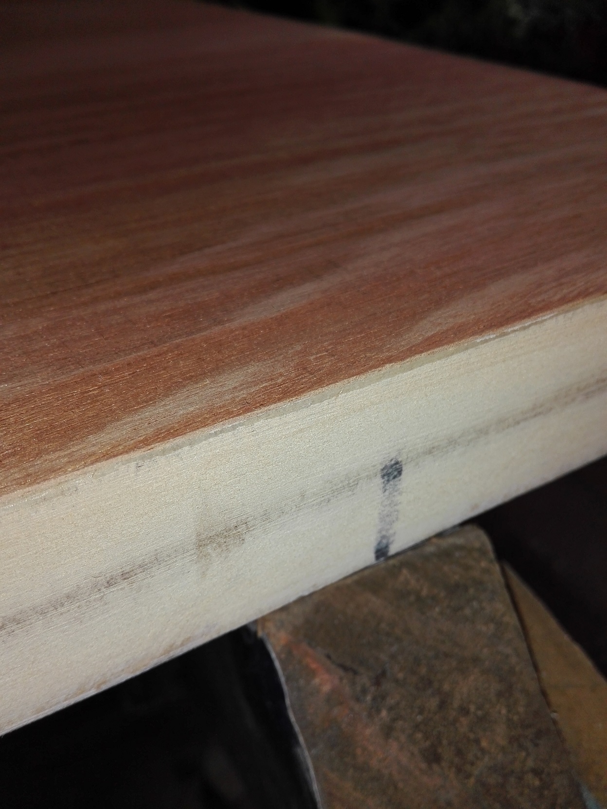

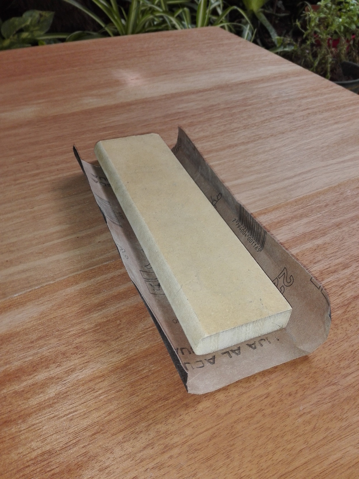

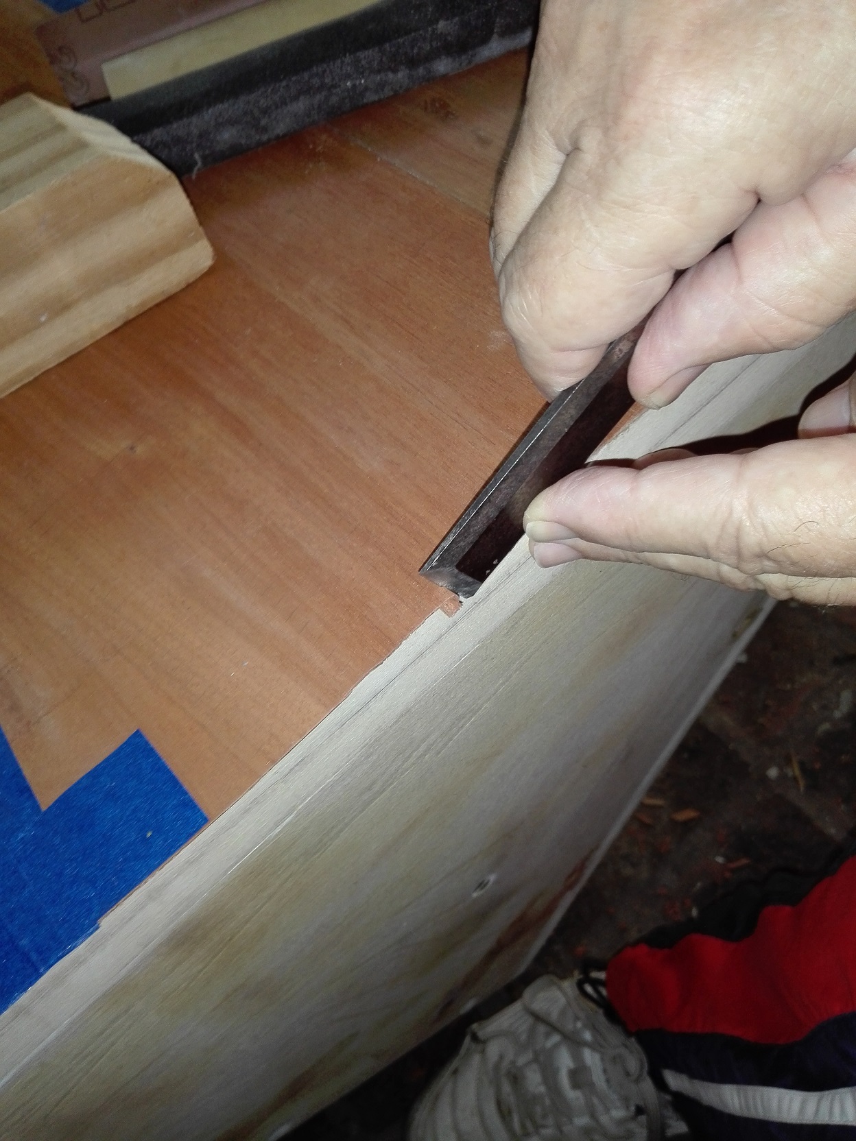

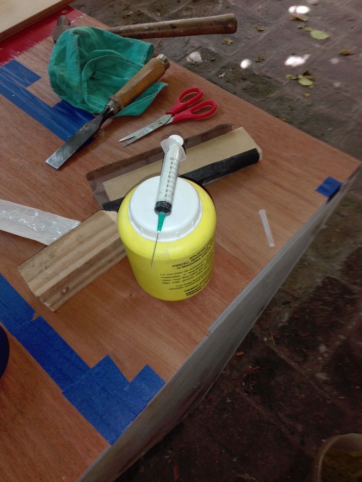

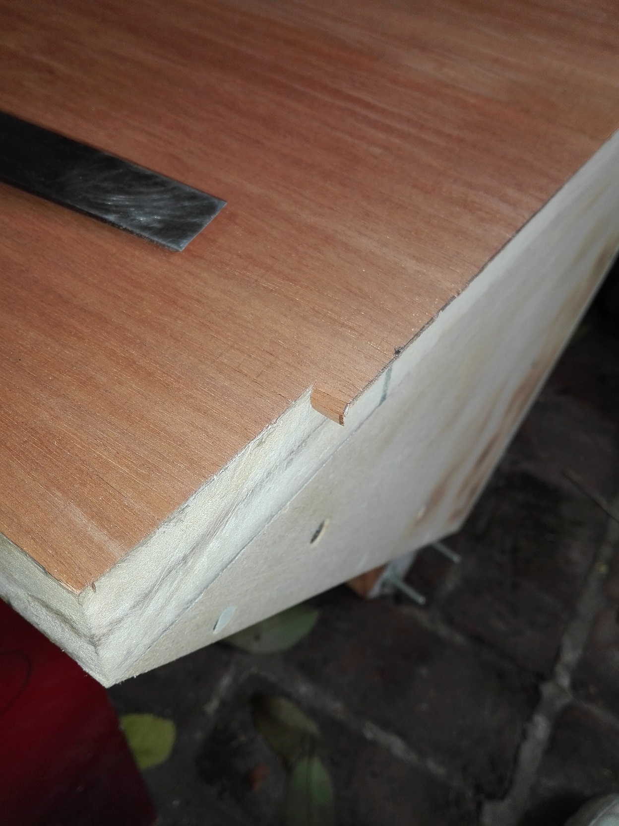

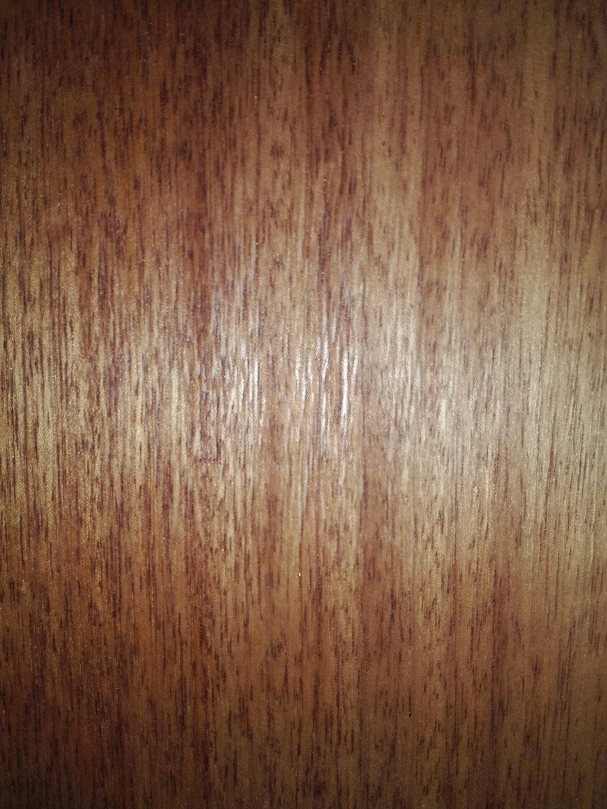

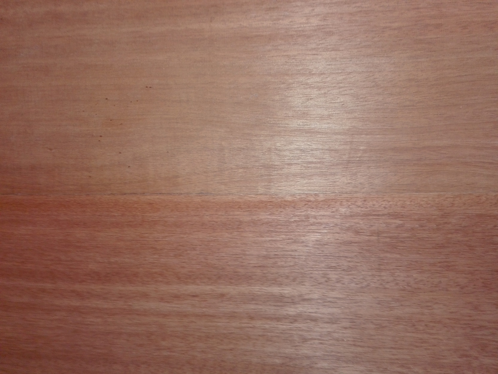

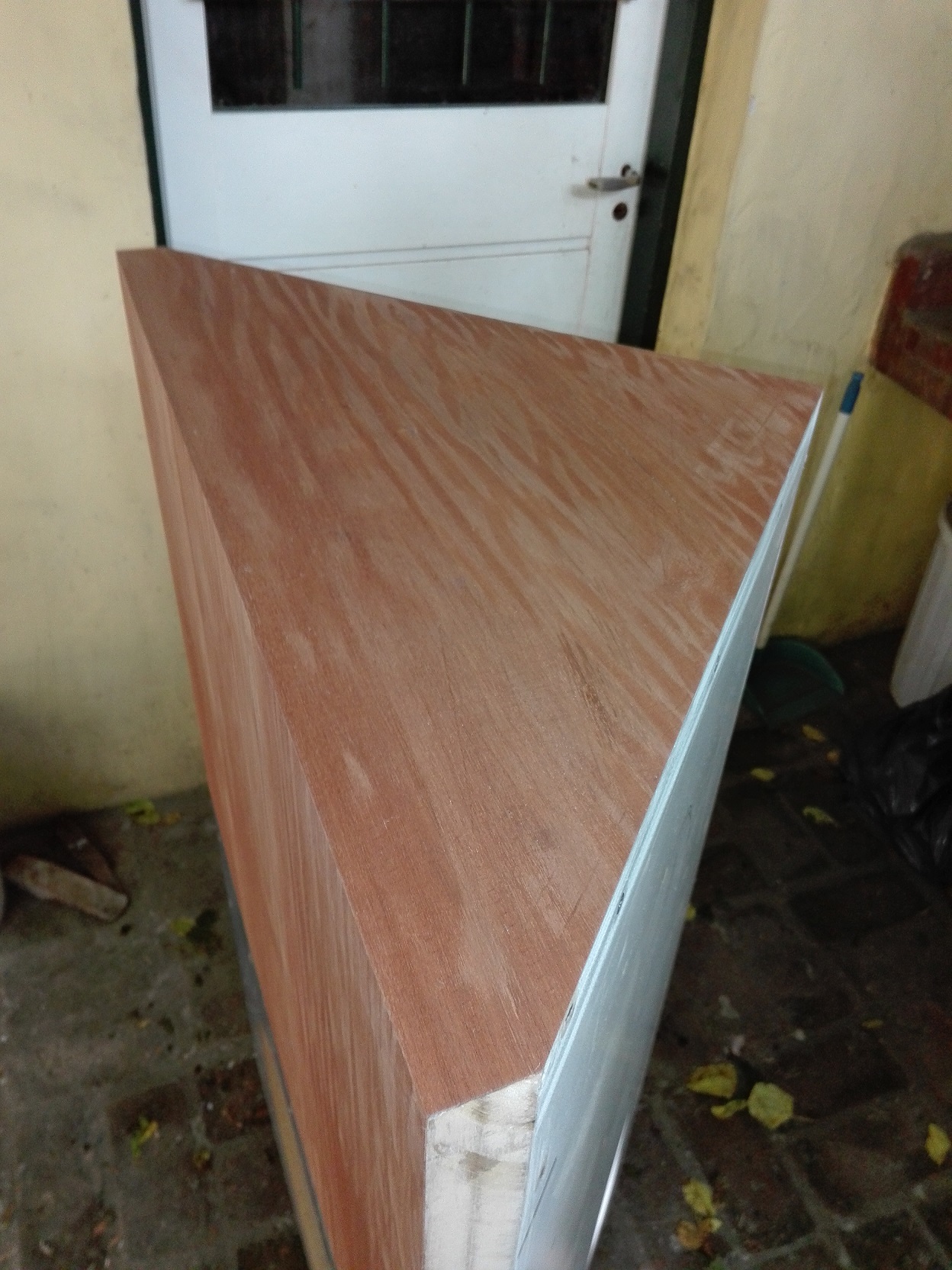

I have done this work previously with contact cement, and my conclusion is that over time it takes off, being very difficult also the application on large surfaces, balloons are formed, etc.
So now I use classic carpenter's glue, a good press is all that is needed, and apply a lot.
Even if a small sector remains without adhering well, the PVC adhesive can be injected with a syringe, apply a weight again and let dry.

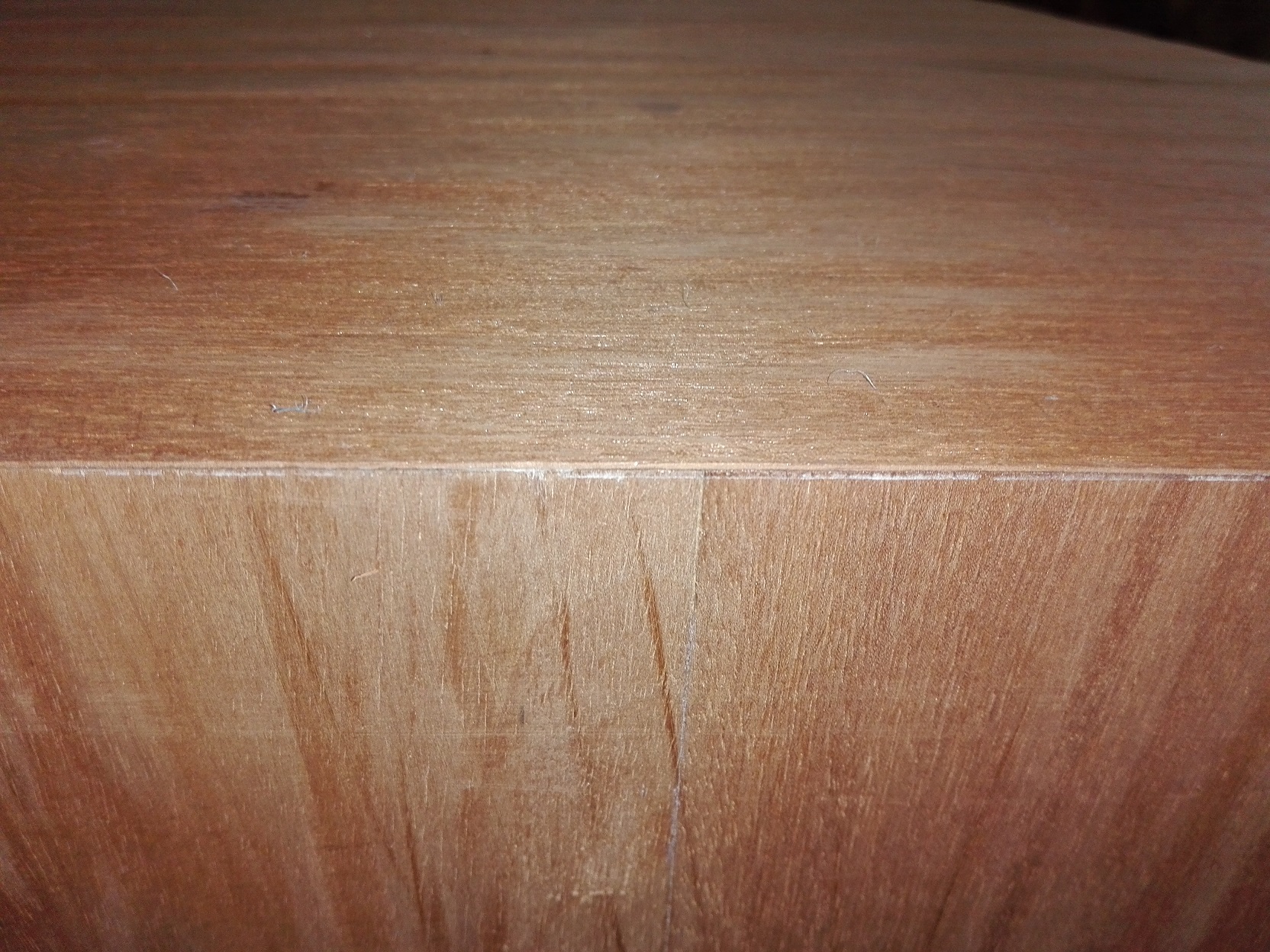

The rest is not secret, trim the edges, remove traces of the glue, apply diluted varnish to 50% of "primer", and finally two coats of varnish or more, gently sanding between hands with fine sandpaper.
PD: The glue remains must be thoroughly removed, or they will be visible under the varnish, spoiling the finish. A good trick is to use pieces of broken glass, and then very fine sandpaper.

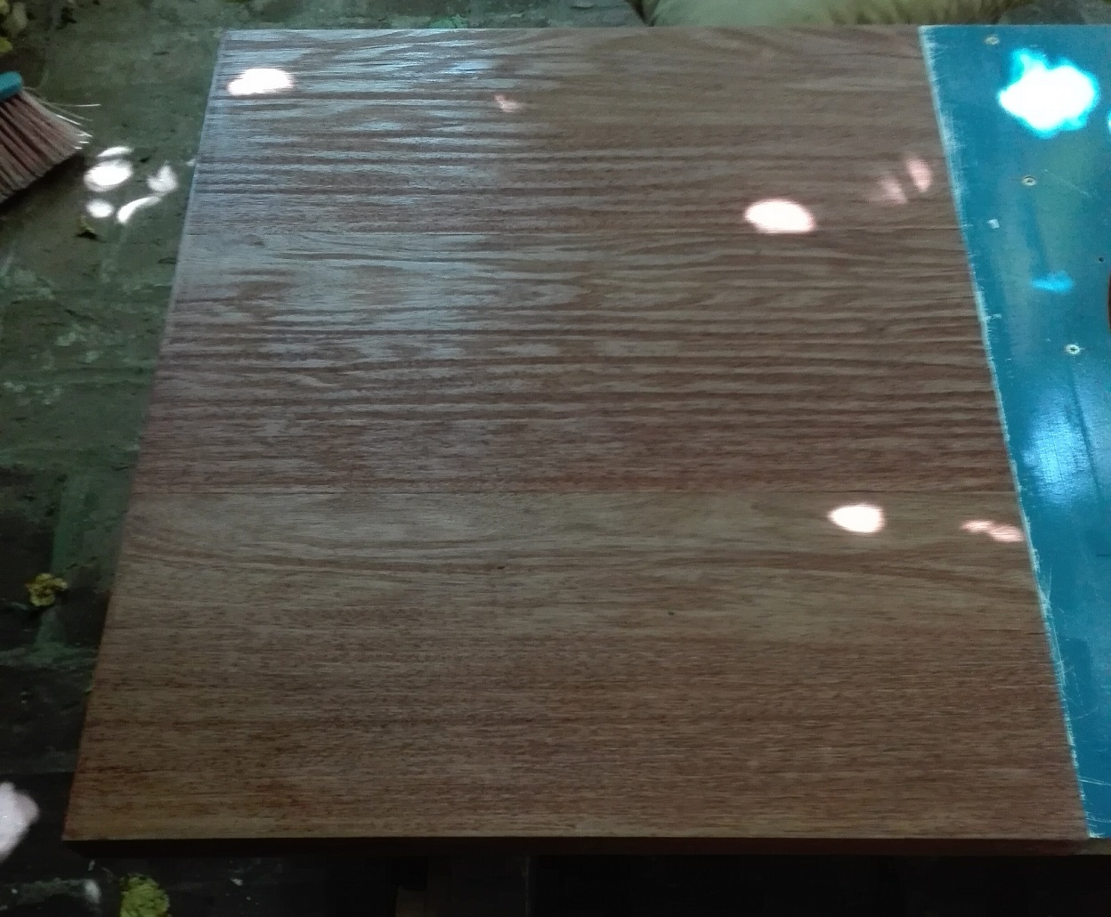

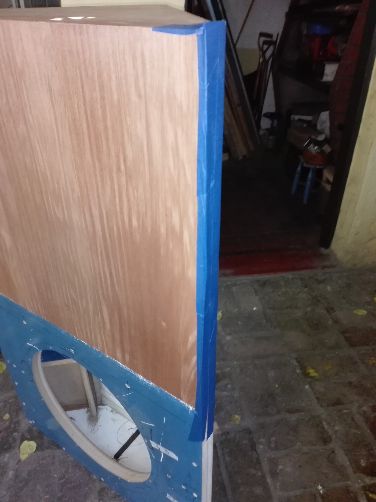

Last installment of this chapter, in the next photos of the veneered wood already varnished, I hope you like it......😉

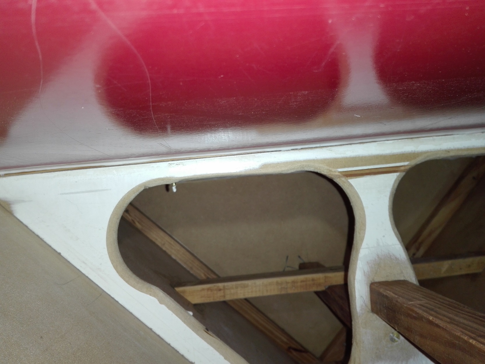

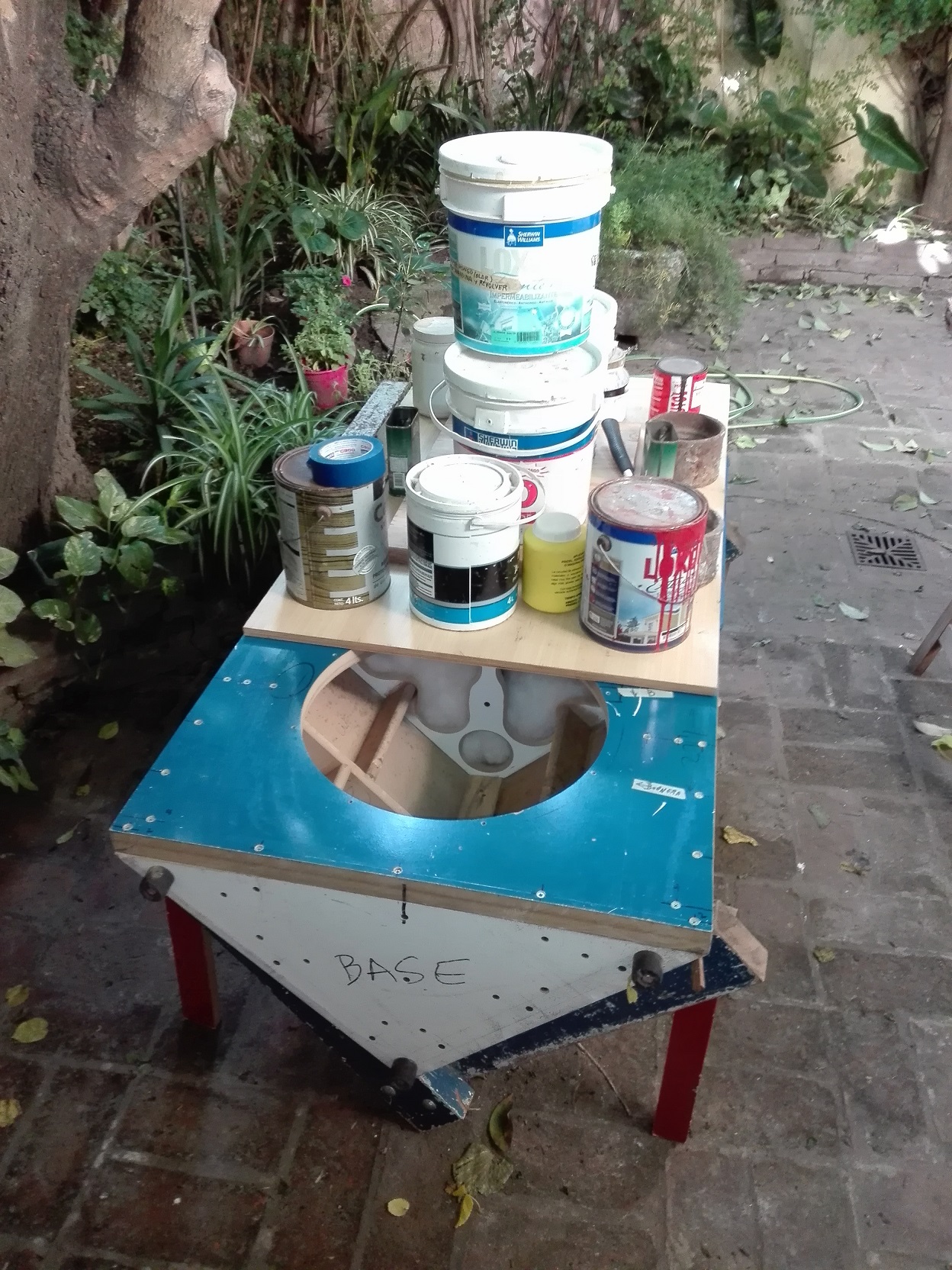

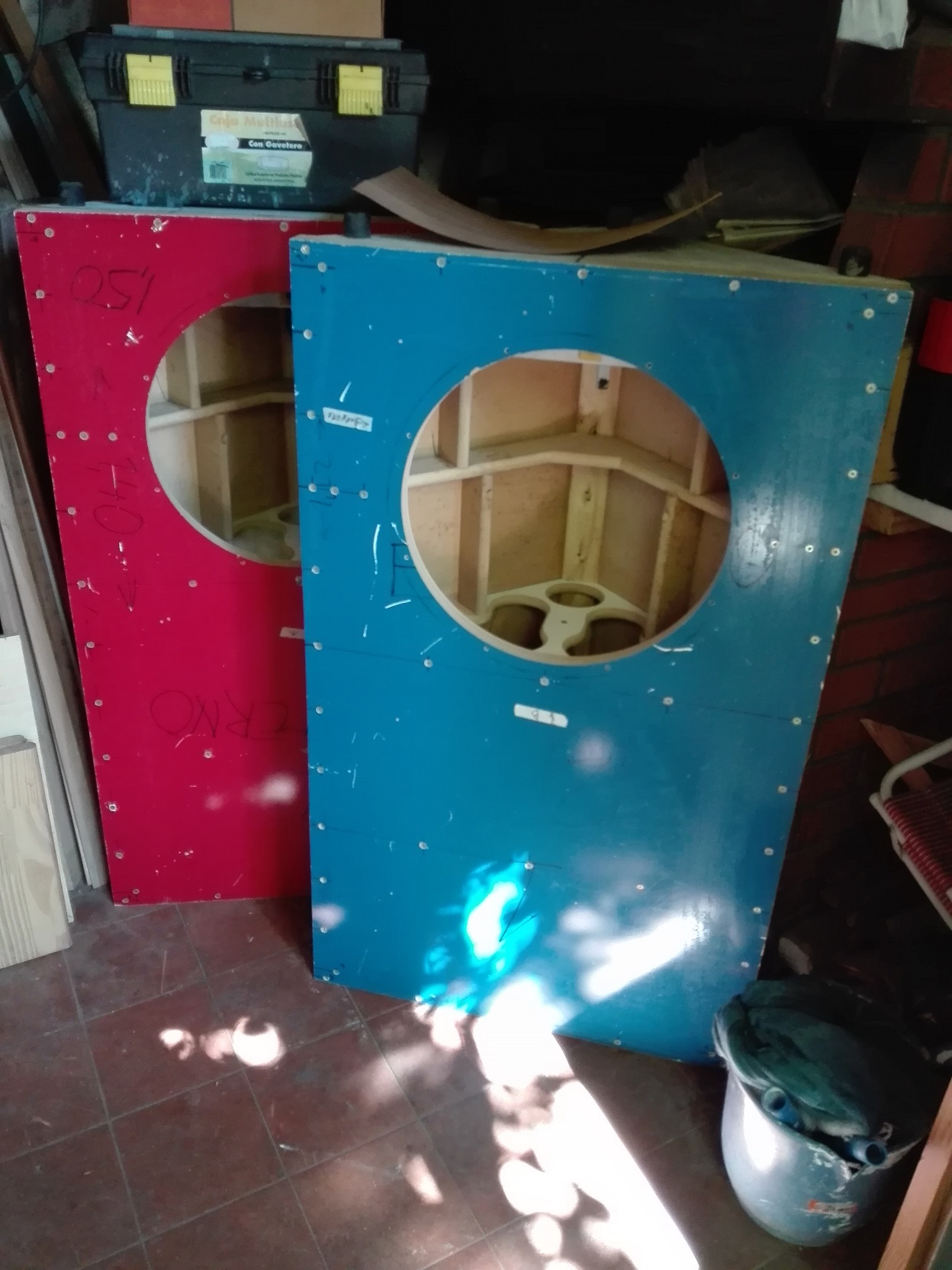

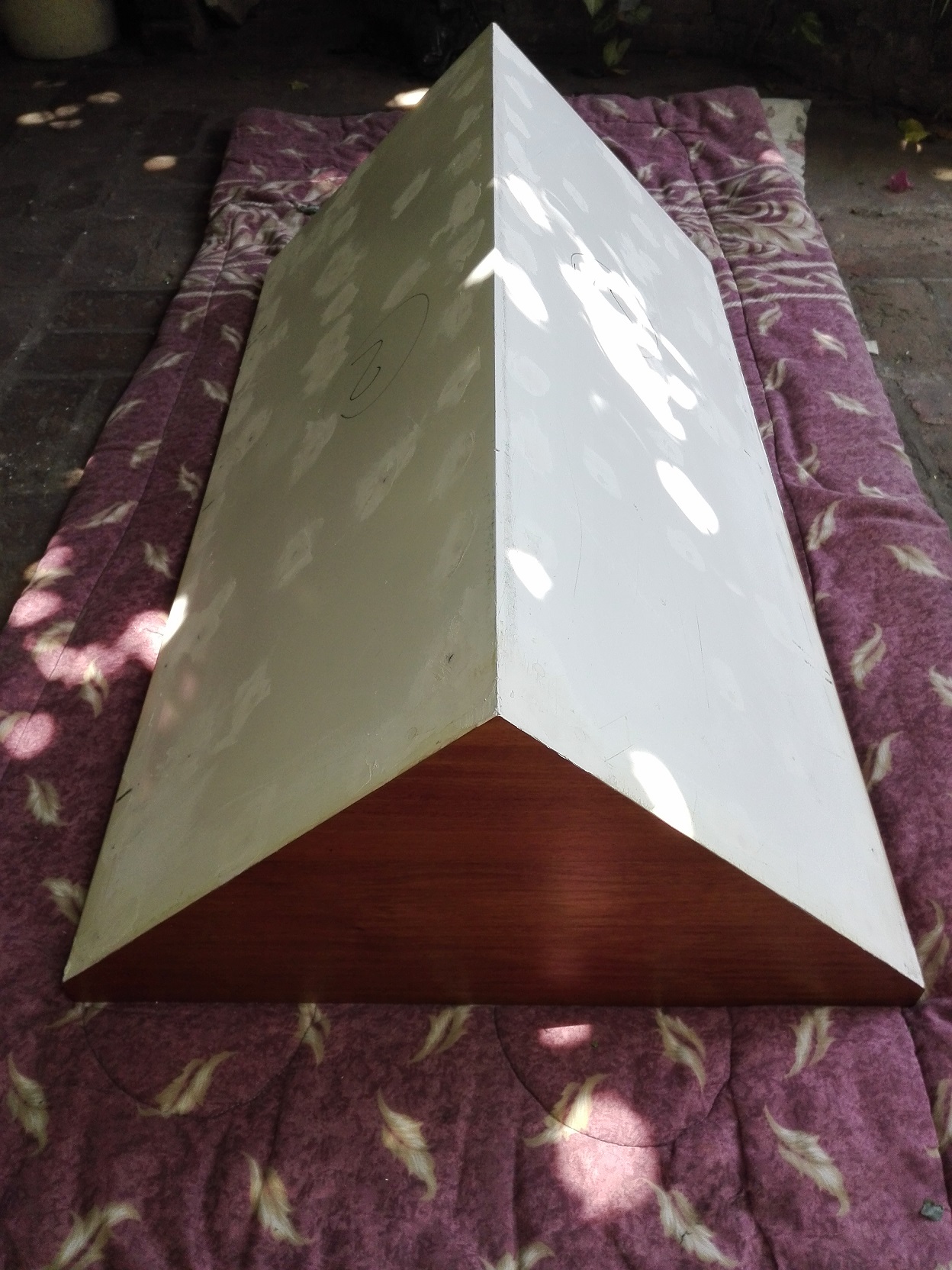

I have already applied two coats of pure varnish, and there is one more left for last, since it will be applied over the entire cabinet.
The following steps are:
1) Remove the provisional rubber feet, fabricate and place the final ones, they will be made of plywood. (I have BB leftovers since the construction of DTQWTII)

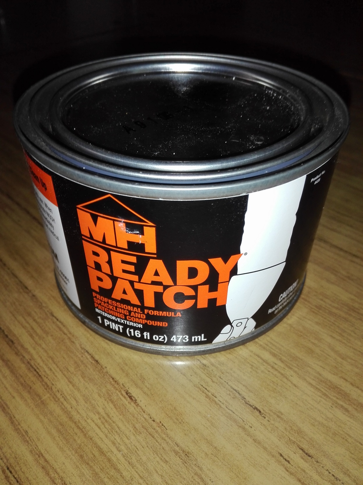

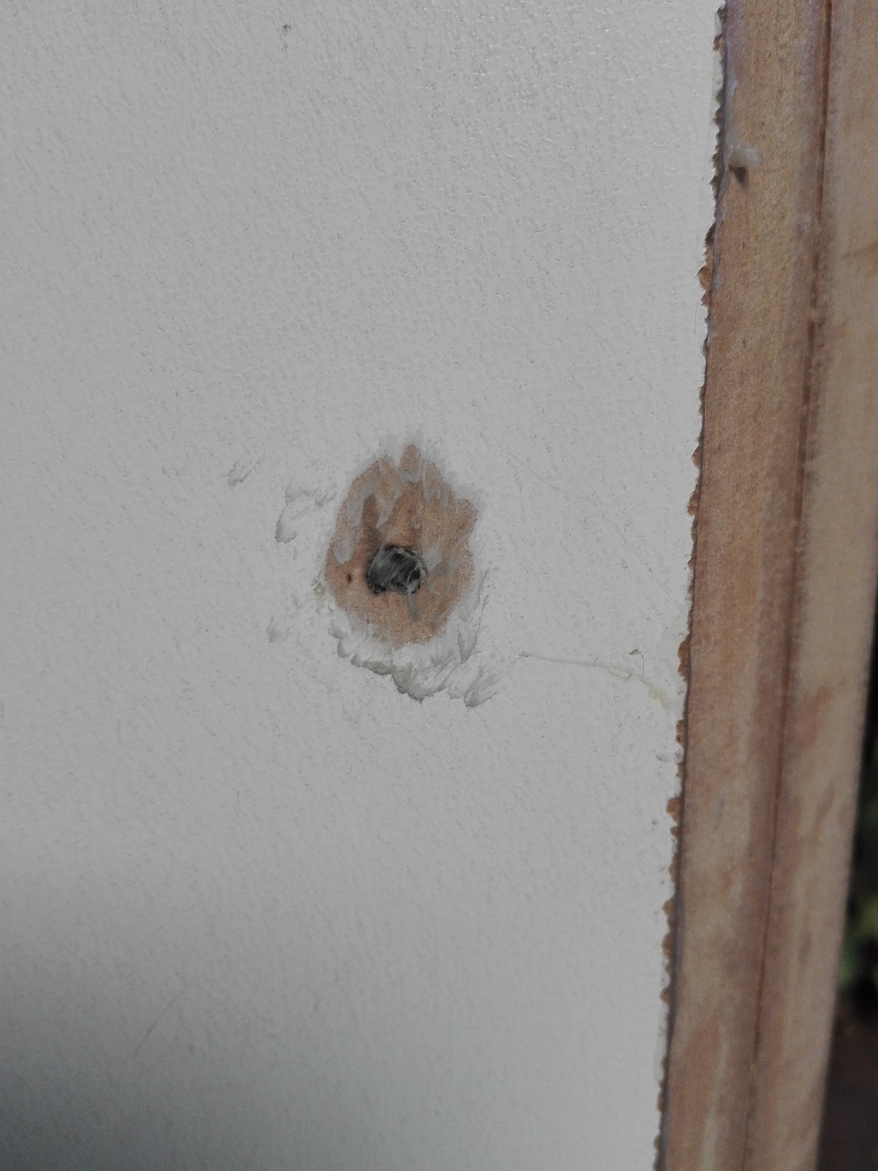

2) Putty all imperfections - the screw heads included -, sand and paint.
3) place the connection terminals
4) Connect the speakers and place them, previously the lower sector will be filled with polyfill.
Taking a look to the 4Th pic, it seems that the syringe has glue inside it, ready for injecting to someone. Perhaps you.I do not understand that comment
No entiendo ese comentario
Ahhhhh ! 😱 what sense of humor do you have, who writes you the script ?

Currently putty before spray painting.
