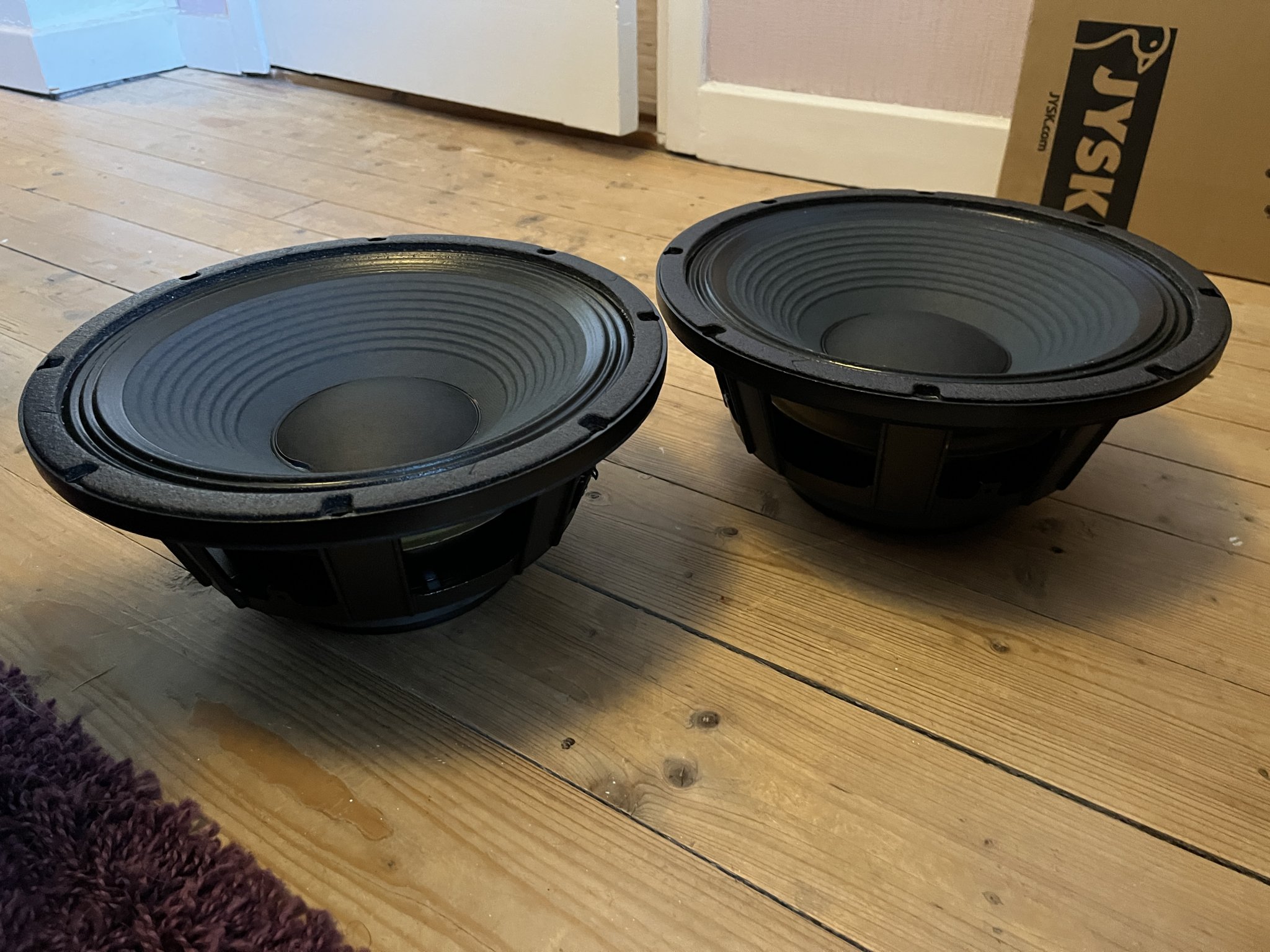

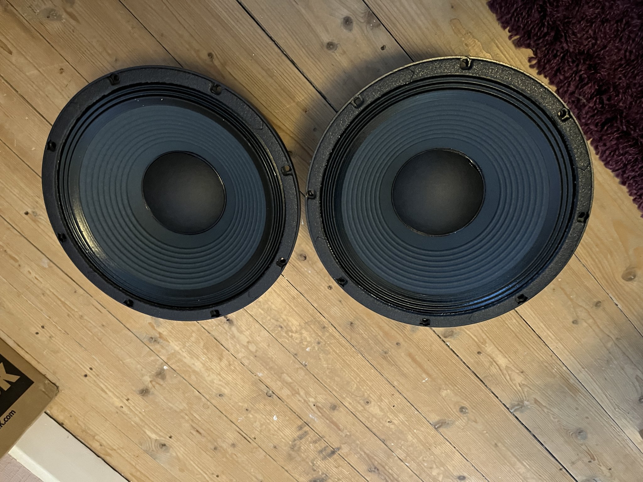

I got my edn XST drivers today. They seem very well built I agree with the other poster. Free air resonance seems lower than expected when I tap the cone is resonates like a 808 bass drum which to me is always a good sign for lows. Can’t wait to test it in my heresy like cabinet with ASD1001 in APT150 horn and 1,6kHz xo, I have a feeling this will perform better than the Beta-CX. Tempted to buy more and play around, these tick off most of my “requirements” but it would be nice to have a datasheet.I am aware. But how bad can it be. The drivers are used in a bass guitar amp with a 40hz claimed response in a 212 config and 32hz in a 112 cab. If I cut at 250hz to a midrange I’m sure it will be ok. Sure I can add a 18” sub to my system later.

Do you not own some sort of measurement setup ie DATS or Clio?
The cone looks great for lower mids. Most other 12s in this range use smooth cones, not as stiff as ribbed paper. Could be great with some Aquaplas coating, like JBL does.
