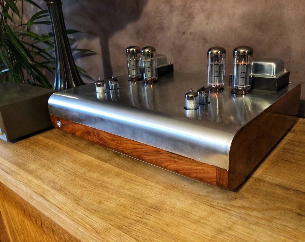

Please, could you tell me something about this amp? how does it sound, if you like it ...

I am very glad you like it .
I am also thinking of building it.
Did you have any stability problems with these transformers, since they are not lundahls?
Transformers are probably the most important component in a tube power amp.
Lundahls are very expensive but they are also very very good. What do you think of the hammond 1645A? They cost a little less but perhaps this project deserves the lundahls.
What speakers do you drive?
Sorry for too many questions but before starting a demanding and expensive project it is better to inquire.

The Lundahls were too pricey for me and somebody I respect told me the Primary Windings parts would be fine. Maybe the Lundahls would sound better – I don't know, but it sounds excellent as it is so I won't be experimenting. I have no experience of the Hammond parts you mention so can't comment, I'm afraid. I've had no stability problems.
I have a pair of B&W DM2 monitors.

Looks great too! Love the aesthetic. Nice job.
Hi. Yes - it sounds lovely. A really rich, warm, full sound - and pretty tight too. I absolutely love it.

willholmania Hi,
Please, can you tell me exactly the models of your output transformer and also the power toroidal?

Output TXs from Primary Windings.
30W 6600 Ohms Ultra Linear Push Pull Output transformer – Primary Windings
Although for my next one I got the mains TX from these guys as they were cheaper. I just gave the the spec of the Amplimo one.
