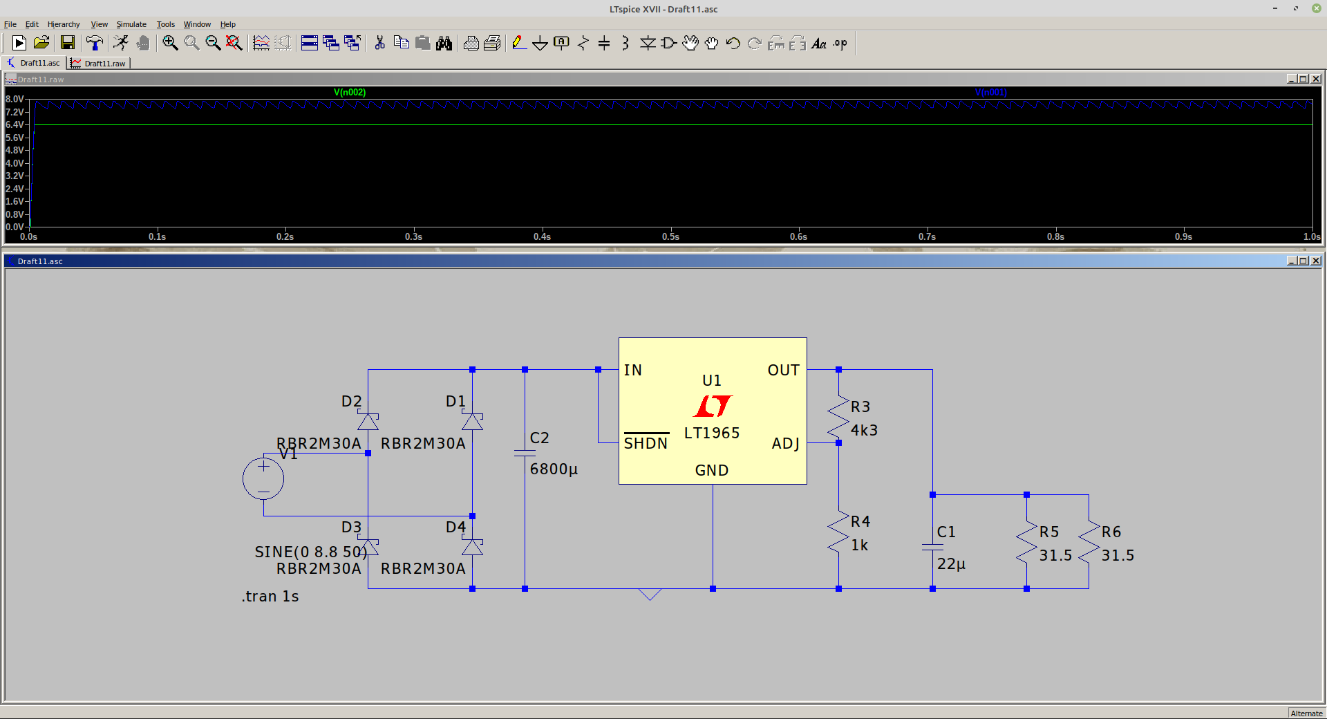

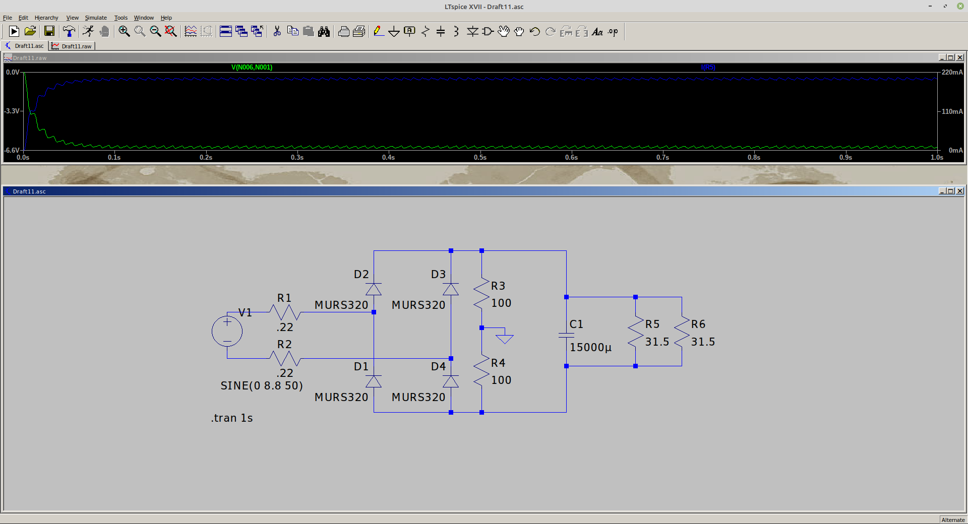

V1 is the 6v3 winding going to the existing ECC83. D1,D4 say 1n5401 R1, R2 1W which adjust the heater voltage. C1 >= 10000uF @ 10V, R5 and R6 are the heater windings of the EF86. The cap need to be large else you just move 50Hz to 100Hz.

Okay - thanks, that sounds like the best solution. Will this board feed both channels or do I need one per side? And how much more current will this draw?
You can feed both channels. Just the EF86 though. If you want no AC at all then this circuit would do. There are plenty of others. Make sure the transformer winding is floating. This one will need some 3A Schottky diodes as rectifiers say 1n5820. The LT1965 is low dropout - its no good using a 780x. It will need a small heatsink.

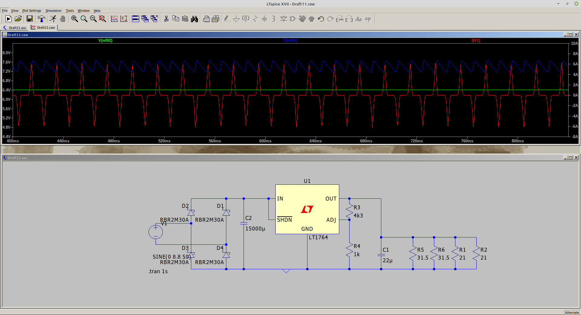

It may be better to drive all your valves EF86/ECC83 with DC as having a mixture may put noise on the ECC83. If you make the C2 15000uF @ 10v and put in a LT1764 that will provide plenty of current. Think thats what I would do.

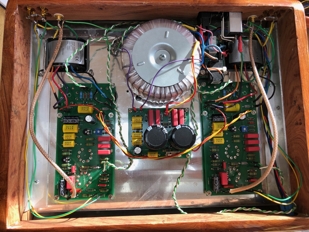

I would not be surprised if the hum is caused by the PCB layout. The heater wiring on the PCB for V1 and V2 is quite bad. But using DC heating should probably alleviate the problem.
Yep since is hum rather than buzz there is significant possibility of magnetic coupling between the tracks. You could cut the heater tracks and put twisted cable to each valve individually. Reading the EF86 spec the hum should not be audible. However would damage the PCB but may be simpler than DC board and cheaper.
I was wondering why I have the problem in the first place, and agree the PCB is the most likely cause. Need to decide whether to go for the DC heaters or just cut the tracks and feed with twisted wire. Hmmm.
It could be equally the ECC83 to blame. The heater tracks are running very close and parallel to the grid tracks. Also its got a big cathode resistor. Although the gain is less. Don't know. If you do cut the tracks do it in a way they are easy to rejoin.
I could, but I’d rather make what’s already in there work, and I’d like to know why it doesn’t. I think I’ll try cutting the tracks first, and if that doesn’t work I’ll go to DC heaters.
Do I need to cut the tracks? If there’s no current flowing in them because the wires are going straight to the valves, will the voltage on them still cause hum?
Well I've answered my own questions. I tried feeding the valves directly with twisted pair wires instead of going via the PCB tracks - makes no difference with or without the PCB tracks removed. I still don't understand why I'm getting so much hum but my only choice is a separate DC supply for the two EF86s and ECC83s, as the power trans can only supply 6.8A of heater current, so is already 200mA over (could this be part of the problem?).
I don't suspect the PT as the culprit, as the overload is marginally. Did you try to feed the EF86 and ECC83 heaters from a battery pack, as suggested by others?
Edit: I suspect you've got a ground loop issue. With some close look at the pics in #45 and #11, I see a green wire that is connected to the input RCA jack's sleeve in the uppermost left corner. Where does this wire go to? Is there a similar wire connected to the other RCA jack?
