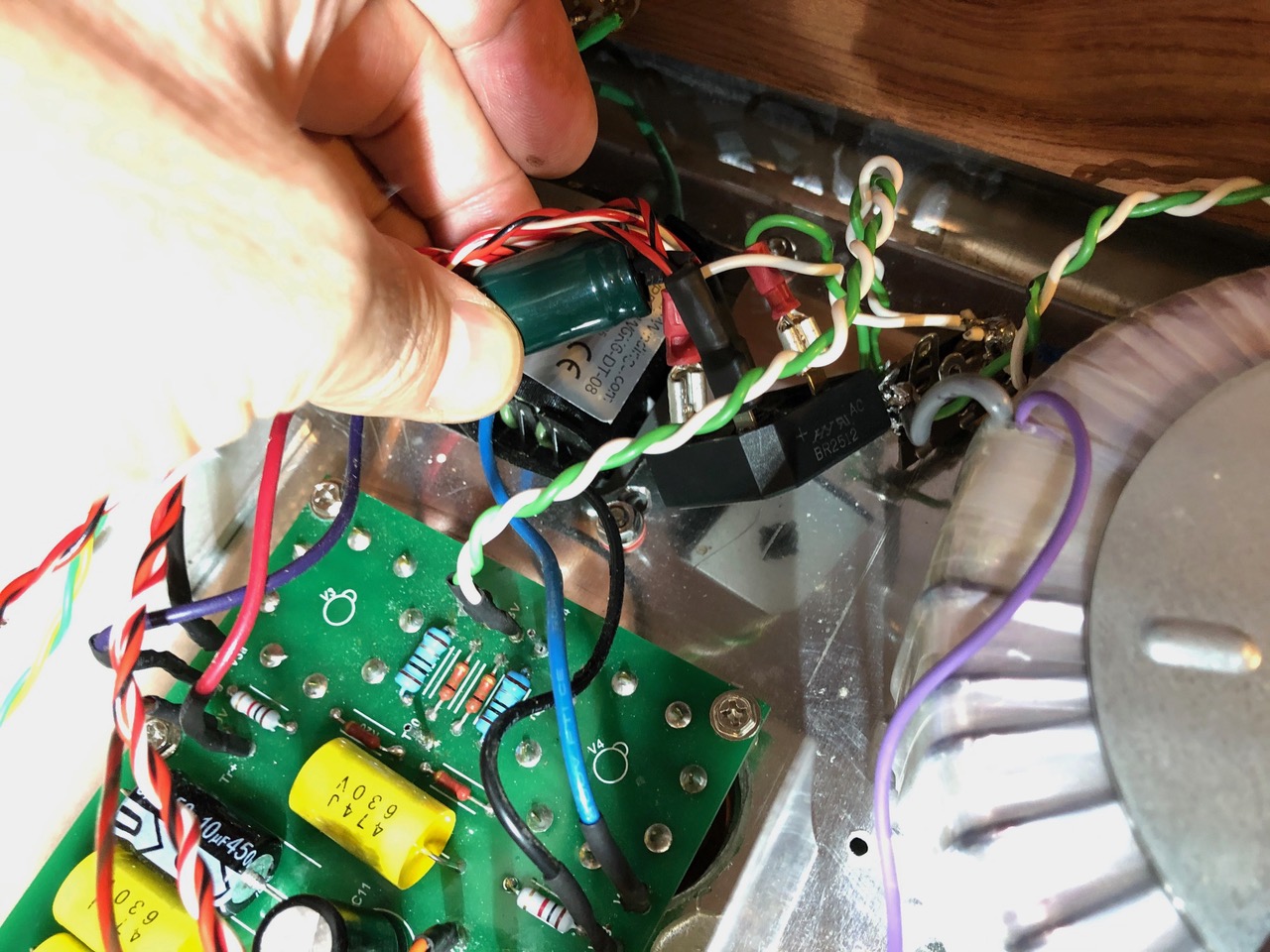

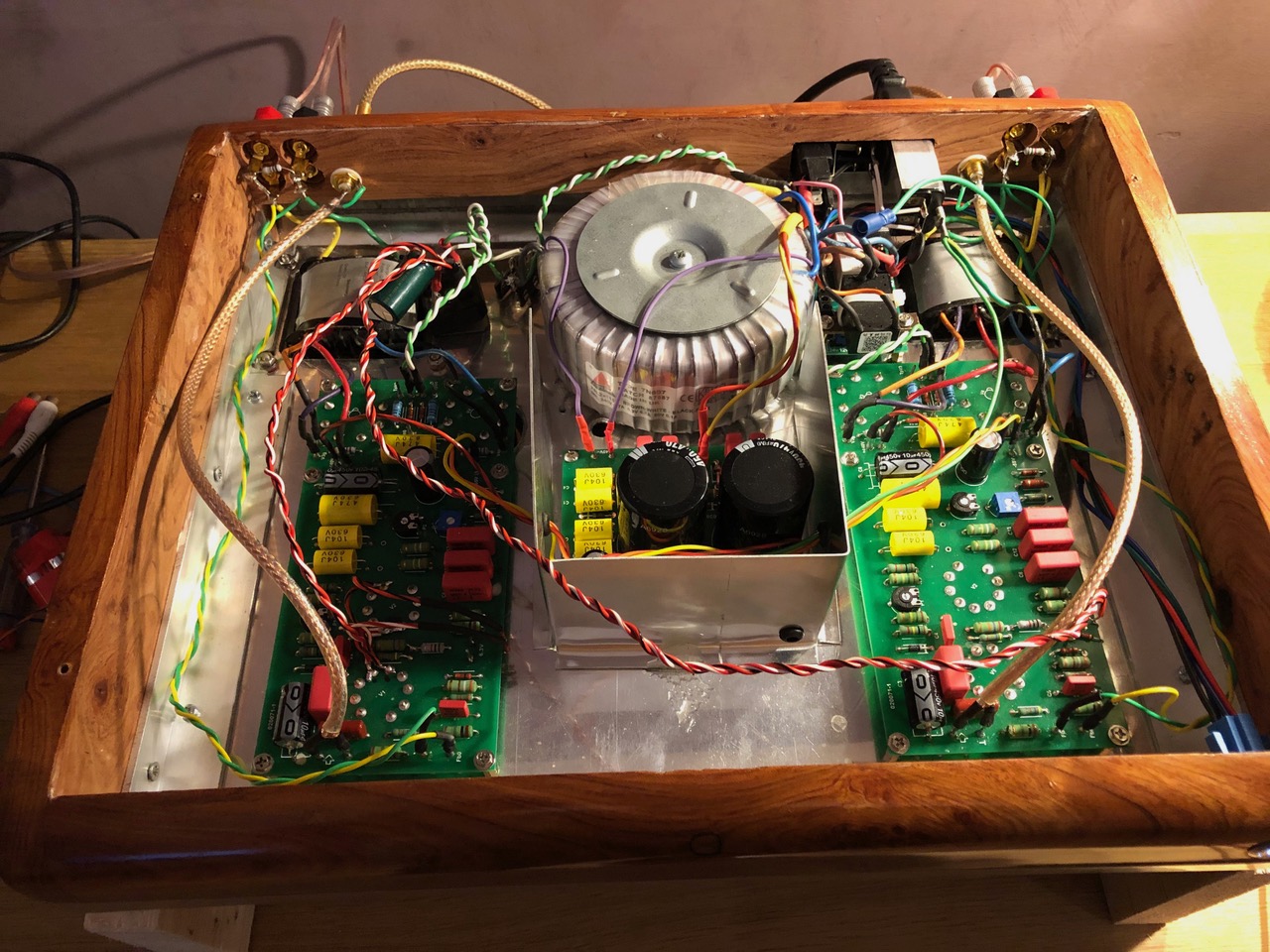

I tried grounding one side of the heater voltage and running it to the EF86 in shielded cable but that didn't help. Then I found a BR2512 bridge rectifier in a drawer. So I fitted that, along with a 15kuF capacitor and Bob's your uncle - no hum. The heater voltage is too high at 6.9v but I can get that down - maybe a resistor or another capacitor. But other than that, job's a good 'un for the time being.

Do you feed the EF86 exclusively from that? Then connect a 3.3 ohms resistor in series with the heater. Or wait until the 2nd EF86 is also connected and measure again. I guess the voltage will sag sufficiently.
