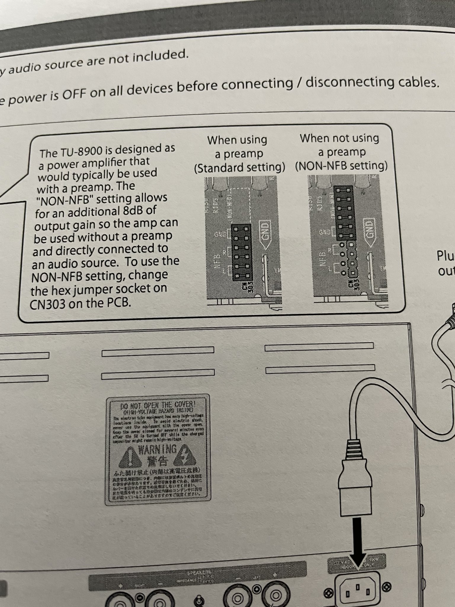

Volume control still functions either way. There are DIY mods to bypass the pot if you are planning on using a preamp…or you could turn the control all the way up.Are the VCAP CuTF upgrade worth it?
And another question regarding the 'non-nfb' settings... if I get the 8900 I'll use it with a preamp (which I use to change volume), so does it mean the volume knob on the 8900 will do nothing in standard/nfb mode??
Essentially instructions are saying the amp gain is high enough without NFB engaged that you don’t need a pre. Negative Feedback essentially feeds part of the output back to the input 180 degrees out of phase which reduces the output signal, thus you “might” need a preamplifier if using NFB . My experience is you don’t need a pre with or without NFB Unless you have a very very low output source…maybe some phono stages.
This amp, as with many tube amp designs has enough gain that you can barely move the volume control off the stop before the music is blaring If you are using a modern 2V source with the zero NFB setting. I couldn’t imagine using this combo with a pre amp. Even with NFB a preamp may be too much with a modern 2V source (most cd players and DACs)
