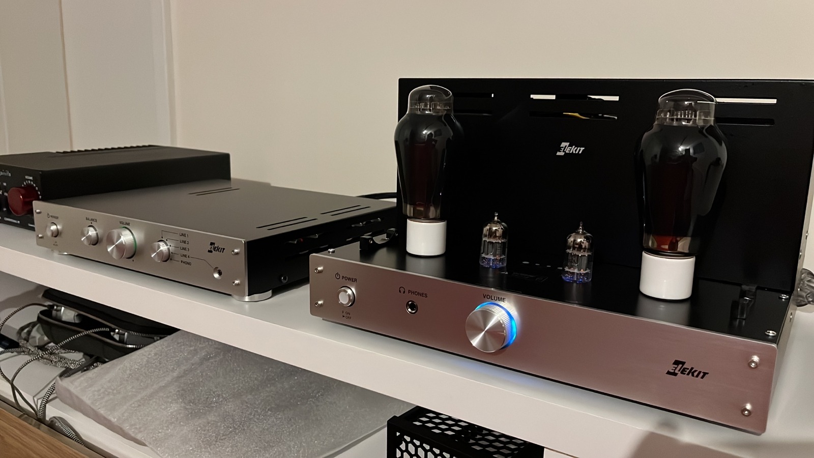

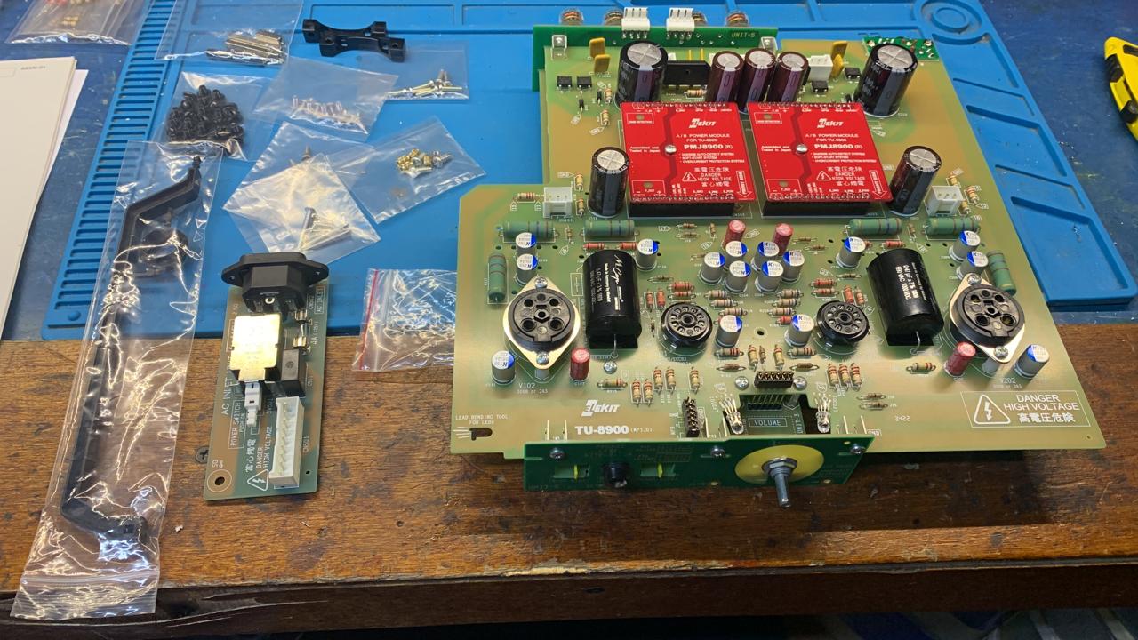

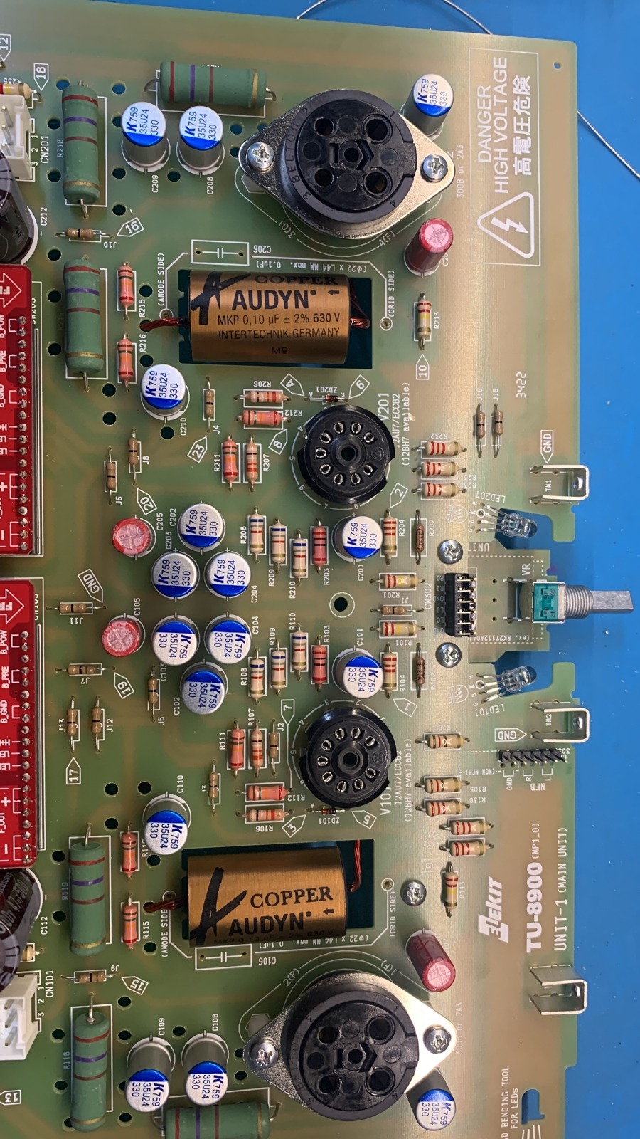

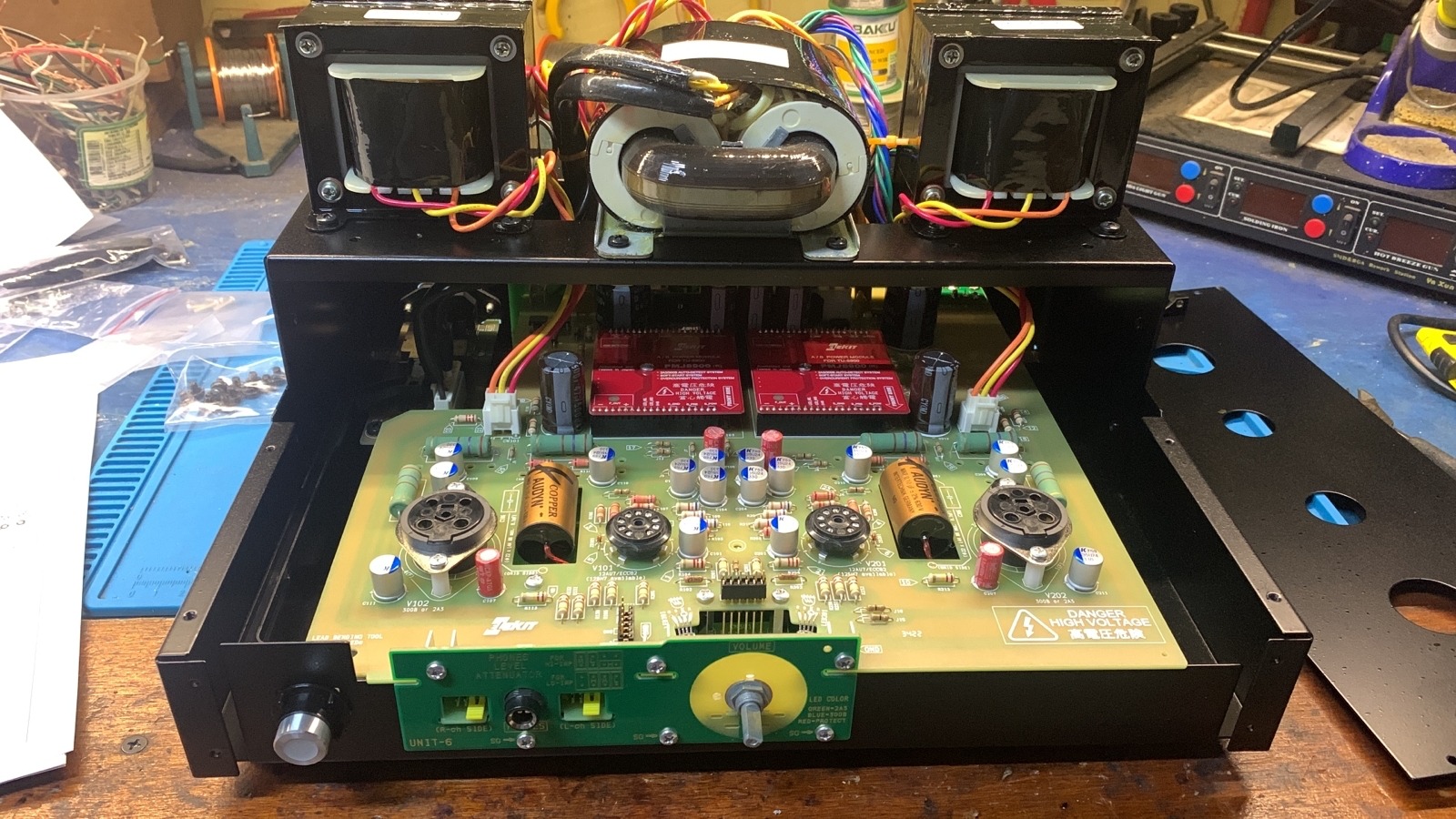

First pic with the bigger (0.47) mundorf silver supreme I saved from the phono stage on the 8550 pre.. it didnt fit the 8900 by a smudge, the board underneath didnt let all close in. Had to swap to the Audyn Copper Max 0.1
Other upgrades include silver solders, Allen Bradley / Dale resistors and a few capacitors; Im not the builder. I did buy a wrong potentiometer (not gonna lie, I did see the messages here and saw on the manual that RK27 was the wright one, and still I wrongly double checked before asking someone to buy the upgardes for me in North America) and furutech NFC plugs that also wouldnt fit.
Am playing mostly with speakers with some good new 300B but already tested with the Senn HD800 and wow!! Also will need to test with the supposedly better quality NOS 2a3. Will need much more time with it for burn in and to further compare with my beloved DIY Kevin Gilmore CFA3 amp. However, this is 220v and the 8900 is 115v, amps are in different cities, so a side by side is really unlikely in the short term

Hi All,
First-time poster and relatively new to this hobby. I am trying to finish my TU-8900 build and need to install the VCAP CuTF's. With the original capacitors they are not listed as being directional. Does that hold true for the VCAP CuTF's, or do I need to worry which side the red and green leads connect to? Thanks.
