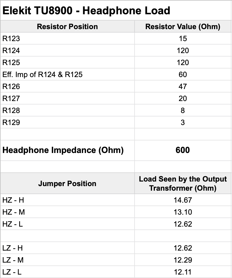

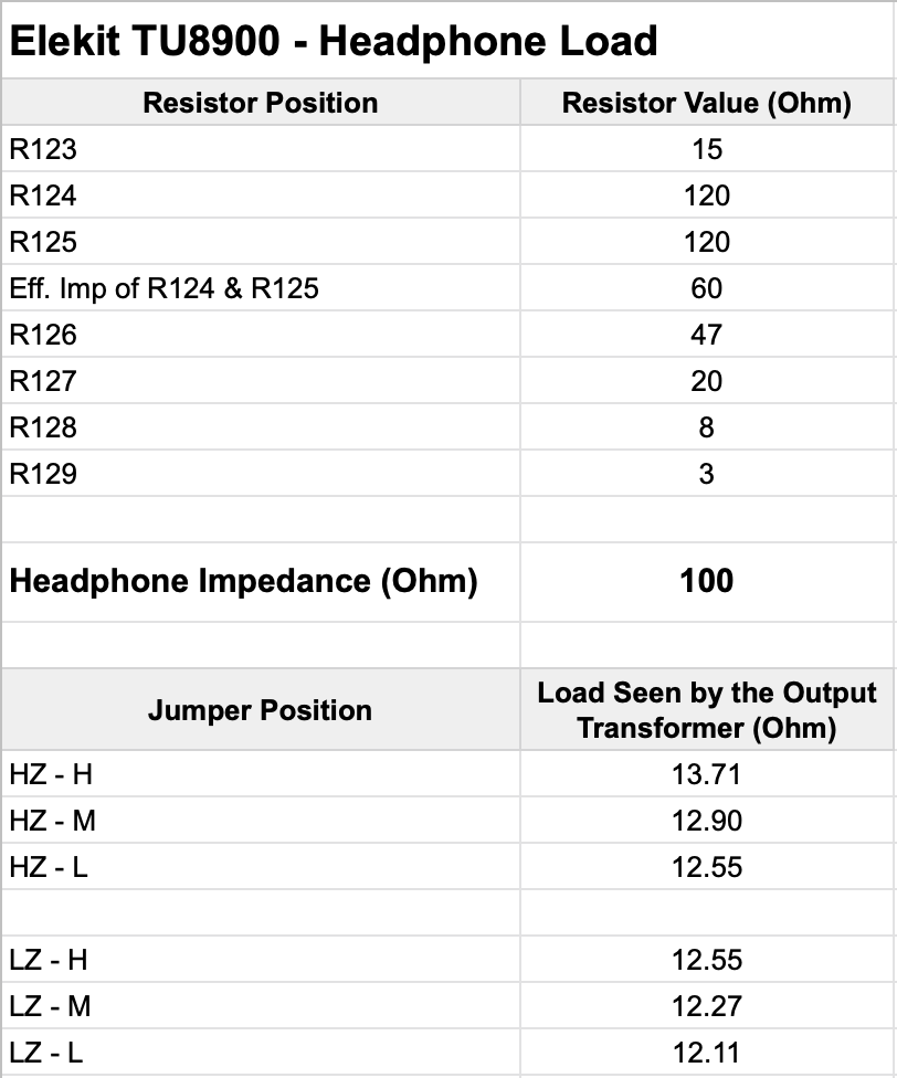

From what I have understood so far, a high impedance headphone should not harm the OPT or the amp in any manner. If I am not wrong, all the Eddie Current flagships (Studio, 445 and 2A3M4) use speaker OPTs and offer a headphone out without a resistor divider network. Problem arises when a low impedance load like a 4 Ohm IEM is connected. The resistor network on the 8900, acts as a fail-safe mechanism and makes sure that, regardless of the headphone being connected, the OPT will always see a load anywhere between 12-15 Ohm. See attached pics.

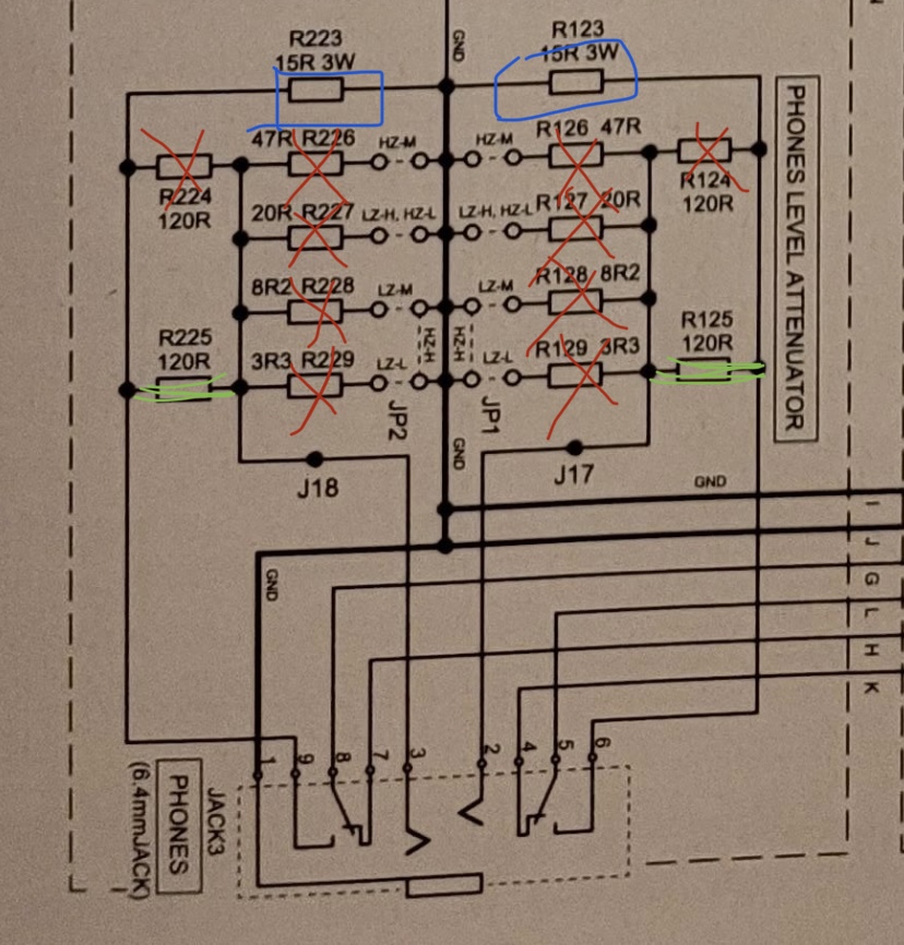

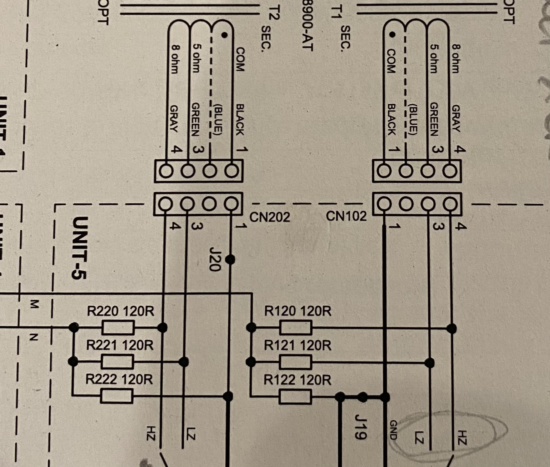

All the resistors that are part of the NFB network are on the speaker out board. None of the resistors on the headphone board contribute to the NFB network.
On the 8900, the output from the secondary winding of the OPT first comes to the 6.3mm headphone jack, and then goes to the speaker taps. The headphone jack on the 8900 has an inbuilt switch. When no headphone is connected, it outputs to the speaker taps. And when you connect a headphone, it breaks the connection to the speaker taps. As a result, the headphone out is the shorter path from the OPT on the 8900.
The problem I foresee by skipping the resistor network are, i) the lack of headroom to finely adjust the volume and ii) noticeable hiss on headphones. I will definitely keep you posted on my findings.

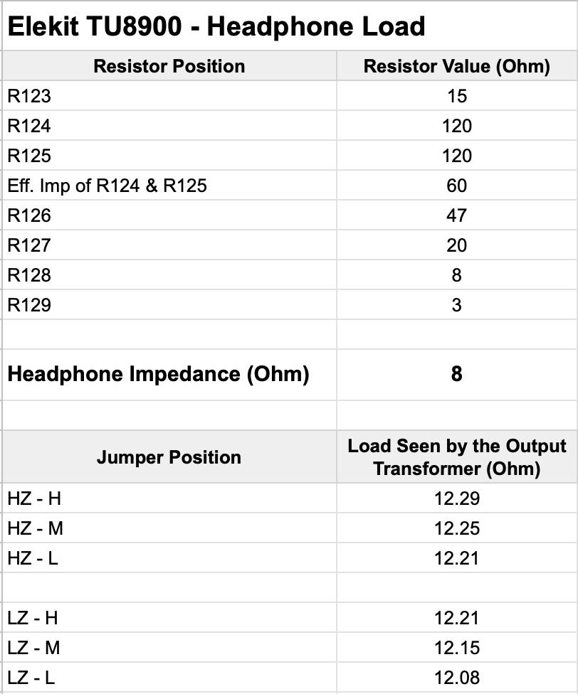

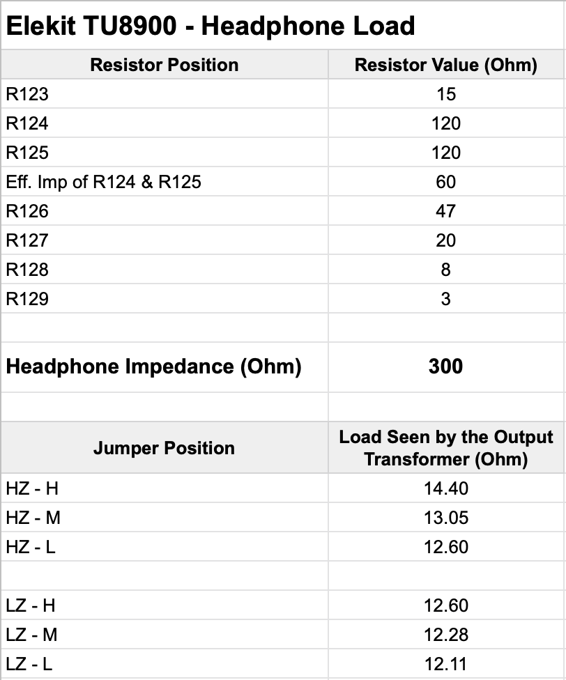

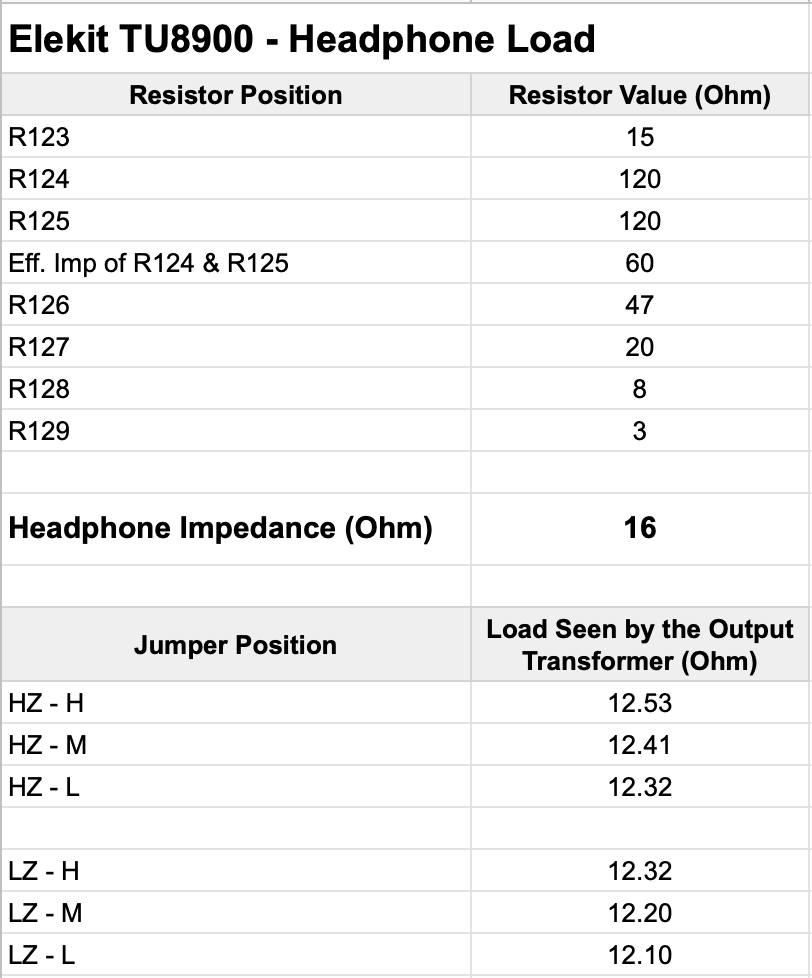

And here is how I am wiring the headphone board on mine. Literally skipping all the serial resistors (marked in red). For now I will be skipping the parallel resistors (marked in blue) too. But might put those in later to understand how those affect the sound. And where it is marked green, I have used a wire to jump, instead of the resistor.

Why don’t you try connect directly from OTs ? R220 or R221 (120R) and R120/121 depend on which one you want to aim for. The Hi-Z is 8Ohm and Low-Z is 5 Ohm. That is if you want to use the NFB networks, and if you don’t, tap it right at CN202-102 terminal 3/4
