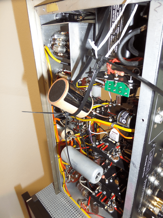

Got it swapped and playing again. That was really quick actually. Took about 45 minutes.
I'm not crazy about glueing to the underside due to bad experiences in the past. Hot glue is great for a top mount but not underneath IMHO. More permanent glues can be corrosive and would make cap rolling difficult. Unfortunately the Miflex are too long to mount or glue topside. I'm happy with the solution I devised.

Well I have to eat my words. Yesterday while listening I noticed some low level 120Hz hum (confirmed by my spectrum analyzer) coming through my speakers. As you guys suggested it was due to the long leads under the board. I took out the Miflex caps and put in the stock caps that came with the kit. In the brief testing I have done so far it sounds like all of the hum is gone.
Time to order a set of caps that will fit in the allotted space.
