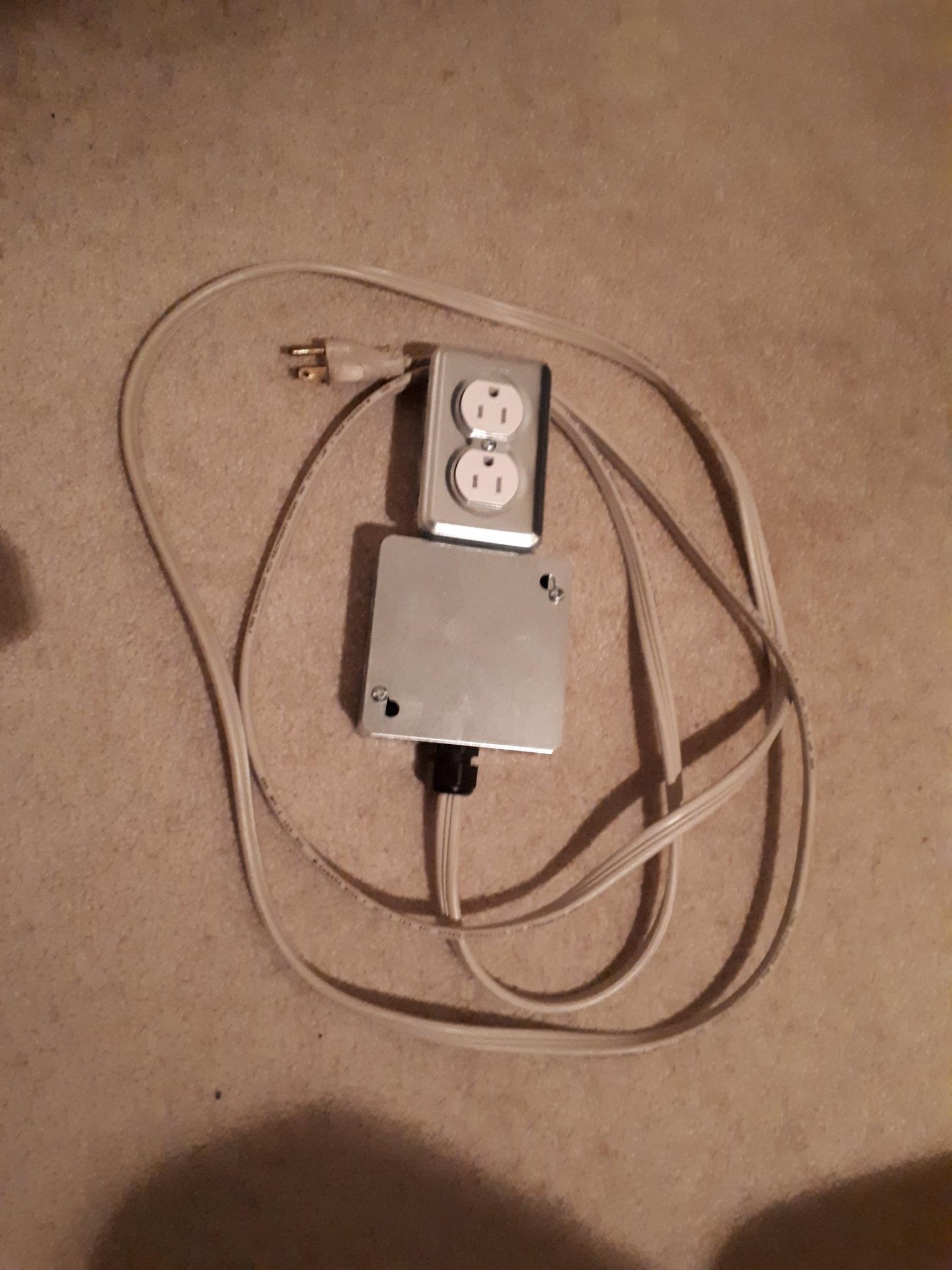

If anyone wants to reduce the white noise and make the music even cleaner. You can get a power line filter for the amp. I tried one for a week and it seemed to clean up the sound even more. I am going to put the CD player and the network player on the power line filter as well and see there is any improvement.
https://canada.newark.com/corcom-te...wer-line-filter-3a-700ua/dp/52K3856?st=corcom
I am settled with the TU-8600S now. I didn't do a lot of mod other than bypass the internal volume pot and use an external EIZZ 24 step premium attenuator (the gold version with ARMS resistors) and now adding the power line filter.

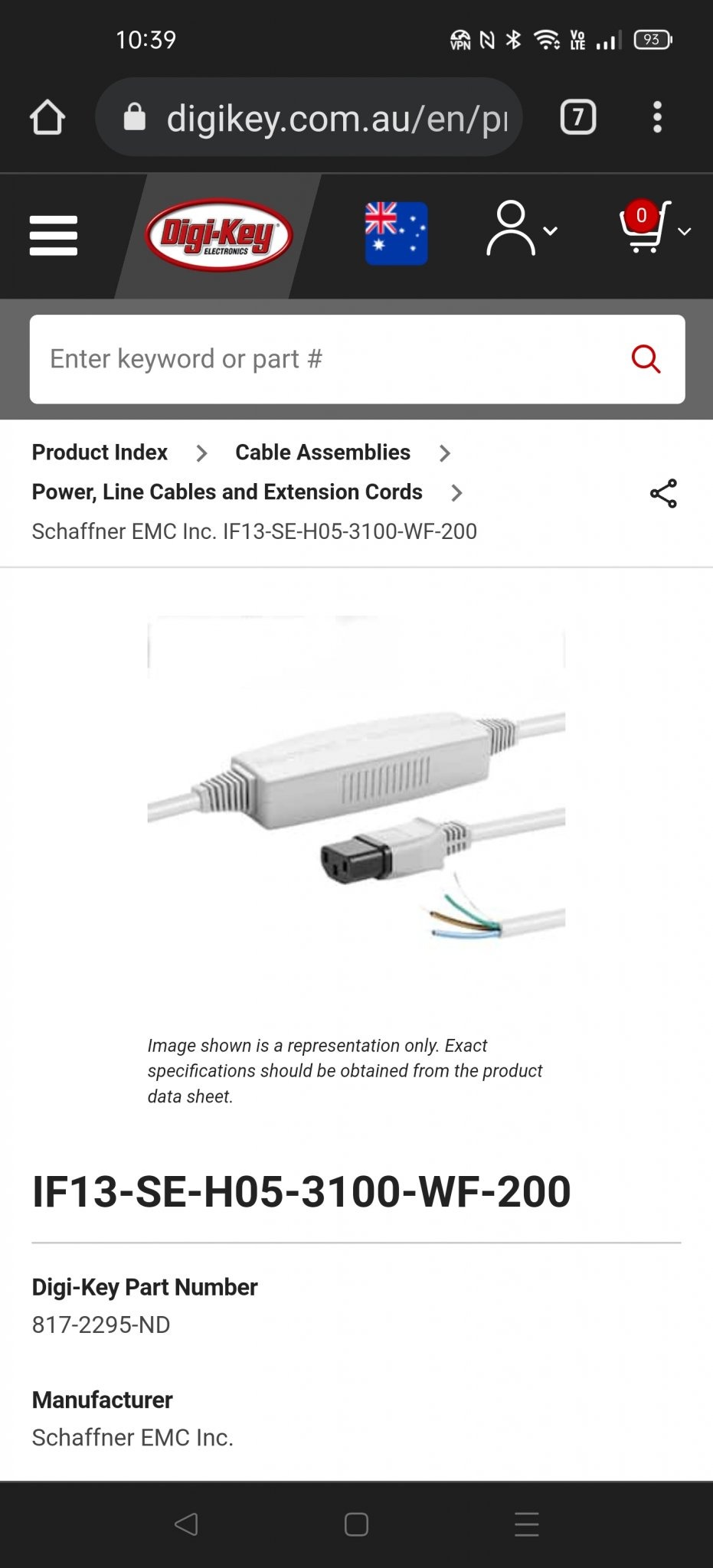

Does something like this do the same job... I can order it locally and won't need to modify the amp to use it, just wire the correct pin plug to the unterminated lead end.
That's the premium version. I already have most of the parts and just picked up two electrical boxes from Homedepot, and here is mine.
Thanks for that, Cool, I'll look into one of them. Whilst I'm happy to build amps from kits, I am cautious with 240v AC!
