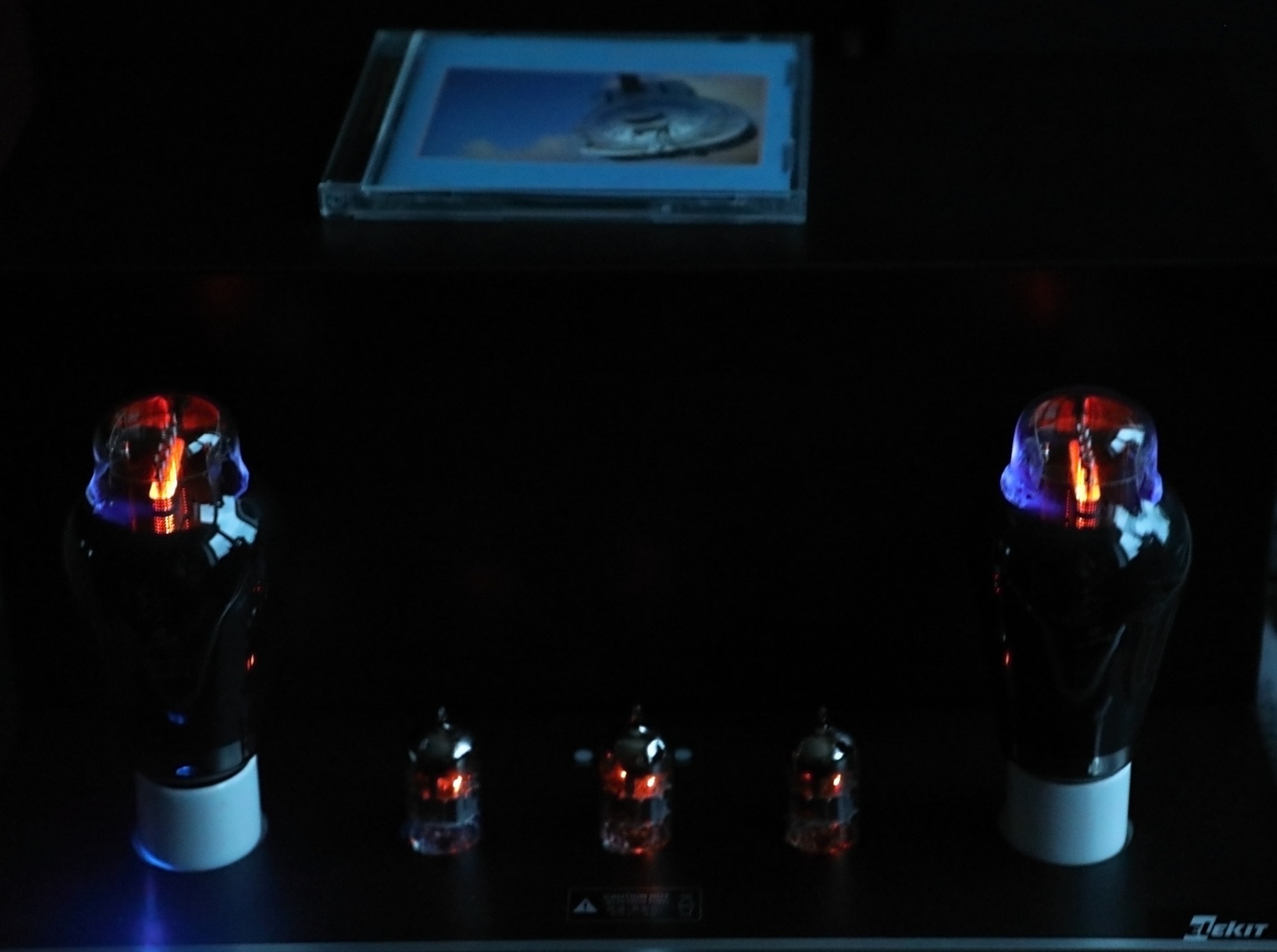

Soooooo after a long day out with the family, my resistors had arrived early in from Parts Connexion. Was planning on ordering from the USA (located in NJ) but I had asked them a few questions, and they were amazing with some help pointing towards what I needed and some options, that I had to give them my business even with the shipping from Canada. Not like my order was huge, only 20 bucks, but also on their side they know I only needed a few resistors and had no issues answering all my questions.
So below are some considerations that I selected my resistors. Just an FYI I think all the takman upgraded resistors in the kit are 0.5W resistors, which makes sense for the stock zphone (120-670ohms).
Why does this make sense? Lets take a look at my guesstimate at what the power rating is for each of the positions below. My assumption is that the amp is advertised at 9w of power but doesnt tell you at what ohms, so I am guessing it makes it at 8ohms like every other 300b amp. We can guess using an online calculator to get a generic number that the amp potentially is making at the ohm below.

So the conclusion, this works as intended. I have much more volume in Positions 1 (240 ohms) with my 300 ohm headphones (zmf/sennheiser) and I am able to finally drive my planar headphones off of position 4 (10 ohm). I am getting the same power that I was getting off of using the speaker tap adaptors. Everything sounds great, and finally the amp is where I am happy with it.
Below is a picture of the resistor locations.
Picture of the Pin Vice I used which I linked earlier.
Picture once everything was installed.
